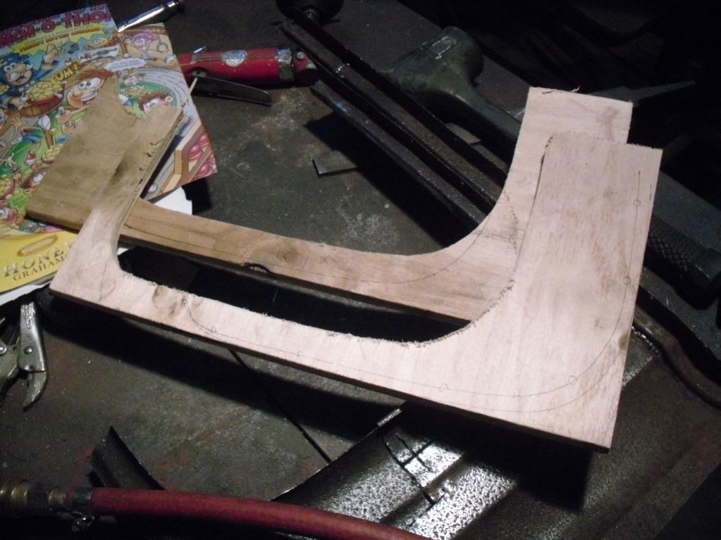

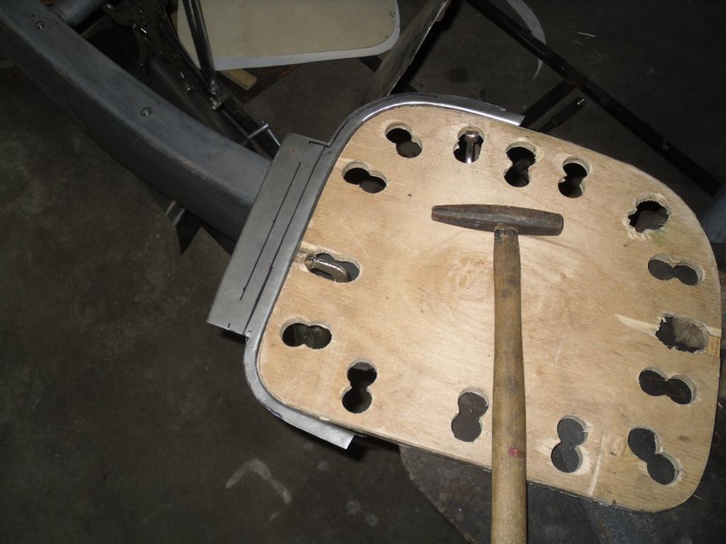

    Here's a few shots of the hammer form technique used to form the inner panel for the lower portion of the qtr window. pattern was made in paper first and transferred to the plywood.
    Again this was made from 18 guage sheet metal.

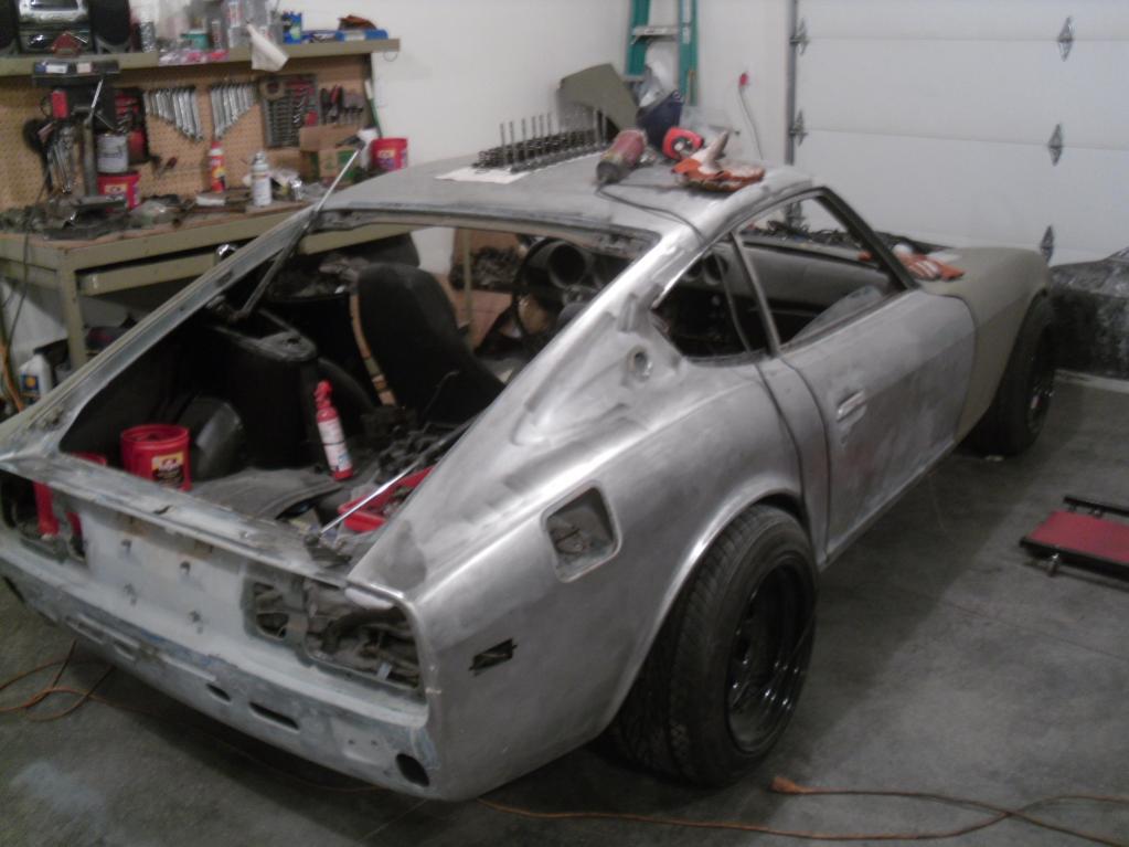

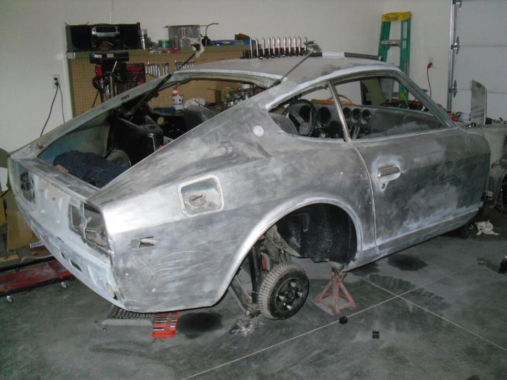

    Here's the datsun build. last picture taken last weekend!

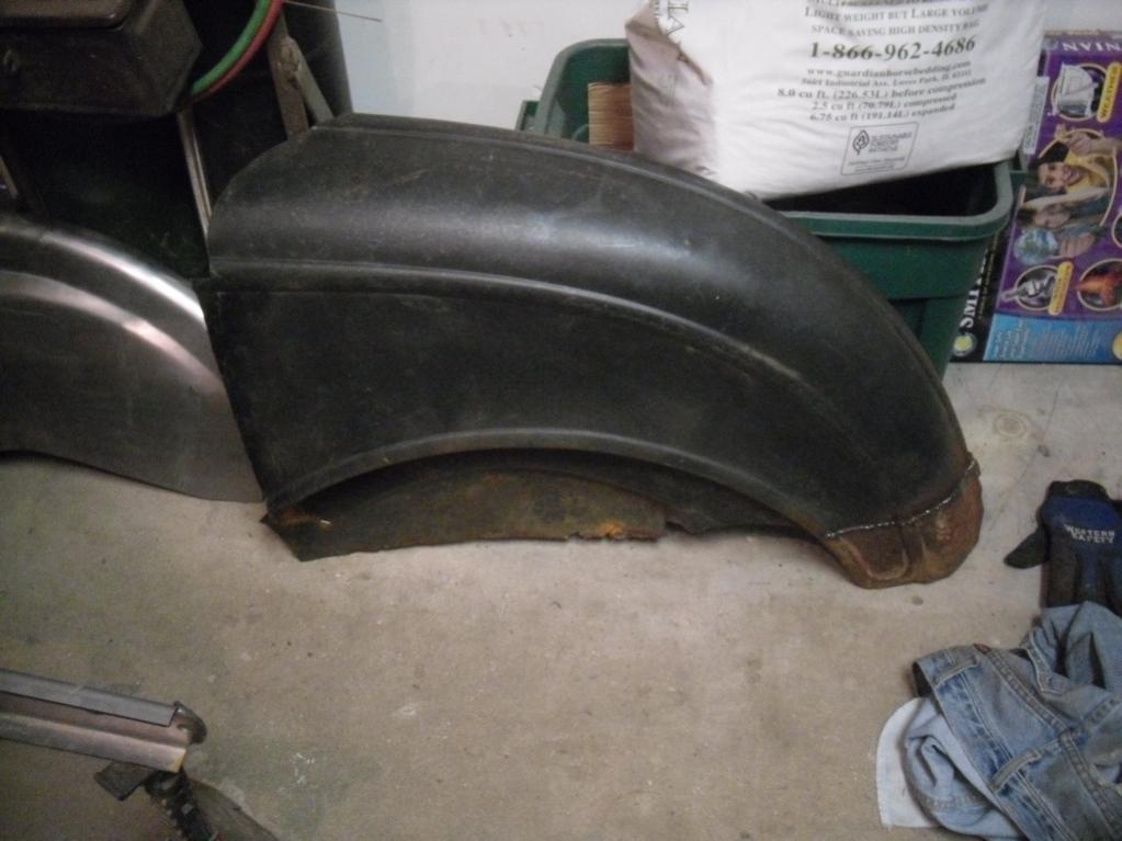

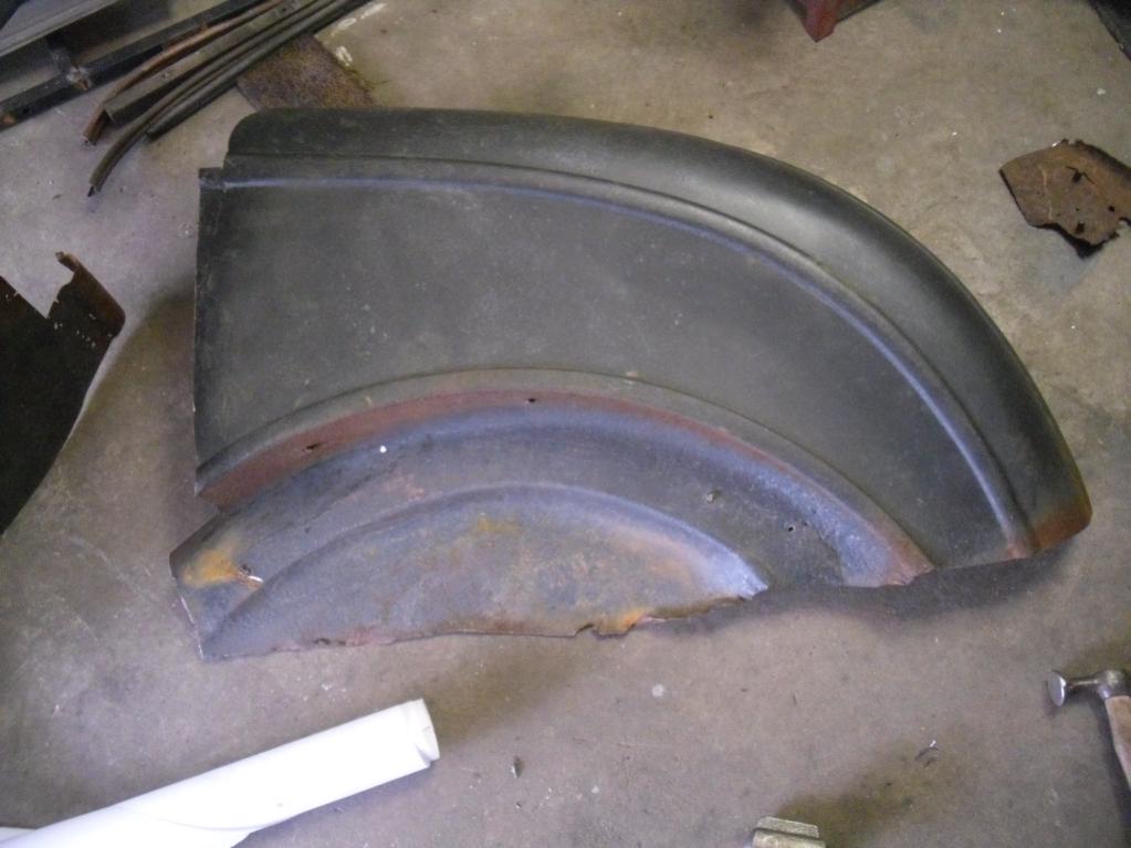

    As luck would have it a fellow hamber contacted me and wanted to work out a trade for the old frame the car came with. His "bait" was the rear half of the missing left rear qtr panel for the coupe.
    well needless to say we were able to work out a deal.
    Here the part...

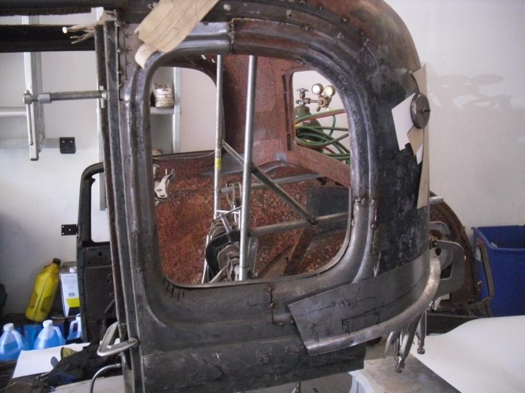

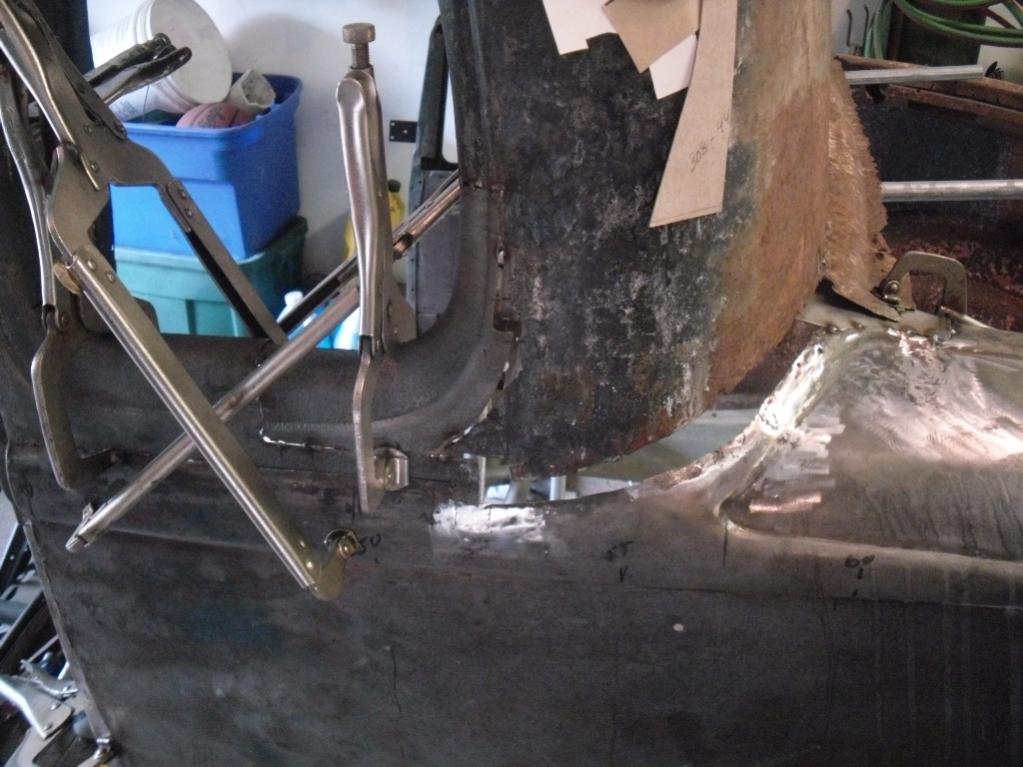

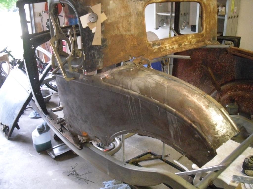

    Now to try and fit this togehter. Here I am test fitting the panel I made and the front of the race car qtr. tack and try the fit,repeat.
    This also will allow me to over lay the back rear qtr. Here is where the time spent converting the 1/2 scale qtr drawing to full scale, will be put too good use.
    Notice the lines on the panels , these are Ford factory measurement lines transferred from the paper drawing. I cut the paper with small diamonds shapes on at the top and bottom of each line. I think used a majic marker and marked each line then drew the lines.
    Hopefully I can match the lines and cut the panel correctly.
