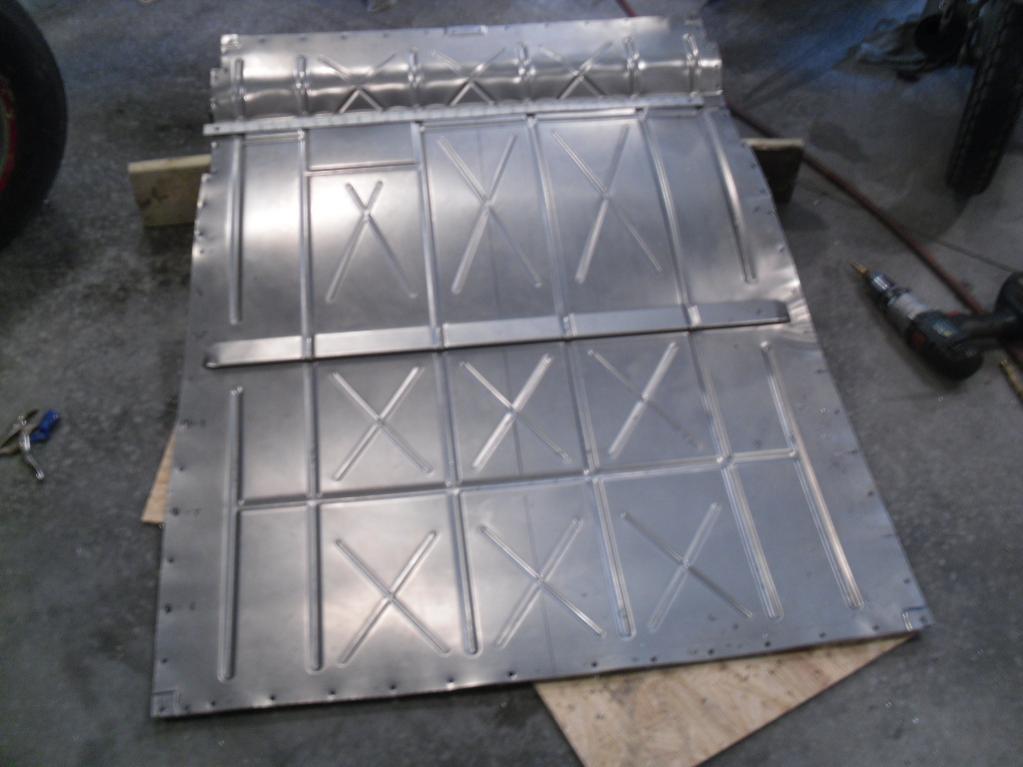

    I bought a floor for this car from Brookville, Fantastic quailty.
    I will post more on it later, but here are some pictures.

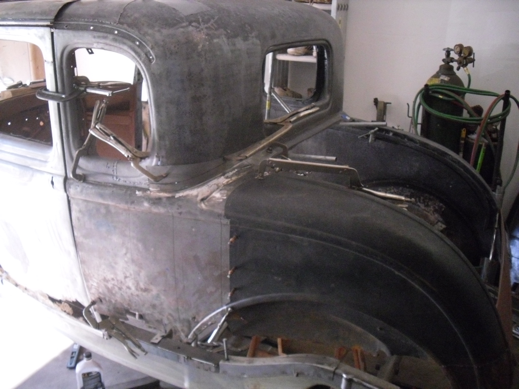

    Here's a few shots with the qtr on the car. I decided to purchase a decklid and gutter set from brrokville as well.
    I have a few pieces of the old gutter , but making this willl take way to much time.
    I figure these pieces will help me control the gaps better.

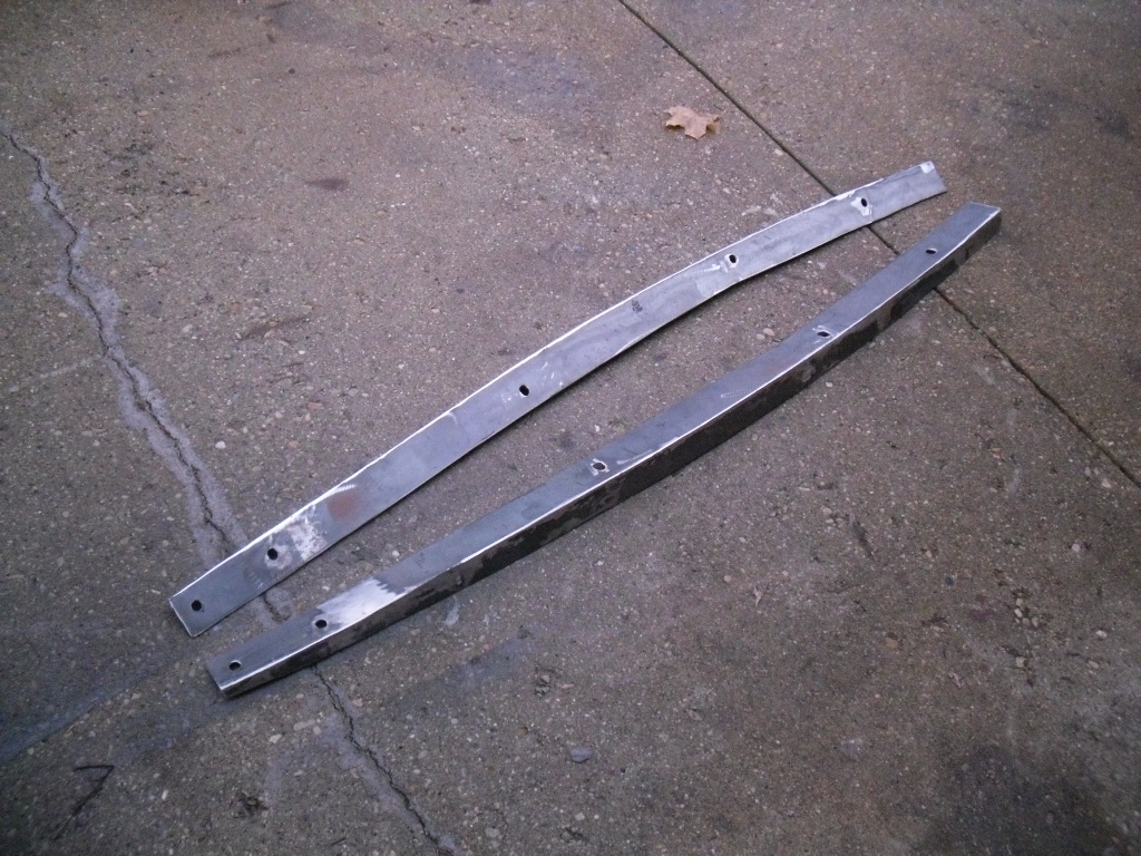

    I started making the subrails for the car . I used what was left of the 4 door front subrails as a guide and cut a couple pieces of 14 guage for each side and welded them up.
    The crossrails have been iin mol***es for awhile and have cleaned up really nice so I willre use them. The front crossrails has been cut up some and will need some repair.

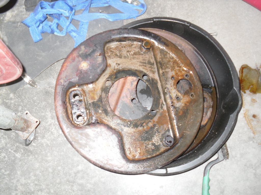

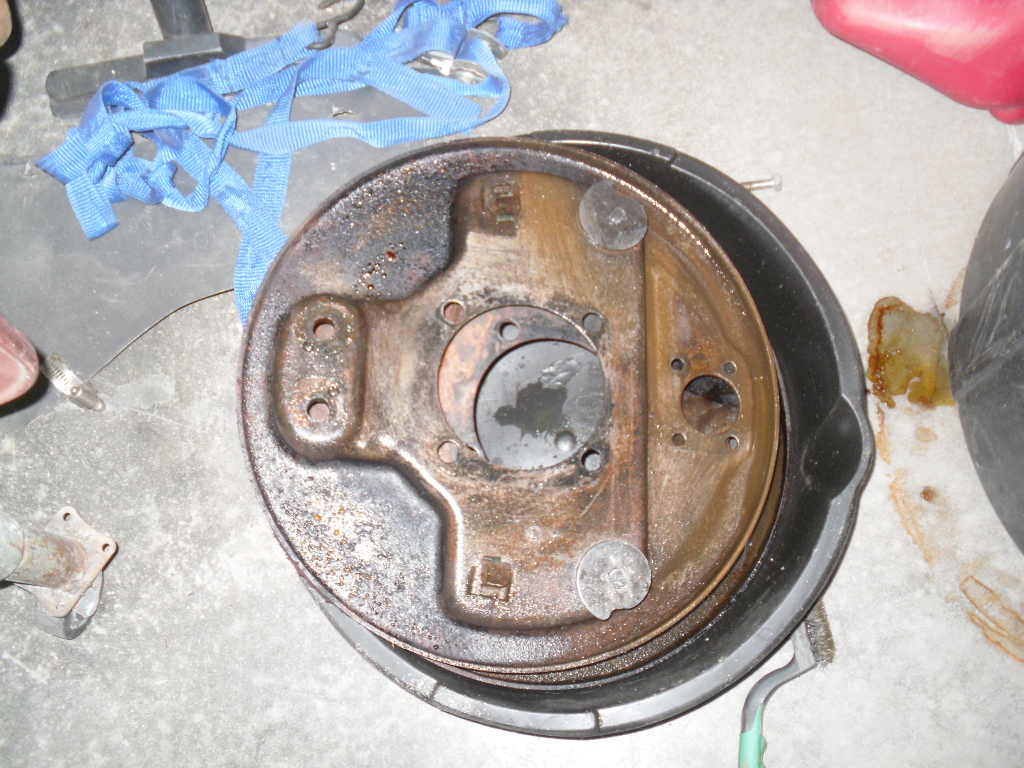

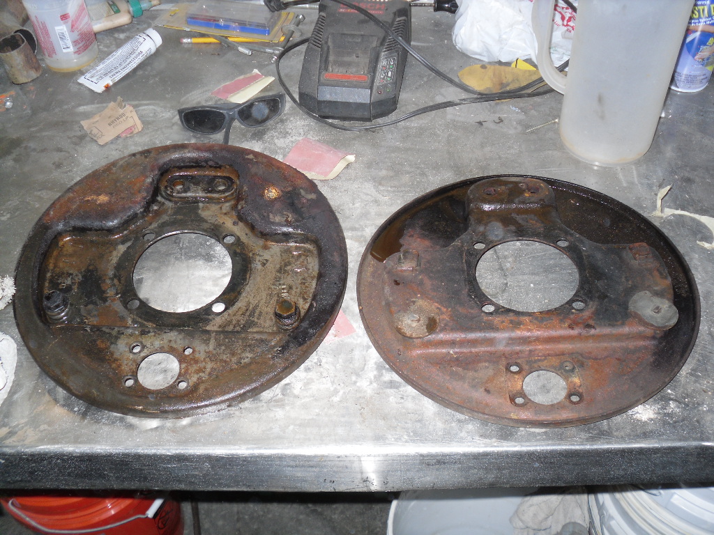

    Found some backing plates off ebay. These will go into vinegar bath.
    plans call for buick shoes and wheel cylinders with Buick finned drums.

    Drew.Morris
    Does the vinegar get rid of the rust?

    yes vinegar will eat rust. l use it on small pieces, that or mol***is (man can't spell that tonight)
    Electrolysis on large parts.

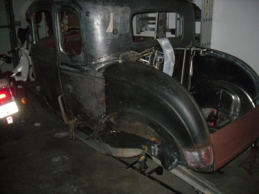

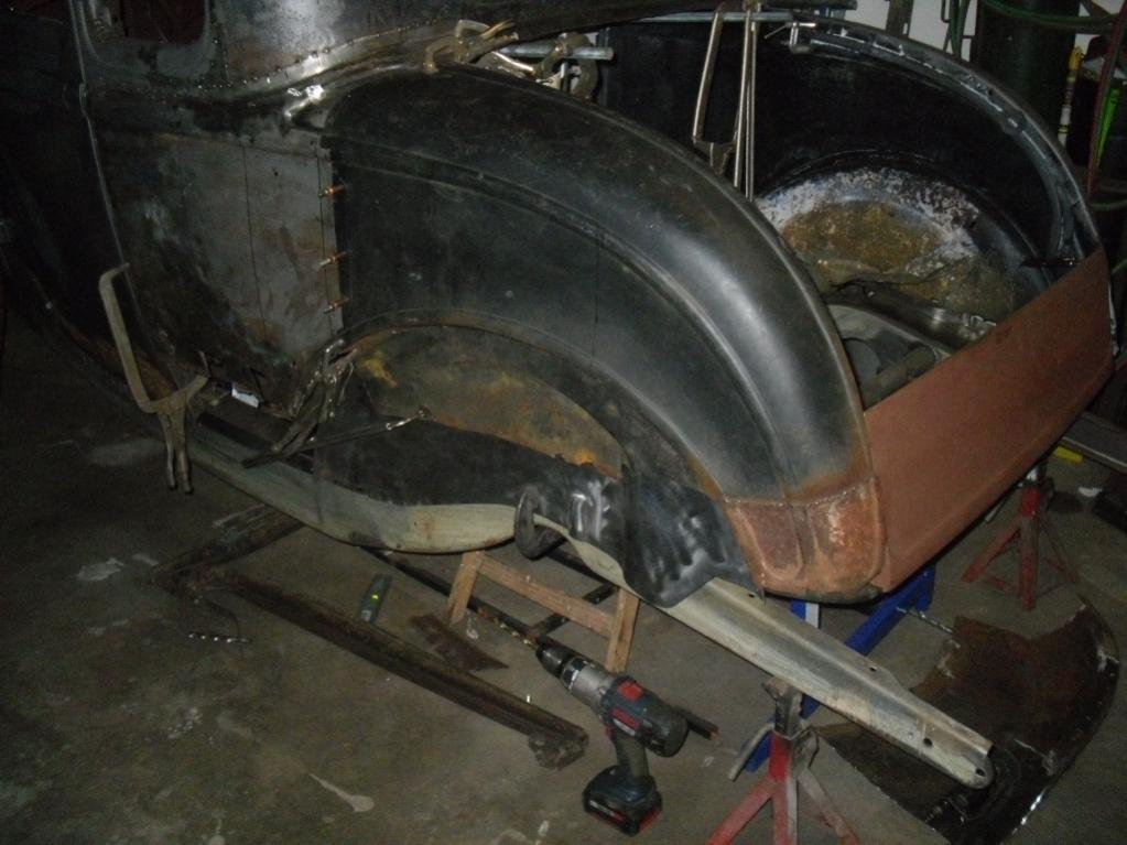

    Using some cleco fastners I measureed and attached the rear quarter. Looks like everything is lining up.
    I have a few steps I have performed that I need to get you caught up on but thought I would let you know how things are coming along.

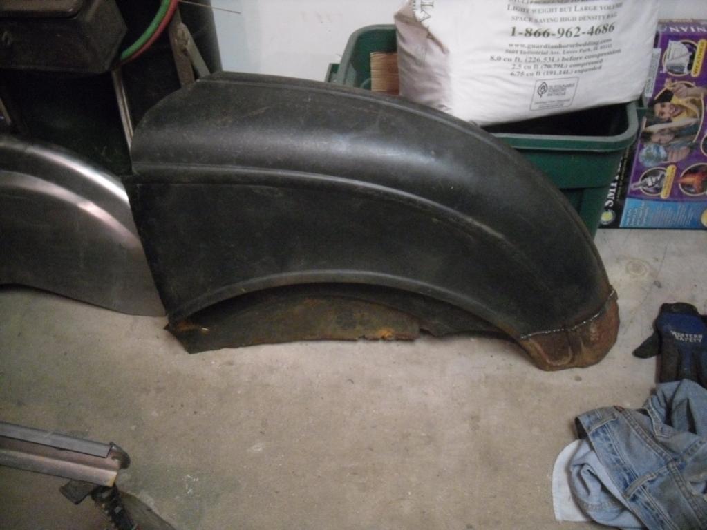

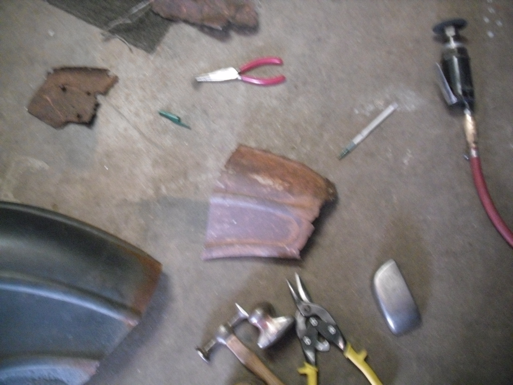

    from wisconsin
    The end of the Black qtr had been cut off before I traded for it. The original qtr for the car was pretty thin everwhere excpt the end so I cut it off and welded it on.
    I may end up replacing this but I needed the end on for proportions.

    Andy
    I don't know about steel, but vinegar will eat iron when it runs out of rust. I had a piece of iron really eaten up. It had holes all over it. Be careful.
