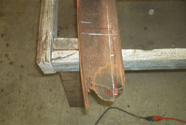

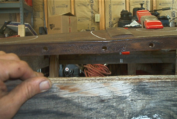

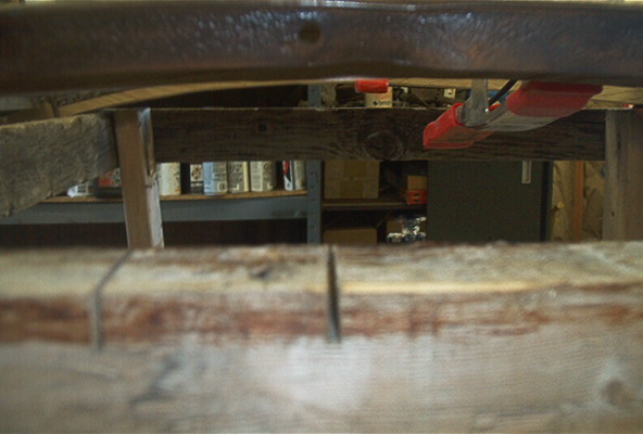

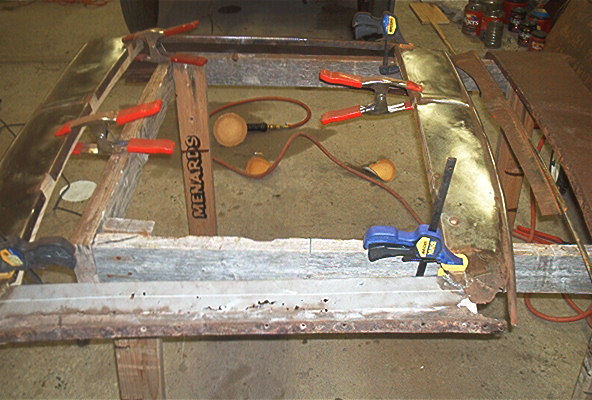

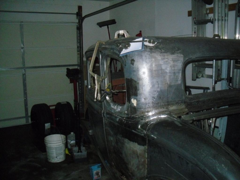

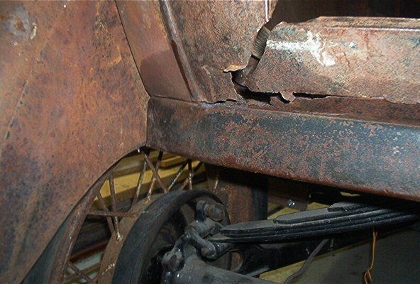

    Here's a few pictures of the qtr splice.
    At this point I have tack welded in the qtr to roof patch and the qtr.

    Jeffery, thanks for looking at the qtr. I think I have enough pieces to make this one now.
    I got the front of a 32 sedan qtr, the lip that fits to the post, when I bought the back window. This was the piece that concerned me the most.

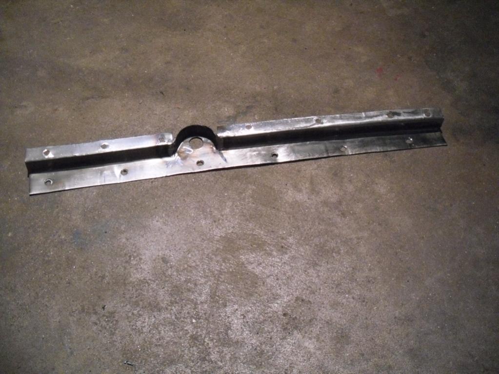

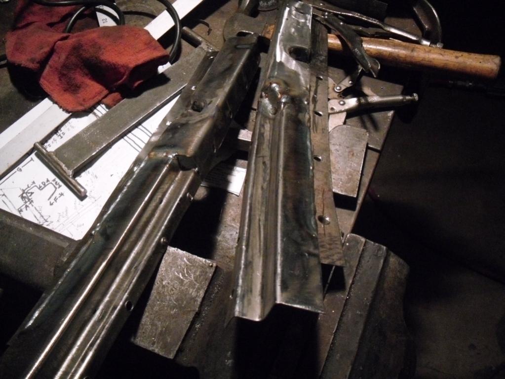

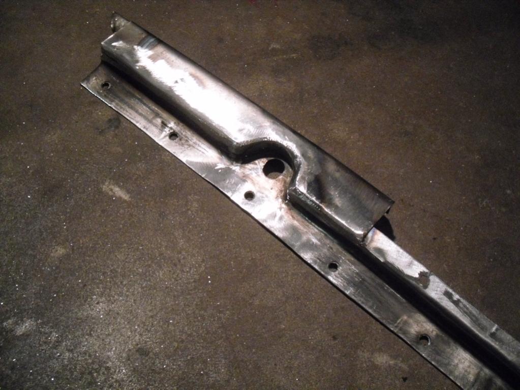

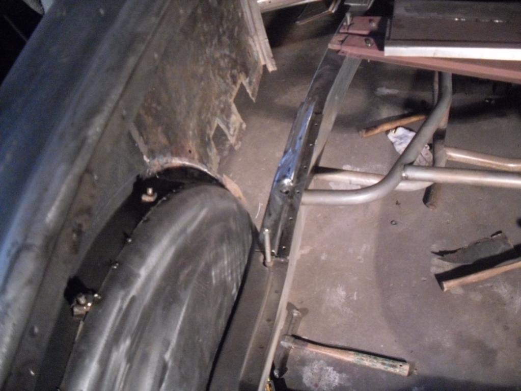

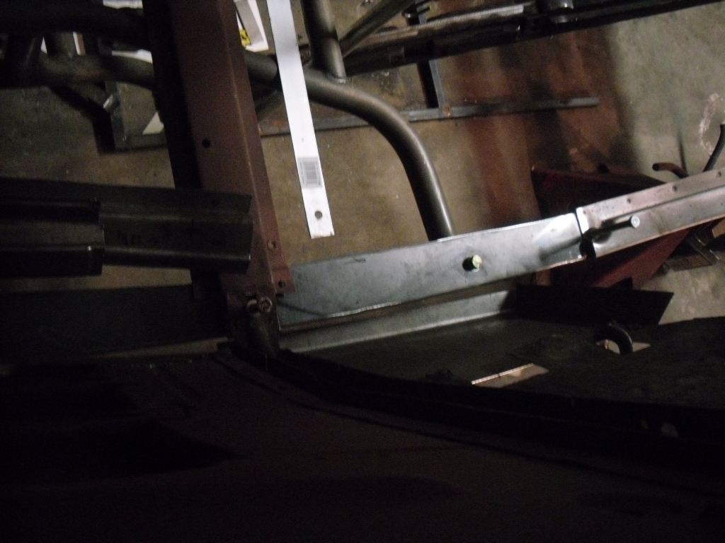

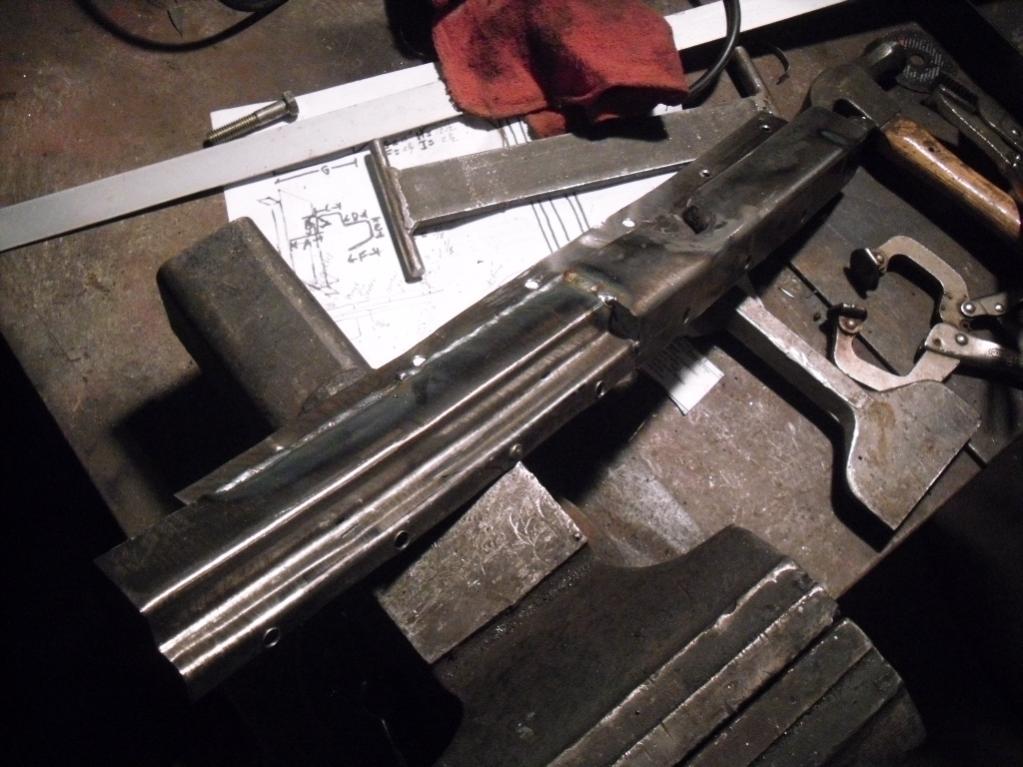

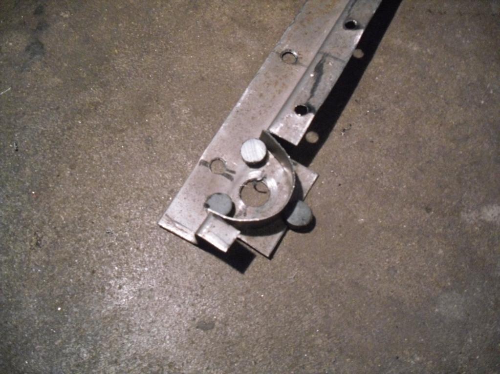

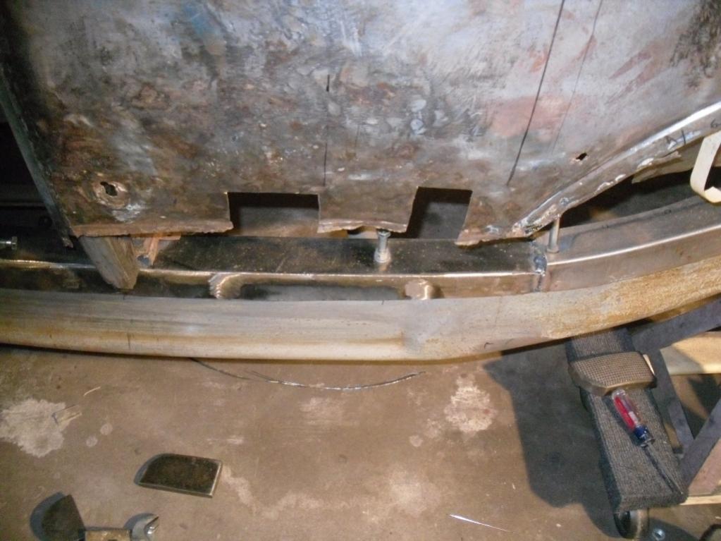

    Been a few weeks since my last update, so here is an update.
    As I mentioned before I purchased a set of brookville subrail cutoffs.
    I am making the remainder of the rails here is some of the process i used.

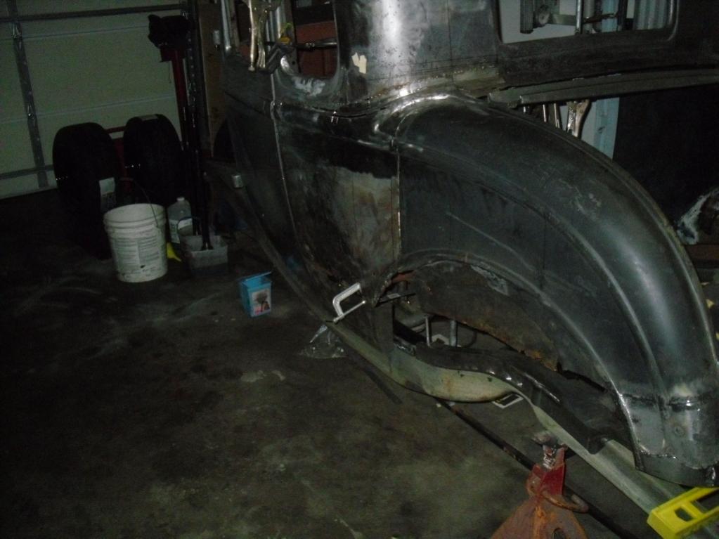

    Thanks for the nice coimments, and yes it was nice working with some 18 guage NEW sheetmetal
    Here's a couple more shots

    Human Fly your absolutely right. I bought a lower panel (below the decklid) from Tom Bay and the inner structure from Brookville. I had to modify the brookville panels to get everything too fit together.
    There will be lot's of mock up, I want the gaps right!!
    More on that later.

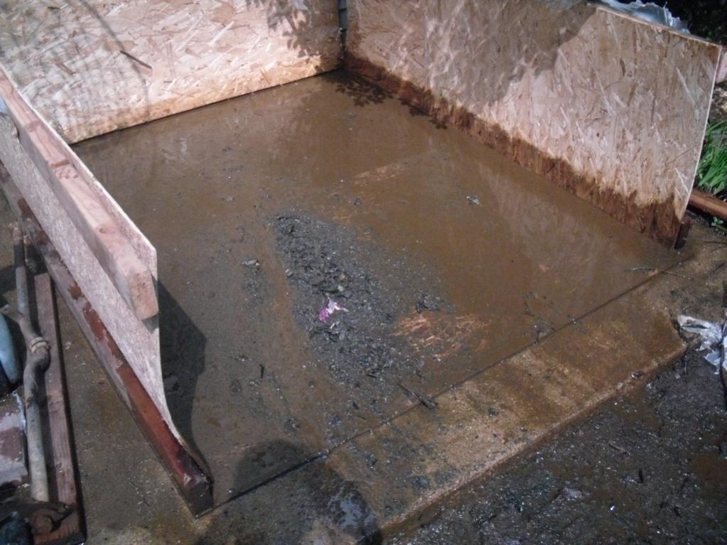

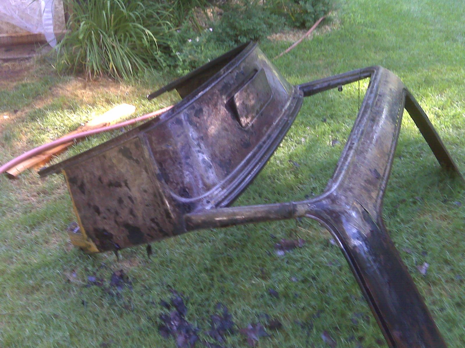

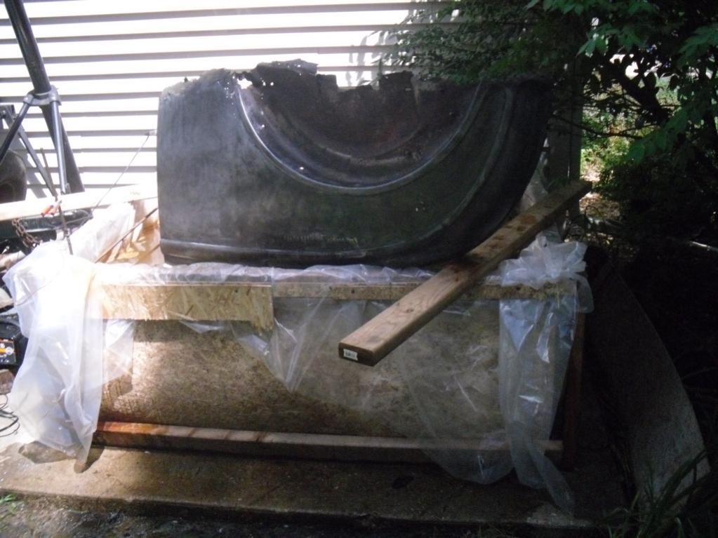

    I decided to use Electrolysis vs blasting to clean the rust off the metal. Very quick but kind a messy.
    Used a 12v battery charger. Rebar from Menards and a home made tub double lined with plastic.
    The rust turns balck and washes off with water and a wire brush.

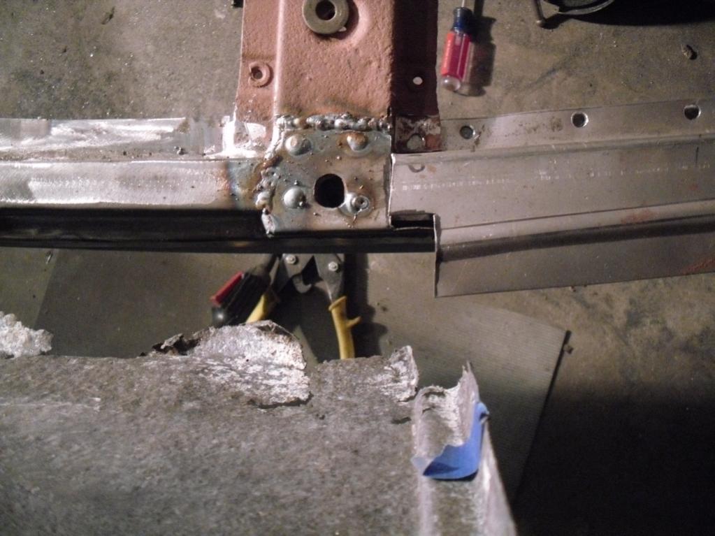

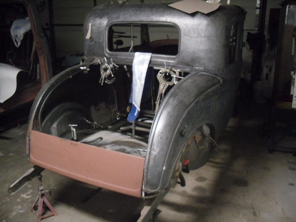

    Been busy working with my son's Datsun but here are a couple updates. Startining to test fot the rear.
