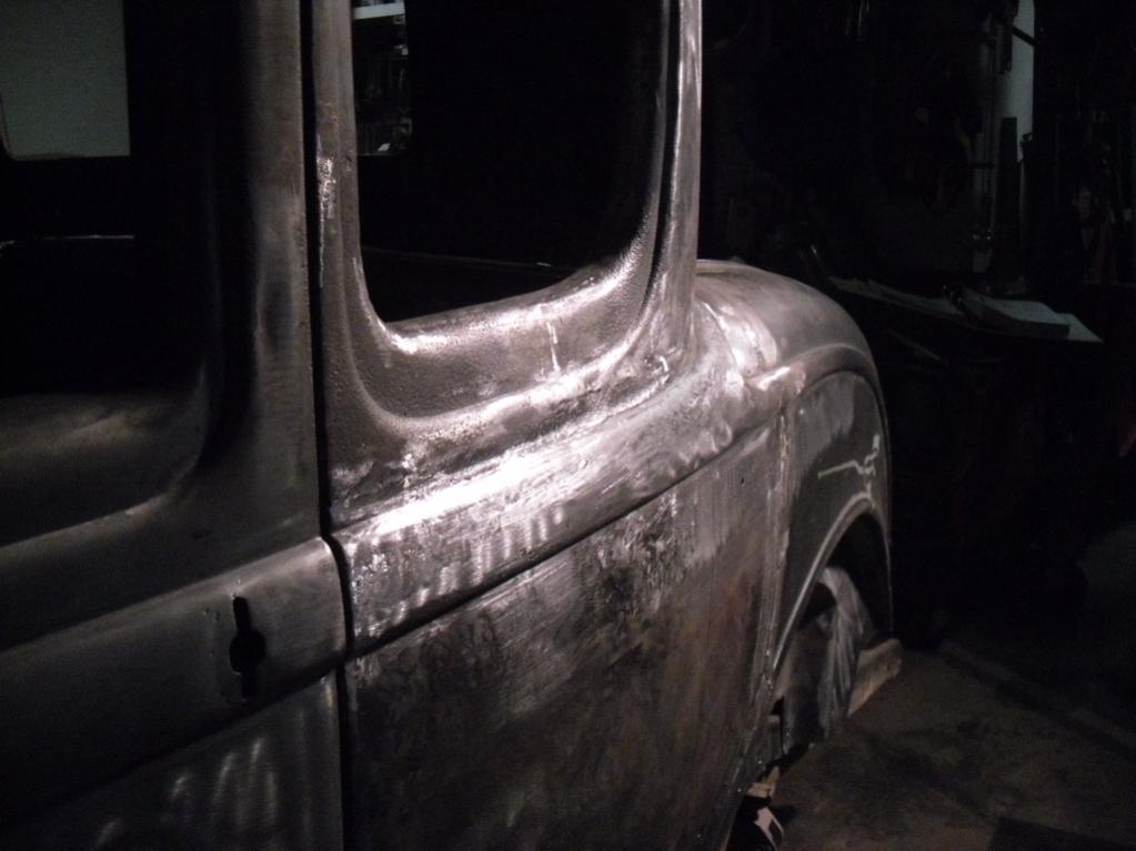

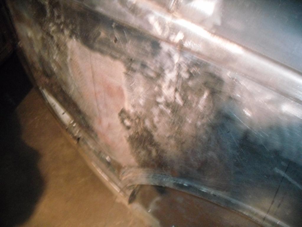

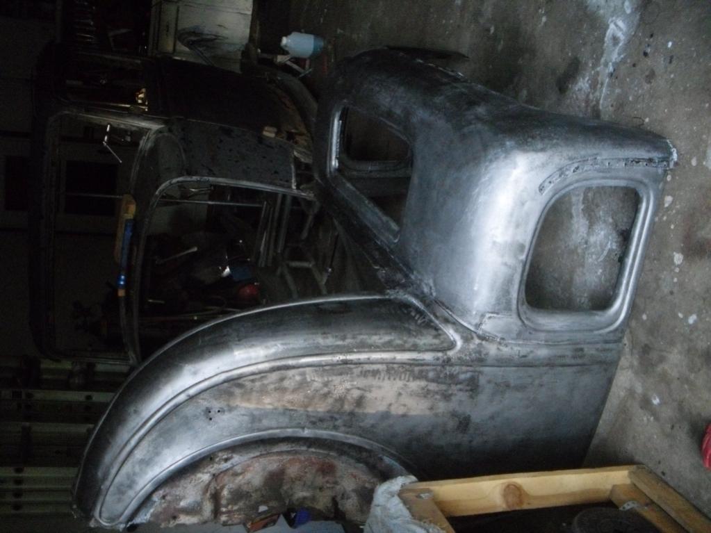

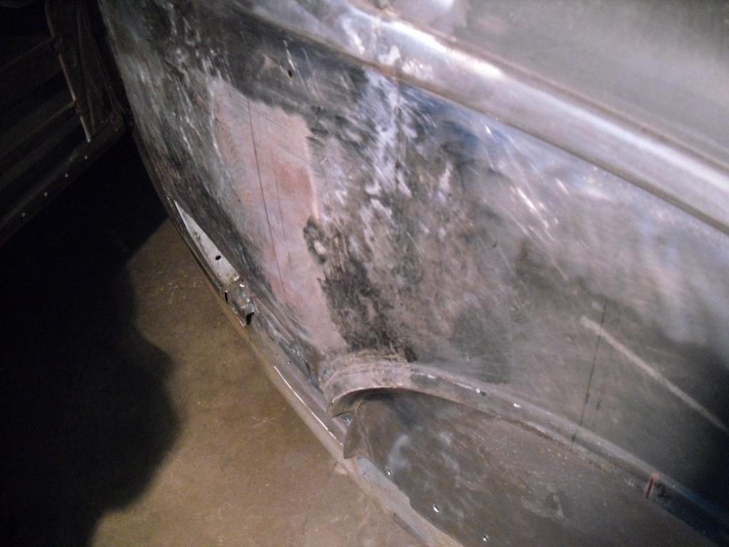

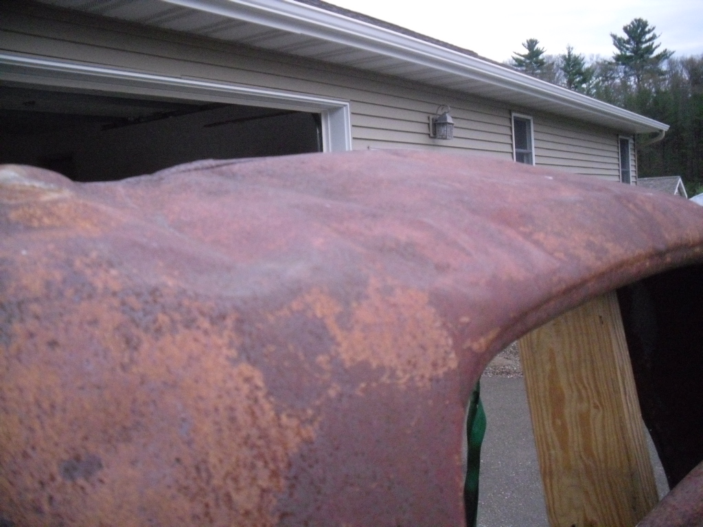

    Here are a few more shots of the electrolysis process. Somewhat time consuming and makes a mess!! It WILL kill the gr***.

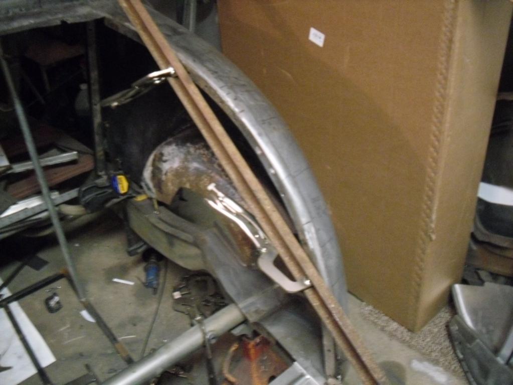

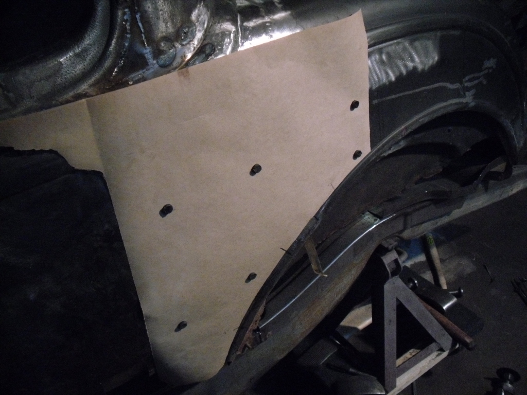

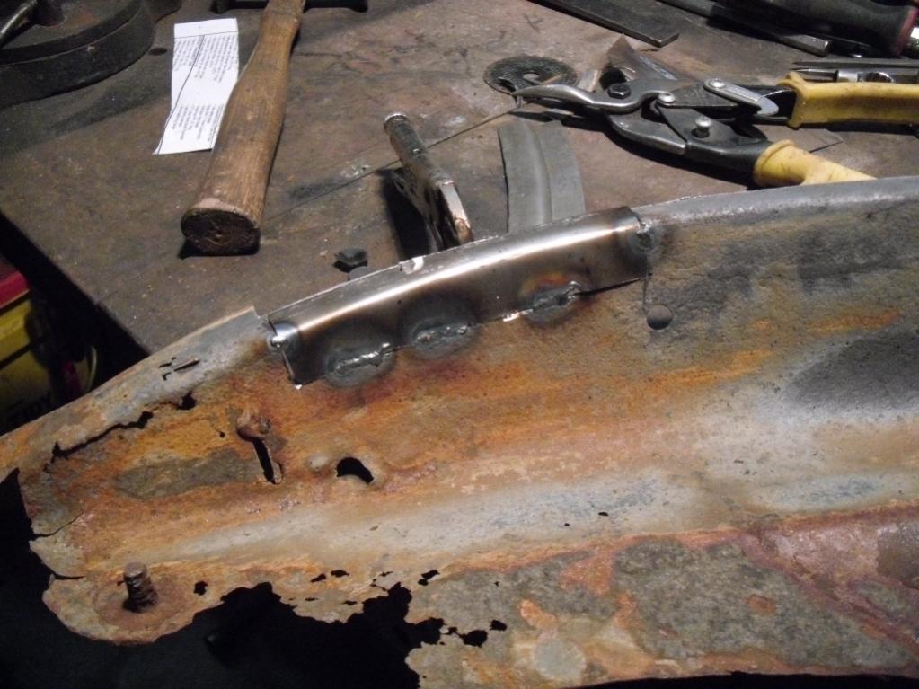

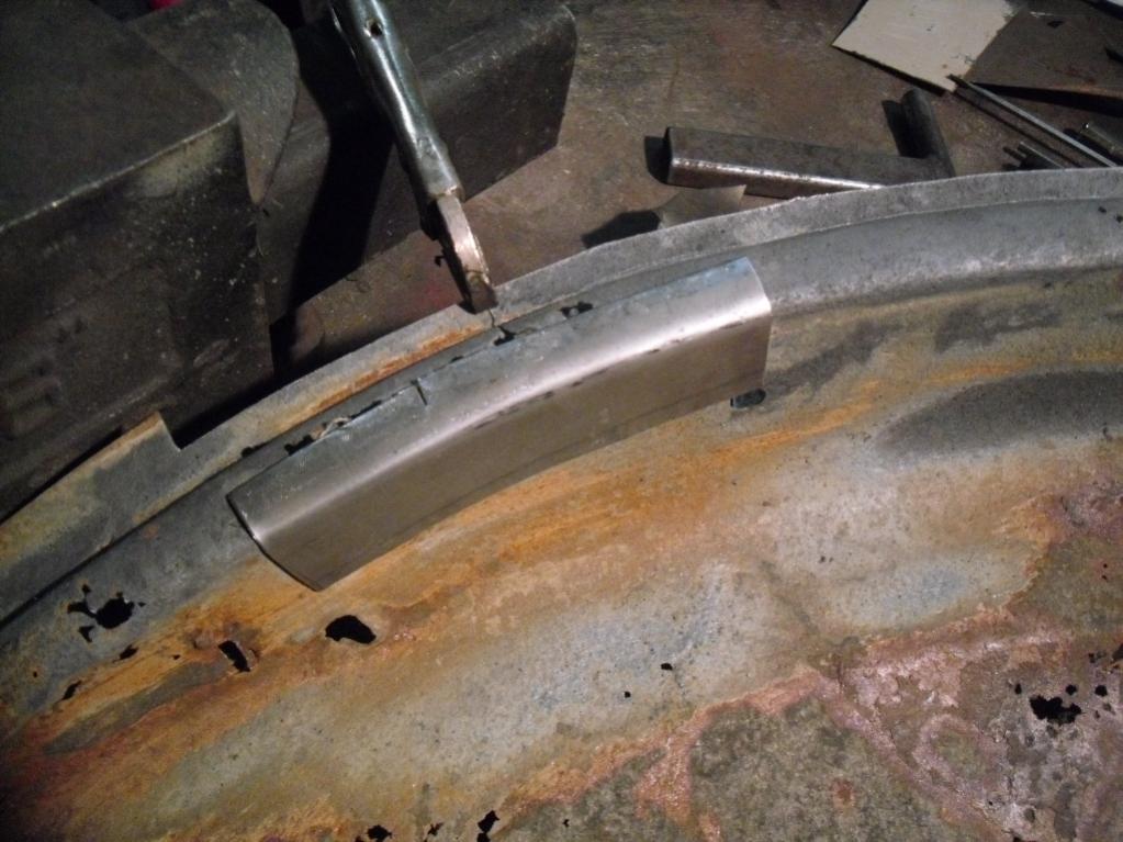

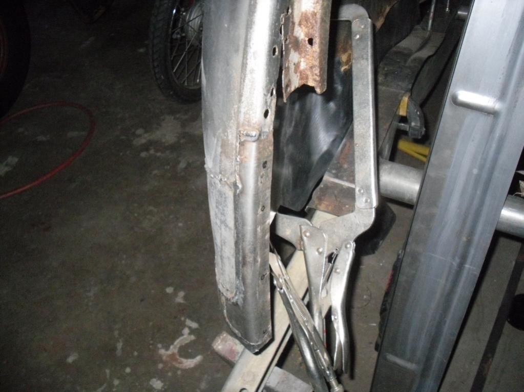

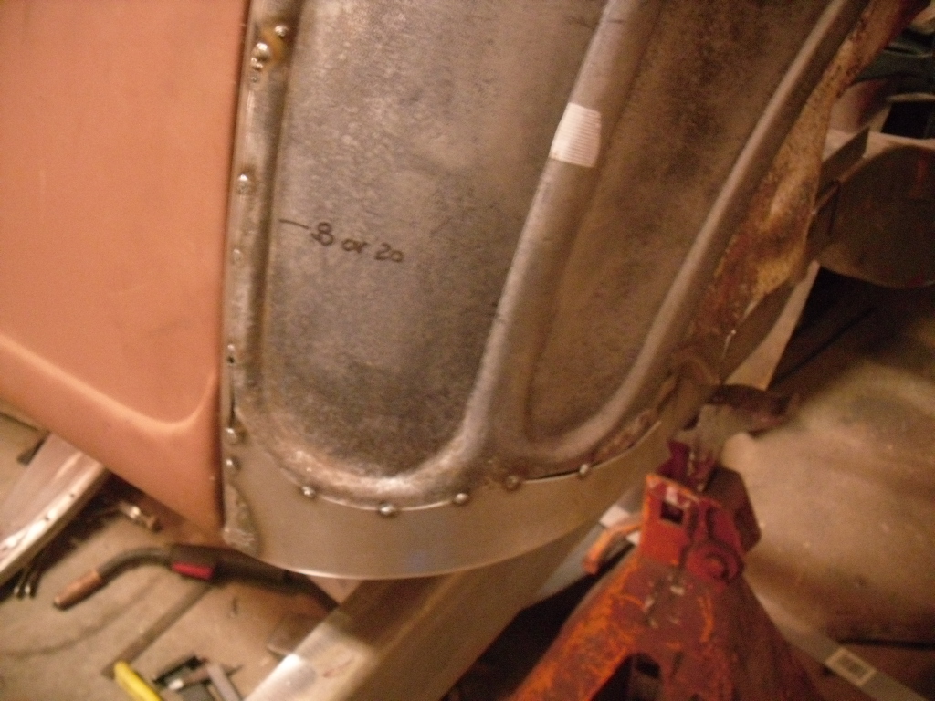

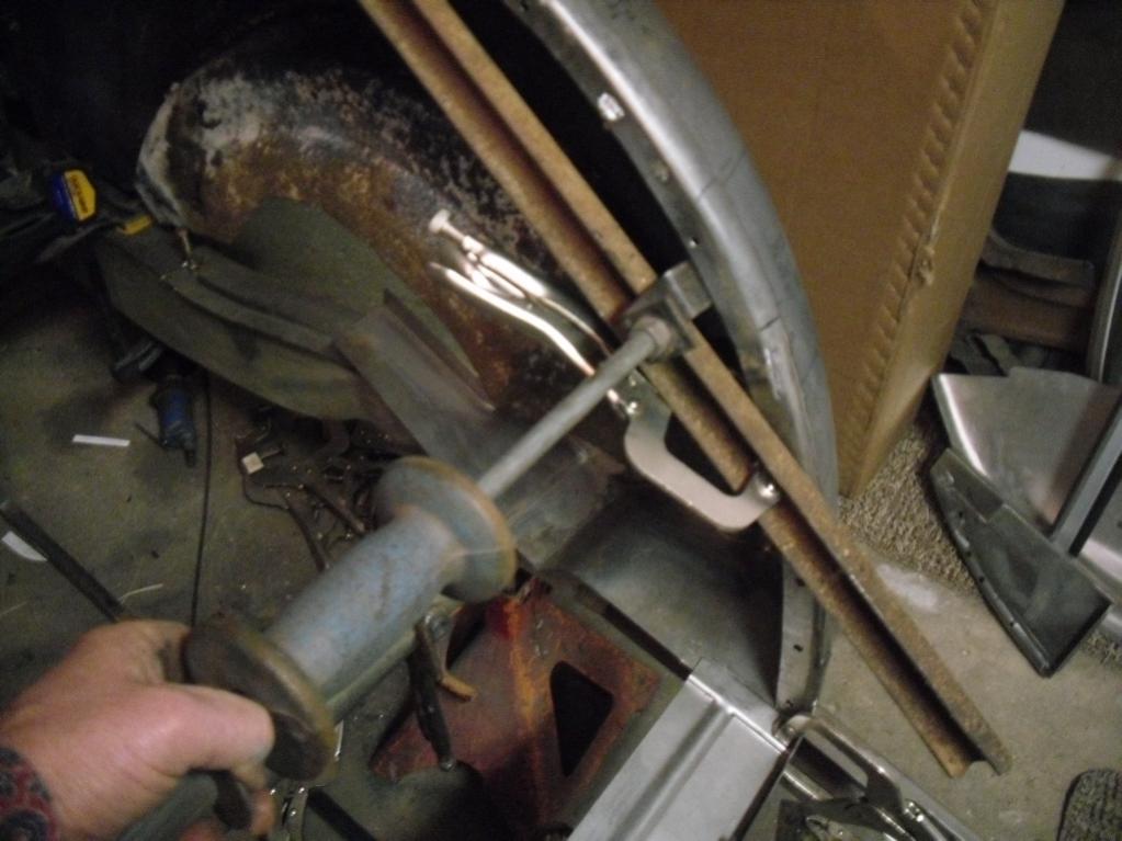

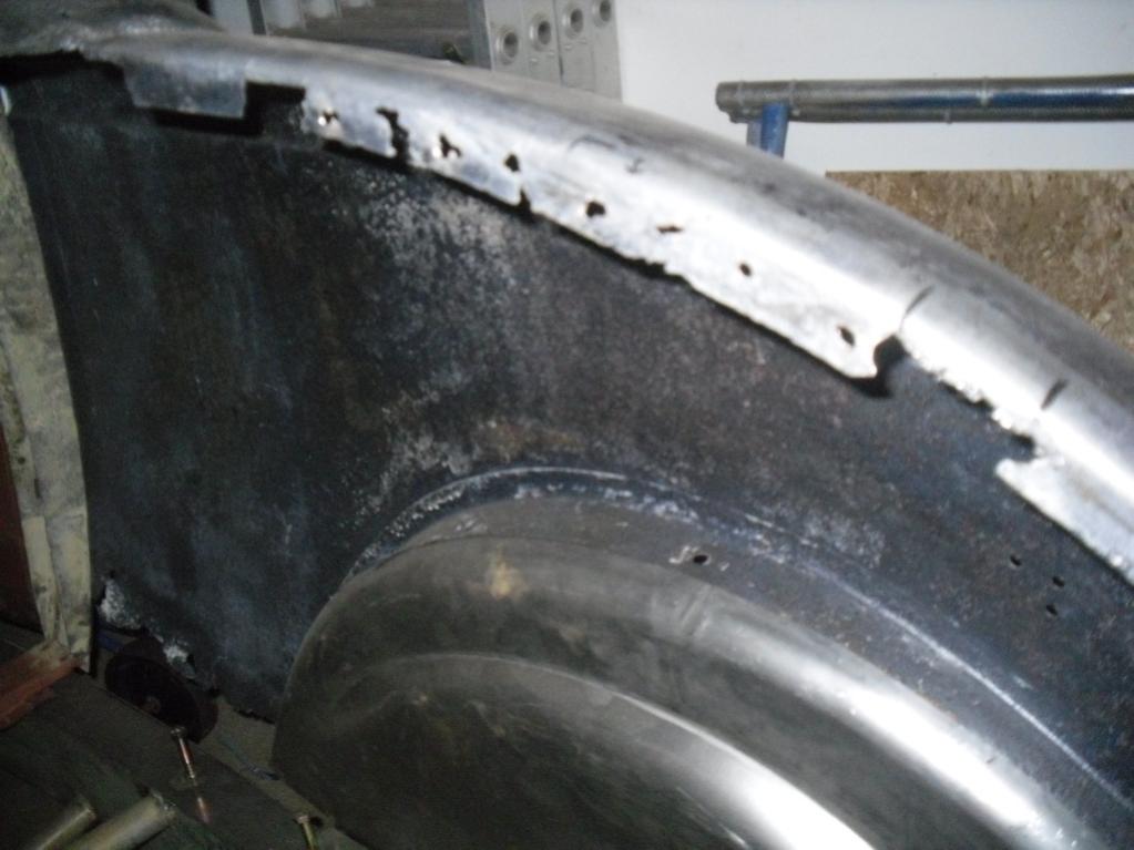

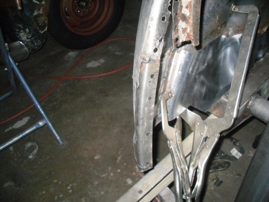

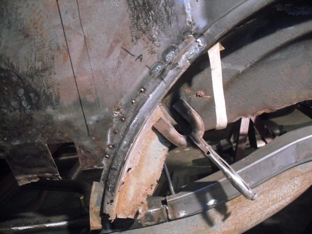

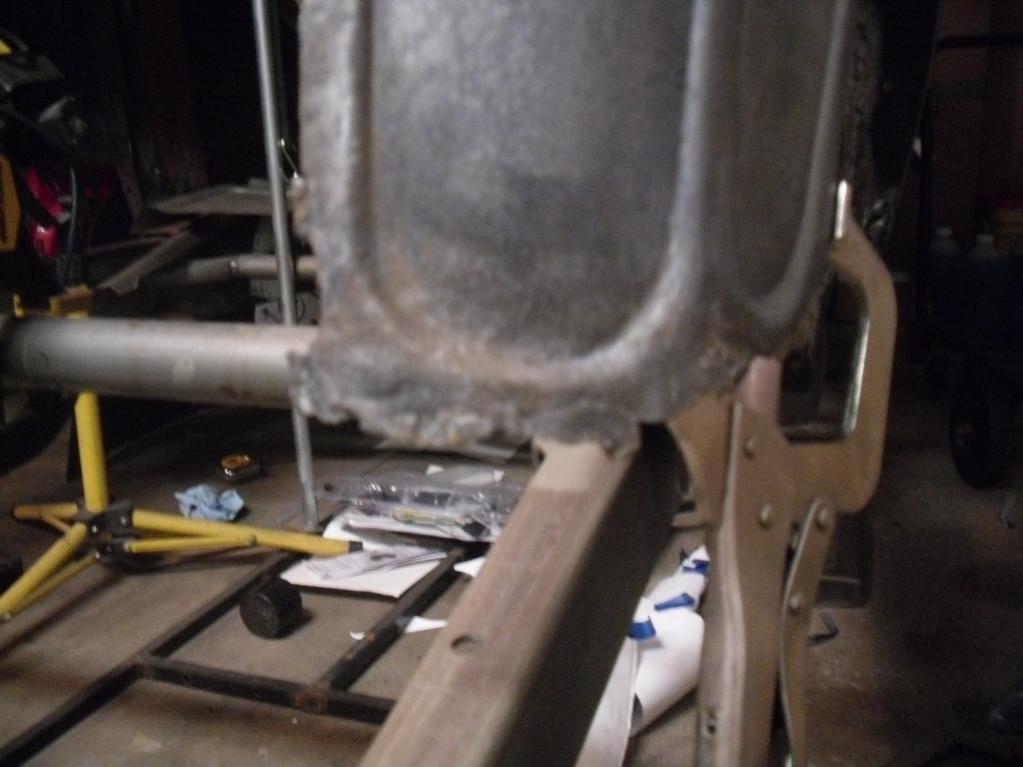

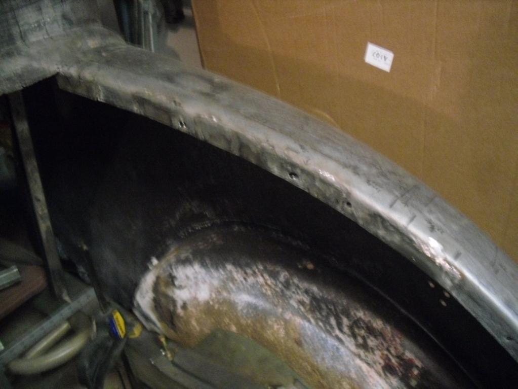

    I am going to jump around on the order of the work here a little (you'll see some work I have not posted on yet in the shots). One of the areas that was really bad was the inner qtr lip on the right qtr. Rus and a really bad repair had taken it's toll.
    I made a pattern of the curve on poster board. This allows me to keep the curve correct as I work the area. Much of the area was cut out and pieced in.
    I seriuosly thought about cutting the entire area out but was concerned about loosing the intergrity of the qtr.
    The last shots show a pull being made to get the qtr line straight. Something in it's earlier life had damaged qtr at the ridge. This squared things up.

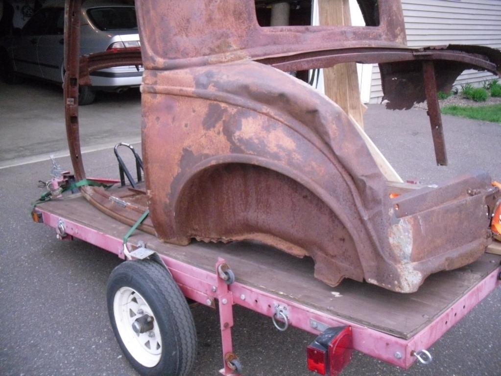

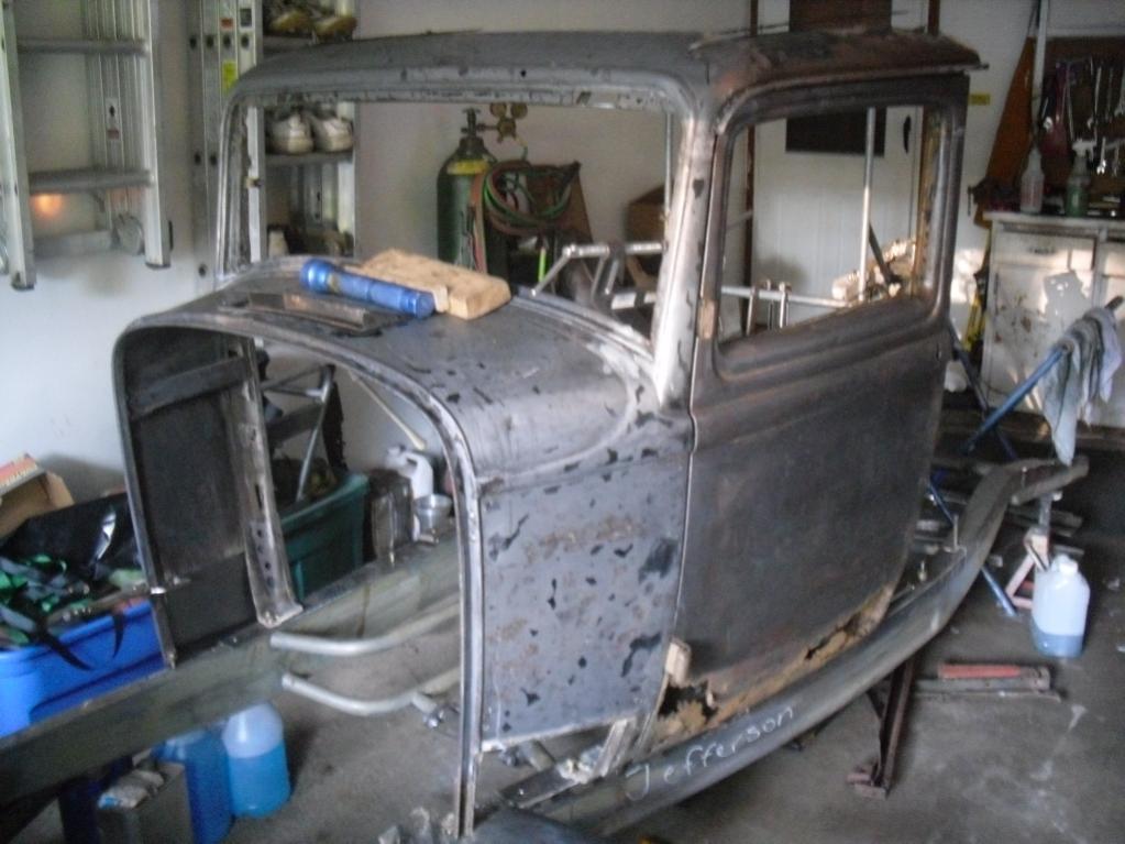

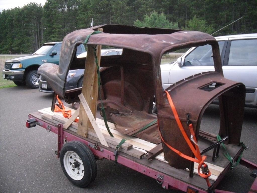

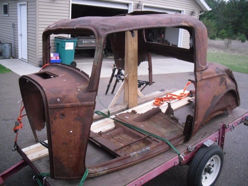

    Took a break last weekend to pickup my next project....
    obviuosly I need some parts...anyone have a couple doors, decklid and qtr for a 32 3 window?

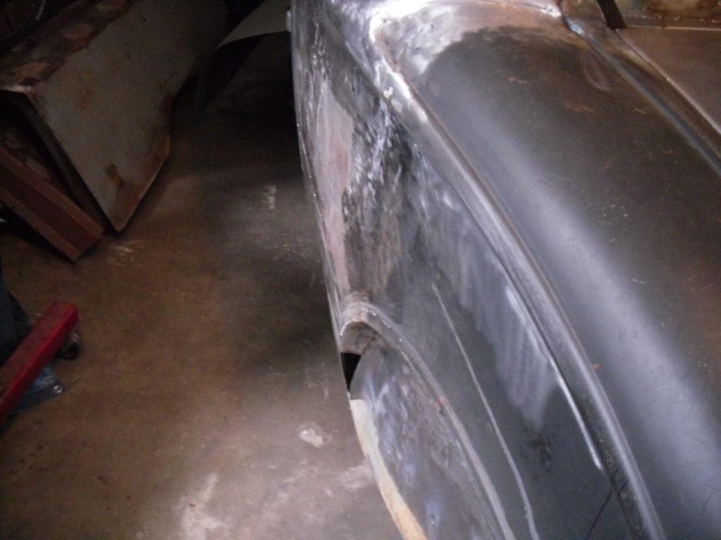

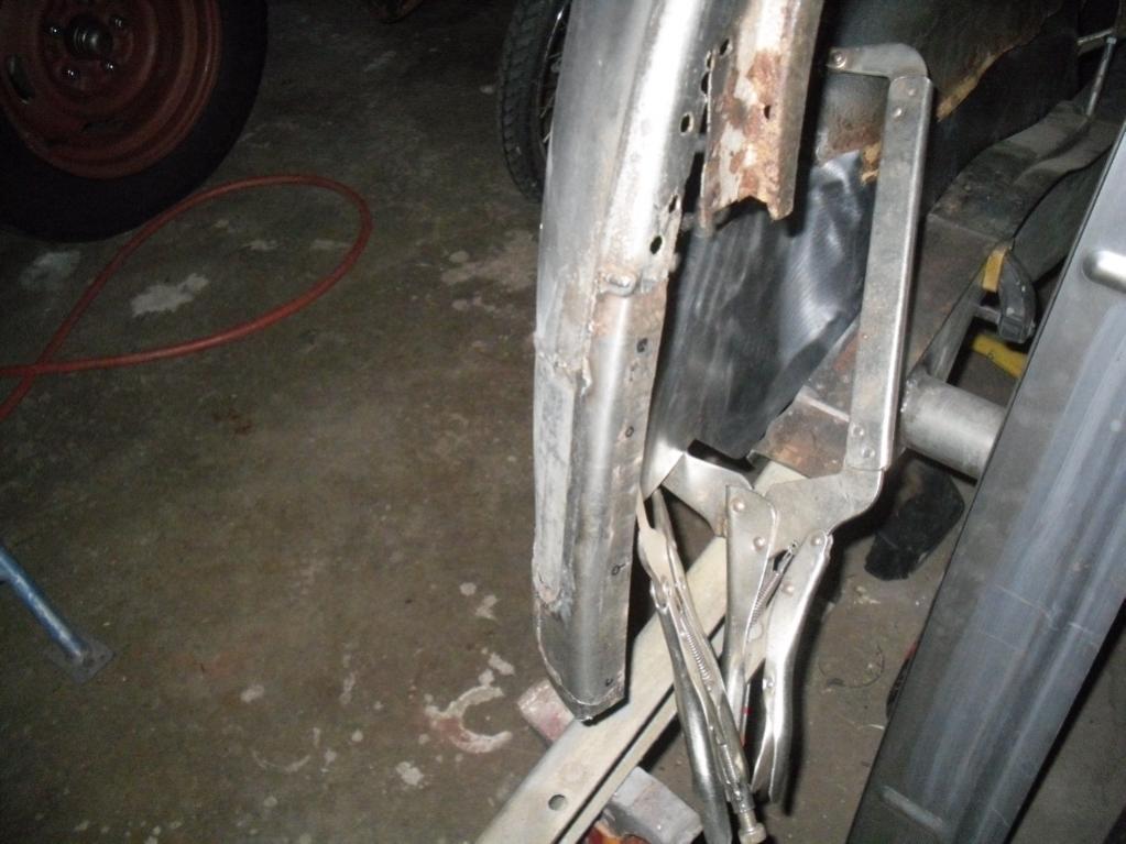

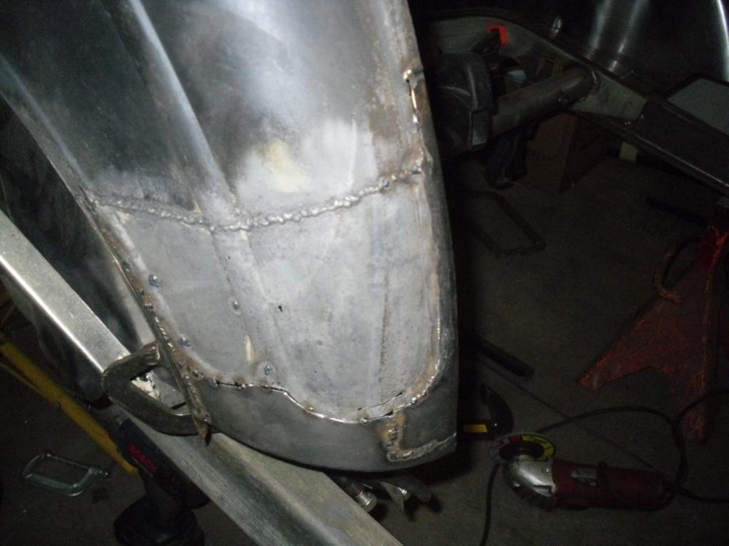

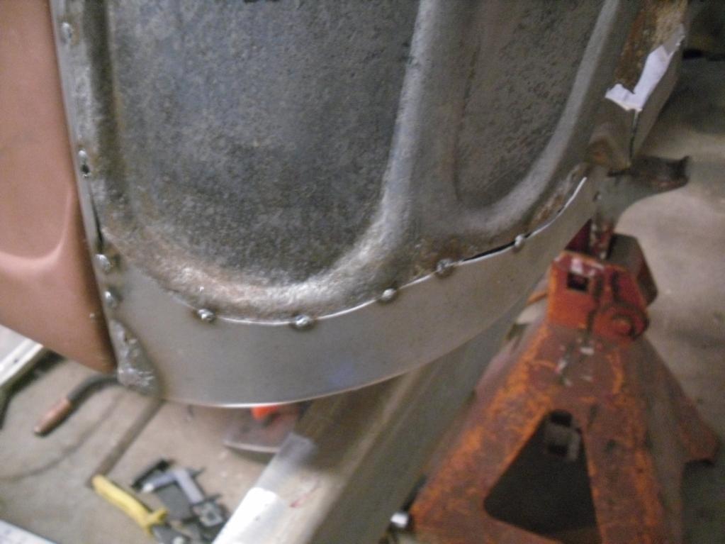

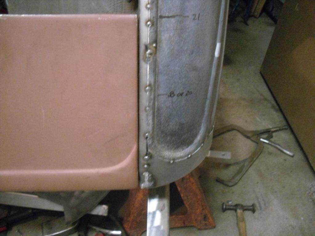

    Time for another update....Started repairing the ends of the qtrs. Boht the right and left qtrs are pretty much gone where the qtr attaches tot he lower panel that fits below the decklid.
  25. rcnut223
    Joined: Oct 12, 2006
    Posts: 1,282
    rcnut223
    from wisconsin
    A few more posts... final pic bolted together
