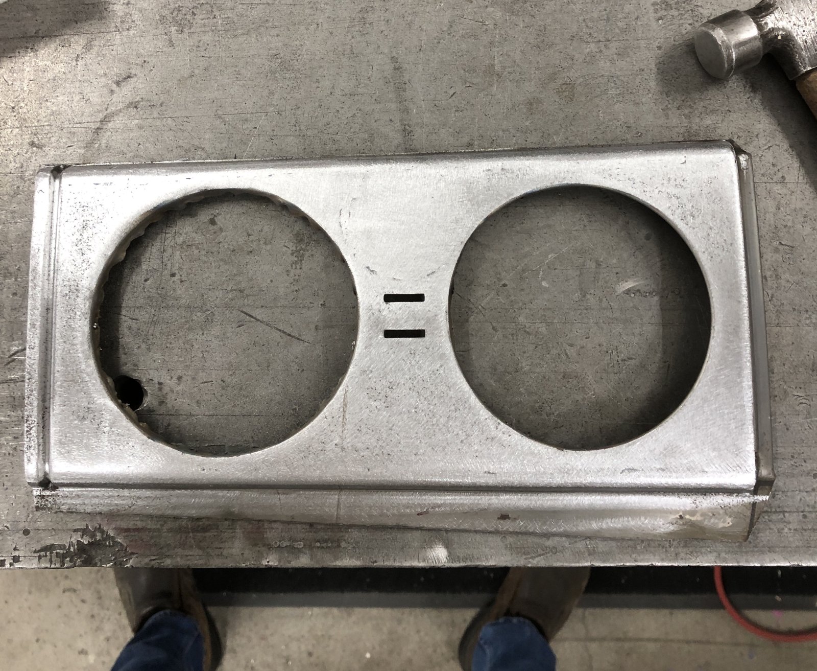

    This kind of a side thread that goes along with my 39 Ford Conv build. Progress is slow on the rest of the car, so I decided to tackle the dash repair so I might at least feel like I was moving forward. Here’s where it begins 8745426C-FA07-46F2-8AAB-E29B3986CC1B.jpeg In its earlier life, in the 50’s the owner added gauges out of a late 40’s or so Studebaker. 33A585CF-0E5D-4868-8EF0-6D6889F5936C.jpeg Make it fit however you can, right? They were not too kind to the dash. DE365546-A608-4F2E-8F39-243C5A3C608B.jpeg
    No problem. Just hammer out as best you can and find a donor piece to repair the damage. That’s where the fun begins. The convertibles and woodies had a different shaped dashboard than the open cars. These tapered from the inside edge of the gauge area out to the vertical line on the left side of the gauge holes. Same shape on the glove box door also. Well as you would expect, a donor piece from a Conv dash is not easy to find. So, I snagged the gauge area from a closed car dash from a fellow HAMBer and proceeded to make it fit. B9A3FA04-E4E8-427C-AA65-C9E82082B632.jpeg 61F33136-4A6A-4111-A2CA-EE7CFD208E6B.jpeg This was real fun, prying the lip up to remove the gauge mounts. It had to be removed so I could cut a wedge shape piece out to create the taper needed to make it fit. B6C60745-BF08-4F51-9964-25DAA406477C.jpeg 8257F9B1-B44F-4B48-9330-F6E86E828A1F.jpeg 0F9BA818-AEC0-4BF0-BCBC-E3B21981DA86.jpeg
    After tacking and then welding it up, I proceeded to smooth it up before making the transplant. 903E671F-BB74-4C6A-9507-7CFF82B77669.jpeg FA639FF2-88C1-4CC0-9CDC-52D999B5EB66.jpeg 7ADA058B-4A9C-4428-AEE4-31F793BE0D7B.jpeg 5FD1A0F8-2E43-4D72-A7CE-C7DE1DD27433.jpeg
    After careful fitting, I welded it up and started the finish work. That’s where I had to stop for the day. I’ll follow up after I get it all smoothed out. I did fail to get good pics of replacing that gauge mounting panel. That was not much fun, but all part of the job.
