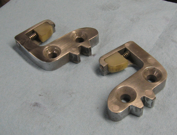

    The door latch mechanisms were in pretty good shape. They just needed some clean up
    and a new coat of lithium grease.
    The strikers pretty ugly. The drivers side one had suffered some abuse due to a misaligned door.
    Patience ,steel wool, files, sand paper and a buffer made for some better looking pieces.
    Don told me after I was finished with these that he can order a new one...... I think he will replace the drives side piece.

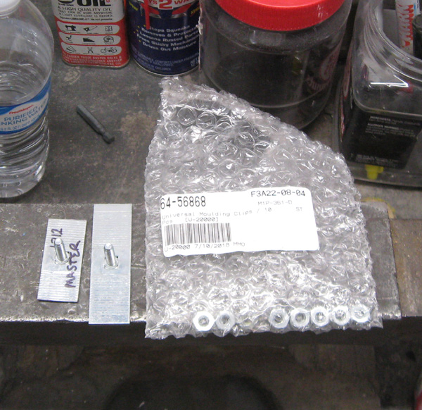

    Nice chrome molding clips. Do they have sections that can be removed? It looks like they are grooved so you can shorten them.
    1947knuck likes this.

    Not to hijack their thread, but I have used those clips, or tried to. That's exactly what they are. Problem I saw was I thought those "break off" indents left the strip too weak. Probably just me.
    Nice to see they survived all those hours of buffing........it's a dangerous job, but one with very gratifying results when the stuff ends up looking like theirs.

    The clips do have shallow grooves or indentations. I think they are more useful for allowing accurate/equal cuts to be made while shortening them to fit your application.
    I ended up cutting the clips to size with my dremel cut off wheel. I don't think they would break off all that easily. Speaking of dangerous, Don bent the final/last piece of interior stainless about 45 degrees off square. We straightened as best we could and figured we would have to live with it. Fortunately we had a friend that attends the local swap meets looking for some parts for us. He found a great source for 54 Mercury parts that we wish we could have known about earlier in the build. We made the 3 hour drive to check out his stash of parts and came home with a replacement for the piece that had been bent and several other treasures. If any of you are looking for 53/54 Mercury parts I would be happy to send you his info if you send a PM. He has an attic full of parts including body panels.

    It's time to install the stainless trim. We tried using the plastic push in clips using a piece of aluminum
    but the plastic pieces would not hold the stainless tight to the body.
    Don found these universal clips which I had to cut down to fit the trim. They worked well. [​IMG]
    There was one clip location on each fender trim that we had to use the plastic clips because there was no way to get a nut or wrench on the clip inside the fender.

    Here is a little project I had to to. Both of these kick panel weather strip clamp gizmos were rusted out at the bottom. I couldn't convince Don that we could do without these things so I had to fab up a replacement for each end.
    Each part required several steps and the ****nal of metal shaping tools.
    I could not figure out a process for putting the small curve at the outside pinching edge.
    But I was able to duplicate everything else with reasonable accuracy.
    I clamped the original section to some sheet metal and marked the curvature before cutting
    off the old rusty section The I clamped the new section to the steel plate and welded them
    together.
    Not perfect but it should do the job. This was another time eater that I avoided doing for
    a long time. I am glad it is behind me.
