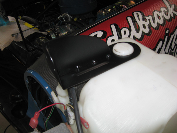

    Since Don is a no billet guy I searched the pick and pull lot in Spokane and found a suitable
    overflow tank and windshield washer reservoir for the Merc.
    Both items needed some brackets made to mount them. Notice this window washer
    tank has a built in pump. I got lucky, the pump still works.
    The reservoirs fit nicely on the drivers side.
    Yes, they are not plumb but will work fine.

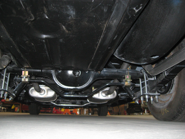

    Hauled the car to the muffler shop last week. Only took the talented young fella three
    hours to install the system with a crossover.

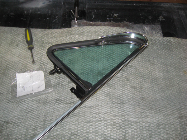

    The front window garnish went in without too much fiddling.

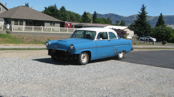

    Well I don't know how to do video's so a few pictures will have to suffice for the first drive.
    Backing out.
    Return
    A happy Don after several years of work. The first drive resulted in another list of things
    to fix and modify but at least it has been driven.Stay tuned as we still have a lot to cover in
    the coming weeks.

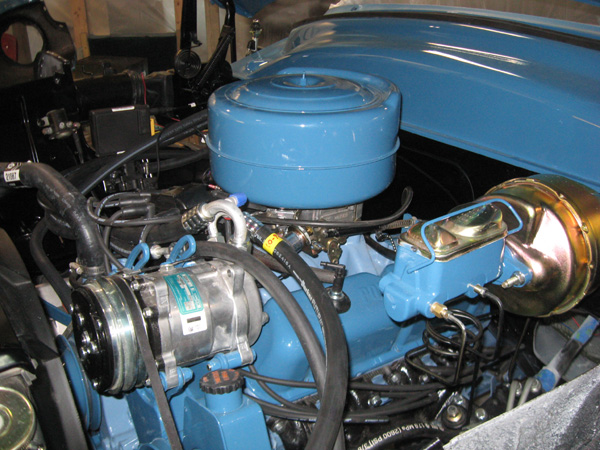

    Crayons
    I like your air cleaner, but how does it get air. .?

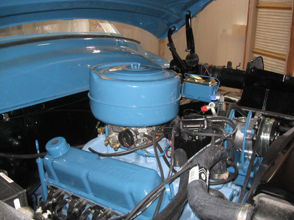

    Crayons, the oil bath is now just a a cap over the air filter. Construction of the filter was covered on page 8 post 229. Finish pictures were shown on page 9 post 250.
    It''s now just a lid or cover.
    The air has a lot more room to move to the filter than it did in the typical oil bath
    configuration.
    The only potential problem I see is that the air will be drawn from the top of the motor
    which may be a few degrees warmer that if it was drawn from the top.

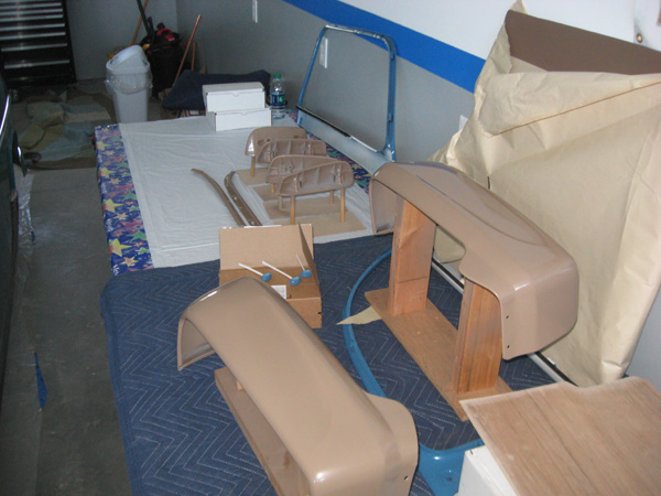

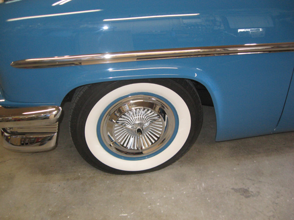

    The new WW tires from Diamond Back came in
    Wheels are painted

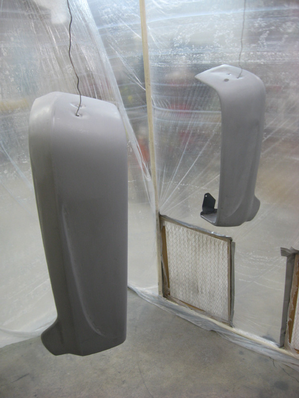

    This grill piece was originally chrome but Don wanted to paint it body color. So we had
    to do a little fine tuning before it was painted.

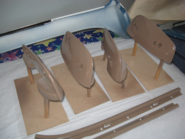

    I made up some stands to hold the arm rests for painting.
    These front seat valances were in pretty good shape but we did a little body work
    on them and removed the old sound insulation.

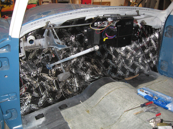

    I put some dynamat in place of the old sound insulation.
    We had to use a custom mixed enamel for the interior parts.
    Here is not so good picture of one of the interior cards. We took so long getting the car
    running we lost our place in the upholstery line so it will be awhile until the seats get done.
    Squablow, brEad, Texas57 and 3 others like this.

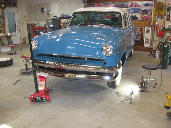

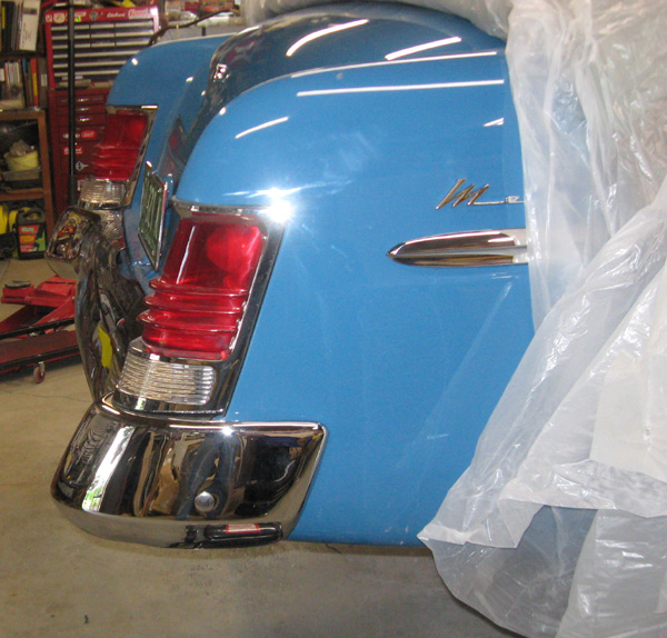

    Once the painting of the upper valance part of the grill was done we were able to ***emble and install the bumper.

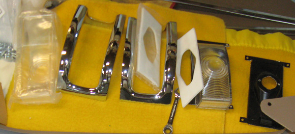

    The parking light bezels were rechromed and new lenses and pads were sourced
    The old light bases were bead blasted and painted

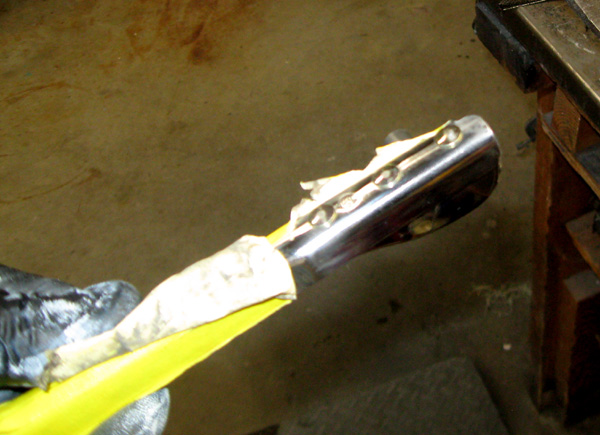

    This one did not have a clip to hold it place so I made one.
    1/8" rivets hold the clip to the base.
    There is just one bolt and the clip to hold this light ***embly to the bumper

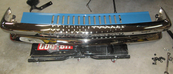

    The bumper ***embly is sturdy and a bit of a puzzle to ***emble.
    The ***embly really isn't all that heavy but it was awkward to handle. The clearances around those
    flanged pieces on the bottom edge of the front fenders is pretty tight. we ended up removing
    them temporarily while we installed the bumper so we would not scratch them.
    The jack and a delicate balancing act allowed us to get the bumper in place.

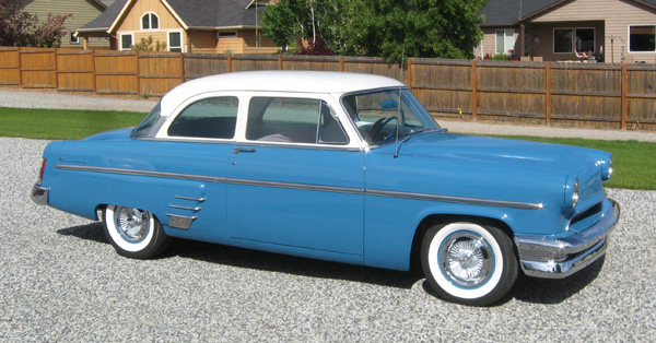

    There it is.
    Looks pretty smooth and not quite as heavy as the bumper with stock bumper guards
    and emblems as seen below.

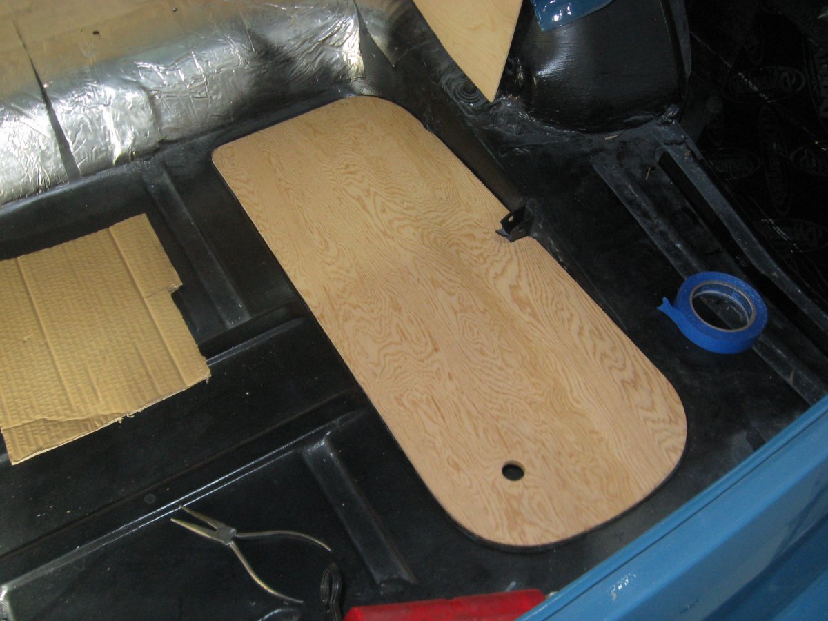

    After some time off of Don's car to work on some other projects around here we started out working on upholstery for the trunk.
    I made this plywood cover for the spare tire area. It is made from 1/4 inch plywood on top with a piece of 3/8" plywood laminated to the bottom to reinforce it. After a few weeks of crawling in and out of the trunk I would say it is stout enough. IMG_4457.JPG

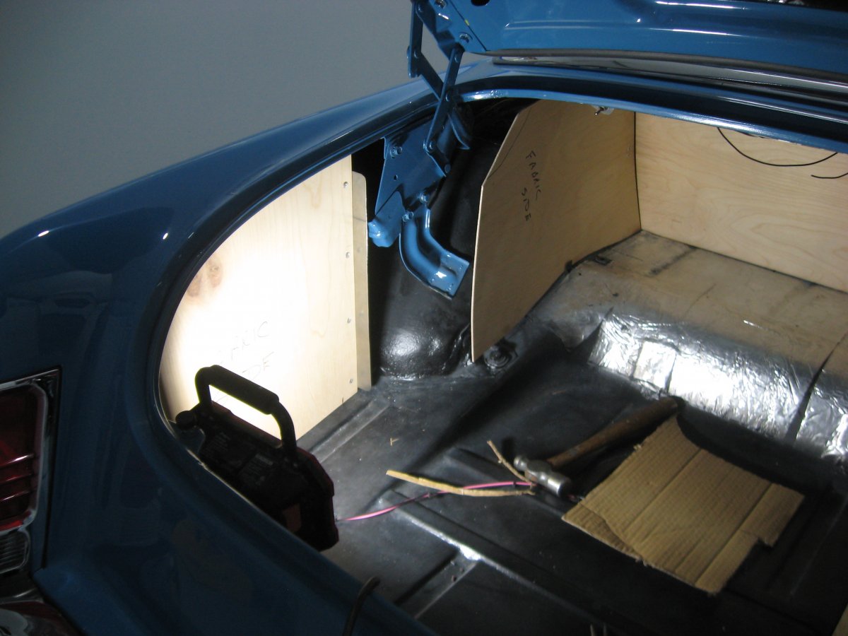

    The wheel well and trunk hinge area create a challenge here. We wanted to make the panels removable for service. IMG_4465.JPG
    After some cardboard templates were built to get the panel shapes correct we advanced to 1/4 bender board. The bender board turned out to be not all that bendable, so Don formed some sheet metal to support the board in the shape we needed . The bender board was soaked in water before bending. One of the boards split during this procedure and had to be replaced. Velcro is used on the vertical metal flange to hold the bent panel to the rear panel. IMG_4468.JPG
    Anvils come in handy for many things around the shop. You can see here that the panels were riveted on to the bracing with 1/8" rivets. On the left side of the picture you can see some tabs riveted on to the end of the board. These tabs are inserted into the back seat wooden bulk head. IMG_4469.JPG
    Two panels were made for the rear to fit around the gas filler protrusion. IMG_4470.JPG
    A position not easily achieved for a guy in his 70's. Don is pretty flexible though. I think he is awake here. Perhaps he is considering some speaker installation issues.
    The gas filler area was filled and smoothed with some layers of 1/4" foam before the material was glued on. IMG_4483.JPG
    Don took the panels to the upholster whom installed the fabric over thin foam. That spare tire hold down bracket was removed shortly after I took this picture. IMG_4498.JPG
    Covers were made to fill the gap at the hinge.
    A little more insulation and carpet and it should look pretty good.

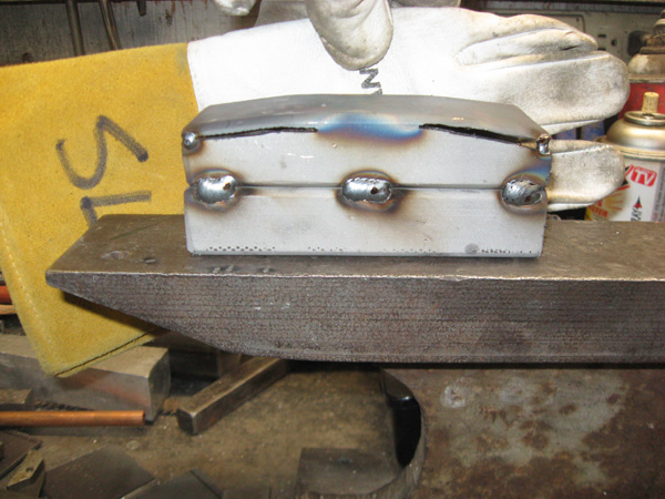

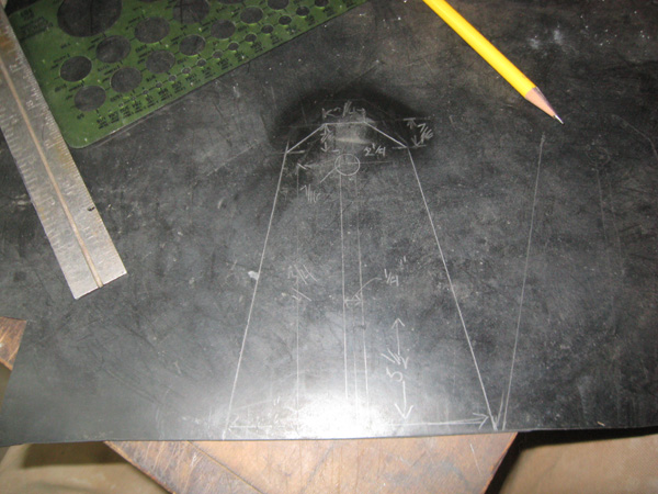

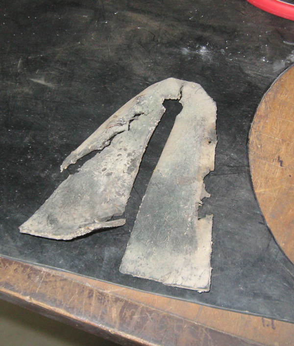

    Well it's time to wrap up this thread. Don put the finishing touches on the car this week and we are on to the next project. I have a few things to show you before we sign off though.
    One of the seat back stops was missing and the other was worn out so I fabricated some from
    high density plastic.
    The wooden round stock used for a handle made the project a little easier to do.
    You can just see the stops inbetween the seat base and seat back.

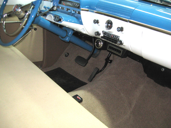

    More dynamat and some floor insulation Don got with the carpet kit.

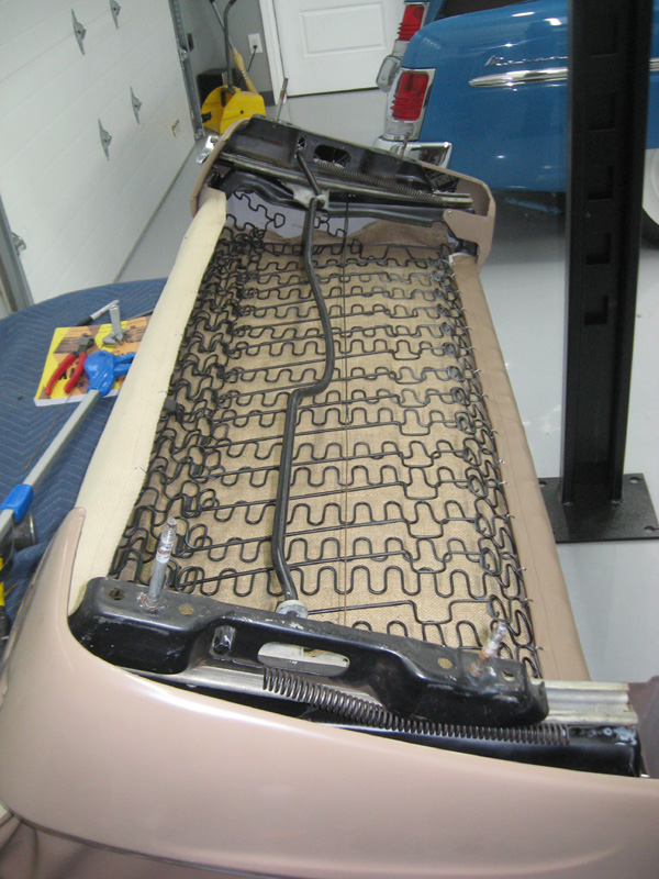

    It took a little while to figure out how to install the seat adjuster bar. It sure is nice to see
    this stuff so clean and new looking after dealing with the rat infested parts Don started with.
    New door card and Don installing the 3 point seat belt.

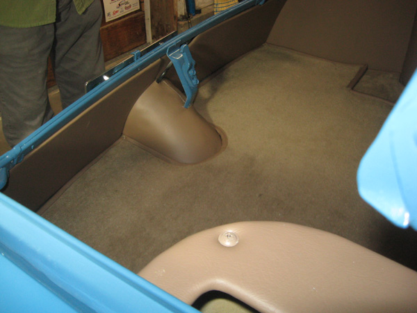

    The carpet kit was not a good fit as delivered. It needed a lot of padding under the transmission hump.
    Don ordered some carpet for the trunk that matched the interior. I couldn't find a picture showing
    the rounded corners this fabbed steel plate is covering up.
    After welding the two panels together it was screwed don to the trunk floor. We had to be careful

    So the reason for installing that plate was so that we could make a nice straight drop over
    the edge without having to conform to the rounded shape of the trunk floor in the corners.
    One of our club buddies sewed the edging on the carpet to finish off the trunk project.
    Don glued some vinyl to the trunk lid. There was enough room to tuck some vinyl
    under all of the edge flanges.
    While test driving the car we discovered that the drive shaft would rub on the drive shaft tunnel.
    This usually occurred when under torque load with my additional weight in the car.....
    To fix this we did three things. First we raised the rear end by about 1 inch by wedge cutting the
    two inch lowering blocks.
    next we added spacers under the rear axle stops. I didn't have any two inch so we welded
    two block together for each side and cut the top one to the contour of the frame.
    I eventyly added caps to each end of the spacer blocks.
    The next concern was spring wrap so new spacers were made for the stock spring snubbers.
    This trio of modifications fixed the problem.

    After a two or three weeks of cutting and buffing the paint and a front end alignment the
    Here she is ready for miles of smiles!
    It only took us 4 or 5 years to finish this thing but we are pretty proud of it.
