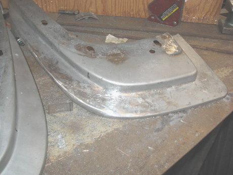

    We have been working on fitting the front sheet metal for a couple of weeks now. It has been pretty frustrating but we are getting closer. It seems like every inner fender panel needed to be straightened and or rust repaired.
    This corner was sticking out too much so I made a relief cut.
    Hammered it over and did an ugly mig weld.
    Then metal finished it.

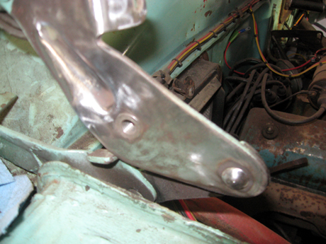

    A view from inside the air intake/hinge bracket.
    We needed access to the riveted hinge bracket pin.
    So we used a hole saw get access.
    The pin hole and the pin were worn out so I decided to make a new system to secure the arm. I turned this nut on the lathe.
    I drilled the arm .562 dimension and inserted the new nut.
    Engine side. Note that the air box hole was drilled out also.
    I machined this piece to go in the airbox hole. A 3/8-16 bolt pulls the hole thing together and the hing arm no longer wobbles.
    H ere is a neat trick that Don taught me on or last project. If you going to be removing your hood springs extend them all of the way out and insert washers in between the coils before your remove them. Then when you are ready to put the spring back on you don't have to try to stretch them out as they are installed.

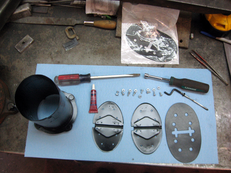

    Well it has been quite awhile since my last post. We have been busy on the car mostly working on the front end sheet metal. I will try to catch up on that in the next couple of weeks.

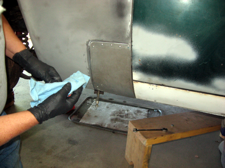

    Here is a little side project I worked on off and on over a few weeks. This is the p***enger side air duct. Although Don is going to put AC in this car he also wanted to maintain the outside fresh air option. Since the old heater will not be used I cut the the tee fitting off.
    The heater T will has to go.
    Cut and bent a patch.
    I used clear plastic to make the pattern for the patch.
    The valve seal was shot. Don bought this seal kit from Dennis Carpenter. The old seal was sandwiched between two steel plates that were stapled together. To get the valve out you must first pull the shaft out from between the plates. It came out easier than I thought it would.
    I cut the staples with my dremel tool cut off wheel and then carefully pried the the plates apart.
    I placed the new seal on the cleaned plate , marked it for the new bolt holes. center punched them and drilled out on the drill press.
    Everything cleaned and ready to go together with the tools I though I would need. The tool selction changed considerably as I went along.

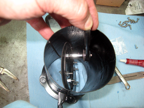

    I chose to insert the shaft first and ***emble the seal inside the tube.

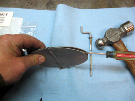

    The kit supplied slotted screws which proved to be very difficult to work with inside the tube . Even this bent screw driver was hard to work with.
    After ***embling the unit the first time I was unhappy with the results. The shaft wanted to turn within the plates making for inconsistent valve operations. So I bent this little sheet metal gizmo .
    The gizmo was placed on the shaft over the flattened part of the shaft.
    This shows picture shows the gizmo between the valve pieces before adding the rest of the screws to the plates.
    Since the slotted screws were such a pain to use I switched to some stainless ****on head allen screws. They worked much better. I used some lock***e 242 on all of the screws. No lock washers were provided and since the rubber will probably shrink over the years I thought the lock***e would hold the nuts in place despite the shrinkage.
    Well there it is. Be careful to make sure the shaft lever is in the correct orientation for proper valve opening and closing before you bolt the sections together. Don't ask me why I had to make that comment.
    The screws appear to be kind of long once the thing is ***embled but you need all of that length to get the nuts started during ***embly. I don't think the extra thread will create any problems with air flow.
    loudbang and Rui like this.

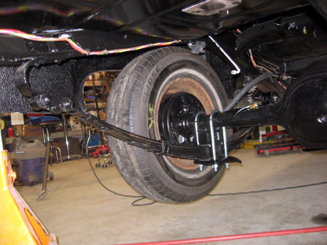

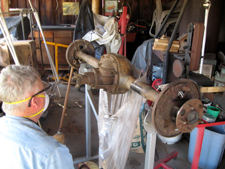

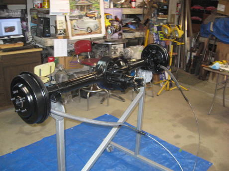

    Don found an 8" rear from Mercury Comet to use in the Merc. The housing was well preserved by copious amounts of grease and dirt. The ac***ulation was removed by hand and then sand blasted once the grease was gone.
    Because the OD of the 8" is so small and the original Mercury springs so narrow we could not find a pad mount that fit or needs.
    Of course the spring pad mounts were the wrong size and location so we had to make new ones. We started with some 2 x 3 x 3/16 tube. The center hole was drilled on the drill press.
    I got out the wrist breaker Milwaukee drill and clamped the piece in the band saw vise and carefully drilled out. I was lucky...no broken or sore wrists from this step.
    I rolled the tubing over to drill the other side.
    I cut the tube to length on the bandsaw and then cut it down the middle with the sawsall.
    We determined that we needed a little more thickness to the bottom of the bracket so I cut and welded a piece of 1/4 inch pate to the bottom of the bracket.
    Don wanted a 3 degree setting on the rear end so set it up and carefully welded the brackets on. I made short beads and allowed the parts to cool between welds .No distortion of the rear was noticeable.

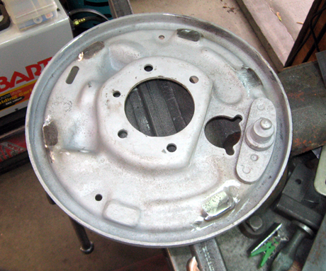

    The backing plates had some grooves so I put some weld metal on the pads.
    And ground them smooth.
    We had trouble finding U bolts that would work with the mercury axle tube, spring and the plate so we decided make another modification. We heated up some 1/4 x 1" strap.
    Then formed it around the rear axle tube.
    Test the U bolt fit.
    The spacers were then cut down and welded to the axle tube.
    New brake kit and brake drums were installed along with new bearings and seals for the axles.
    Don wants to drop the car 2" so we made some spacer blocks. I drilled the 2 inch tube straight through on the drill press. I then machined some dowels to insert in the top of the spacer that will index with rear axle spring pads.
    I put a couple of tacks on the pins.
    Some sheet metal was cut and welded to cap the ends.
    A little sanding with the flap wheel and they are ready for paint.
    This stand sets the rear end at just the tight height for old guys to work on them. I included plans for this stand in my 40 build thread.
    Don is really good at this brake line stuff.
    We inserted the rear end in on the jack and twisted it into place with little trouble. The springs have been cleaned and new bushings inserted .
    Installed with spacers.
    She is back on her wheels for the first time in several months. The car does not look much lower than it did when Don brought it over last fall but we have removed a lotof the weight from the car since. I am sure it will drop down some as we put parts back on. Don is still considering his options for dropping the front end.

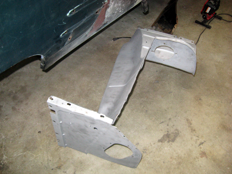

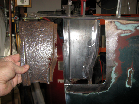

    Drivers side fender repair. Picture heavy as usual.

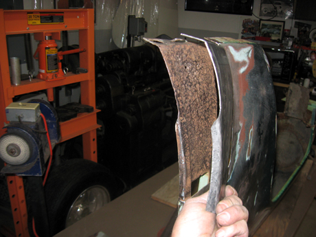

    Inner structure is rusty.
    The outer skin is gone and we could find no patch panels for this section.
    Marked off the damaged area to be replaced.
    I tried to pick a spot for the cut that would allow me decent access to the back side of the panel.
    Spot welds were located along the trailing edge at theses locations.
    Outer skin removed.
    I supported the fender upside down on the table for easy no bending access to the work area.

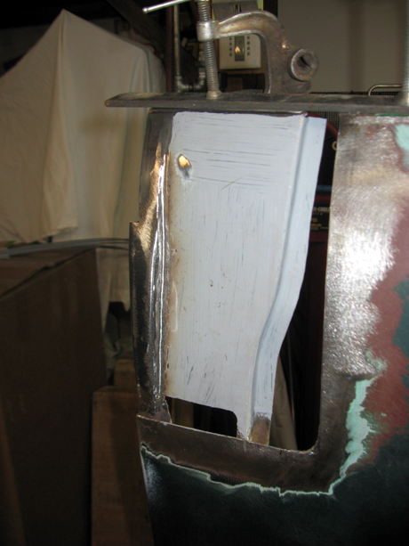

    I used some plastic garbage bag to make a patter of the old inner structure.
    The bead roller was initially employed to form the back edge.
    I clamped some 1/4" x 1" flat stock to the bottom of the fender to maintain the body line.
    I cut the old piece off and then clamped the new piece on with a piece of sheet metal the same thickness as body panel sandwiched between the new inner fender and 1/ x 1 bar.
    The leading edge of the inner fender support was bent to 90 degrees on the break and then formed with the shrinker stretcher and welded on.
    This leading edge shape is not very critical. You just have to keep it out of contact with the fender skin.
    The repair looked great at this point but the trailing edge just wasn't formed quite right. IMG_9542R.jpg
    Had to change the contour of this trailing edge.
    Formed a new piece for this modification.
    some sanding required.....
    Don wanted to continue with the glue on technique for the patch panel so we repeated the same steps as we had done on the quarter panels before.
    The backer panels were glued and clamped in place.
    I missed taking pictures of the forming of the outer patch. But it was basically hand formed over human body parts and various round shapes such as pipe and cut shape.We waited until we were finally happy with fitment of doors and front fender finalize the patch dimensions and contours before proceeding with the gluing process.
    The inner surfaces were roughed up with a 60 grit sanding wheel.
    Same with the inside. Note the screw holes were pre drilled to a larger dimension than the screws that would be used to clamp the piece to the body.
    Glue was applied to both surfaces and spread with a putty knife.
    The screws at the top and the clamps at the bottom were sufficient to hold the panel while it dried.
    IMG_9961R.jpg Don cleaned the excess glue off.
    The screws were rem0ved and the area prepped for some reinforced filler. The sight says I am out of pictures space for this post..... I guess that is enough show and tell for one day.
