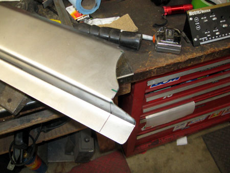

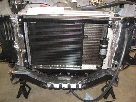

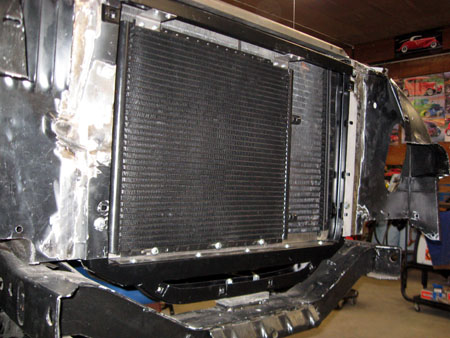

    That cross flow radiator install created another project..... The lower valance that goes between the radiator and the front bumper needed some modification.
    This recess needed to be extended 2 1/2" on each side.
    One of the easier projects. Simple layout.
    I guess I neglected to take pictures of the different steps on this one. I just cut out the original section and bent a new longer piece and welded it in.
    Wish all of the projects were this easy. That arrow just points to area that where a support rod goes. This area had to be rebuilt because during the wreck this area was basically punched out by the support rod. I flattened the area back out and reinforced it with a washer on the back side.
    That's all for today. We have been quite busy on the car lately and I am still behind on posts but I will be back soon with some coverage of the Alternator,AC comp and PS pump install.

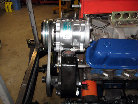

    Hanging the AC compressor , power steering pump and GM one wire alternator proved to be an interesting project. Unless you buy one of the very expensive billet systems for this the options seem to be limited. Also the possible combinations of engine configurations are beyond our experience as we both have spent more time working with SBC's
    The alternator was too difficult but the AC compressor took some head scratching and much modification of the bracket Don purchased.
    Fortunately I have an old lathe so we were able to custom cut the tubular spacers accurately and face them off squarely for good alignment of the pulleys.
    We have just tacked all of this together for now but we are satisfied that the system will work well.

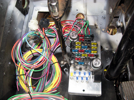

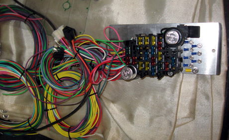

    Don bought an EZ wire kit for the car and we decided to mount it on a drop down panel like we used on my coupe project.
    I welded a piece of 1/2" square stock to the firewall after drilling and tapping it for some 10/32 screws to hold the short piece of piano hinge.
    With the panel in the down position you can see the ground terminals which are 10/24 screws threaded into the the aluminum base.
    In the up position the panel is out of sight and also out of harms way. It is held in place with a 1/4 x 20 screw that is inserted into the dash and simple plastic knob with threaded br*** insert. The 1/4x20 nuts ans all thread holding the fuse panel to the aluminum base will be replaced with allen head bolts during final ***embly.

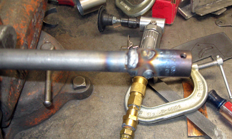

    Steering column and power steering gear install project.
    The power steering gear that is now installed in the car protrudes farther towards the firewall than the stock unit. We wanted to retain the stock column which is now too long. With lots of head scratching and measuring we came up with the following solutions.
    One of the last things we did is weld this smooth on the steering shaft side,Splined on the steering box side coupler onto the steering shaft. I showed you it first because it is a key element in why we did everything else the way we did. That coupler is stuffed up inside the column sheath and has just enough clearance to allow the shifter mechanism to work. We lined the column splines up at the steering wheel and the steering box as close as possible before welding, the final setting will be made when the front end is aligned in the future.
    This lower section of the column sheath was cut off .
    Four slits were cut in the column sheath to aid in tightening the bottom with the clamp.
    The rubber bushing or gasket was original equipment. The spacer ring was made to fill the gap between the the column sheath and the steering gear. 19 GA. I think.
    Spacer and rubber seal installed.

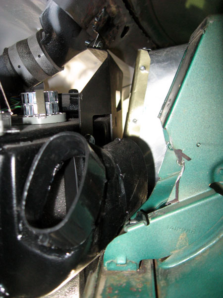

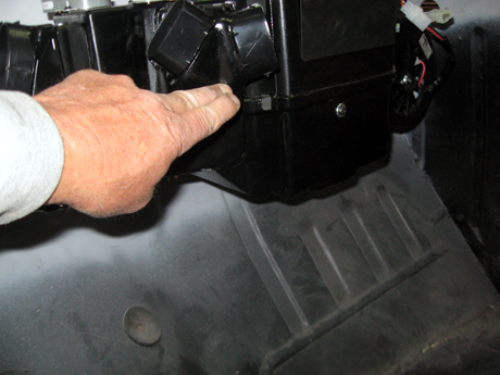

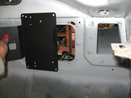

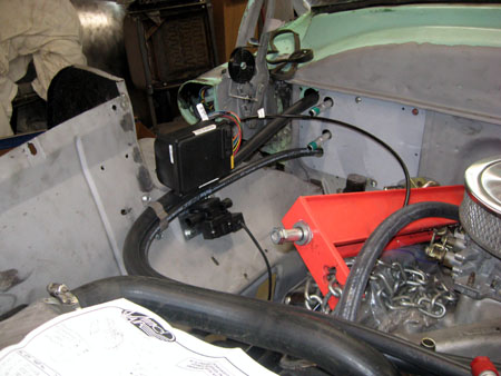

    Don decided to install a Gen 4 Vintage Air system in the Mercury. There is not a sure fit kit for this type of car so it took quite awhile to shoehorn this system into the car. I took a lot of pictures as we progressed through the install. Maybe it will be of some help to one of you in the future. Don was given some good technical help by Vintage Air in choosing the components.
    This bracket came with the unit. We chose to mount the unit in the original heater location.
    This flange was ground off so the bracket could sit flat against the firewall.
    The unit was mocked up.Yes it is pretty big.
    The first casualty was the ash tray. A little grinding took care of that.
    The glove box is also a casualty This area had to ground off also.
    This area had to be ground out to clear the defrost fittings on the unit shown in the next picture.
    The ground area.

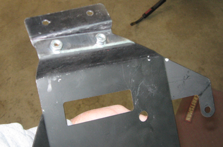

    I welded come 1/4 20 nuts on the back side of the bracket.
    A 90 degree bend was made in the bracket and then fabricated a bracket to attach it to the inside firewall .
    I recommend using this anti splatter stuff. It keeps all of those weld splatter beads from sticking to your metal.

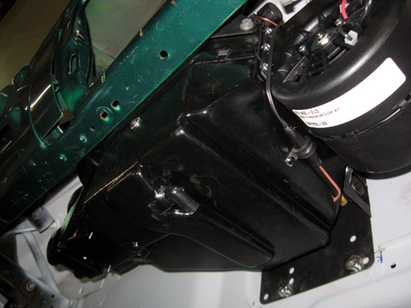

    The welded on nuts will make the install of the unit possible.
    The electric wiper motor and p***enger side linkage was temporarily installed to make sure we had clearance for the linkage.
    When we sure there was adequate clearance the upper bracket was welded to the cowl. IMG_1401R.jpg

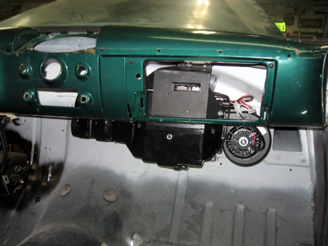

    It is mounted as close to the firewall as possible.
    So we think we can install a glove box deep enough to hold the registration and insurance papers.

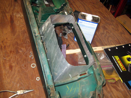

    We started designing the the new cover plate with a cardboard pattern.
    Clear plastic ( not shown) was used to figure out where to drill the holes for the fittings in the 1/8" steel plate.
    The screws on the right p*** through the firewall and into those nuts I welded on the bracket earlier.
    With unit securely mounted we could turn our attention to the plumbing and controls.That's next.

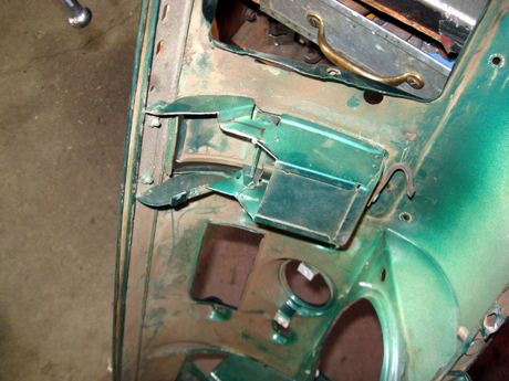

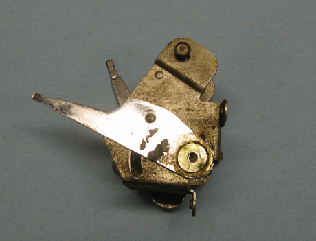

    As some of you may know these Mercury's have this weird control pod that extends from the dash below the instrument cluster. Besides making it difficult to come up with a suitable steering column (other than stock) it also presented us with an interesting project for the Air conditioner controls.
    At the risk of boring you to death and overloading you with too many pictures I wanted to show the steps it took to modify the original cable operated controls to work with the new vintage air electronic system. I realize AC is somewhat off topic on the HAMB but the reality is many of us find as we age that AC can make the difference in driving the car to a hot summer destination or considering the trailer or stay home options. The object of this install is to hide as much of the AC install as possible and maintain the original charm of the Mercury pod.
    The old cable control as found. You will see this side get modified extensively as this configuration will not work with the new control.
    We want to copy this side as it is just what is needed.
    Top view

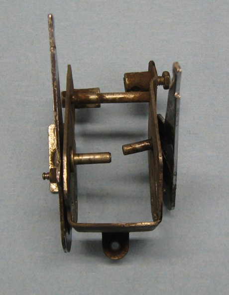

    Stripping the unit down.
    I chose to make a new bottom section(above).
    The handle portion was cut off and welded to the new bottom piece. Note a piece of flattened 3/4 " copper pipe was used to keep the two pieces flat while allowing me to weld the two together without welding them to the steel tubing they were secured to.
    Mostly metal finished the new piece is compared the original from the other side that was being copied.

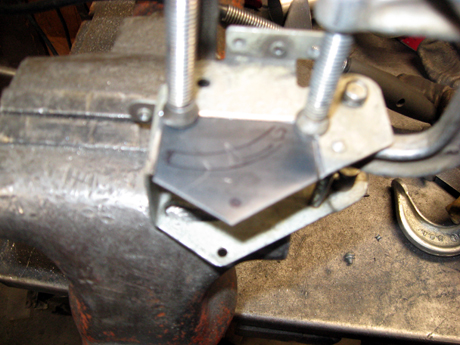

    Now the base had to be modified. once again I chose to make a new piece to insert into the old because they were so different in configuration.
    Clamped
    Welded in and marked for the new arched slot.
    I drilled the holes as close together as possible and then used a small dentist type pit in the dremel followed by a small file to finish the slot.
    Testing the slot and handle.

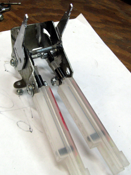

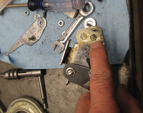

    The old cable clamps had to be modified. Notice they are at different heights. The ends were cut off and the height of the left clamp was lowered to match the right side.
    The clamp portion is cut off . This boss rotates in the the body and we maintained that function.
    Test fitting the new linear control .
    We thought we needed to move this spreader bar and did move it . We later discovered we did not have to move it.

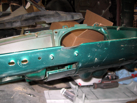

    The dash was cut to allow the controls to p*** thought it.
    This area of the dash pod had to be cut out clear the new controls.
    There was a little detente tab here that had to be cut off to allow the control arm to swing through it's whole range of motion.
    The modified ***embly
    The modified ***embly mocked up and ready for test fitting.
    Testing and adjusting.
    View 2.
    Rear view. The control wires plug into the ends of these plastic tubes.
    Note the tubes are sticking through the modified dash.
    Ready for knobs.
    Nylock nuts were used to secure all of the threaded stuff. The nylocks were also used to set the drag or resistance on the controls so that they will stay in the control position they are set to.
    There was one other rotary control switch that was installed for this AC unit. It was a simple install and I did not get a picture of it's install I will have to get some pictures of it later.
    So there it is another one of those projects that you would never think of after the car is finished. It will be out of sight and if it functions as it should everyone will think it is stock. Hopefully though by covering it here on the HAMB someone else can consider using the design rather than adding a extra control module below the dash.

    After a few false starts Don finally received his 19 inch fan, so we could proceed with the the fan shroud and condenser install. I think this fan shares a part number with a UPS truck fan;). That is to say it is big and should have no trouble pulling enough air to cool the Mercury.
    We had to cut the bottom out of the plastic shroud and fabricate this piece to install in it;s place in order to accommodate the large fan.
    The new piece was then riveted to the bottom of the shroud. Just a reminder this is the stock shroud that came form the donor mercury and is mounted upside down.
    We were able use the stock rubber mounts on the bottom of the radiator and wanted to use the upper rubber mounts also. So made a sheet metal cover that would incorporate the upper mounts while giving the radiator a finished look.
    We used the HF break to bend this 19 ga. sheetmetal cover.
    Some contour work to match up to the upper brackets.
    Clamped in place for tacking.
    IMG_1561R.jpg .
    Welded and finished ground
    Finished.

    With the radiator secured we moved on to the AC condenser.
    There was a 1 inch space between the bottom of the radiator and the radiator support. So we decided to make the bottom condenser support run all of the way across the bottom. This allowed the support to two jobs as condenser support and air dam.
    The upper support brackets were made from 18 ga steel.
    The drier was placed on the driver side. We then ran all of the hoses to make sure we had the right fittings and that the hoses could be secured neatly during final ***embly.
    Looks like it will all fit nicely.
    The cruise control and the AC hot water valve were mounted on the p***enger side inner fender panel.

    Since the cross flow radiator is 5 inches wider than the stock original radiator we lost some room for the battery. After some research Don found a battery dimension that will just barely fit in the stock location.
    Since it will be awhile before the battery is actually needed Don measured the battery as acurately as he could and I made up this cardboard version to use for fabricating a new battery box for this application.
    This is not the prettiest piece I have made fr this car but it should be sturdy enough and it mounts to the original battery box holes on the inner fender.
    More AC unit complications.... We needed an abbreviated glove box. I found some very thin aluminum s****. I believe it is a roof flashing material.
    Don made a pattern off of the worn out original glove box and made this replacement.
    The aluminum could be cut with scissors. You would think that it would be too flimsy but once it was riveted together and attached to the dash it felt quite strong. I think it is deep enough for a registration and insurance card (not much else). The aluminum will be covered with fabric to finish it off.
    It is kind of hard to see the clearance between the AC unit and the glove box here. There will be a multiple plug that goes into the slot in the AC mounting bracket so we had to leave a little room for that.

    Here is a subject we already addressed back on post 128 of this thread. It turns that we had the linkage upside down.So this post will cover the modifications to the C4 to modified 54 mercury column.
    Stock link arm.
    After much fussing over this linkage this is what we came up with. It did not work well. In fact we found that this transmission was set up for a floor shifter.
    After looking through the Lokar catalog we found this system designed for the floor shifter on a C4.
    Don having tight pockets as he does decided we would make one.
    So I turned a piece of round stock down to fit shaft of the shifter rod in the transmission.
    Some flat stock was bent to the required offset and an ajustment slot was made in the lower part of the arm.
    After trying the new linkage with the shift shaft while it was still in C4 the. Once we happy with the shift pattern,the transmission was hauled back to the ****** shop. George removed the the shift shaft and I aligned the pieces back to the match marks and carefully welded them together .Back to the ****** shop to insert the shift shaft .
    This time it took just a few minutes to get the column and transmission linkage to sinc with each other.
