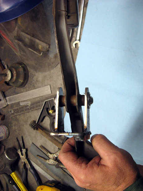

    We fabbed a bracket to support the pedal
    We had to add a shim on one side to make the peddle sit flat on the firewall.
    Not shown here is the stock Ranger throttle cable that was modified to fit the Mercury's application.
    This is the throttle cable bracket we made up for Ranger throttle cable.

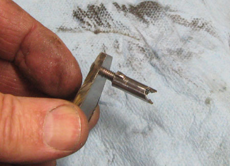

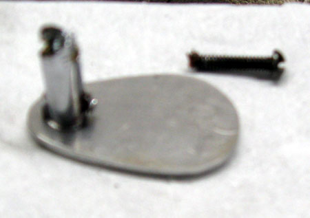

    We removed all trim from the trunk but Don wanted to maintain the stock trunk lock. The cover for the lock was missing though so Don did some research and found this cover for 55 merc.lock. Of course it does not fit the 54.
    It is a die cast pot metal piece. We decided to try to make a cover using the stem from the new piece and and a piece of 1/8" stainless plate.
    I traced an outline of 54 lock onto the stainless and cut it out with a cut off wheel.
    The stem was cut off the die cast piece and the plate and stem were tapped and threaded to fit a 6=32 stainless screw. That little bulge on the stem has to be aligned correctly so that the spring loaded cover opens and closes correctly when used.
    Sorry for the fuzzy picture. The stem was then tapped for a size 4 screw to be used as a set screw.

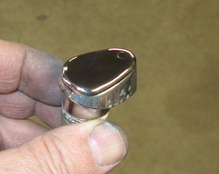

    After much grinding and polishing we end up with a cover new stainless cover.
    Once were certain of the clocking of the stem thread locker was applied to the thread and the set screw was cut off.
    Yes the end of the stainless screw shows but I think it will be one of those things you have to look for and if you are looking that close at the car I am alright with that.

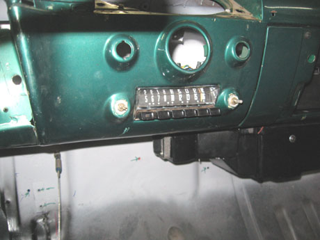

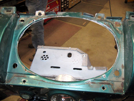

    Don chose to keep the original radio but have it modified so he could have the modern conveniences such as AM/FM Bluetooth and a USB port for a thumb drive or I pod. We had limited space to install this hybrid radio and it took some serious fabrication so lets get on with it.
    Don stripped the radio down,removing all of the old tubes before sending the unit off for it's modernization.
    This is what we got back. All of that fancy stuff on the right side of the picture is the heart of the radio now. It kind of reminds me of the way computers have been miniaturized over the years.
    This is the guy that did the modifications. It was very expensive to go this route. We tested the unit and it works as advertised. Due to some miscommunication we had to do a little additional wiring in order to provide some power to the power antenna. We used the wire for original dial face light to power the antenna and connected a new wire to the light that will be connected to the light circuit of the car.
    I think I showed this modification to the AC air manifold earlier. ABS had to be built to clear the modified radio.
    First test fit.
    The dash is clamped to a vise to make it easier to work on the radio. This clamp held the top and bottom plates in position while the paper patterns were fabricated.
    Thin cardboard was used to mock up the new steel housing panels.
    New steel panels were fabricated from the paper patterns.
    Some rubber vacuum hose was used to form a grommet for the wire loom.
    The radio came with an interesting speaker (stereo). The new speaker had to be mounted on the top of the speaker mount. (The old one was mounted below the mount). In order to get the new speaker to fit under the stock speaker grill.
    After trimming the speaker mount.
    The speaker now sits nicely in its modified mount. Notice the dual cone speaker.
    Grill installed
    A final view of the radio and speaker installed.

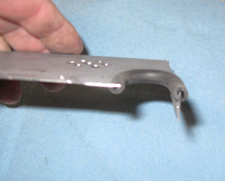

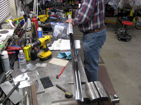

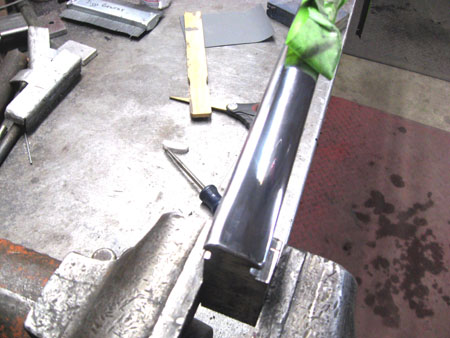

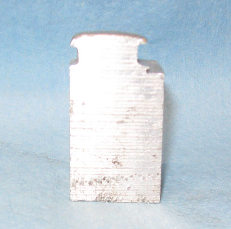

    Stainless Trim......Stainless everywhere, windows, belt line and Side panels. We just spent way too much time restoring this trim. But it should we think the end results will be worth it.
    I had this chunk of aluminum and decided to make a dye for
    forming the forming the belt line
    I used basic hand tools to form the die.
    I used this profile tool to to copy the shape of the belt line trim.
    The form ready to go to work. We only used this type of form
    on the waist trim. It worked well. The rest of the trim we found
    that using the smooth surface of the anvil to back up the hammer blows.
    We found that very little pressure is needed to move the stainless.
    I did not take any pictures but the hardest dents to get out proved
    to be the little rock chip type dents in the window trim. The rocks
    always seem to leave a deep pit at the center which is almost impossible
    to get out without getting the surrounding metal paper thin.
    This was the worst piece.
    The worst piece repaired.

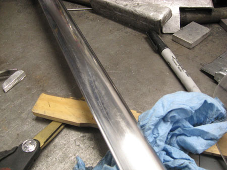

    We used all sorts of tools and polishing methods to get the
    finish back to like new.We used body hammers,anvil, tongue
    depressors,buffers with rag wheels tight, and scisle wheels
    with gray stainless steel compound and Lots of 600,1000,
    1500 and 2000 grit wet or dry sand paper. Lots of elbow grease.
    It took us about three weeks to get it all finished.
    I only took a before picture of this piece with a crease in it.
    Hours of this. Getting the work piece up where it is somewhat
    comfortable to work on is helpful when you are spending a few
    hours a day trying to get the shine back.
    Some of the pieces.
    Don wrapped them all up in news paper and stored them away
    for that day when the final touches will be added to the car.
    We thought the window trim was going to be flimsy and dangerous
    to polish on the bench buffer so Don spent a lot of time buffing the
    trim while it was still on the car.
    Turns out the trim is actually a T shaped extrusion and is quite sturdy.
    We ended up doing some touch up work with the bench on the trim after
    it was removed from the car. Doing all of this kind of stuff ourselves is one
    of the reasons why it takes us so long to build a car. We are always learning
    as we we go and having fun doing it.

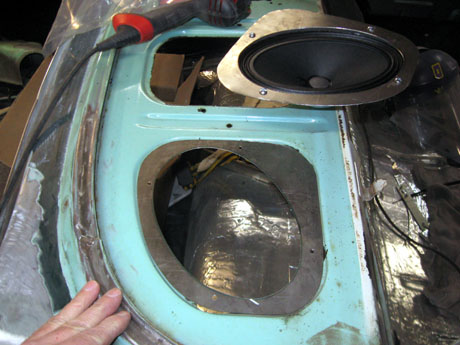

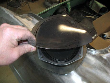

    Another radio project.
    19 gauge steel was used for these 6x9 speaker adapters
    I used some scrap plastic to make templates as usual.
    The speakers had to be mounted at an angle.The plastic was
    used again for layout and pattern.
    The speakers will be hidden under the package tray cover
    Don plans to not use a speaker grill but will punch a bunch
    of holes in the upholstery.
    I miked up some JB Weld to glue the inserts in place rather
    than weld them. I didn't want to weld them all of the way around
    and I thought they might vibrate if I did not weld them all the way
    around. It took quite a bit of weight to hold the to contour
    biggeorge and loudbang like this.

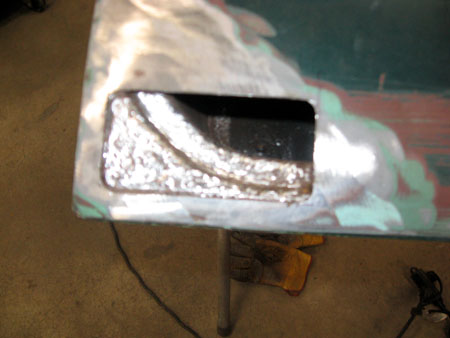

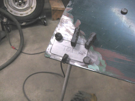

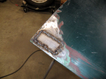

    Just when you think you have found and eliminated all of
    the rust..... Yep, found some more rust bubbles at the
    bottom front of the drivers door.
    That green template in the picture comes in handy for layout
    work. It has layout marks at 90 degree intervals that make it
    easy to mark your hole center
    I punched the rust bubbles with an awl so the rust spots show
    up better.
    I laid out a rectangle and marked it so I could drill some
    1/2" holes with a multi bit.
    You can see where the crud had accumulated and held the
    moisture to cause the rust.
    A little cleanup and a coat of rust stopper (not shown) and
    we are ready for a patch.
    A few trips to and from the cutter and belt sander and we are
    ready to weld. The magnets work well for holding a patch
    in the general area. Be sure not to weld too close to them as
    they will explode (Well fracture).
    Lots of spot welds later we have a sound but ugly patch.
    A little time with the right angle air tool with an 3 inch 40 grit
    disc and it's done.
