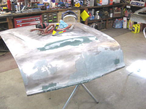

    Well we have been working steadily since my last post here in March. We got my coupe put back together and at is running good and shifts much better. After a much longer than expected recess for the 40 coupe we got back on the body work on the Merc.

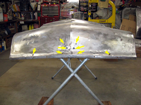

    This hood has been a serious challenge to us from the start. I think we have weeks of time into it by now, we should have tried to buy a better one to work with but we like challenges.

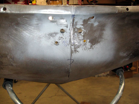

    Don wanted to run the 52 trim on the front of the hood which does not use the big 54 emblem so we had to fill some holes and re contour the nose of the hood.

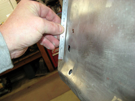

    Lots of big holes to fill

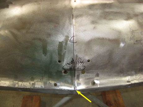

    The center line was also off a little so we had to move it over

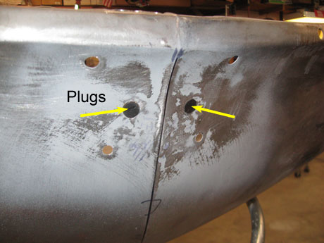

    We cut out some plugs for the holes. We used a slightly thicker
    metal for the plugs so they could be more easily ground to the
    surface.

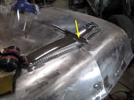

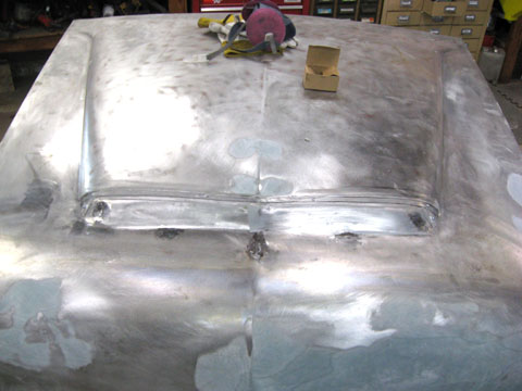

    Don decided to eliminate the scoop emblem also
    After much discussion and some experimenting with some
    clay Don decided to fill the holes and add some metal strips
    to reshape the scoop contour.
    The metal strips were glued on with the same adhesive that was
    used on the quarter panels
    Holes filled with steel plugs and ready for filler

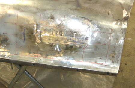

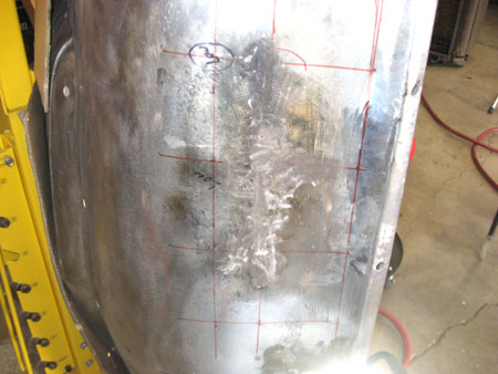

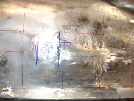

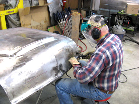

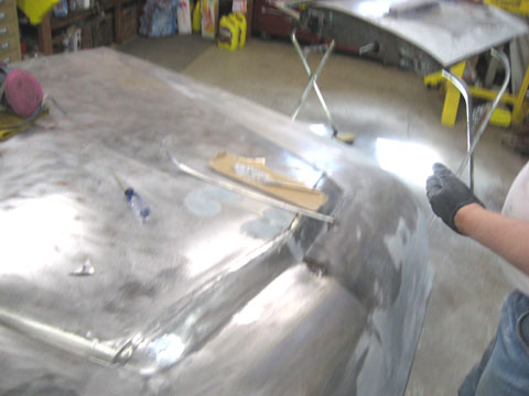

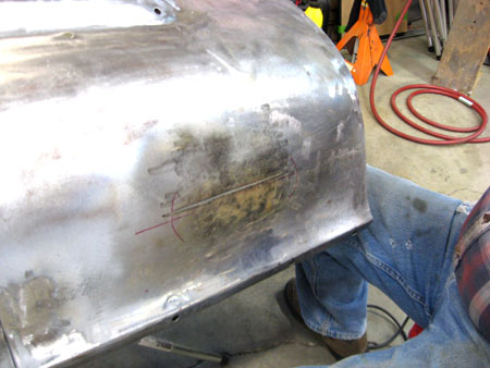

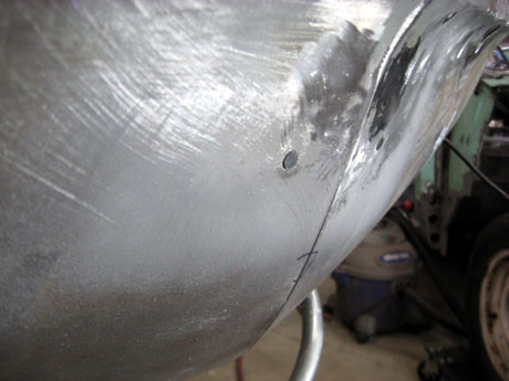

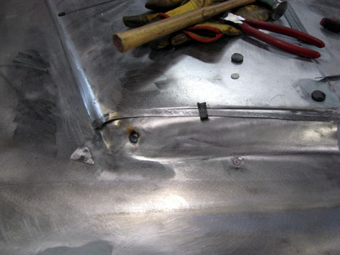

    The drivers side front sheet metal of the hood had been
    stretched to a point that we could not shrink it enough
    to get it to contour. So we decided to make some cuts

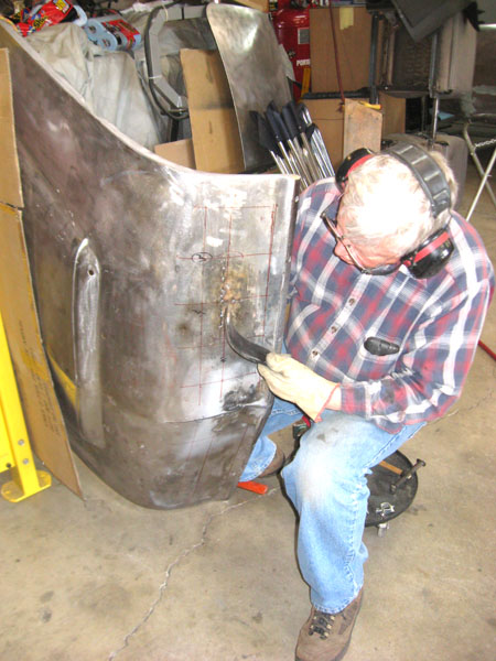

    We started with two cuts with the cut off wheel

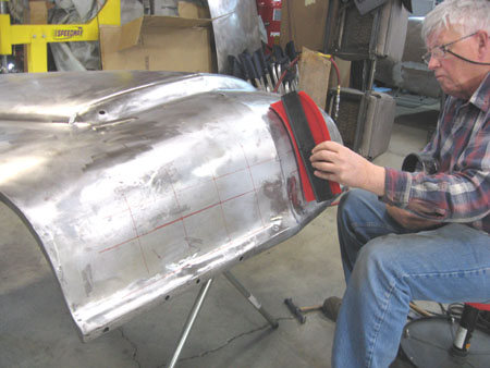

    We laid out a grid and used the contour gauge to compare
    the sides

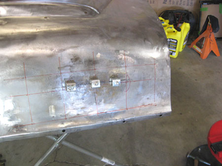

    Clamps were used to hold the pieces in contour
    Hammer and dolly work
    Getting closer
    You can see we made a few more cuts to shrink the bubble
    Filling some holes
    More cuts
    Finally close enough for bondo
    We used the fiber reinforced filler
    Some filler was also applied to the back side. The hood latch
    There is still a lot of work left to do on this hood at this point
    but it will have to wait until we start the primer phase.

    Thanks Joel.We tried lots of things on this hood.
    Heat by torch and quench with water
    Heat by propane torch and quench with water
    Shrinking disc and quench with water
    Shrinking hammer (Waffle head)
    It was stretched when we started on it from the previous body work and everything we tried seemed to not help or make it worse so as a last resort we decided to cut it with a thin abrasive wheel on the 4 inch grinder. We ended up cutting a full plus sign in the middle of the bulge and then made a short cut at the left end of that because we had a small bulge there.
    The cuts were made simply because we had exhausted our limited bag of tricks and skill level. Hopefully we will get it looking better than new in the end. But since this hood was so bad to start with we have never ruled out finding another one for this car.

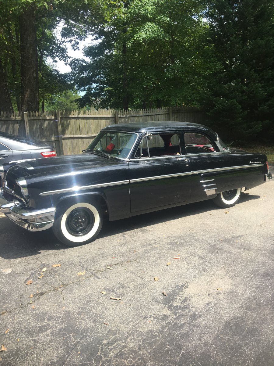

    I know the feeling I got this one recently , it's been restored in the 90's but some of the bodywork is starting to bubble so I plan to build a mild custom but I've been driving the heck out of it so who knows when I'll ever start plus I do body work for a living so I'm in no hurry to get started but I'll be following yours for motivation image.jpeg
  11. The 39 guy
    Joined: Nov 5, 2010
    Posts: 3,777
    The 39 guy
    Looks like a nice Merc! I like the black wheels and white walls. I hope some of the stuff we have posted will be of some use to you as work on your car.

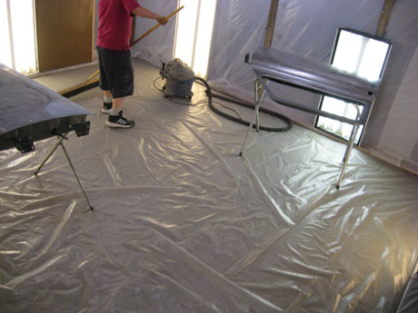

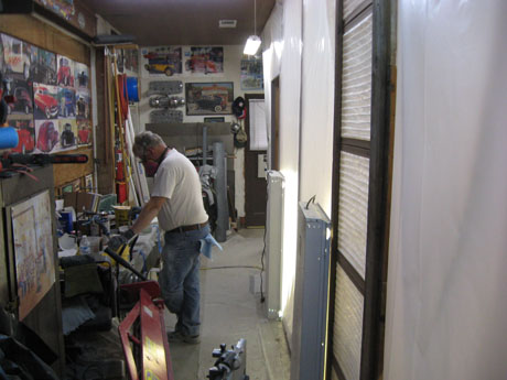

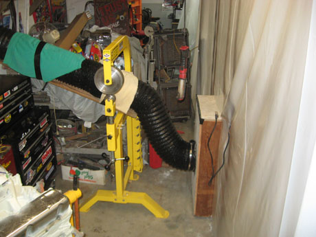

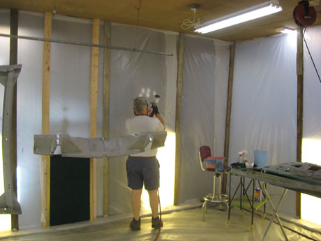

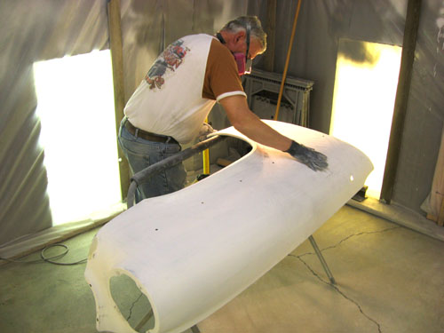

    We built a paint booth! We used mostly s**** lumber I had around from my old shed to build it. I recently cleaned out that old shed and hauled off 6000 pounds of wood and junk plus a ton of s**** metal. I am sure I am going to miss that junk next time I try to build something around here.
    The Fan
    Intake uses stacked furnace filters.
    Exhaust filter is in the opposite corner.
    Used 1/2 inch plywood for the plenum.You can barley see
    the bailing wire I placed on the face of box to keep the
    filter from being ****ed into the pipe.
    Used
    The filter media was really inexpensive and is working very well.
    We bought some 8" hose off the web and it came with this adapter.
    The hose runs through the english wheel and p***es through
    a piece of plywood in the window to the back of the shop.
    The fan ****s well . I have to leave a window open a little to
    get the air volume the fan needs.
    We put a full plastic sheet floor in the booth. After a few weeks
    of dealing with it we have decided to cut it out.
    I had an old pre hung door with spring hinges laying around
    so we installed it in the booth. Works great.
    We hung a couple of pieces of 3/4 inch pipe from the ceiling
    for small parts.
    Don went to work painting the engine bay parts.
    We have a total of eight 4 tube light fixtures on the outside of
    the booth. They also have been in the shed for years.
    The walls of the booth are 1x4. The bottom boards are 2x6"
    The plastic sheeting was the most expensive part for this booth.
    So for less than $200 bucks a bunch of junk parts and some free
    labor we have booth tha thas been working well so far.
    There is enough room for us to walk around the perimeter of the
    booth inside the shop. When we are ready to bring the body in
    the booth we will expand it.

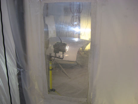

    I taped a piece of plexigl***(from the bead blaster cabinet)
    to the wall so I could keep an eye on Don while he paints.

    Thanks Joel. It does seem to be working very well. We cut the plastic floor out this week. It was just to wrinkled and very hard to clean up. We decided that we would just wet down the concrete floor before painting.

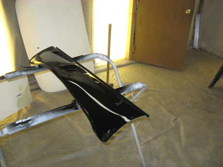

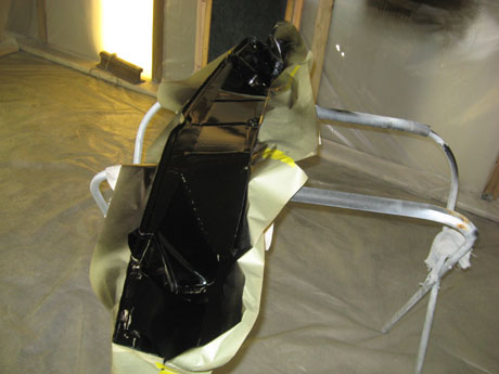

    We started out with the inner fender parts.
    We learned a lot about prep and paint along the way. They
    came out pretty good despite our lack of experience. Don hauls
    home the finished parts for clean storage and to make room for
    the next batch of pieces in the booth.
    All of theses items were painted semi gloss black.
    we took out a lot of the stamping wrinkles during the prep
    process.
    getting complete coverage on hood hinges is hard to do....

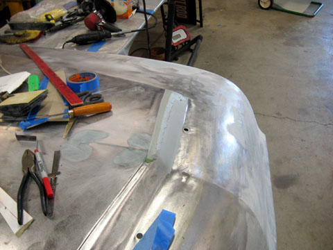

    One of many guide coats
    Finally finished
    We tried this approach and it worked pretty well.

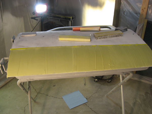

    But we found that covering the door all the way to the trim line worked better. This real helped block the door in short order. Most of this was sanded off. It's kind of like what they do on the cars they do on those TV shows.
    While working on these doors I often thought about how imperfect these cars where when they
    built them,and then I wondered just how far we should go to perfect these body panels. Needless
    to say we spent way too much time on them but hope they will look great when painted.
    We used several different sanding blocks. That piece on the door is the radiator brace cover.
    Blocked as close to perfection as we could.

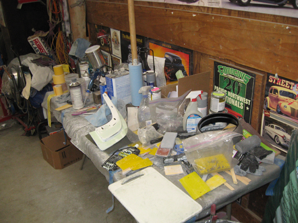

    Our paint bench is constantly in a messy state.

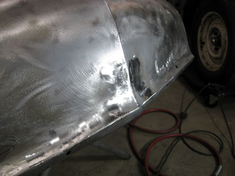

    Head light rim rotisseries . We had to modify the fenders to get a better fit on these. We are still not happy with the fit . I am glad we did not try to french these to the fenders. It would have required major surgery to get a smooth line from fender to rim.
    I had to do a little cutting and re-positioning to get the rim to fit the fender.

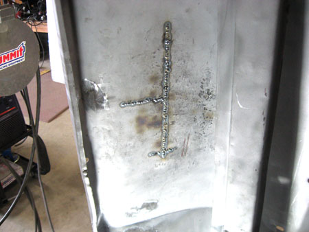

    Dang I didn't take a picture of this after I metal finished this ugly mig weld. Oh well it came out fine.

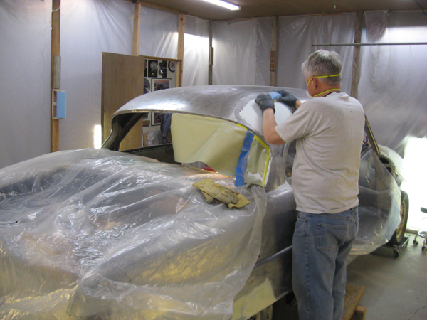

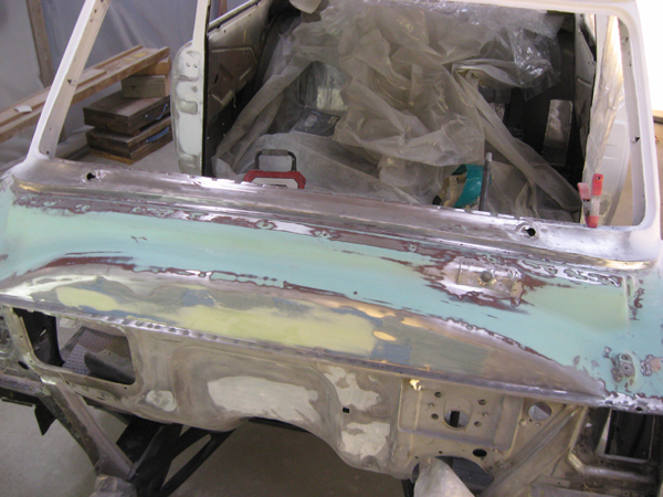

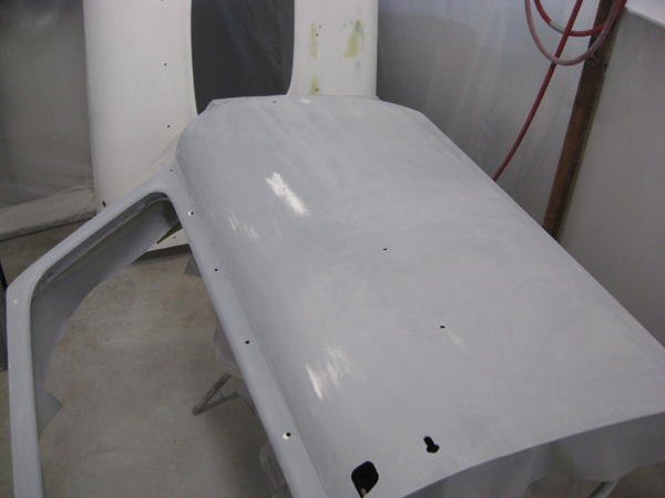

    We moved the car into the paint booth in January. The nice thing about our dry climate here is that this body had been sitting since last summer in bare metal and had no surface rust issues.
    Both rear corners of the top had dents in them. Don't know why but suspect they were **** prints.
    Sometimes there was an effort to be organized...
    We moved the paint and bondo supplies inside the booth because the perimeter walls of the shop are not insulated well and the chemicals were just w wee bit colder when stored there.
    Epoxy primer was sprayed on all baremetal inside the car.
    We used these trusses for platforms when working on the top.
    We found that using a a shop towel between the hand and metal would allow us to feel imperfections in the body work that we could not otherwise feel or see without it.We found several dents along the brow of the top. It must have been used for bleachers at many outdoor events.
    Even the cowl could not be allowed to escape without way too much attention.
    All of these holes for trim are a serious pain in the neck to work around when trying to get a panel flat.
    Working with the epoxy primer was challenging because we had trouble getting it on without a lot of orange peel. So we would have to sand it down before applying the high build primer.
    Door jambs took a week or two to finish.
    We finished the high build primer to between 400 and 600 grit.
    Don eventually figured out the correct mixing ratio,application pressures and spraying technique allowing him to apply the primers without very little orange peel and runs.
    Quarters ready for color after weeks of prep.
    More cowl stuff.The lower section has been painted semi gloss black as were all of the inner fender and support structure. The upper cowl will be body color.
    We are going to start shooting some color today. We have a lot of paint booth cleaning to do before we do that though.
