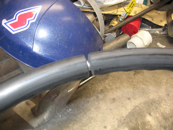

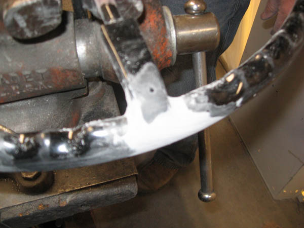

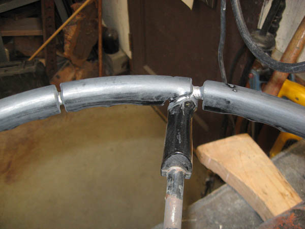

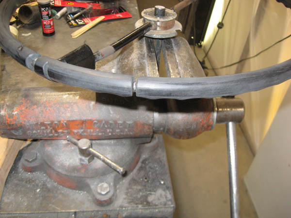

    Dons' wheel had several cracks and since I had always wanted to try restoring a stock steering wheel I studied up on how to do it and dove in.
    The wheel was cracked in several places. The cracks at the base of the horizontal cross bar were the worst. I used the dremel tool to gouge out the cracked plastic.

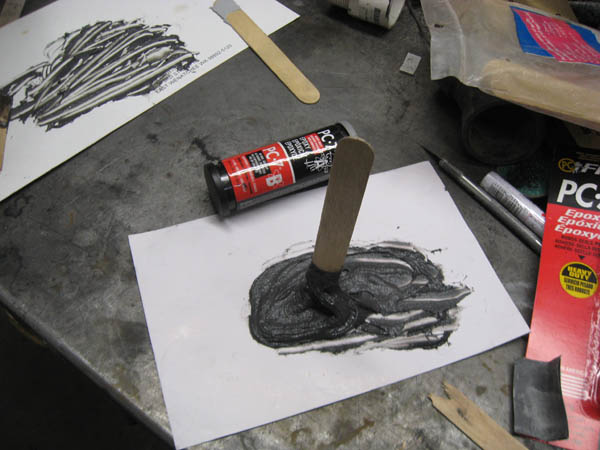

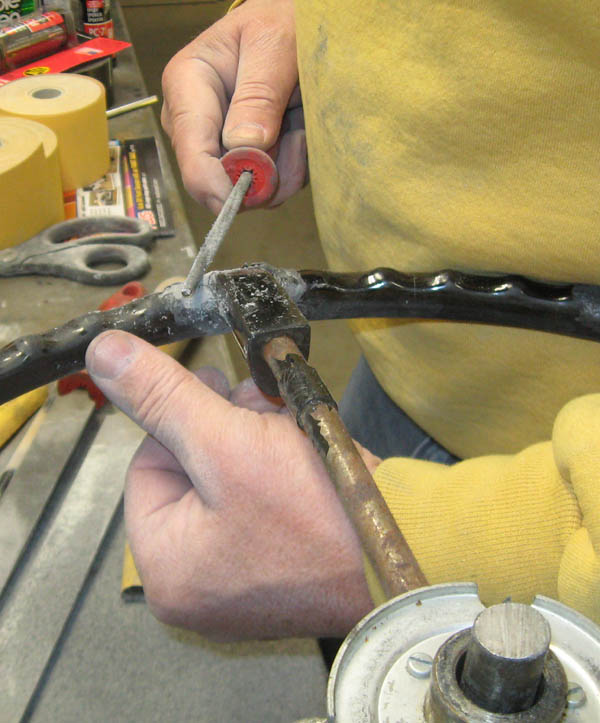

    The material we chose to use was PC-7. we were able to buy it at the local Ace Hardware Store. The PC-7 mixed into paste form. I was able to glob it onto the wheel. Not too much fun to work with.
    The material stayed where placed. I was surprised to find that it took a full 48 hours to cure,
    I used this round file (fairly course) to rough out the filler.

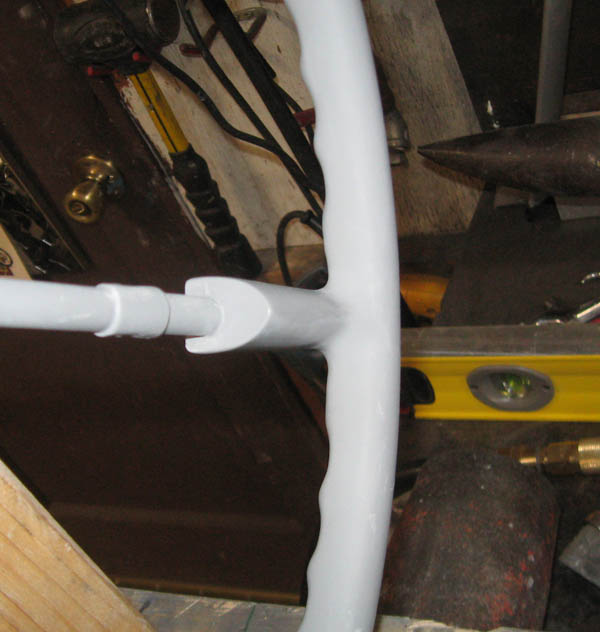

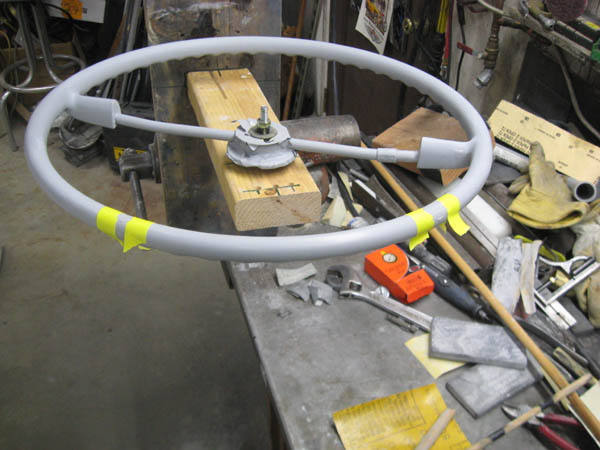

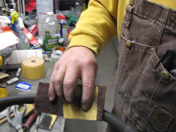

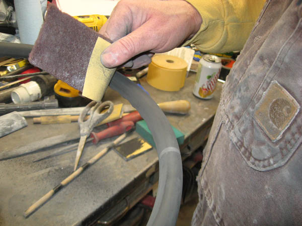

    I used 80 , 220,360 and 400 grit to finish the PC-7. To fill some of the low spots I used some body filler. It took 3 or 4 trys to get it ready for primer.

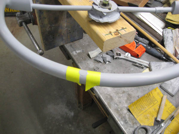

    Don applied a sealer primer and then filler primer.

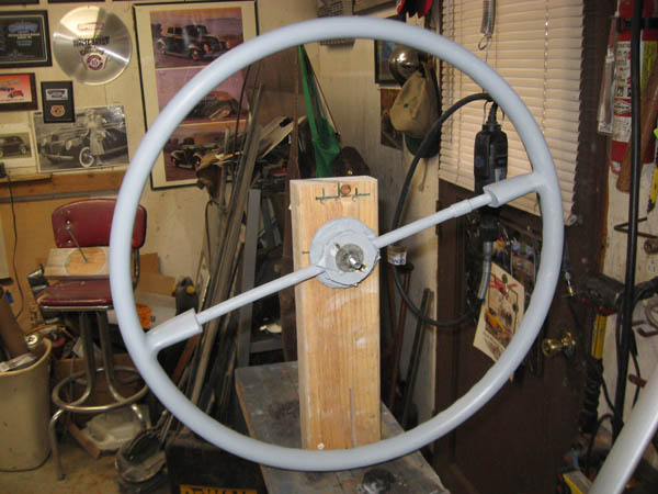

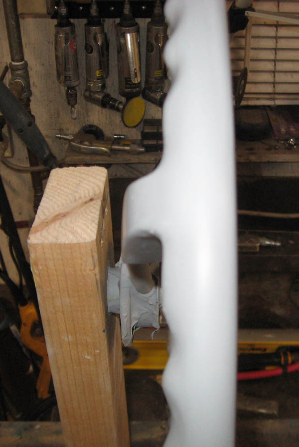

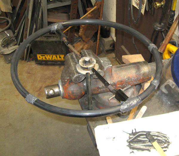

    I made this jig to hold the wheel.
    Cracks are gone. I don't know for how long but it looks good for now.
    I found a few little nicks or indentations on the face of the wheel. Rather than use body putty to fill them I tried mixing a little bit of filler primer. I then blobbed it on with a small brush. I first sanded it down to the tape. Then I removed the tape and finished sanding the primer down to the contour. It worked great. I don't know f it was the right way to do it but it worked better than using finishing putty and more primer.

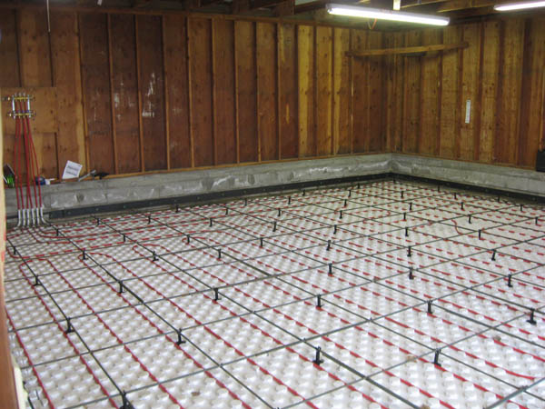

    We have also been distracted by the job of prepping my other dirt floored shop bay for a new floor.
    Some insulation was used and #4 rebar 24" on center.
    We are finally ready for the concrete guys to do their thing. They should be here next week to do the pour.The bay is 26 x 30'. It has always been a dirty catch all for parts and mostly stuff I should have gotten rid of many years ago. I started clening it up last fall and hauled many tons of stuff away to get it ready for this project. My hope is to have this area kept very clean and tidy for parking the finished cars....but we all know how that goes.....

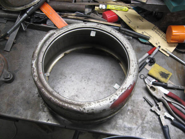

    Here is a fun project I did a few weeks ago for the Mercury.
    I was rooting around in my shelves looking for something else and came across this old oil bath that had been on my 40 coupe when I got it. Since Don is wanting a very stock appearing engine with no chrome or polished stuff I thought this would be an excellent candidate for an air cleaner for the Merc.
    I was amazed at how complex this filter was. The amount of engineering required and the expense of all of the steel stamping required to make one of these filters had to make them very expensive to make.

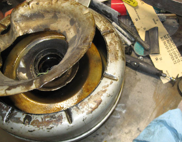

    So I started cutting the filter apart. It was like an autopsy for me as I was very curious about the construction of this thing. My intent by the way is to convert this oil bath into a new air filter cap for paper filters.
    I used my trusty dremel tool to slowly cut this thing apart.
    This is the aftermarket filter base used for a pattern of the cut required.
    As you can see this filter was used on a stromberg 2 barrel .

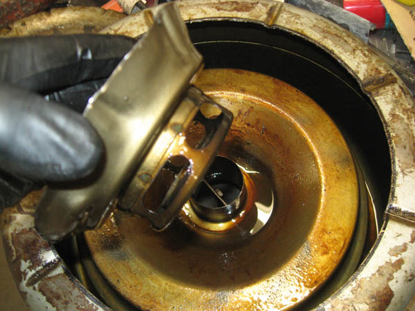

    I thought I would just cut the bottom out and remove it. I was wrong.
    I cut the inside of the circle out. Did I mention oil yet? Oil every where!
    Another cut reveals another chamber. Some of these chambers you would never be able to get cleaned out.
    Finally after several hours of cutting and lots of oil clean up I got to the final rim .I left some tabs thinking I would be able to use them in the welding process (for the lid).
    You can see the three tabs in this picture.
    I was going to weld the lid on with the three tabs but it was too hard to get the mig welder in there and still see what I was doing so we went to plan B.

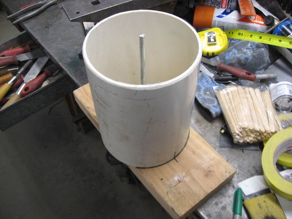

    I decided to use this epoxy to glue the lid to the filter body.
    After bead blasting the the filter body and lid .The lid was carefully centered on the body and the seams taped. The all thread and stick held the lid tight to the body.
    I used two tubes of the epoxy which was applied into the seam.
    The epoxy worked great.
    The next step was to build a simple jig to hold the filter for the needed body work and paint.
    The jig allowed me to work on the filter housing in the flat or 90 degree position.

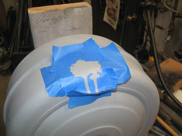

    Some dent removal and filler was required. The bottom section of the filter had a lot of stretch marks or fretting from the pressing process.
    After a lot of sanding I still had a couple of small holes so I mixed up some sanding primer and filled the taped off hole.
    When I removed the tape I had this small raised section I could sand off. This seems to work well for small holes. You do not have to paint and sand the whole piece this way.
    Finally it was painted the same color as the body of the car.
    A trial fit on the motor indicates the desired look.
    It was a lot of work for a little detail on the engine but it is different than the standard aftermarket paper filter and looks kind of stock.

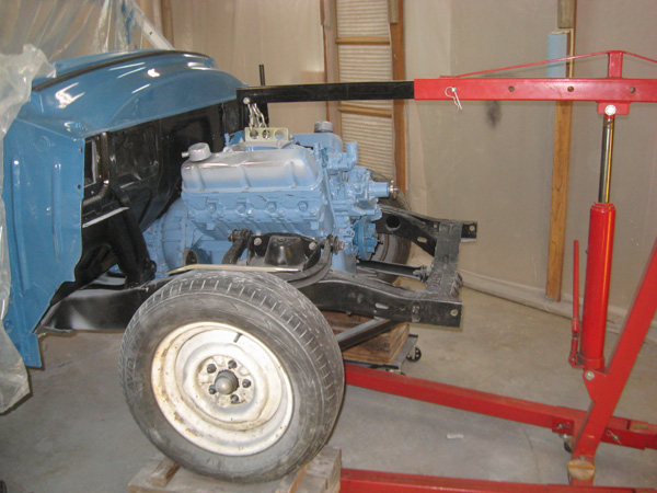

    The motor and transmission were bolted together and installed.

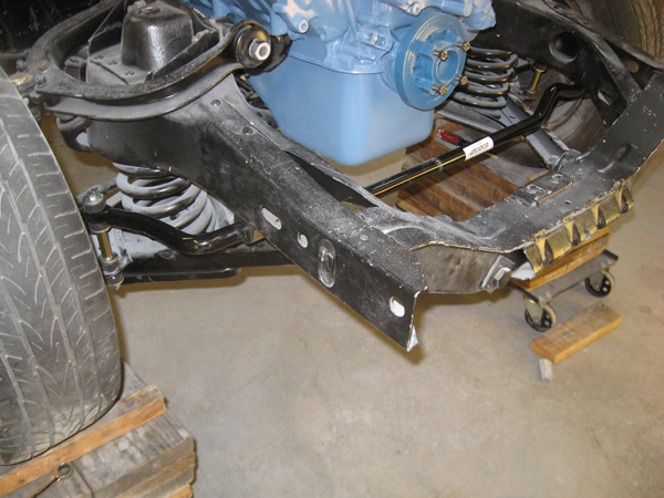

    This front sway bar kit was installed. This one bolted right in.
    Here is the pat number for anyone that might want to use one of these.

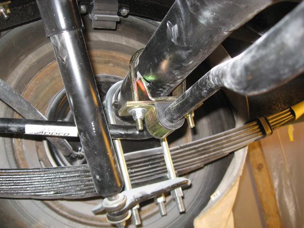

    So I moved on to the rear sway bar. I think this is the one Don had to wait a long time to get.
    This was an interesting way to attach the top bracket. I had to drill the holes in the tube frame section and insert this U bolt into the frame. It actually worked pretty well. Make sure you have a nut attached to one end when you insert the U bolt or you might loose it in the frame.
    For some reason the link arm bolt and spacer shipped with the kit was about 2 inches short so I had to make some custom spacers and washers to lengthen this link.
    The ADCO number for the rear bar.
    The most likely cause of the need for a longer link bolt was that the rear axle has a 2 inch spacer.
