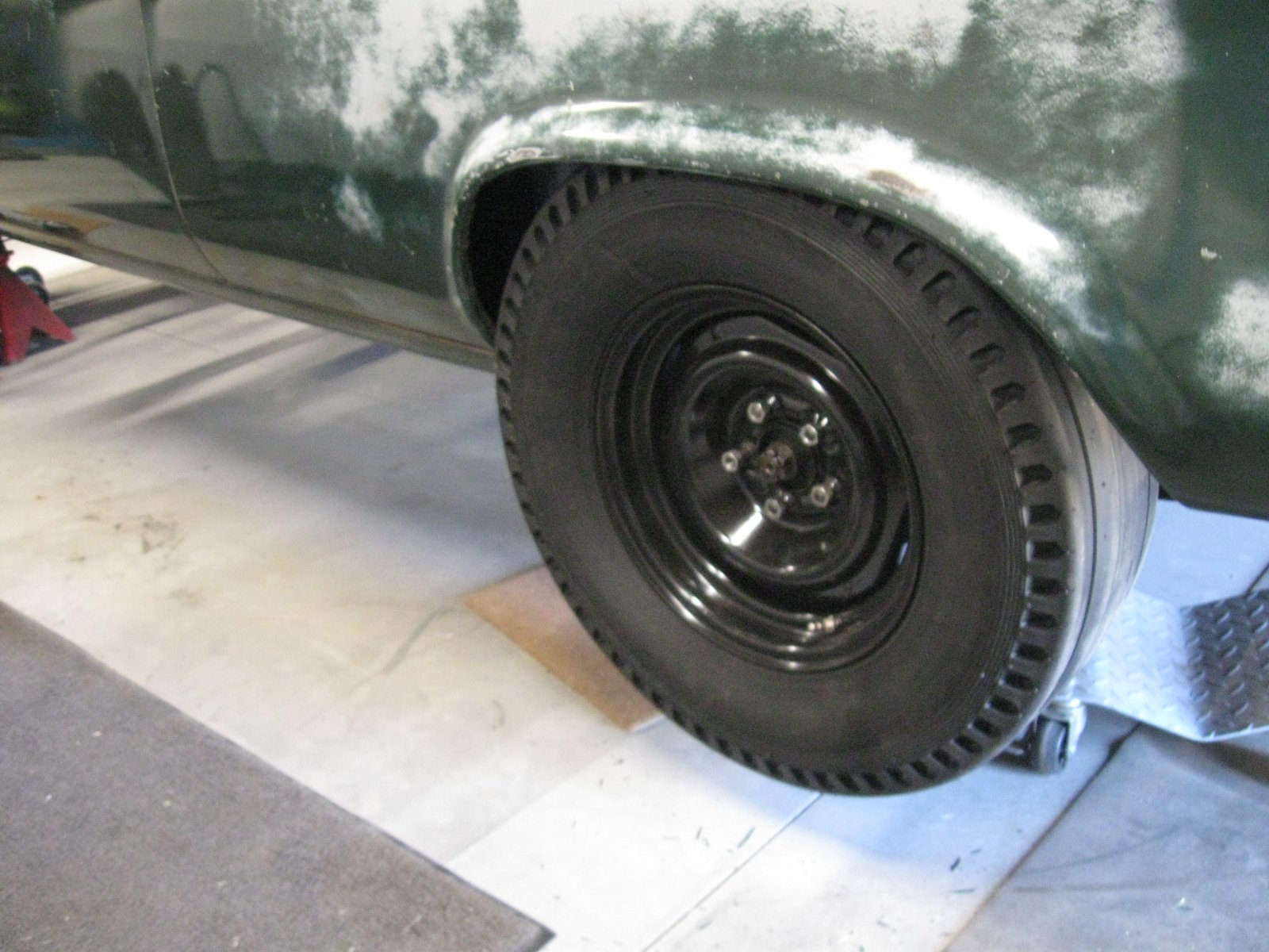

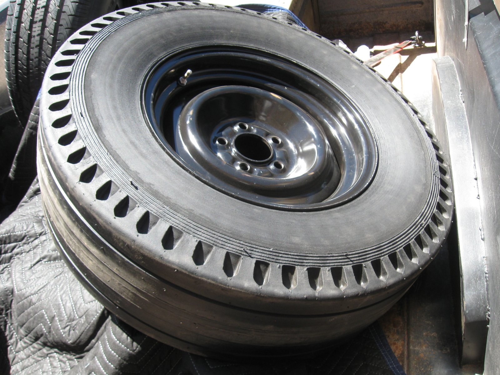

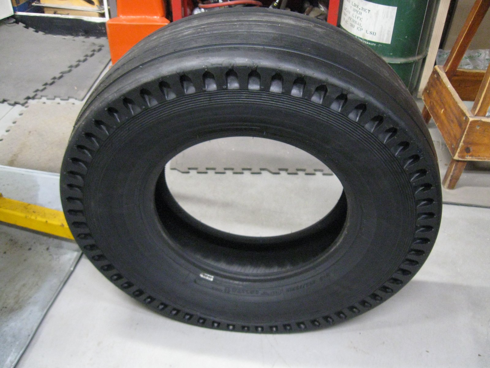

    Since last mentioned, I've come up with a simple solution to the tire issue. IMG_2002.JPG
    I determined that the original wheels, 15x6-1/2, would give me the semi-straight profile that I like:

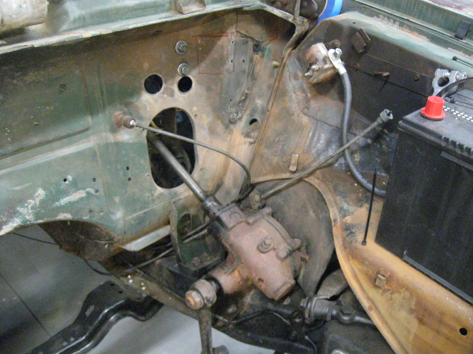

    I've seen the sidewalls "bulgey" due to a wider wheel, I've seen sidewalls that are "****ed in" due to a narrower wheel... and then the combination that gives the "semi-straight" profile that looks juuuuust right!
    So I took a leap of faith after cleaning and smokin' a little black on the wheels, had the tires mounted, and to me they're juuuuust right:

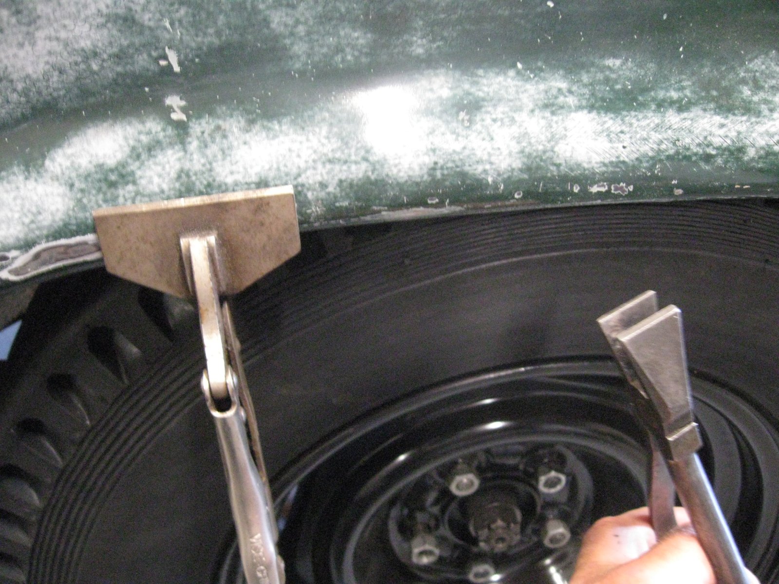

    Then I selected an old pair of pliers I got from my Grand-Dad along with a pair of wide bill channel locks and proceeded to bend the inner lip of the fender opening a little at a time. I was able to do so without messing up the outer surface at all and gained a ton of room between the tire and the inner lip of the opening.
    It took a little shuckin' & jivin' to wiggle the tire into the opening, but on it went. I did a bit more adjusting of the lip and have gained enough clearance that I can easily get my hand between the tire and the fender. And as Frieburger would say; "That's a win!!" IMG_2008.JPG IMG_2009.JPG
    Torkwrench, Tim, Ragged Edge and 6 others like this.
  4. In_The_Pink
    Joined: Jan 9, 2010
    Posts: 1,042
    In_The_Pink
    I think you made the right call there. Now, just hope it don't rain. :D
    Six Ball and Jacksmith like this.
  5. Rynothealbino
    Joined: Mar 23, 2009
    Posts: 439
    Rynothealbino
    That looks awesome and I'm glad it worked out with the wheel. I just got a 15x6 WV wheel I ordered in October (got its match back then) so I know the pain of stuff not working out the way you want.
    bchctybob and Six Ball like this.
  6. Six Ball
    Joined: Oct 8, 2007
    Posts: 7,238
    Six Ball
    from Nevada
    That really looks nice. I don't use the word "perfect" often but I'm tempted to now. :rolleyes: What is it like at the top where the flair meets the body. The suspension on these things don't have much side to side slop.

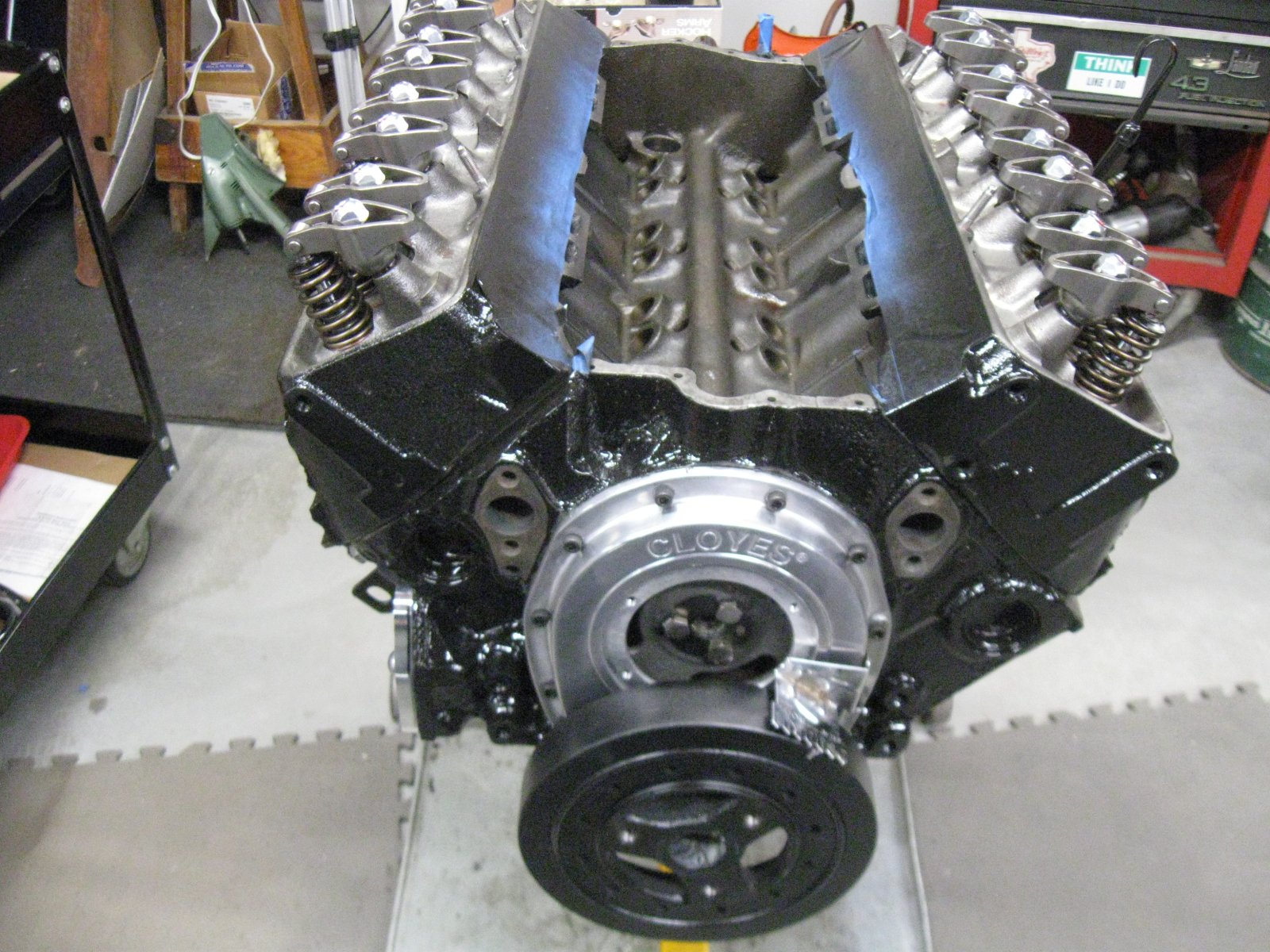

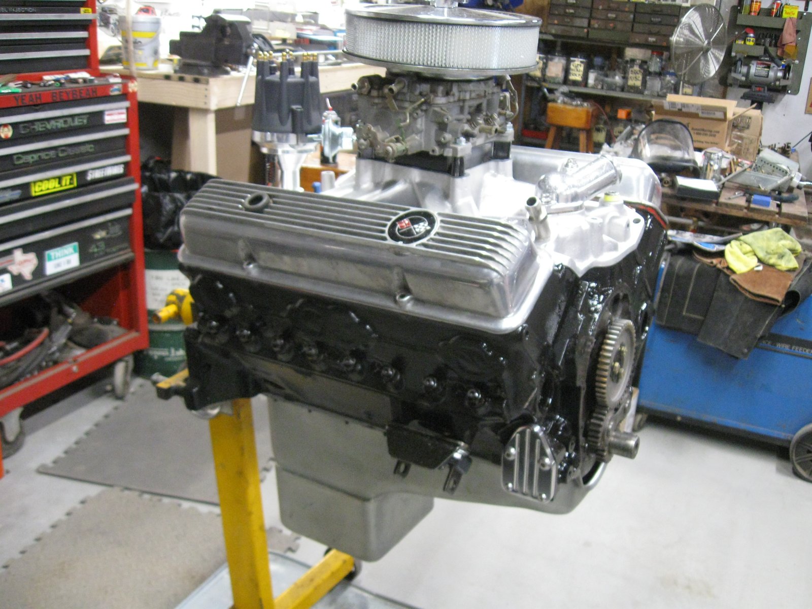

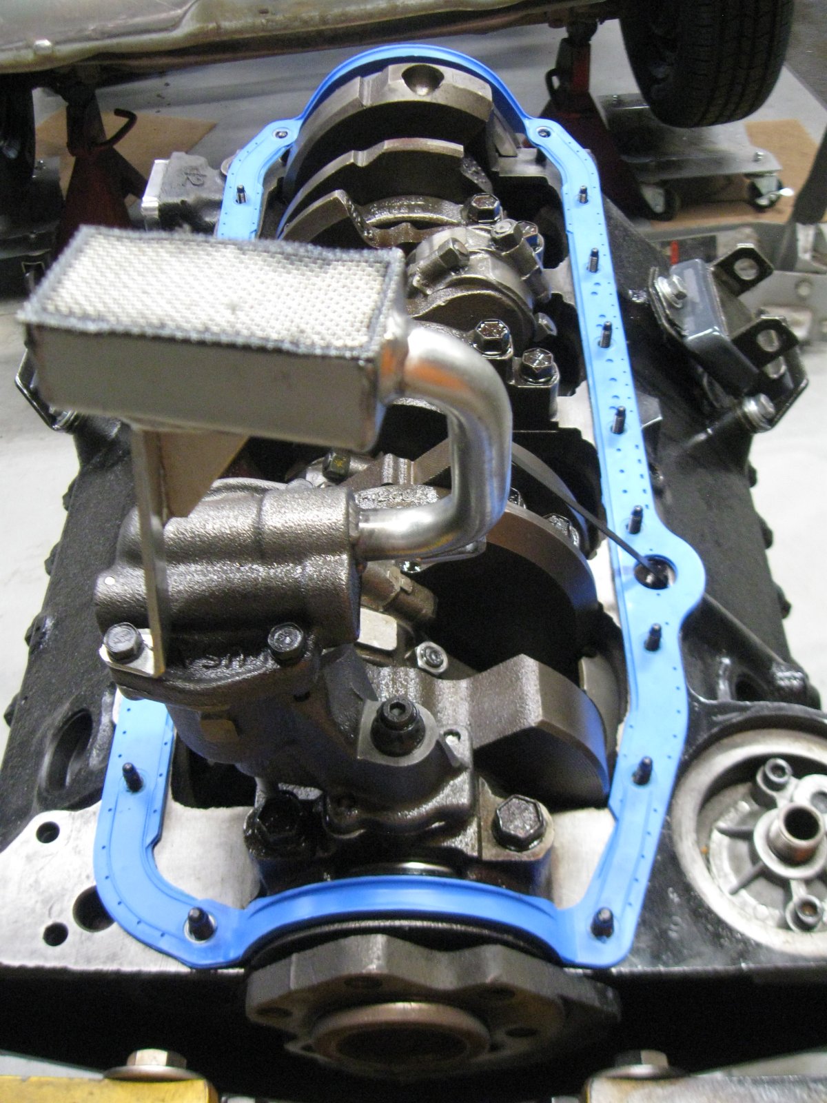

    O.K., that's set. Now, back to the engine... I had to return the 1st oil pan gasket I'd ordered, & the replacement arrived today. It's the right one. I also got the rocker arms. Check.
    I learned that a short water pump helps to hold the roller cam/ ****on in place, where a long pump does not. I'll use a stout timing cover to hold the roller cam in place. The Cloyes cover has an adjustable cam ****on and it's stout. Cool.
    I wanted to use a N.O.S. gear drive that I've had for a while, but the Cloyes cover doesn't clear the idlers... go figure. So the gear drive goes back onto the shelf and the double tooth timing chain set will go on.
    The stuff I have laying around got mocked into place for a change of scenery.... Miller time & pick it up tomorrow.

    I've managed to get a bit deeper into this project than I'd originally planned. When I started I figured a down & dirty "get 'er runnin'" agenda would be fun and rewarding. I obviously didn't know I was going to have all the extra, better parts that I am harvesting from the White organ donor. It's all good and I like the direction we're going... it's proving to be more fun & more rewarding than I'd originally planned. I believe in the end the car will be much better as a result.
    That being said, it's now time to delve into some "dirty work"; cleaning & repairing where necessary, a splash of paint here & there and getting to a point where I can start putting this lil' rascal back together!
    Speaking of "Lil' Rascals", I have a new ***istant; This is "Bear" he's going to make sure I'm protected from lizards, birds and cats while I'm working. I feel very safe! IMG_2044.JPG
