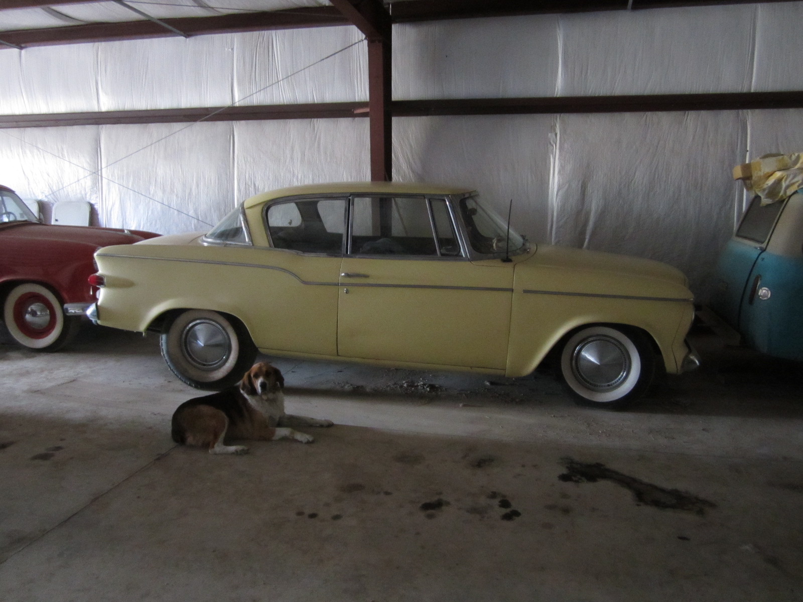

    Hey Bob, I found another image of the white one... color me inspired! (I'd like the black wheels all around though...) White 60 Sedan-rf.JPG
