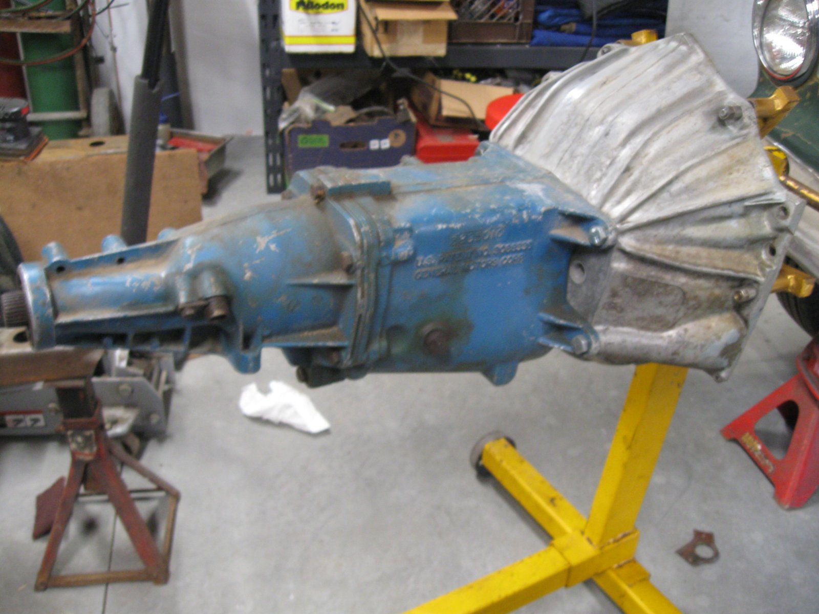

    Posts: 1,131

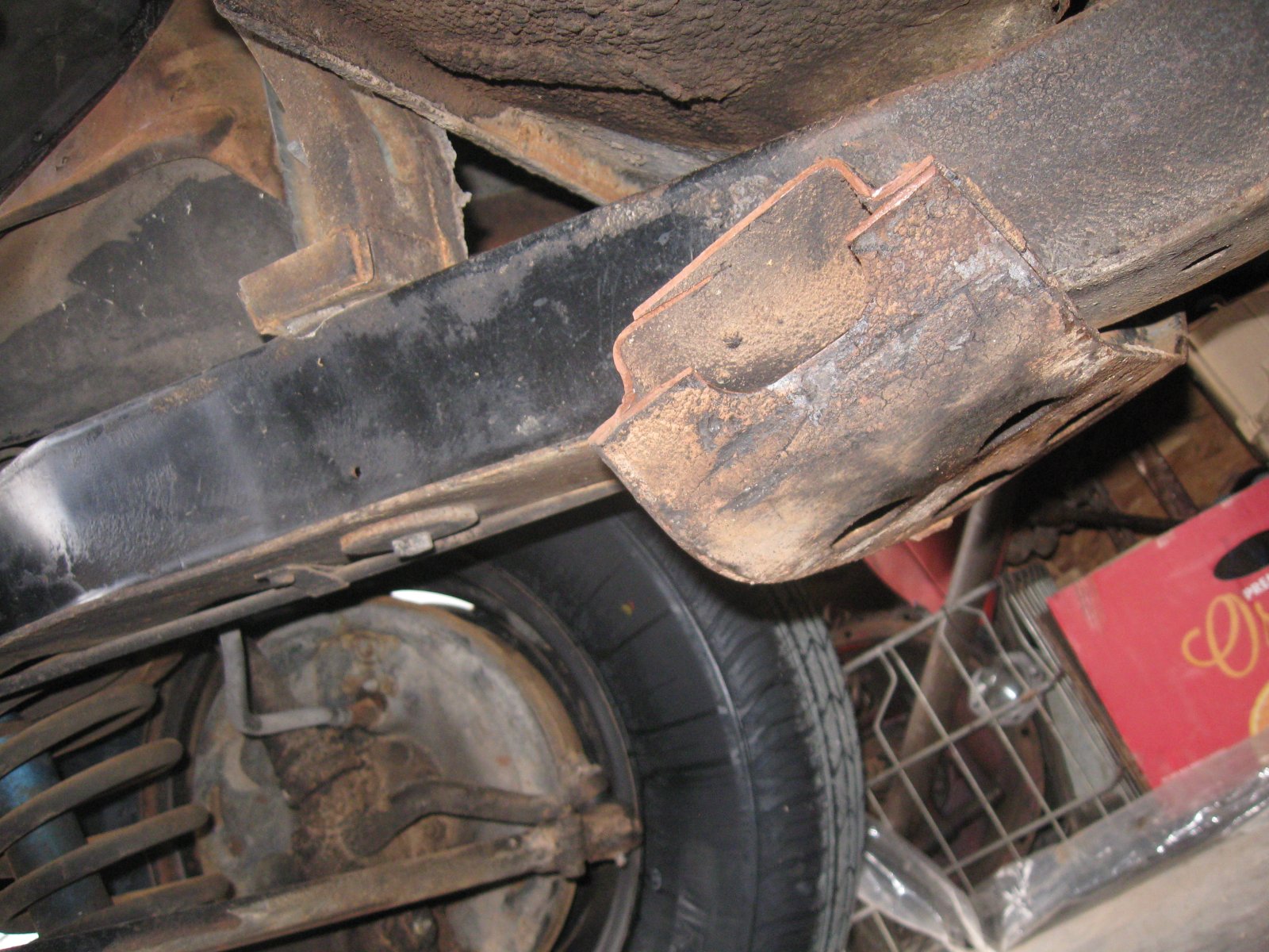

    Nice batwing. Save those ends for the midwest & eastcoast guys.
    For those that don't know, the batwing not only supports the trans, the outer ends support the cowl. When they rot, everything attached to the cowl goes wonky. & the ends rot out fairly fast. Doesn't take much to destroy the integrity of the ends, either... Those look like real good patch material.

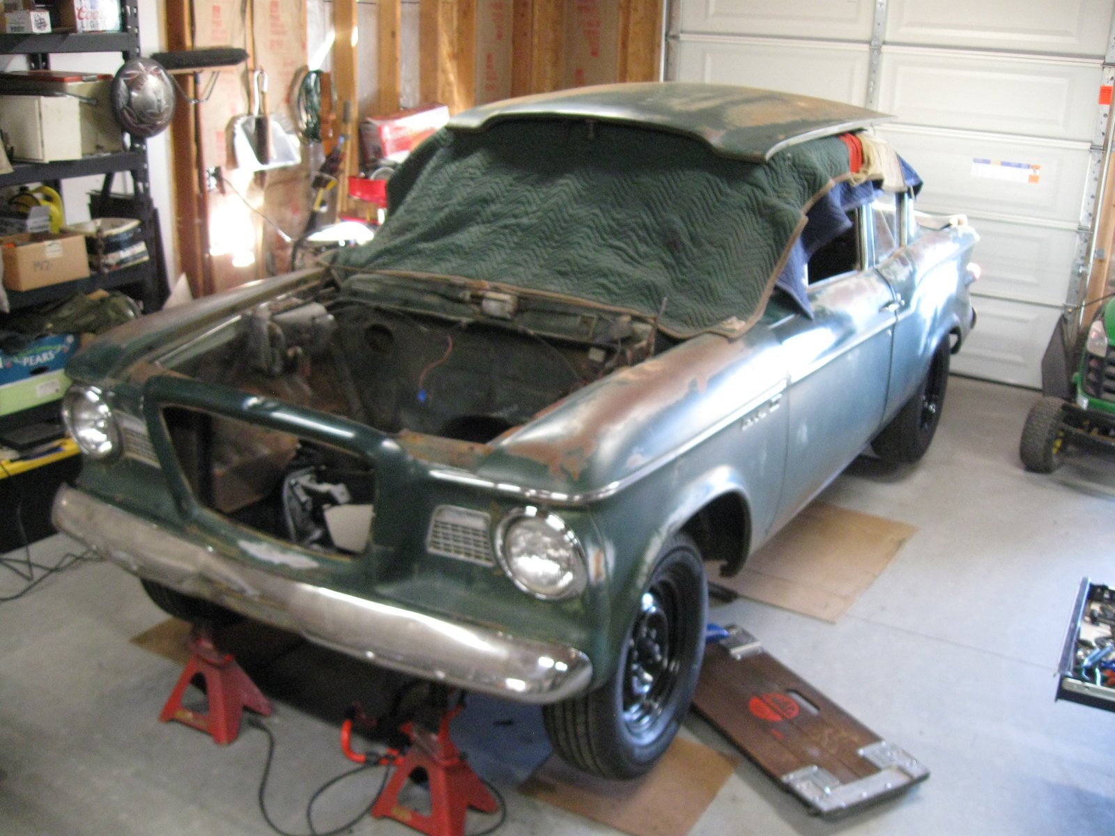

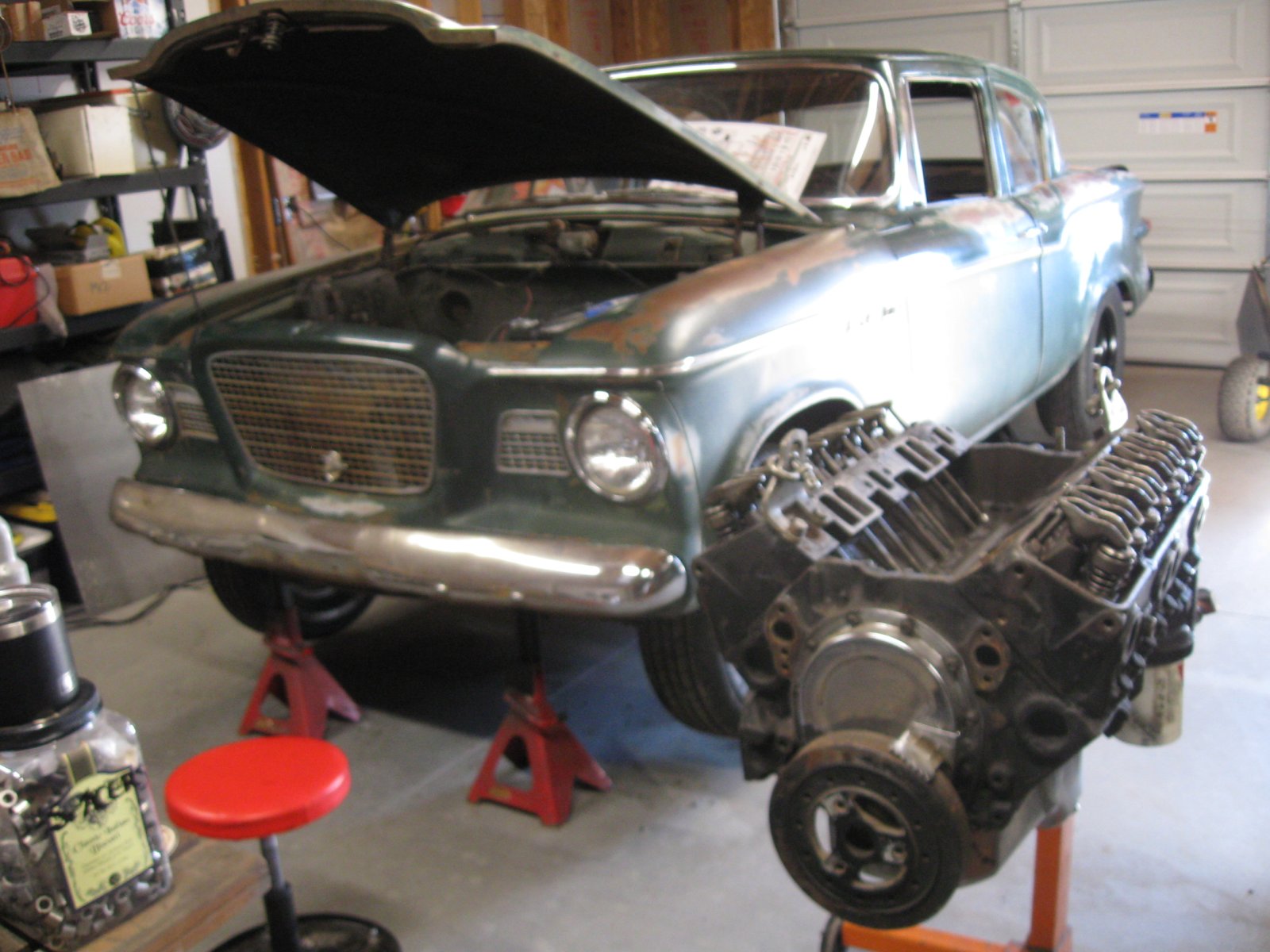

    Hnstray, bchctybob and Six Ball like this.

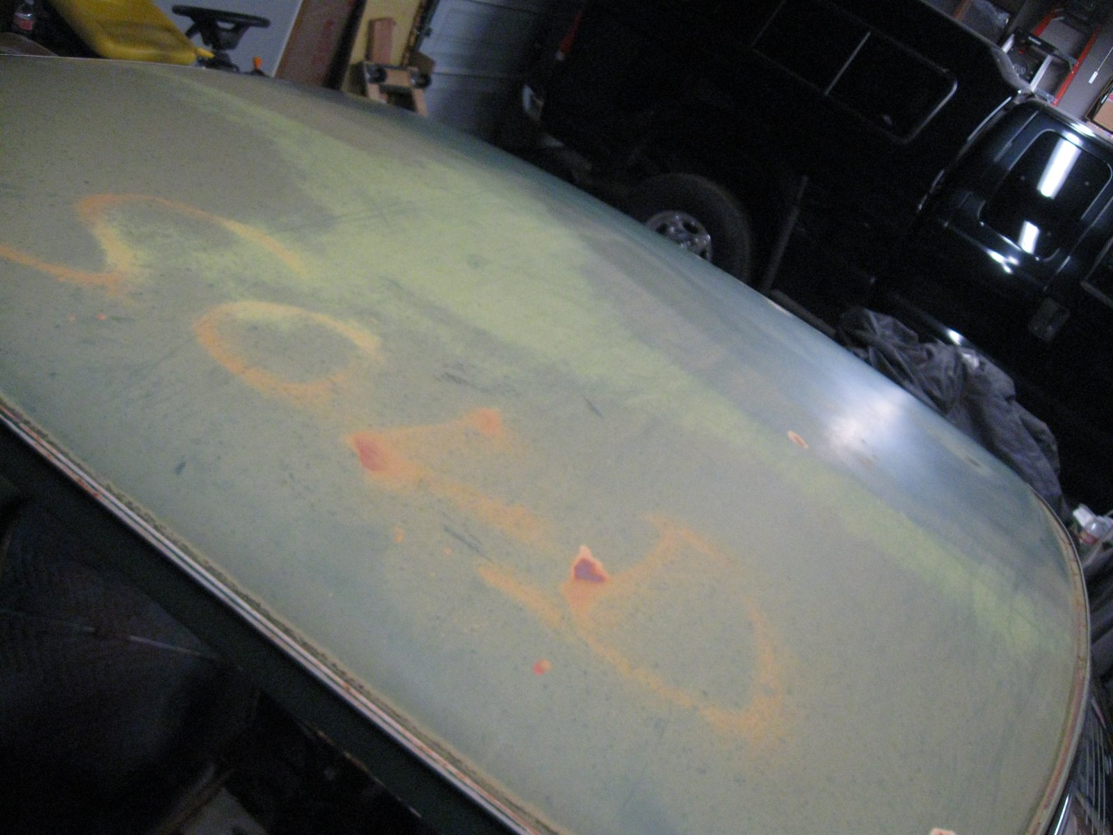

    The Lark has a white 1/4 panel... Further inspection explains why IMG_1508.JPG IMG_1515.JPG IMG_1535.JPG ... it also has "SOLD" sprayed on the roof.

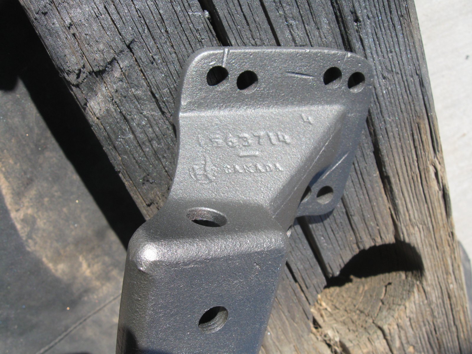

    I recently scored a set of engine mount brackets from a guy outside of Phoenix... These were used on Studebakers built in Canada, as they came with Chevy V-8 engines. While pretty crusty, they cleaned up nicely and will help with the next phase of the rescue.
