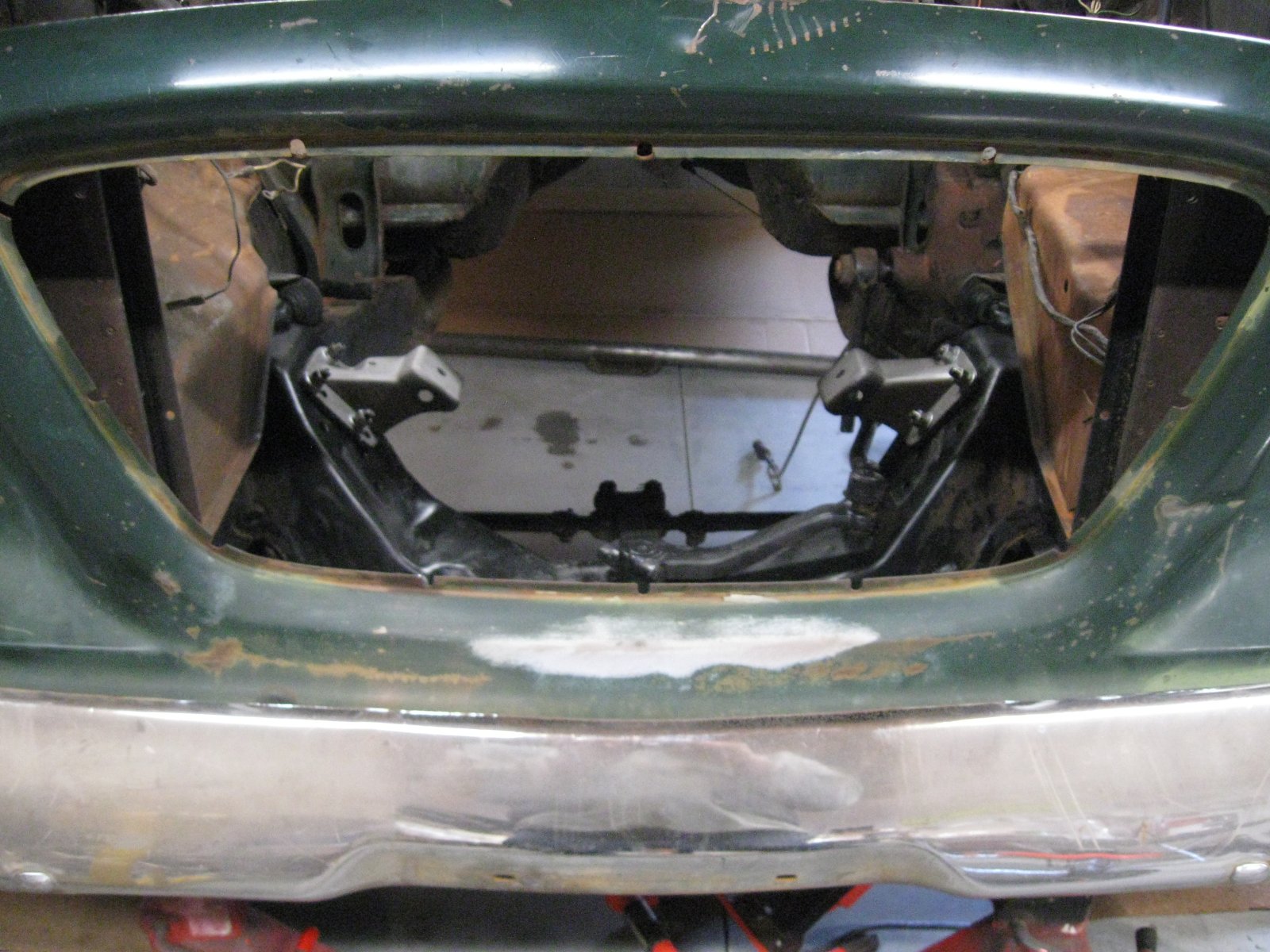

    Today I got the refurbished Bat-wing installed, changed the diff fluid and did some more cleaning. I also tossed the gross old seat belts.
    I've got the engine & trans mounts ordered and they'll arrive Monday. It will be interesting to see where the engine sits regarding exhaust manifolds...

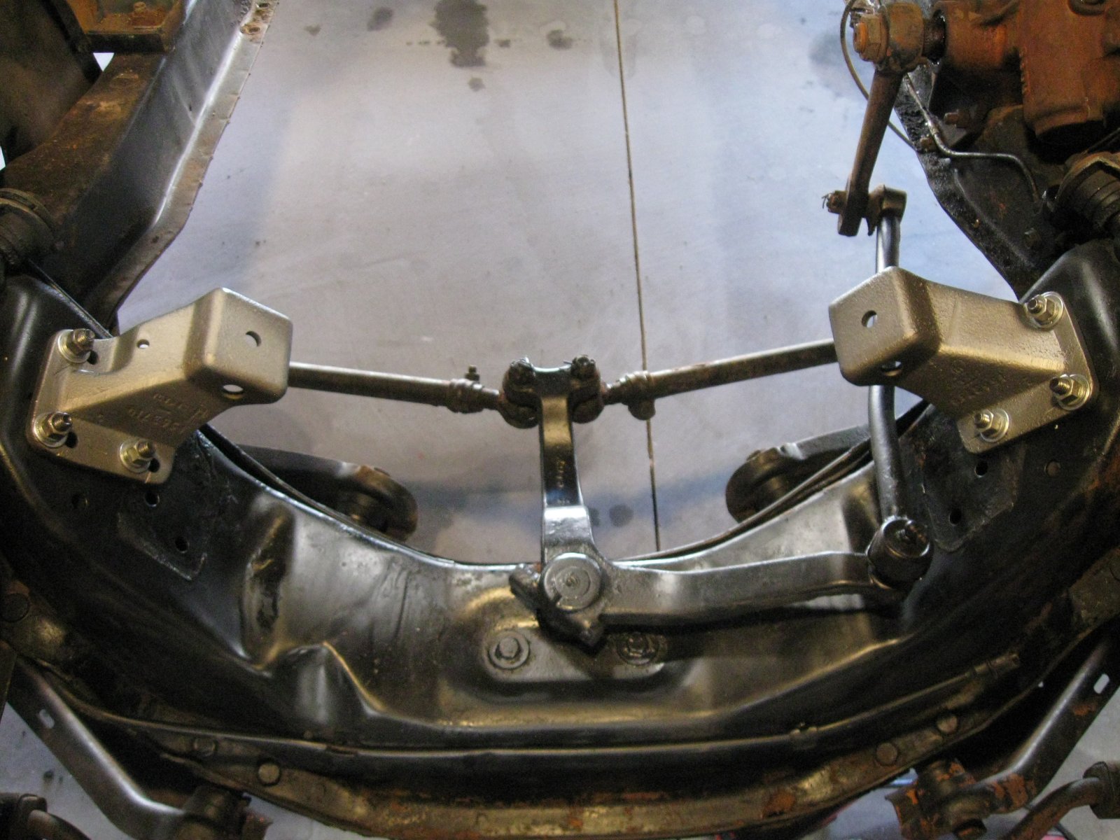

  4. guthriesmith
    Joined: Aug 17, 2006
    Posts: 12,676
    guthriesmith
    That is some crazy steering linkage on these Larks!

  6. Six Ball
    Joined: Oct 8, 2007
    Posts: 7,078
    Six Ball
    from Nevada
    Studebaker used the same basic steering from about '52 till the end of the line. That bell crank causes some clearance issues but works very well especially in the non-power cars.
    Jacksmith likes this.
  7. Jacksmith
    Joined: Sep 24, 2009
    Posts: 1,876
    Jacksmith
    from Aridzona
    Yeah, there's around 9 points to wear out. But when it's tight & adjusted correctly it steers amazingly well... almost like power steering because of the resulting leverage.
    If you look @ the steering arms, starting @ the box, there is a long distance from the box to the rod that connects to the bell crank. Then the distance from there to the bell crank's pivot point. Then the distance from the pivot point to the tie rods. Then another distance @ the other end of the tie rods to the kingpin's center... don't forget the distance from the steering column's hub to the o.d. of the steering wheel... add it all up and you've got a couple feet of leverage, like putting a pipe on a breaker bar. All that, strange as it looks, makes for relatively easy steering for a manual set up. The down side is that there are at least 9 points to wear, not including the king pins/bushings. (And there's a couple pounds of grease zerks all sprinkled around) But, like all technology, it's great... when it works.

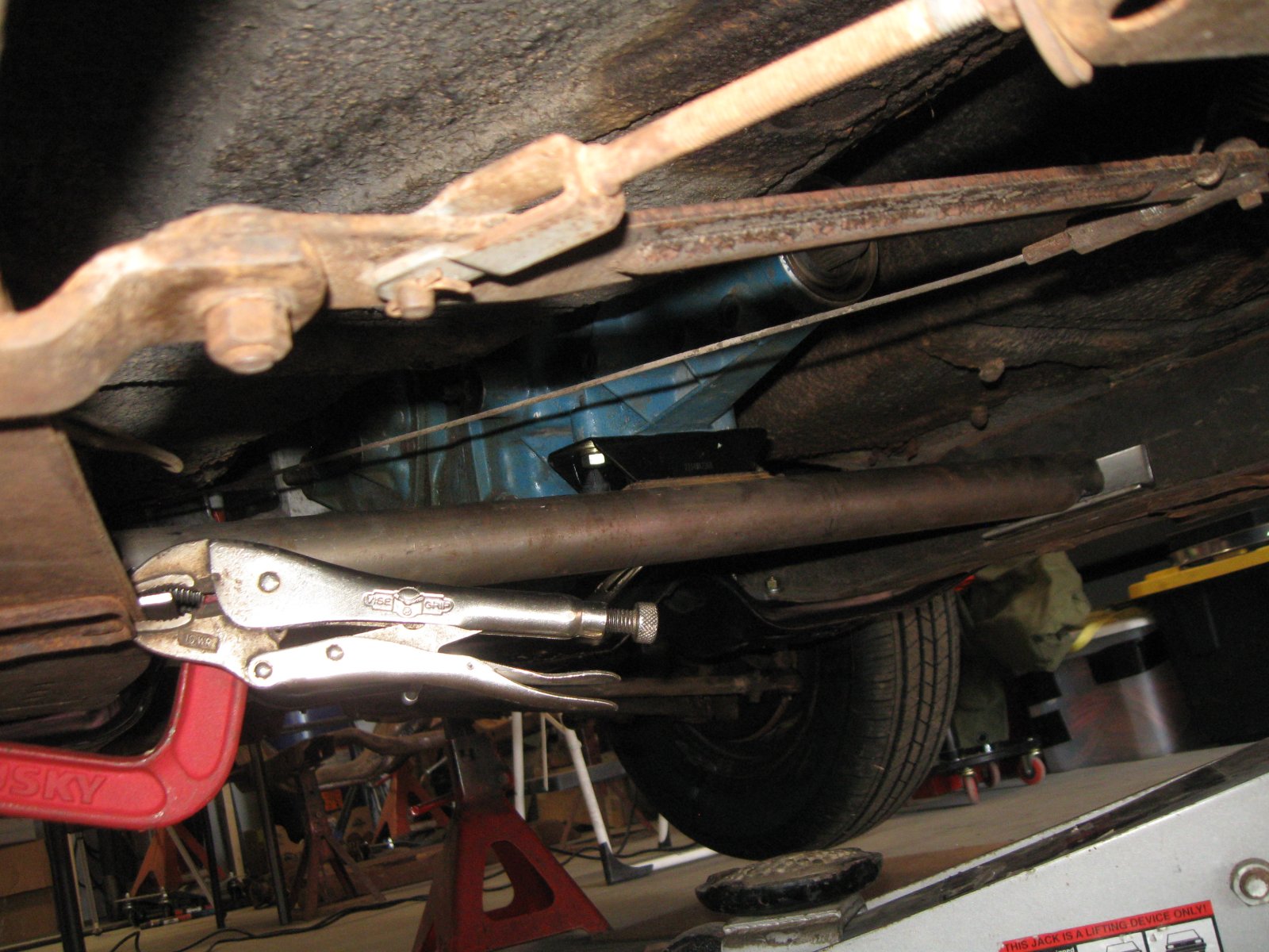

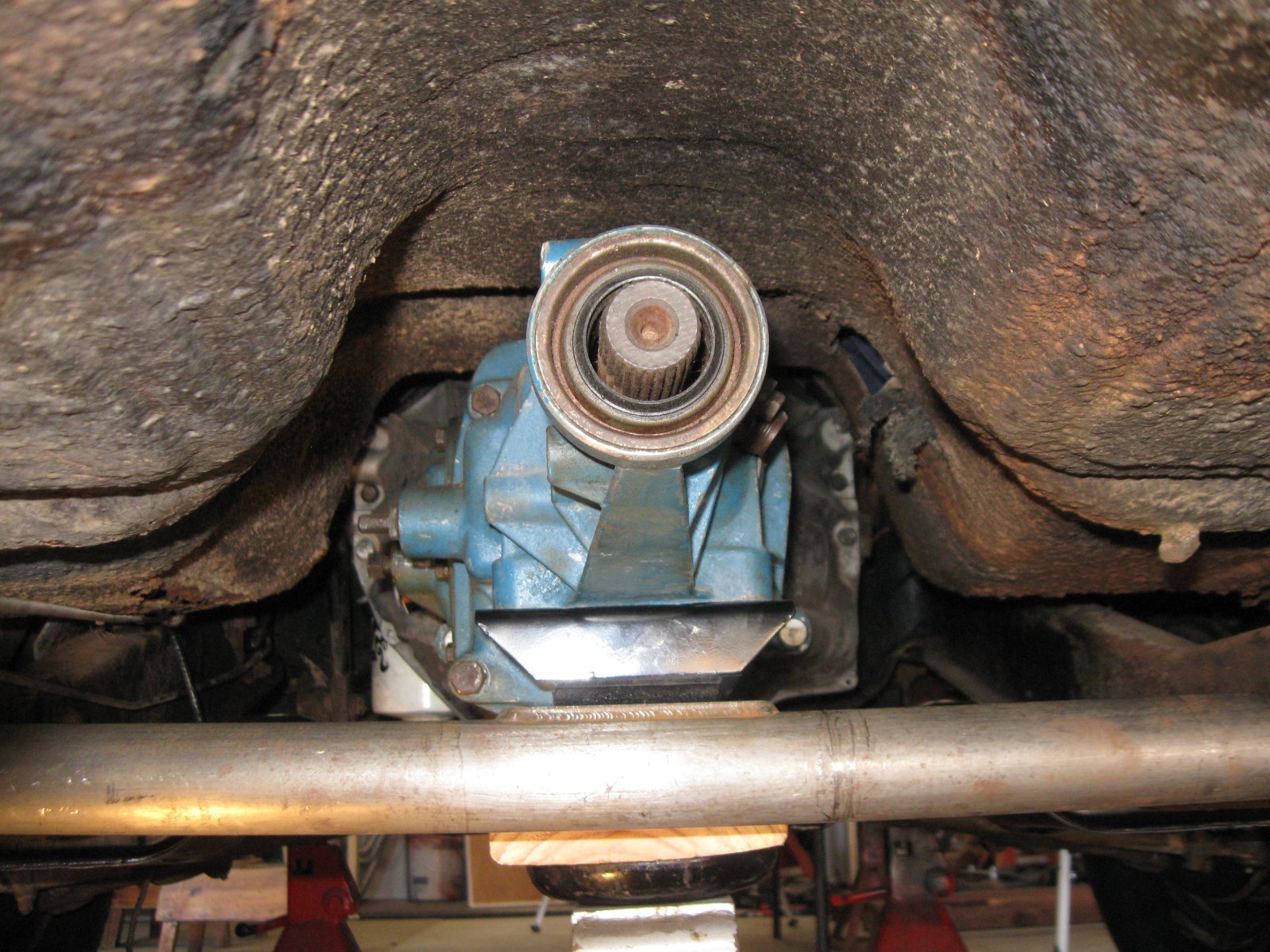

  8. Jacksmith
    Posts: 1,876
    Jacksmith
    from Aridzona
    Here's the "Bat Wing" installed:
    IMG_1566.JPG IMG_1567.JPG IMG_1568.JPG IMG_1569.JPG Today, much to my surprise, the Summit box arrived. (a day early) So my parts pile is growing.
  9. lumpy 63
    Joined: Aug 2, 2010
    Posts: 3,449
    lumpy 63
    Yes my Lark had a muncie , I had to fabricate a bellcrank ***embly that bolted to the back of the ****tershield in order to use the 59 floor pedals. I think in 61? they went to swing pedals. Better check clearance with the 7qt pan , you may find the steering arms hit the front of the pan. I had that problem with the 327 I installed first and I put the quick ratio steering arms on and it gave me just enough clearance for the 7 qt kick out pan. The downside was steering effort increased dramatically . When I installed the 400 I used a stock 5qt pan and could have reinstalled the stock arms. I have pics of all this if your interested PM me.
    Jacksmith, bchctybob and Six Ball like this.

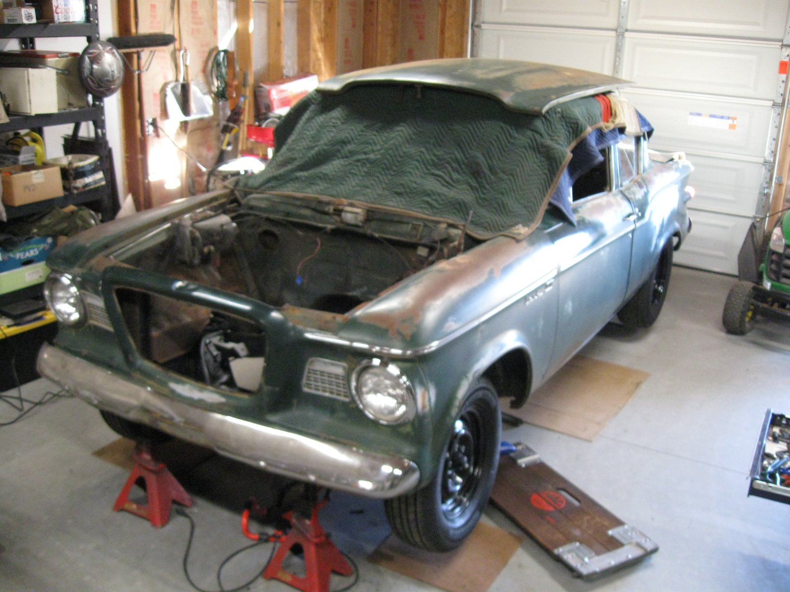

  24. Jacksmith
    Posts: 1,876
    Jacksmith
    from Aridzona
    Another reason why I'm sticking with manual steering!
    Six Ball likes this.
  25. Jacksmith
    Posts: 1,876
    Jacksmith
    from Aridzona
    I made a bit of progress... The engine mounts lined up well. For grins I plopped an old pro stock tunnel ram on there. Ha-ha, looks pretty cool. So any way, next I'll figure out a trans cross member, pulleys, blah blah.... IMG_1572.JPG

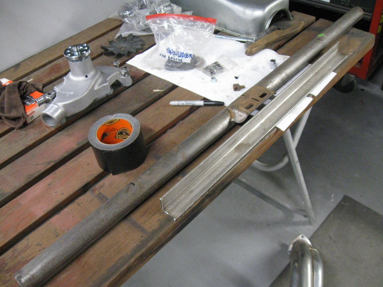

  26. Jacksmith
    Posts: 1,876
    Jacksmith
    from Aridzona
    I scrounged around through the endless junk pile & came up with a water pump and brackets to mount the alternator.
    In the interest of having a solid home for the trans mount, I began building a cross member for it.
    Baby steps... but moving forward nun the less.
    I have to move the whole mess forward in the shop 'cause I can't quite reach with the welder... UGH!!!
