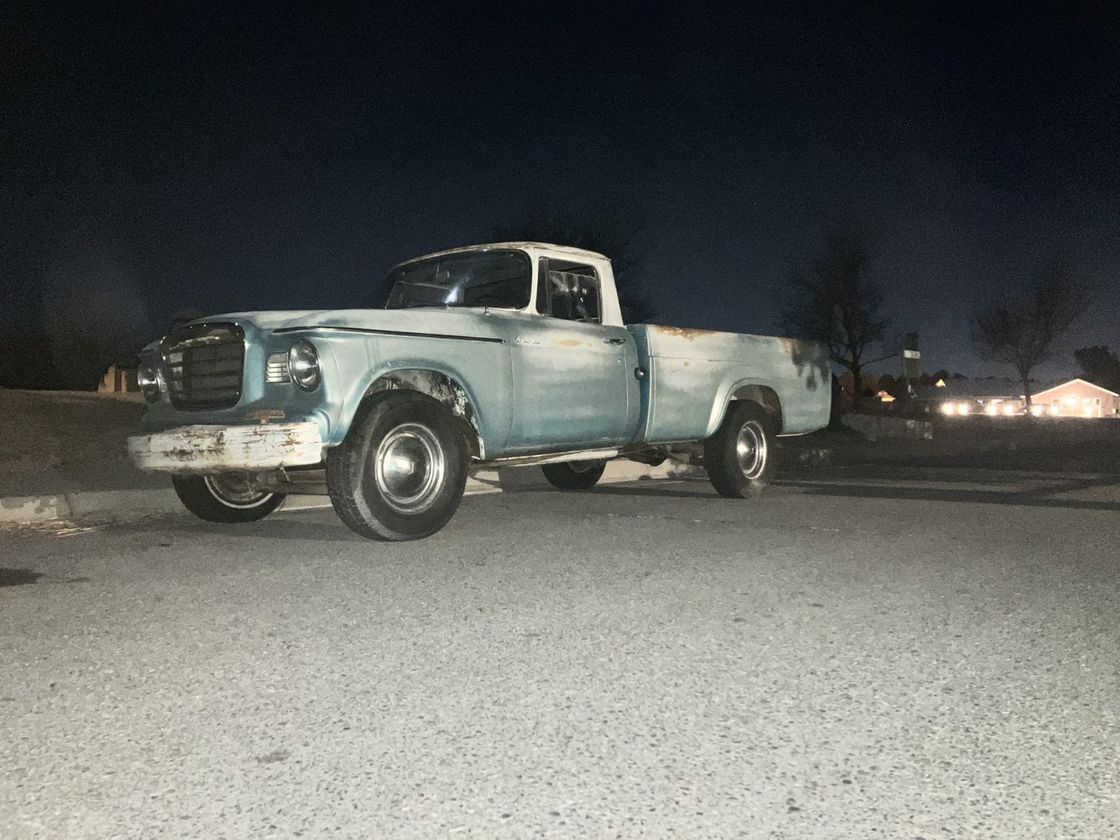

    My Transtar started out (with me) as a scetchy "runner"... it ran but not reliably. The more love you give these Studes, the better they get!
    Here's a partial before & after of what is now my daily driver as motivation to keep going:
