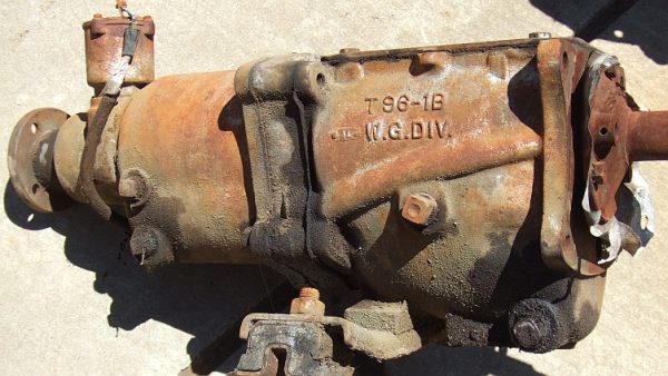

    Good question! Ha-haa... The smart *** answer would it came out of the Lark's trunk along with a bunch of other **** when I first got it home! But seriously, I have no clue. The ***embly itself is in nice condition so I thought I'd see if I could make it work. I need to build a bridge from the firewall to the dash to make it more stable, but that'll be fun to do. The challenge will be the clutch master cylinder. It would have to mount directly under the brake M.C. because of the actuator rod that's on the clutch pedal. I think that'll be O.K. though. I've had good luck with older Ford truck M.C./slave cylinders, but I might try a hydraulic throw out set up on this one... I just don't want one of those new fangled M.C.s stickin' out on the firewall.
  3. Jacksmith

  4. RAK
    Joined: Jul 15, 2011
    Posts: 196
    RAK
    Those swing pedals look like later model Studebaker, the part that you removed would have bolted to the firewall with a M/C on the other side in the engine compartment. If you had a 65/66 bell housing and T86 trans with all of the original linkage you could probably make it work with a little tweaking. Make sure you reinforce the firewall really well where the pedals bolt to it or it will flex. BTW, the 283's in those 65/66's used the GM ram's horn manifolds so if you had a pair you should be able to buy a fabricated exhaust system.

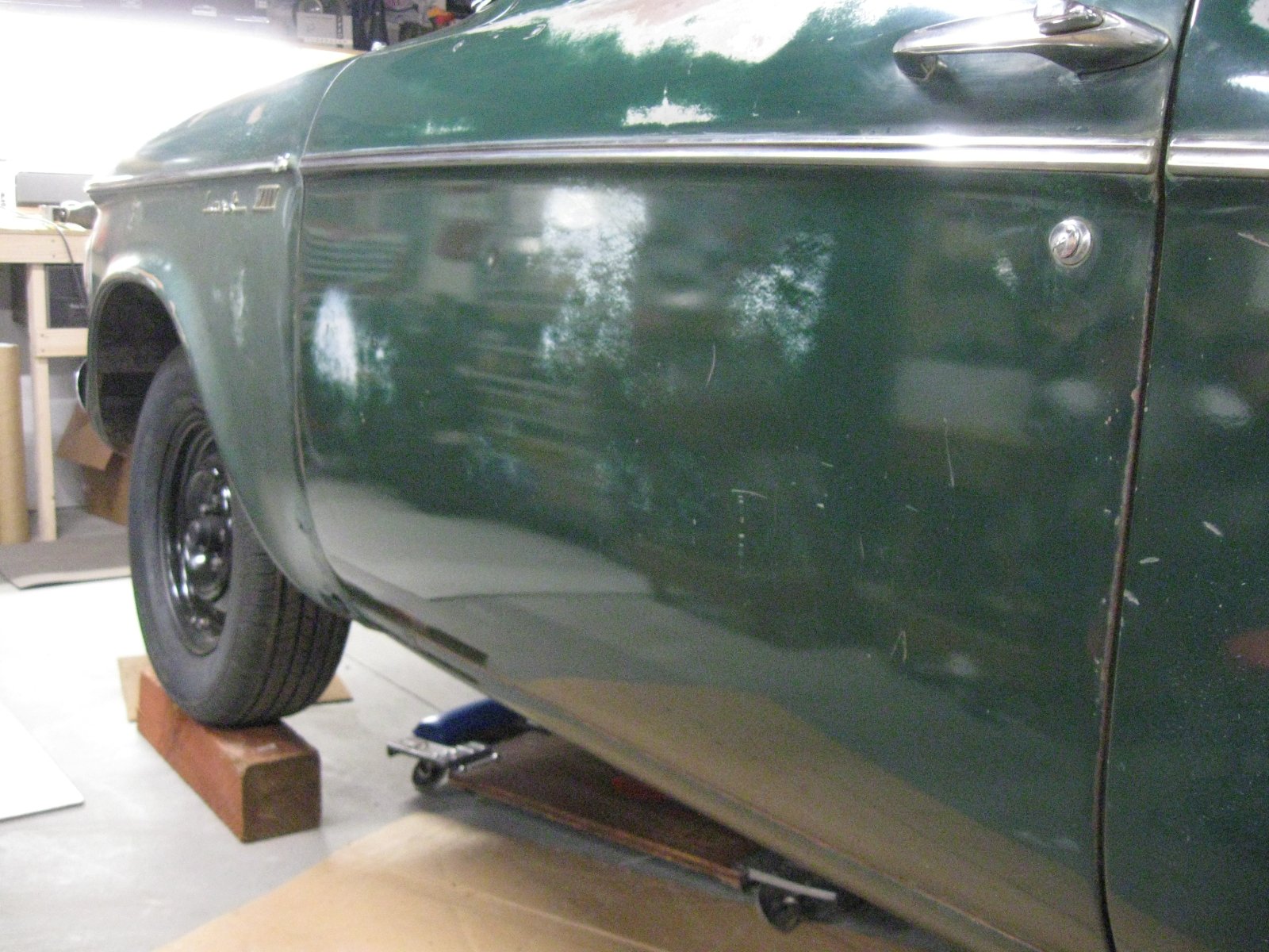

    I also got a bottle of compound from Detail King on the recommendation from a fellow H.A.M.B.er. So I decided to waste(?) some time and do a little cleaning over a couple frosty ones. Boy, I'll tell you what that stuff works well and is easy to use. Check out the results!
    I llllike it! Not waxed, just squeeky clean!
    Greenblade, Chucky, Joe Blow and 17 others like this.

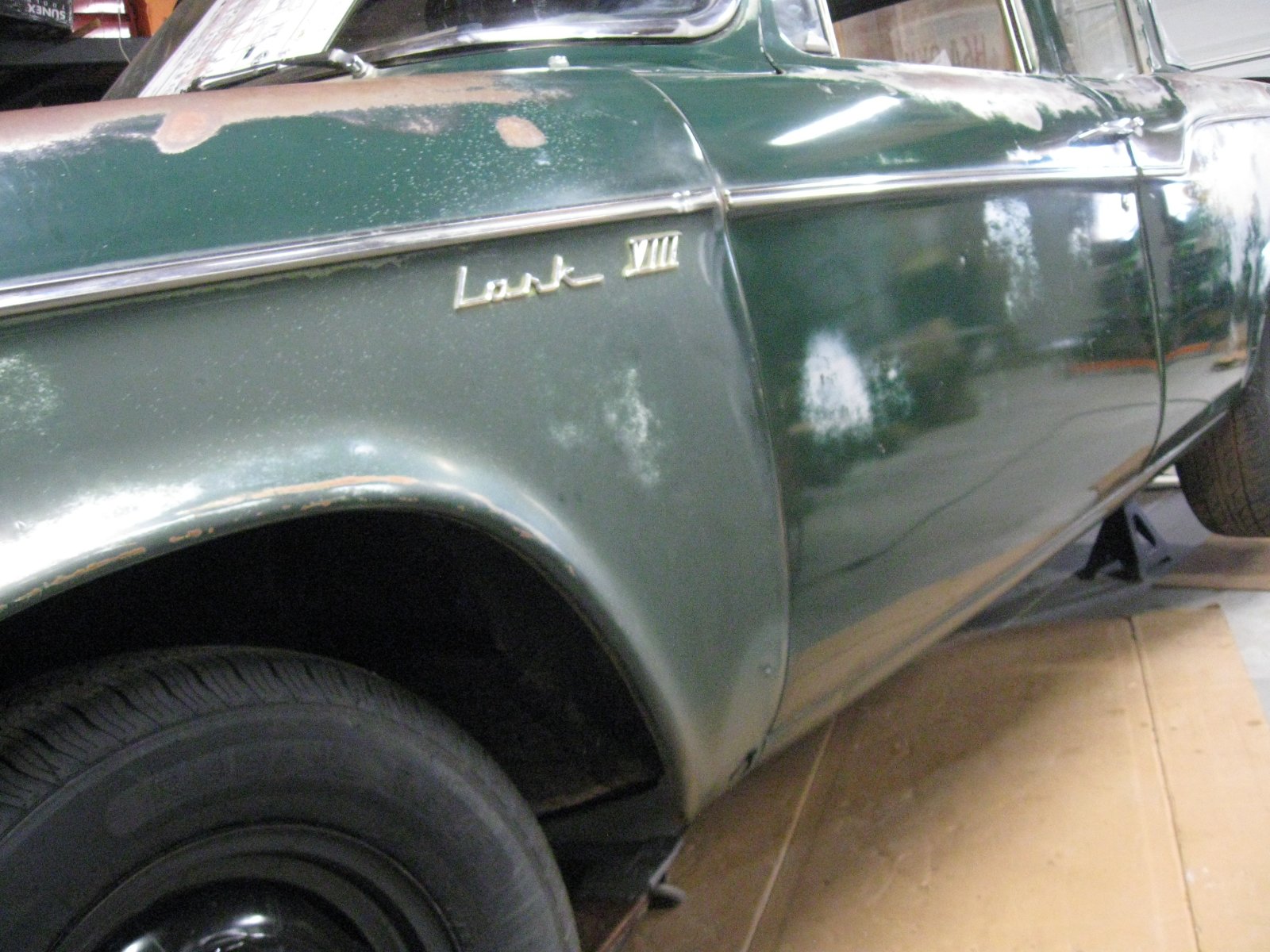

    I got the rest of the "SOLD", that was rattle-canned on the roof, cleaned off... It doesn't contribute to getting the car running, but it was buggin' me...
    and moved underneath to get back on the exhaust system now that more parts arrived. I'm using ball & socket connectors to facilitate flexibility on routing the system as well as the ability to easily remove a section of the system for repair & maintenance in the future. It'll need to go around under the trans x-member utilizing some 45 degree pipes. IMG_1726.JPG IMG_1727.JPG

  9. bobbytnm
    Joined: Dec 16, 2008
    Posts: 1,828
    bobbytnm
    Wow, that paint cleaned up nice!
  10. Jacksmith
    Joined: Sep 24, 2009
    Posts: 1,876
    Jacksmith
    from Aridzona
    I know, right? The car is still kinda ratty, but at least it's clean!

  12. RAK
    Posts: 196
    RAK
    Did you use a machine to buff that paint? It looks great!
    Six Ball likes this.
  13. Jacksmith
    Posts: 1,876
    Jacksmith
    from Aridzona
    I used a random orbital buffer with a sponge pad and Detail King's compound.
    Back on page 4 there's a shot of the top B/4 the "SOLD" was cleaned off.
    Too bad the car baked out in the Arizona sun for 30++ years... the paint that's still there shined up nicely. Oh well, I've got a look that others are trying to achieve, Ha ha.

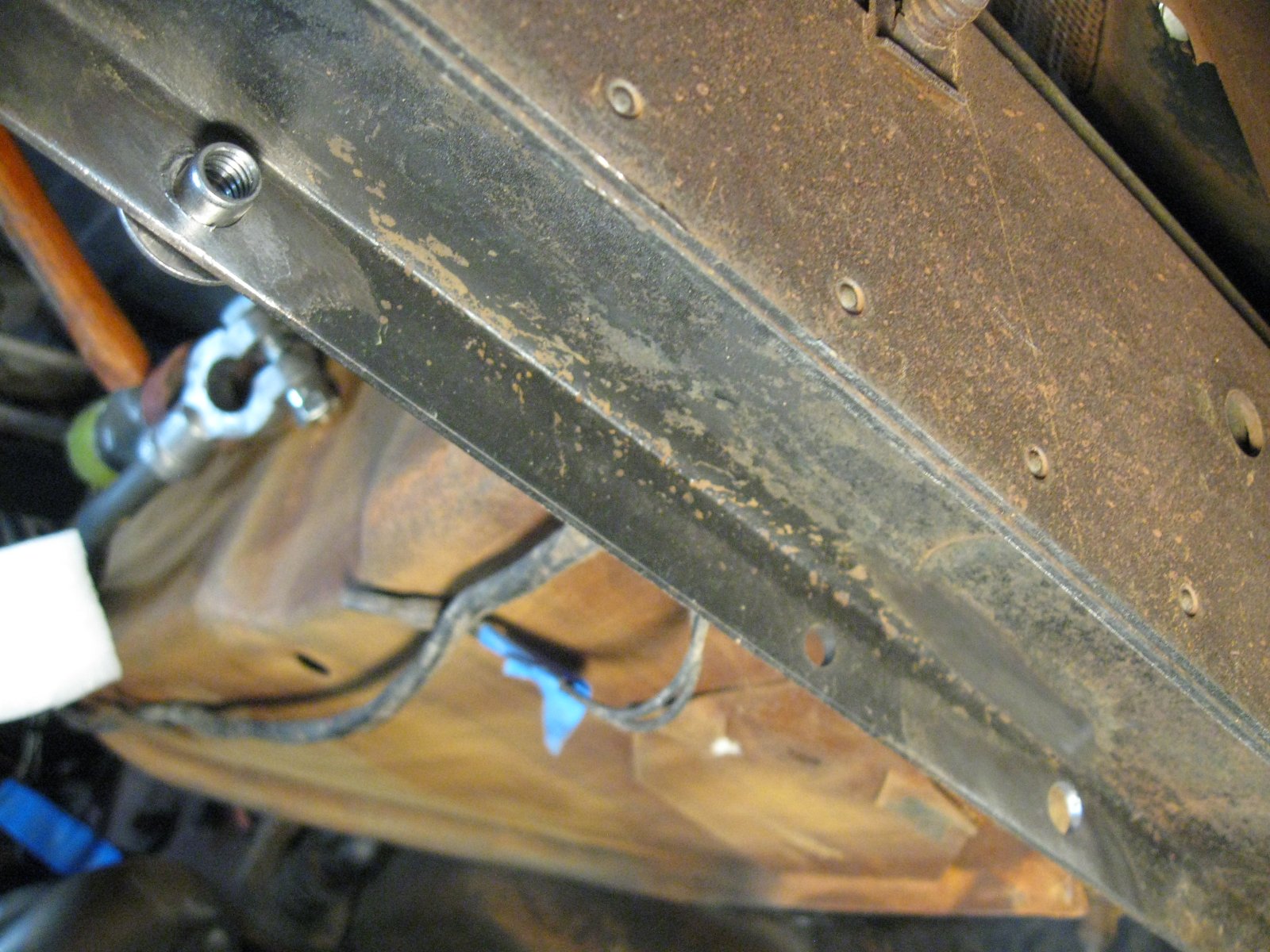

    I got a tip from a buddy that a radiator intended for use on a Jeep CJ, re-powered with a S.B.C., would be a close fit in an early Lark. So I did a little research an lo & behold he was right. I schmoozed around on the inter-web and found an outfit in Crazy-fornia that makes just such a component. They showed dimensions, etc, and it looked like a good match... so I took a leap of faith and ordered a 4 row aluminum radiator. Two days later (today) it showed up and it's all I hoped it would be! So... one more step in the right direction. I plan on painting it black if I can get my hands on some satin epoxy, which by the way was M.I.A @ 6 stores I visited today. Anyway, with some spacers and a couple new holes in the core support I should be good to go for cooling.

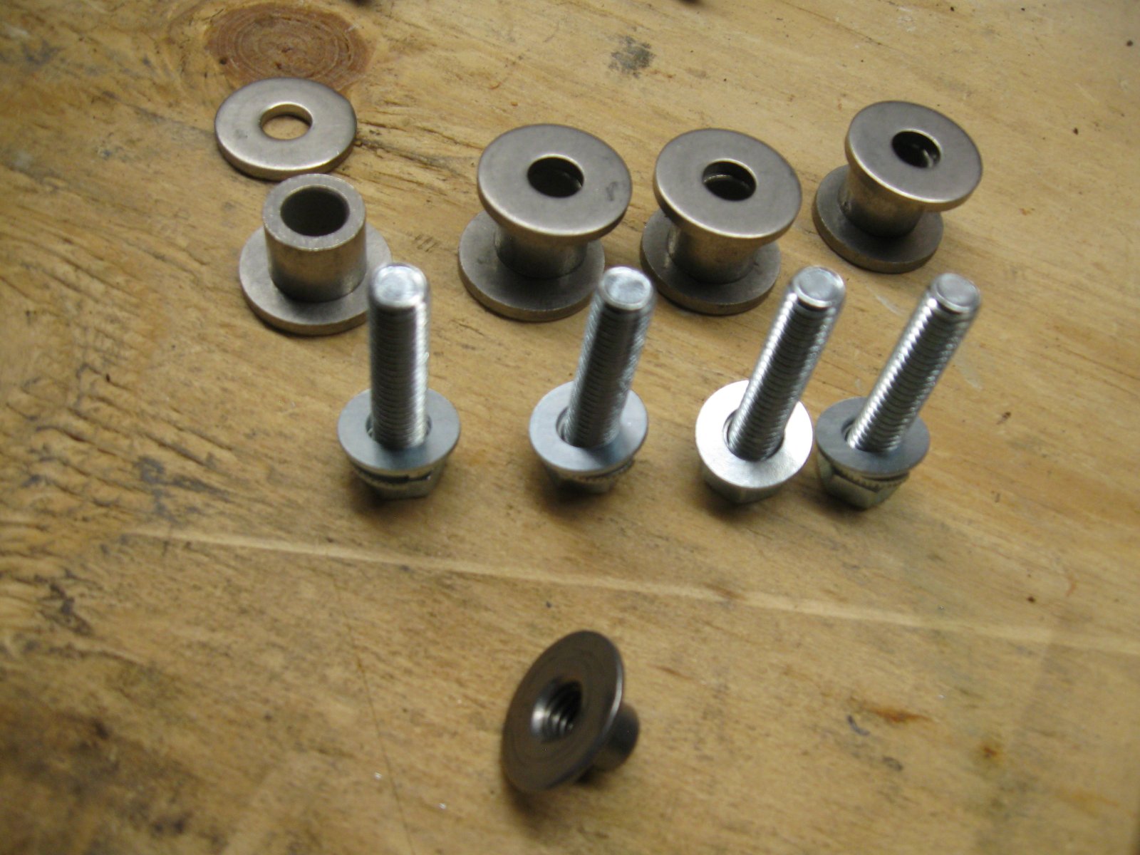

    I double checked all my clearances between the core support, hood and what not one more time. Remember; "Measure once, cuss twice"... The mounting points were marked & drilled. I used weld in thread inserts, heavy washers and spacers to put the radiator where I wanted it. The fan & hoses come Friday.
