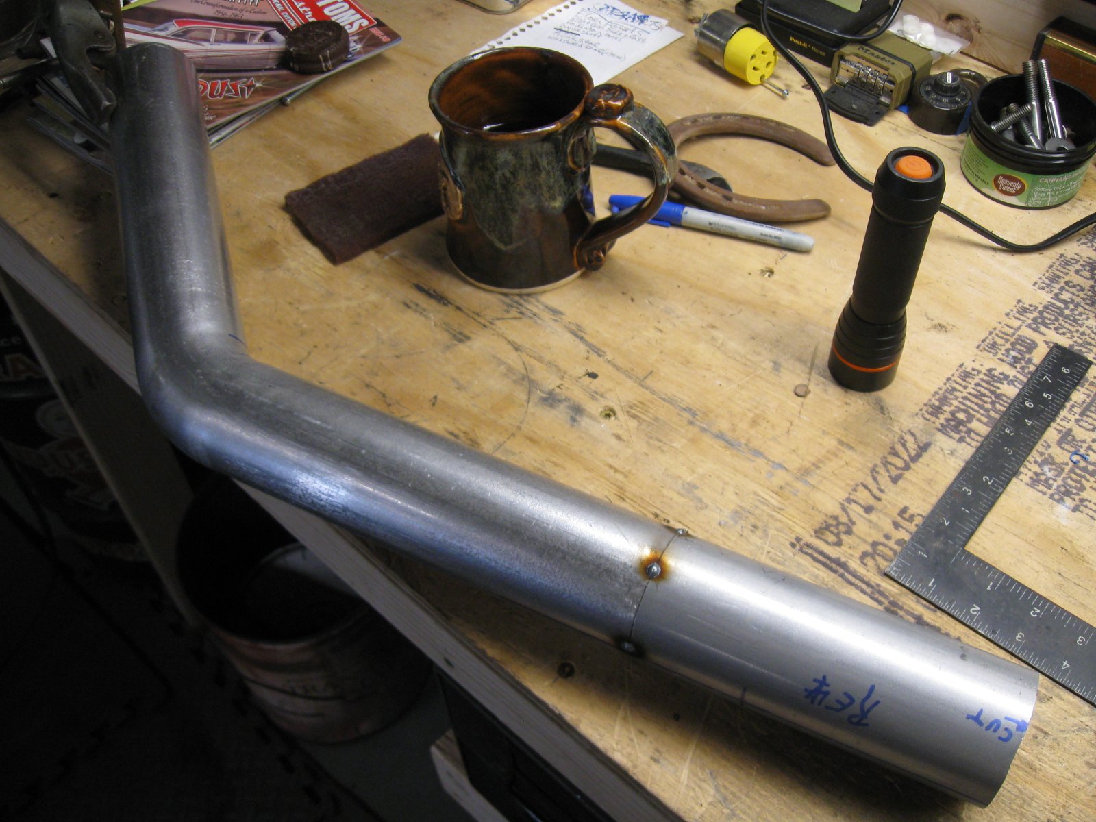

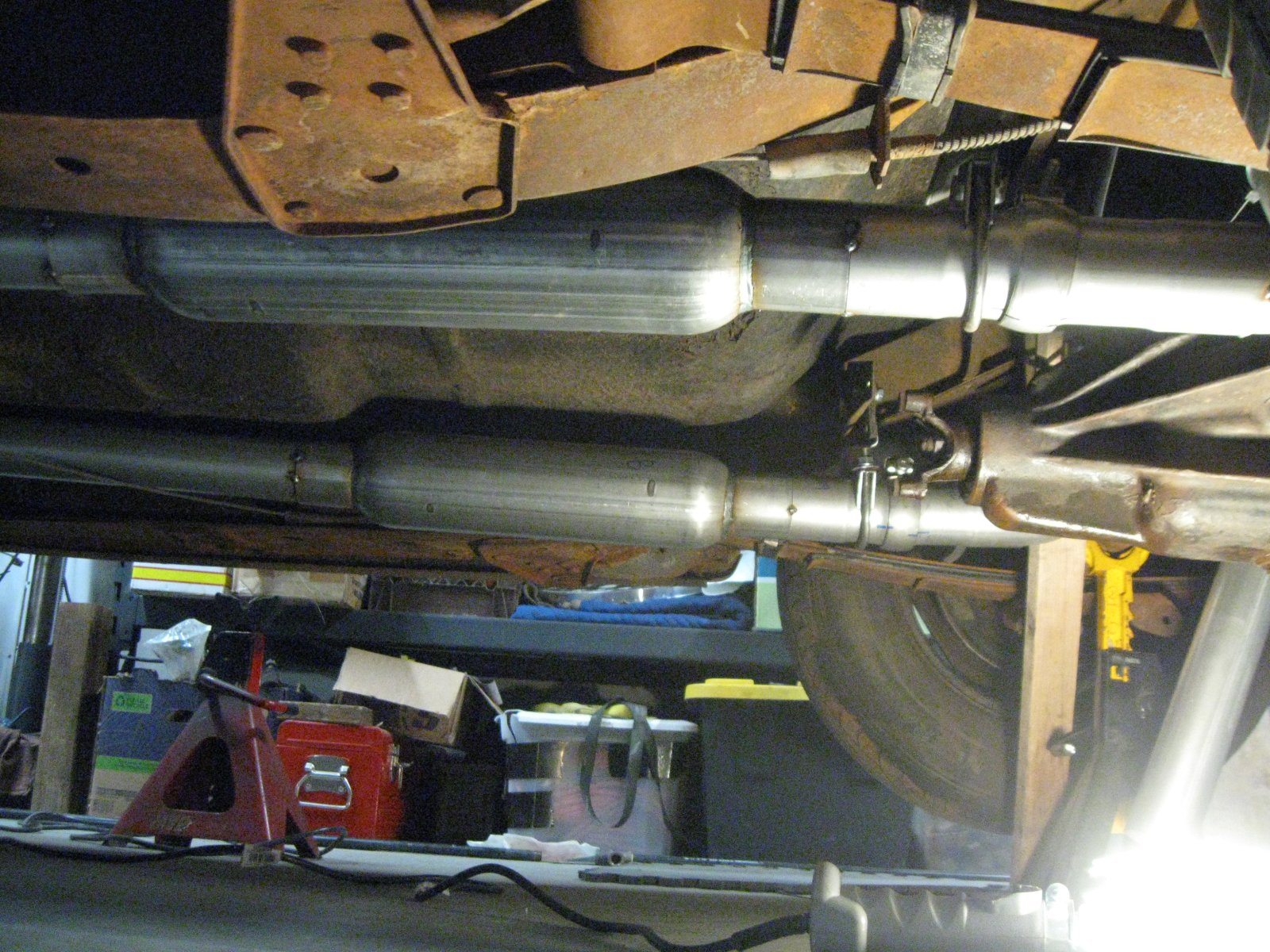

    The 90 degree exhaust pipe has been tacked to the collector and the ball & socket joint is in place. A short straight pipe is joined to a 45 degree pipe to get around the trans cross member. IMG_1769.JPG IMG_1770.JPG IMG_1771.JPG
    Now a second 45 pipe is trimmed and tacked in place.
    Next another straight pipe will be cut to place the muffler.
    Joe Blow, egads, Ragged Edge and 5 others like this.
  7. Jacksmith
    Joined: Sep 24, 2009
    Posts: 1,876
    Jacksmith
    from Aridzona

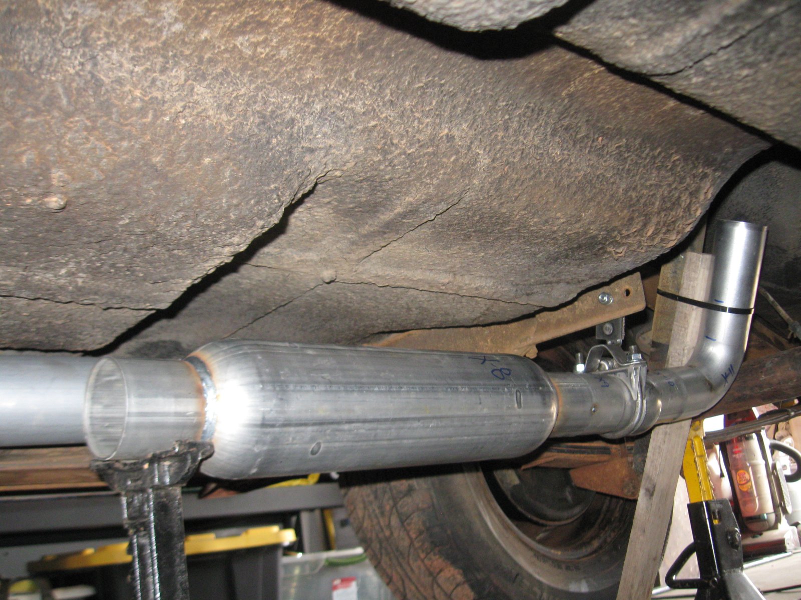

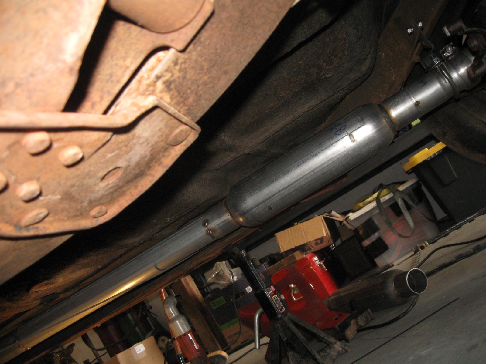

    A ball & socket joint was tacked to the muffler and trial fit. Then a 90 degree bend pipe to mate with a U pipe, to go over the axle, was trimmed, tacked and trial fit.
    It was determined that the U pipes would run parallel to the rear shocks. A piece of 2x3 wood was used to maintain clearance.
    After measuring and cutting the exhaust pipe a couple pieces of angle iron were secured to the pipe to keep it straight & tight.
    After building the other side and installing the gas tank, the U pipes and tail pipes will follow...
    Joe Blow, egads, Ragged Edge and 7 others like this.

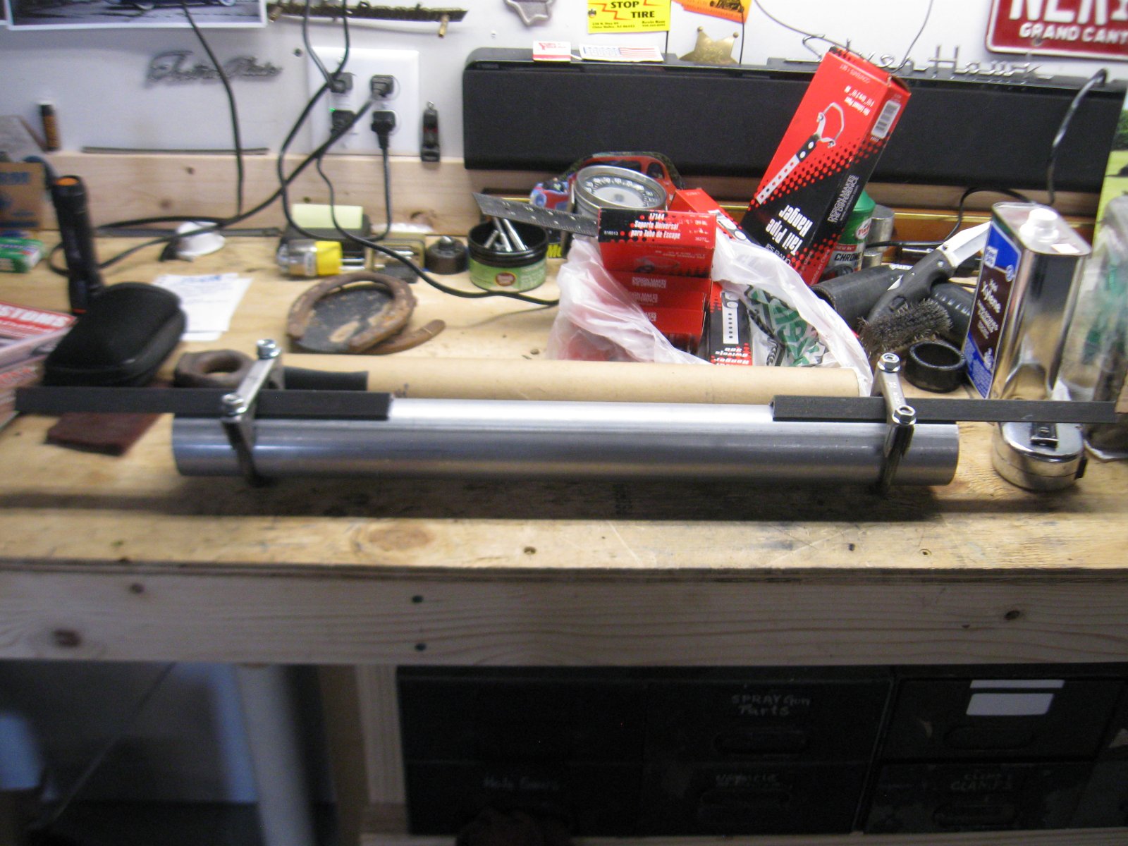

    When working with exhaust, angle iron and tubing go together like peanut ****er and jelly!

    More of the same, just on the other side. IMG_1797.JPG IMG_1810.JPG IMG_1812.JPG
