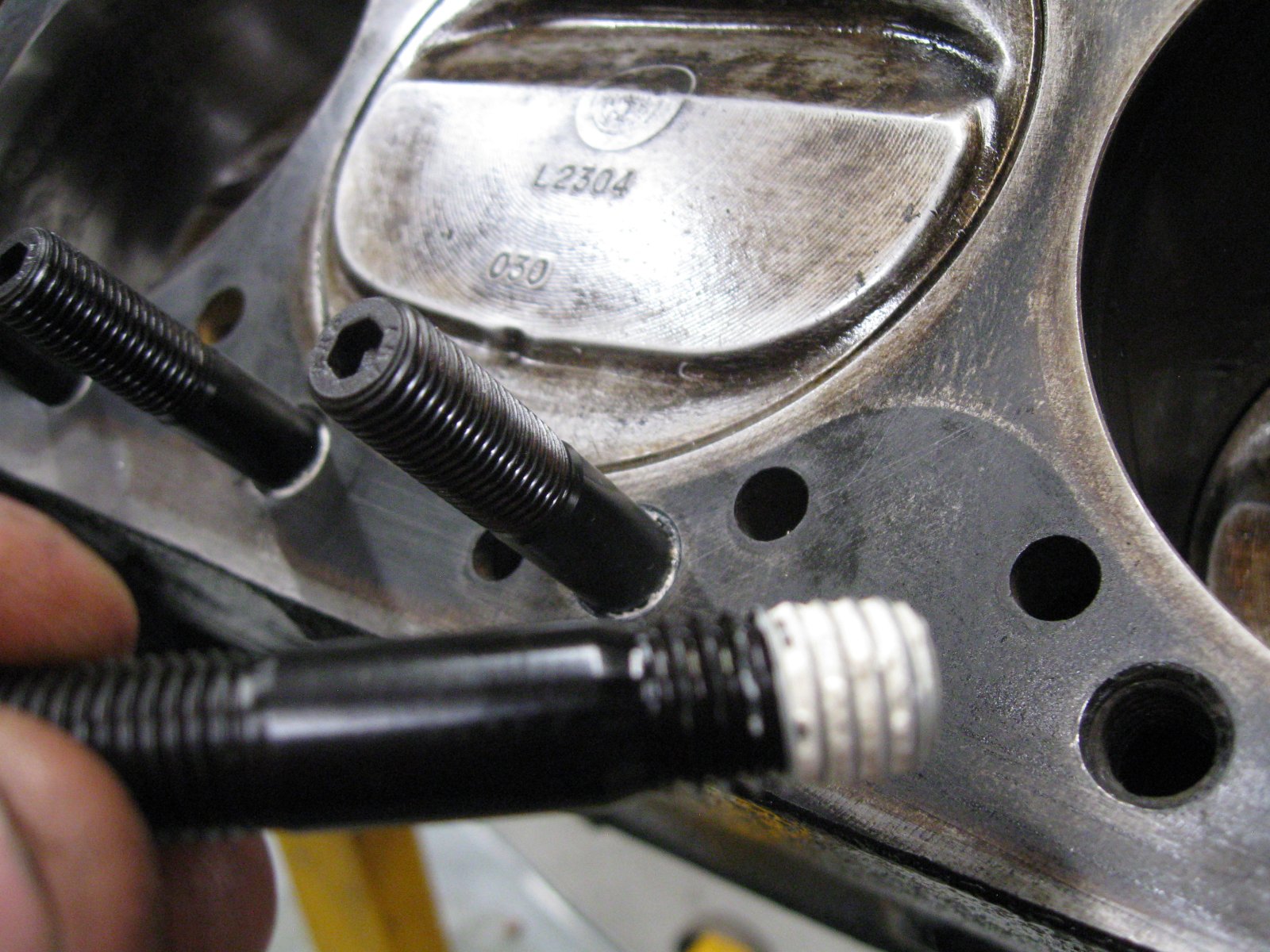

    For a change of pace I decided that I'd start the clean-up & upgrade of the engine, so out it came...
    With the block cleaned and a coat of paint done, the head studs are installed. IMG_1926.JPG Engine mounts got a set of Mr. Gasket bolts I found in the bin... IMG_1927.JPG
