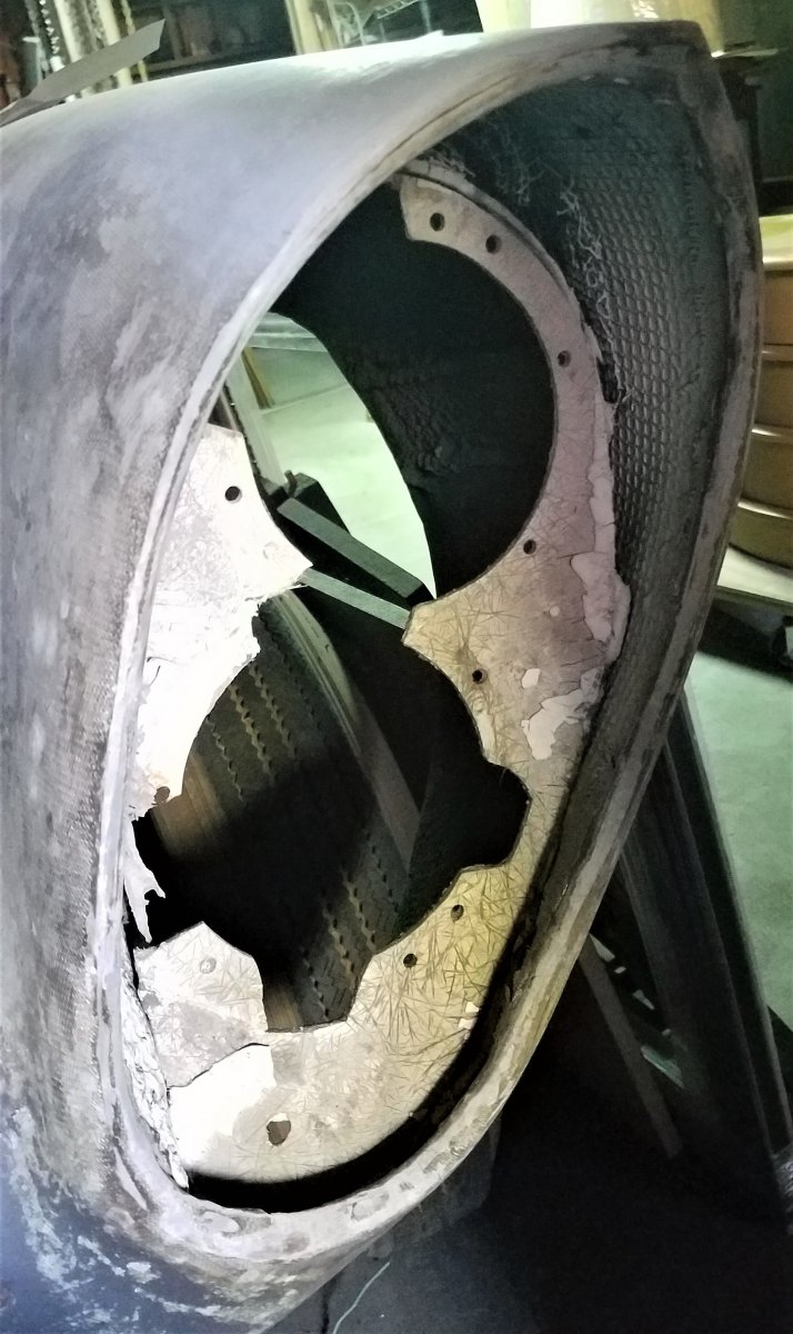

    It looks like the actual headlights were mounted to a fiberboard of some kind (maybe not something heavier because it was built for show?). The drivers side has a couple of breaks but the p***enger side is intact. I was thinking about making the backers out of metal or finding some original 58 Lincoln mounting brackets to see if they can be adapted to work. Might take a while to find them but in the long run it might save time and work better. Then later I'll get the Lucas lights. Any thoughts? 20200325_182105 (2).jpg 20200325_181725 (2).jpg

    @Moriarity built a few he would have a good idea or two...perhaps gl*** in the Lincoln backers your suggesting...Maybe that is Hardboard or that may be what your saying it is just by a different name. OEM backing would give you adjustment and of course a more robust mount.
    It will not be seen therefore no points off I think...:confused:

    I'd be tempted to replace the hardboard with fibergl*** piece cut to shape and gl***ed to inside fender from the back side. reinforce as necessary.

    That is a possibility. I want to check out an original piece to see how it's done from the factory because the bezel has a bracket at the bottom and 2 screw holes at the top. None of those mounting points still exist. If anyone has a pic of the original headlight brackets, please let me know.

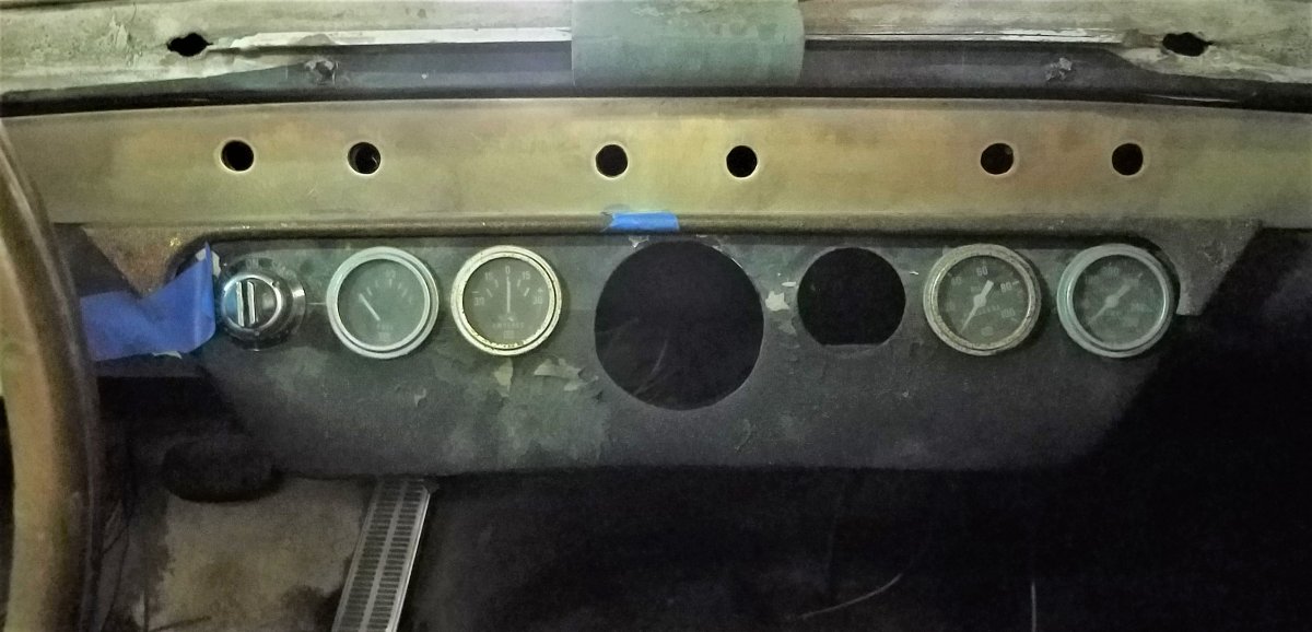

    I tend to jump around on a project, so while I'm waiting to find original headlight buckets (see above).....I started checking out the dash. Several of the interior pieces were mentioned in the magazines to be gold plated. I have the long metal piece above the gauges with 6 holes for switches (this was gold plated). It was showing way too much patina, so I cleaned it up a bit. It still needs to be re-plated. I also found 2 wooden pieces in the trunk that were painted gold metalflake. Turns out it should have been one piece. 20200327_140728 (2).jpg 20200315_160939 (2).jpg 20200315_170139 (2).jpg

    Then I test fit the pieces on the dash. Notice the 2 humps on top of a stock Corvette dash have been removed. The wooden pieces go around the gauges but the bottom part has gone missing. I'm hoping to see enough of what should be going on in the magazine spreads to re-make the wood panel. The area below the gauges has been extended down. Originally, the bottom of the dash was higher and followed the bottom curve of the gauges. The six holes were said to be for Jaguar push/pull switches, but I have no idea what they were for. 20200315_165857 (2).jpg 20200327_164310 (2).jpg
