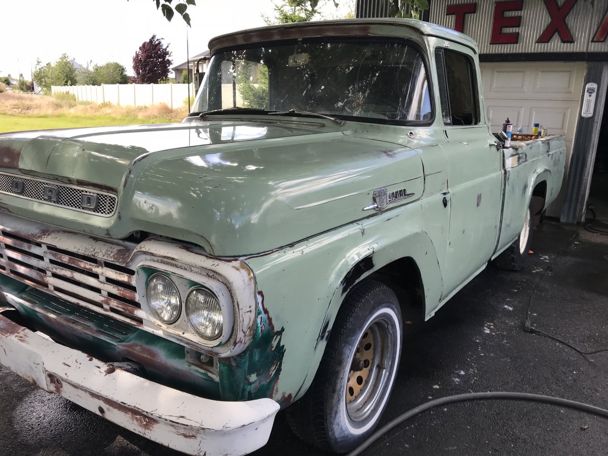

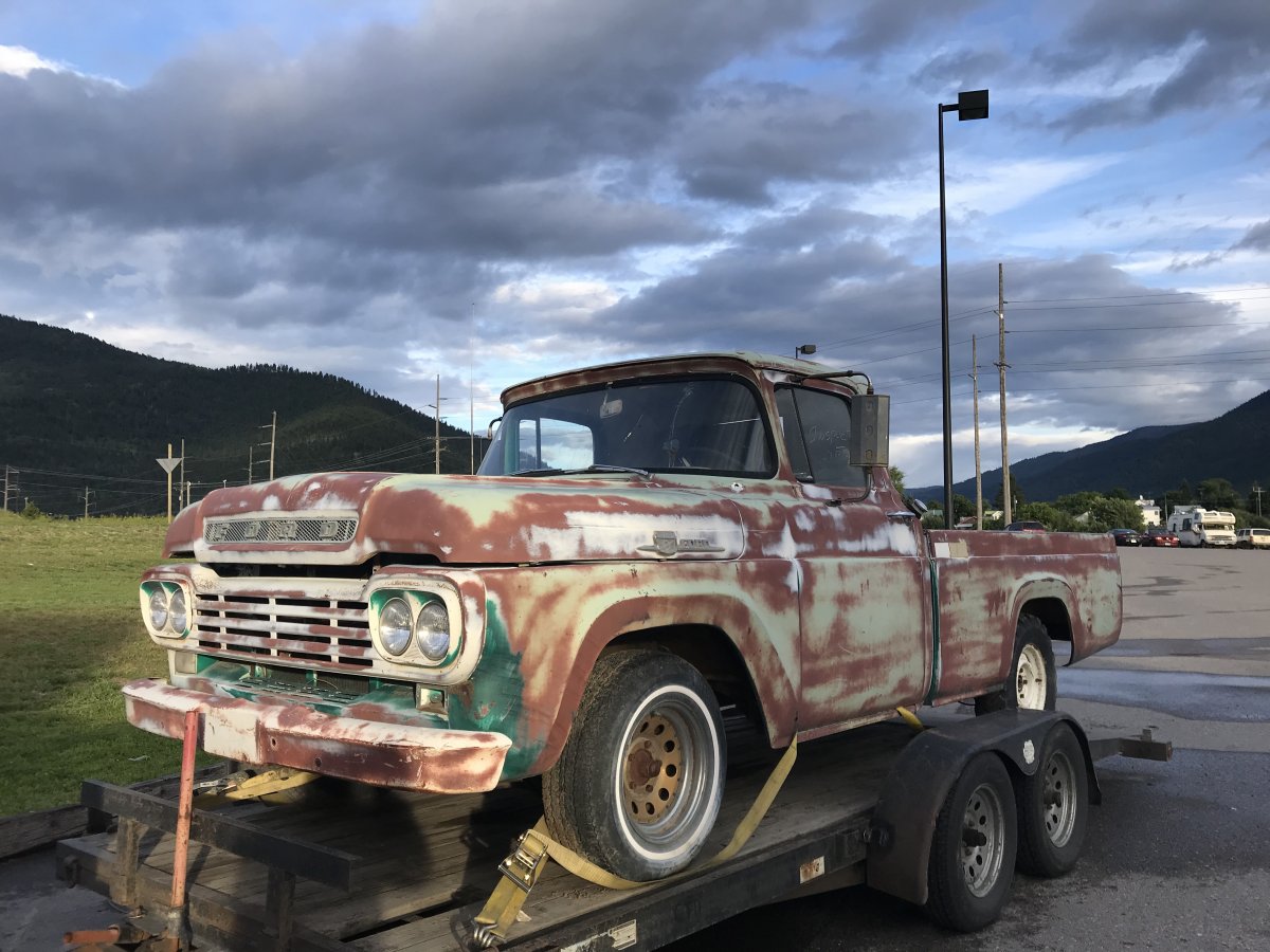

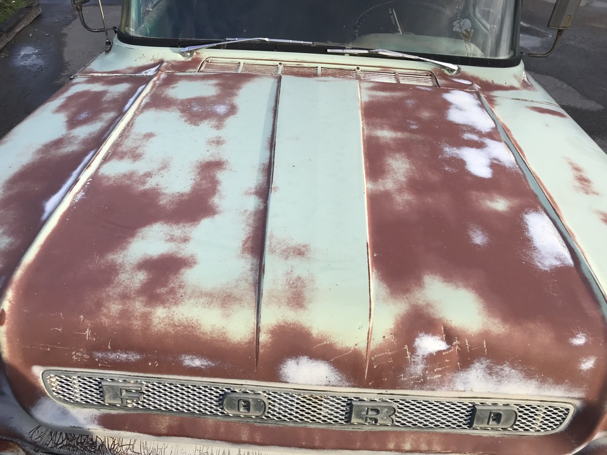

    I bought this 1959 F-100 a couple months ago...I have a 1960 factory 4x4 that the body is pretty toast, and for the past year or so I’ve been looking for a nice original 59 or 60 long bed pickup to use the 4x4 running gear from

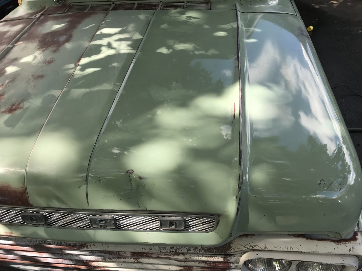

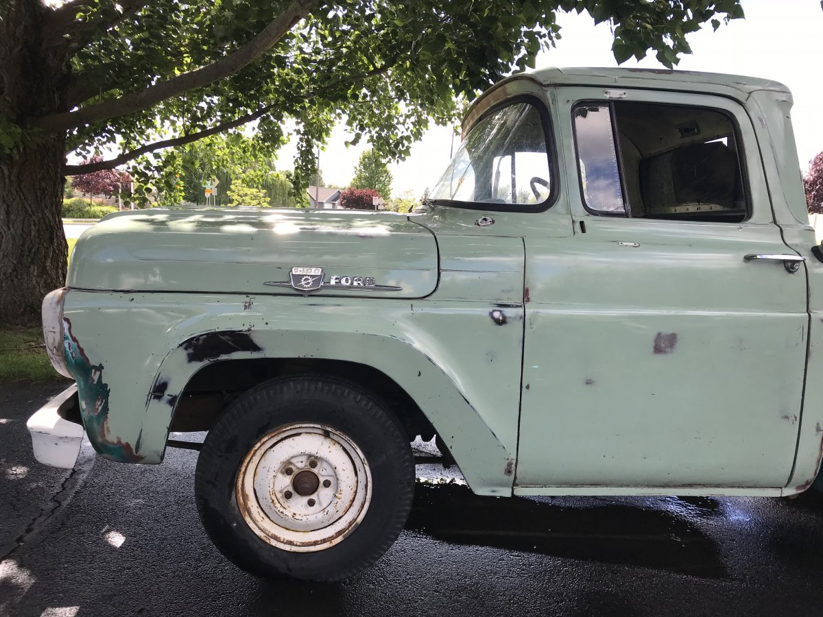

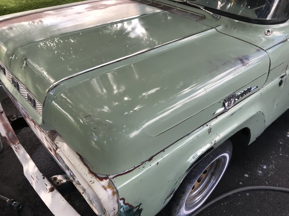

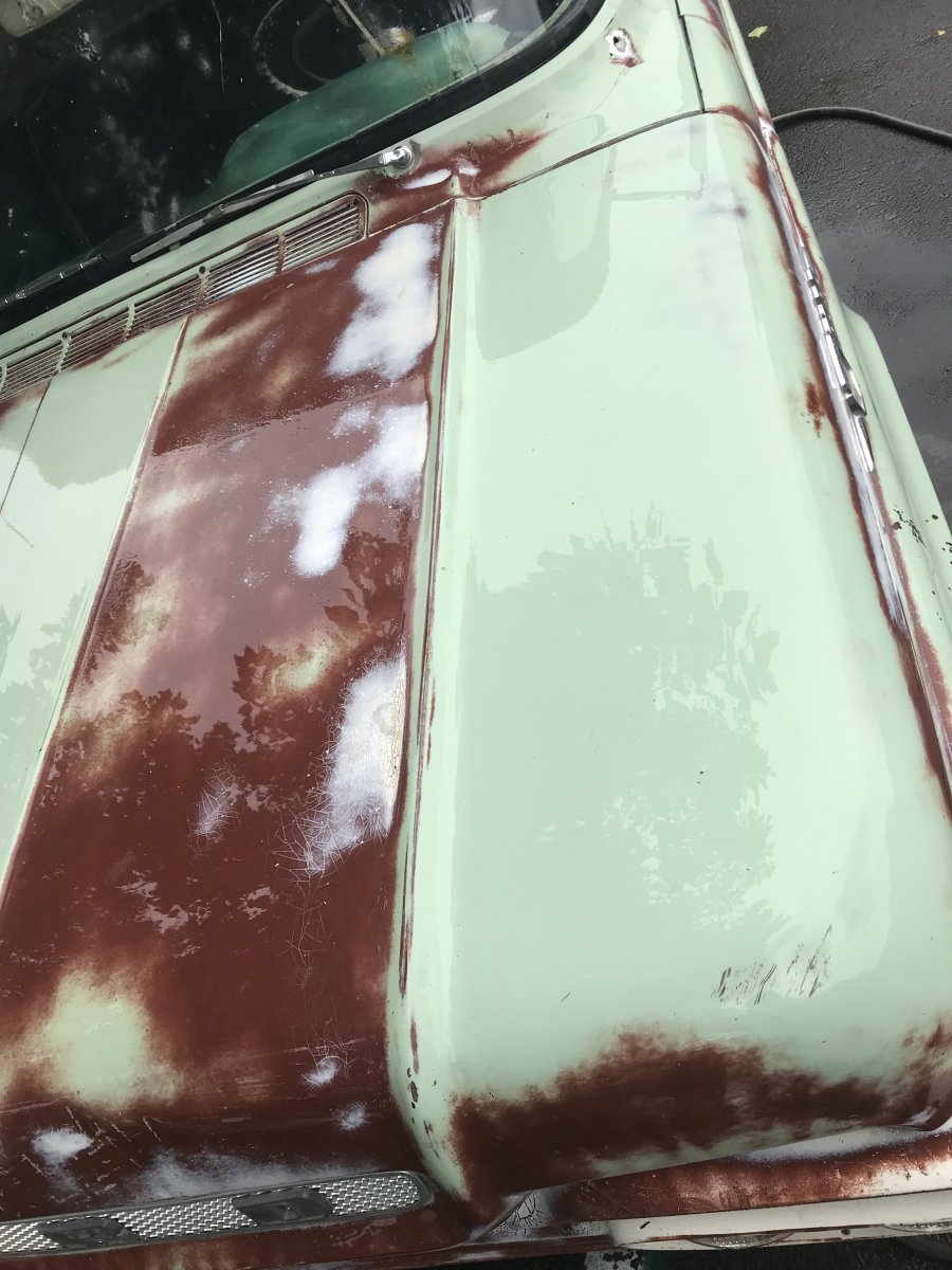

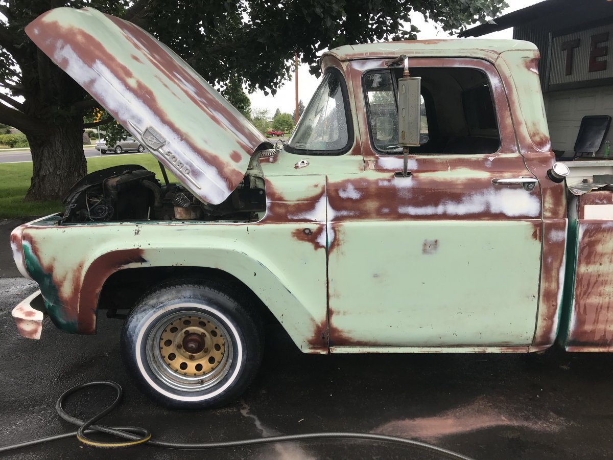

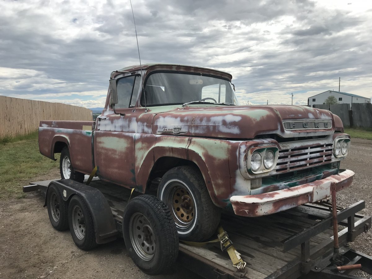

    This truck popped up for sale over in Montana. I bought it off of 8 ****py pictures. It looked strait and I did t see any bad rot. It was also cheap enough that o figured if worse comes to worse I could part it out and get my money back. The seller called it the “ugly truck”. So Friday my wife, kids and I drive to get it. I got it home and got a good look at it. It is very strait, and has very little rot. So I was happy. At some point in its life someone primered it. They may have even painted it...as there is dark green and white paint in places. I’m thinking someone did this and then it sat in the dry climate of MT and over the decades the paint and primer slowly wore off.

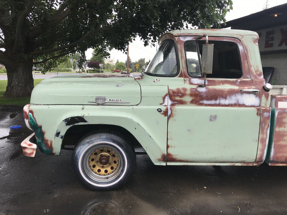

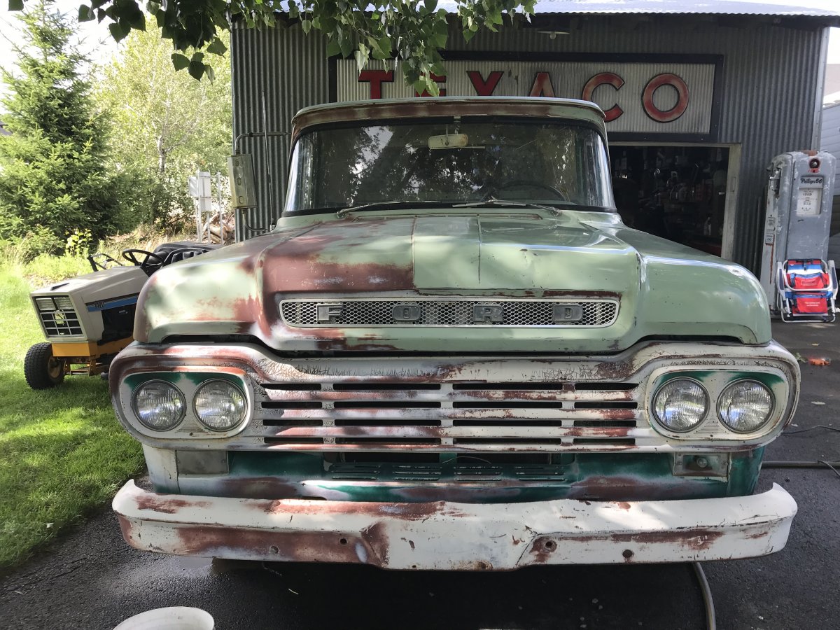

    I started with wet sanding. Using 1200, it was slow but removed the primer.
    Then I tried oven cleaner. That did the trick. It softened the primer so that it basicly wiped off and a little wet sanding was required. I finished half of the truck yesterday, except a few touch up areas. I buffed it with rubbing compound and then a polish. I am amazed at how nice the original mint green paint is. The primer put over it probably saved it. Still have to do the other side, grill and back of the cab. But a fun project I thought you guys might like.

    I just really like bringing old cars to life. The paint is thin in spots...the black on the front fender is the factory primer. The paint on the bed is really thin. But, I'll just leave it how it is for the most part. The whole idea was one that didn't need any paint and body work. I like the charm old original paint has, even flawed. I just got lucky on this truck, no body work, bondo, repairs...just factory paint with spray paint over it.

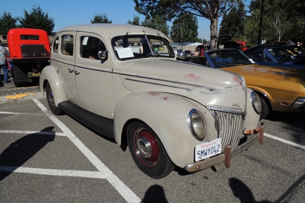

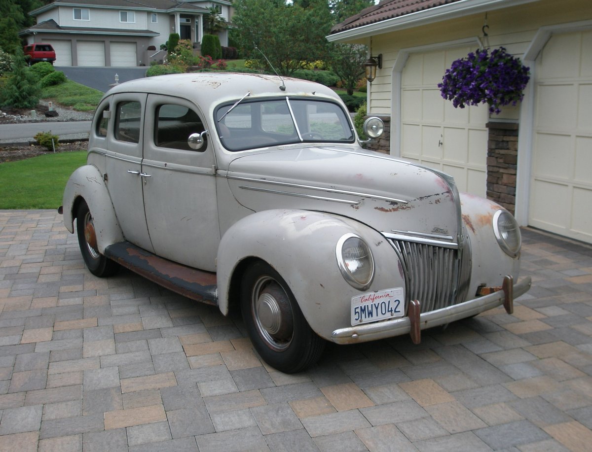

    A few years ago when I had the '39 four door I did something similar. The OE paint was maroon, but someone had done a very thorough color change to Folkstone Grey. That in turn weathered, and due to dumb storage with a plastic tarp, it had mild surface rust in places. A couple days of clean up similar to what you're doing, and just enough buffer work to bring up a mild shine and the car looked old but cl***y (to my eye anyway).
