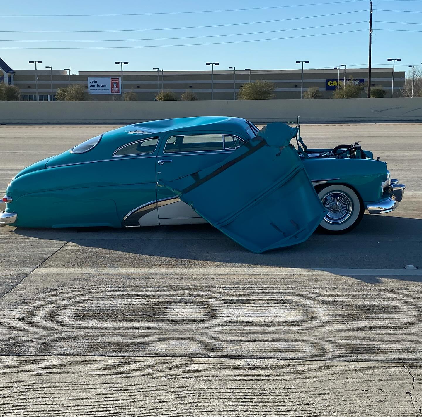

    “Well, we had a nice episode this morning at 70’s mph  the rod that holds the spring off the hood they come from the manufacturer, broke off, just broke, bounced off the roof several times off the side of the car couple of times.
    But thank God nobody else got hurt I didn’t get hurt see what the insurance is gonna say next week sorry guys we will rebuild.”

    Are they talking about the safety catch for the hood? I've seen a few hoods with those missing, they're not very beefy. But that would mean the latch pin pulled out, too. Not sure what happened there, exactly. Bummer for sure, but not un-fixable.

    I zoomed in and you can see the latch with the spring just above the front of the fender, still in the cowl. It looks like the retaining bolt came/pulled out of the hood latch mechanism and there was nothing left to hold the hood down. That is a shame as it looks like it was a very nice custom. Thank goodness nobody was hurt and they plan to rebuild it.

    I have heard shoeboxes are notorious for this happening, really need to put a back up pin on mine. Would kick myself if I knew and didn’t do anything about it and something happened right.

    In 30 years of racing I reckon that every single season I’ve seen someone’s hood make a bid for freedom.
    You always need a failsafe in my mind. It’s just not worth removing the safety catch.

    That didn't just pop open, the whole latch ***embly pulled out of the hood. Mercury hood damage.jpg

    ~'53-'64 C/K Studes have a similar problem. Crummy latch, to say the least. So yrs back(decades, actually) the solution was, & is, to loop chain thru the hood-bar & the latch panel. Some guys use plastic-coated aircraft cable. Then use a padlock to secure it. Sort of a theft-prevention, but mostly for hood hold-down guarantee. Also kinds rattles... but beats kinked hoods... Folks also use a whole different latching ***embly also. Depends on what you want.

    Unless the piece that held the pin and spring was comprimised to begin with it took a lot of air pressure to pull that piece out of the hood bit I'd have to believe that the safety catch was not working right or missing. This being s found on the net photo showing thr catch.
    When I had my 51 Merc the catch worked but you had to set the hood down gently , push the latch back, get your fingers out of the way and close the hood. It didn't always catch the first try. 1950-Mercury-Monterey hoos latch.jpg
