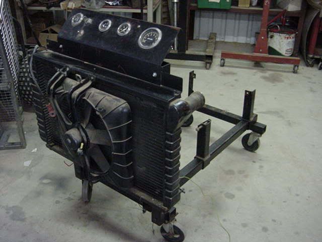

  16. Lobucrod
    Joined: Mar 22, 2006
    Posts: 4,121
    Lobucrod
    Alliance Vendor
    from Texas
  17. Here's one that works well. They've had a small block, a big block, and a Pontiac 400 on it so far.
