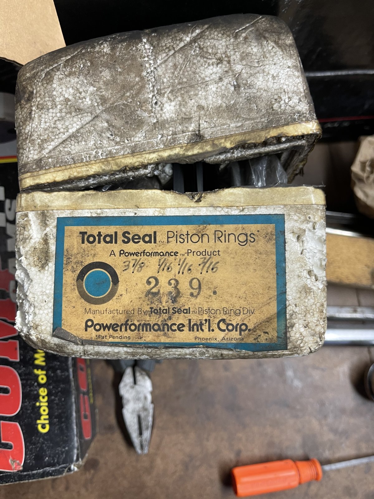

    One set takes 1/16, 1/16, 3/16 piston rings. I have a NOS box of Total Seal Rings part number 239
    but am not sure if these are drop in or file fit, unsure how to tell (I have email off to them).
    I don't want to spend the time on file fit rings, does anyone make a drop in set of these?

    post a picture of the label on the box.
    The TS rings that are file fit usually say .005 don't they?

  14. Total Seal rings should be file to fit. Easy to tell stick a ring in the bore and straighten it. File to fit will be evident.

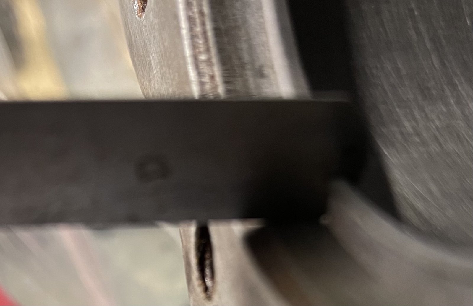

  18. The rings I have are not file to fit, they are cast and stepped with a two piece ring for the top groove. I was able to speak with tech at Total Seal, guy I spoke with has been there 23 years and never has seen these as they were befor him. He said check gaps and run them, just checked one and it is great. I will check the rest later.

    Take one out of the box, check it in the bore and party on

  28. I made up a wooden plug years ago that puts the ring into the bore, 1" below the deck. That is a reasonable depth I use for checking gaps. I forget if my Speed Pro pistons came with rings, the shop I used assembled the short block.
