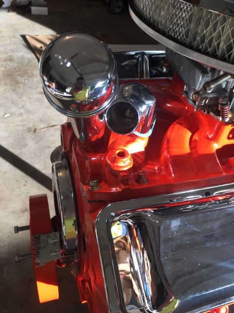

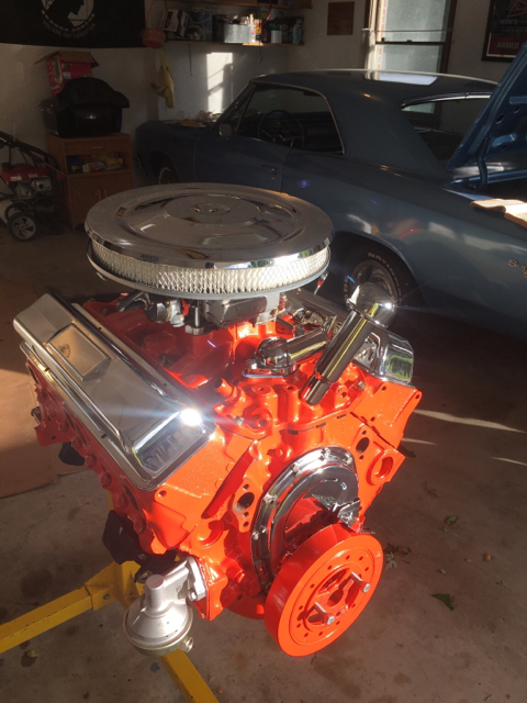

    Mocking up on my 327 and found that my thermostat housing and oil filler tube are so close I can't get a radiator hose on it, have a thermostat housing for a early Chevy that is straight out and at a 45. Any ideas on a radiator hose that will work with a early sbc thermostat housing etc etc?
    Radiator hose attaches to the radiator on the driver side. [​IMG]

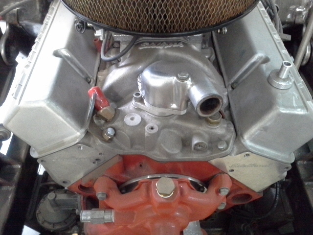

  12. IMG_0512.JPG Hey OP, is that an edelbrock intake? If so use the straightforward housing, it will clear the fill tube. then just shop for a hose. I've taken old hosees and cut out the shapes I needed then duct taped them together when you have the "hose" you need take it to the parts store to compare. Nice chevelle by the way!

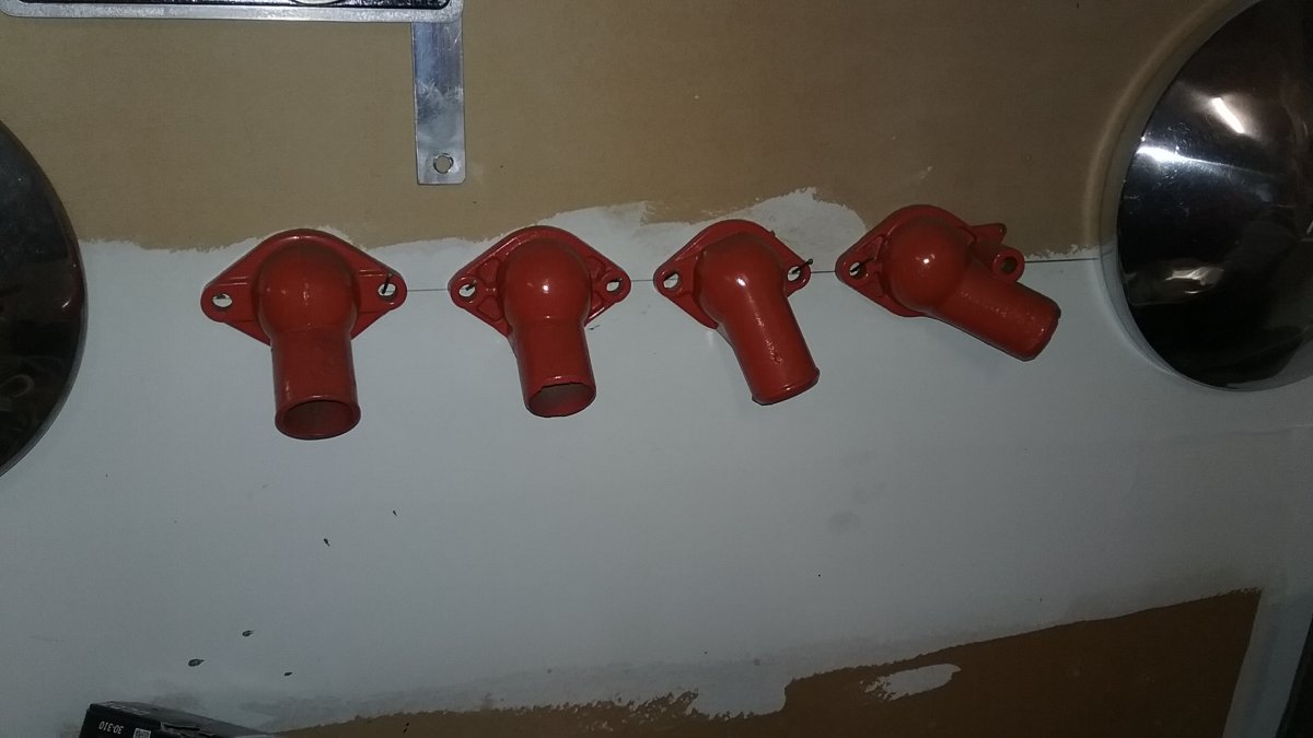

    I'm always on the look-out for these in case I ever need 'em. Got 'em hangin' on the garage wall. 20170505_071253.jpg

    ........So true, Jim. I think the chroming process warps them. I've seem 'em right out of the package with warped mounting surface.
    olscrounger and lothianwilly71 like this.

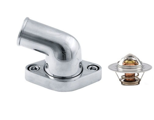

    This is kind of slick, used it recently though I painted it Orange so it wouldn't stand out as bad. This water neck swivels and clamps down when the bolts are tightened so it virtually can be set any degree. Polished aluminum costs $27 at Jegs http://www.jegs.com/i/Allstar-Performance/049/ALL30173K/10002/-1
    , chrome ones are cheaper but should be avoided.
