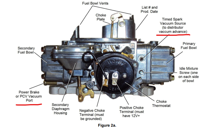

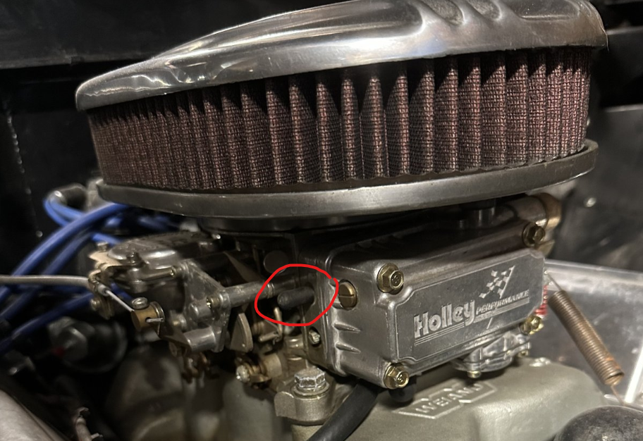

    Thanks, just getting to this now. So the truck with the SBC 350 and rochester carb ran way better off port, no stumble like before! Thanks for helping me get that fixed.
    This SBC 350 with Holley is in my Shoebox Ford. Just noticed the distributor had no vacuum running to it and no PCV. I bought an AC/Delco PCV and grommet and will run that along with one of the breathers. I will run the distributor to port on the Holley carb as you suggested.
