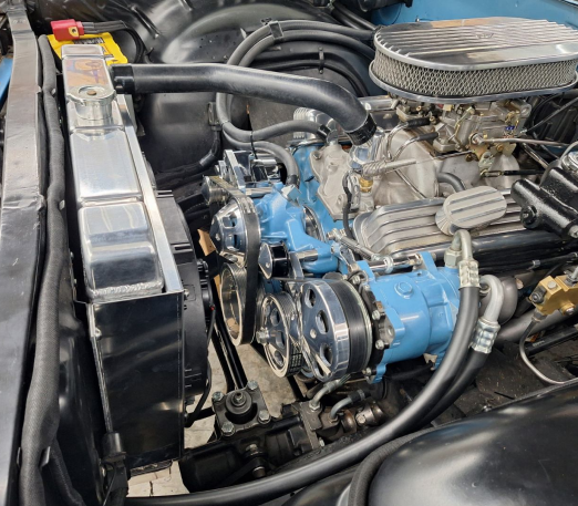

    Got a situation that has me a bit baffled looking for ideas.
    Recently swapped radiator in '61 Impala with a oversized 2 core aluminum Cold Case with 2 11" electric fans and shroud.
    The issue that I have run into is it will get hot at highway speeds or underload, going up hills and running the a/c also while on the highway, however, it will sit in traffic all day, cruise a around a show, idle in the garage and never have an issue. It has never gotten so hot to puke or blow by the cap.
    Things I have tried and details.
    • Originally had a 160 thermostat and the temp would swing from 180-220. Fans would shut off when gauge showed 180 and temp would go up, fans come on and it would start dropping. . It would do this over and over again while sitting in the garage with and without a/c running Fans never shut off going down the road
    • Changed to a 180 and it idles at 200 and will get up to 220 under load. Fans come on and never shut off, temp never goes below 200 on gauge. Seemed like a/c didn't have as much impact on using 180 thermostat vs. the 160 but I may be imagining that.
    • Fan sending unit is on at 185, gauge shows 200 when they come on
    • Gauge sending unit is located in stock GM location in the side of the drivers head. Gauge is a cl***ic instruments hot rod 2 1/8" gauge. Nothing special.
    • The lower hose is not collapsing with RPM
    • High flow water pump. It's a PRW 1435001 aluminum pump.
    • Timing is using vacuum advance. Initial of 2ish, 16ish w/vacuum and 34ish total so in the ball park.
    • 13lb radiator cap
    I have another gauge and sending unit coming to confirm one or the other maybe having an issue.
    Is there something I am missing or another suggestion of something that I should be looking into?

    how about some pictures? maybe we can see something obvious about airflow, etc that you have overlooked

    I was thinking that two 11" fans with proper shrouding will be covering up half of the radiators surface....

    2nd what Squirrel said. Pic would help but I bet you’ve blocked half the radiator with the new shroud.

    The 2 fans and shroud basically covers up the entire back of the radiator. I considered adding the flaps into the shroud but probably could only get 2 maybe 3 in it.
