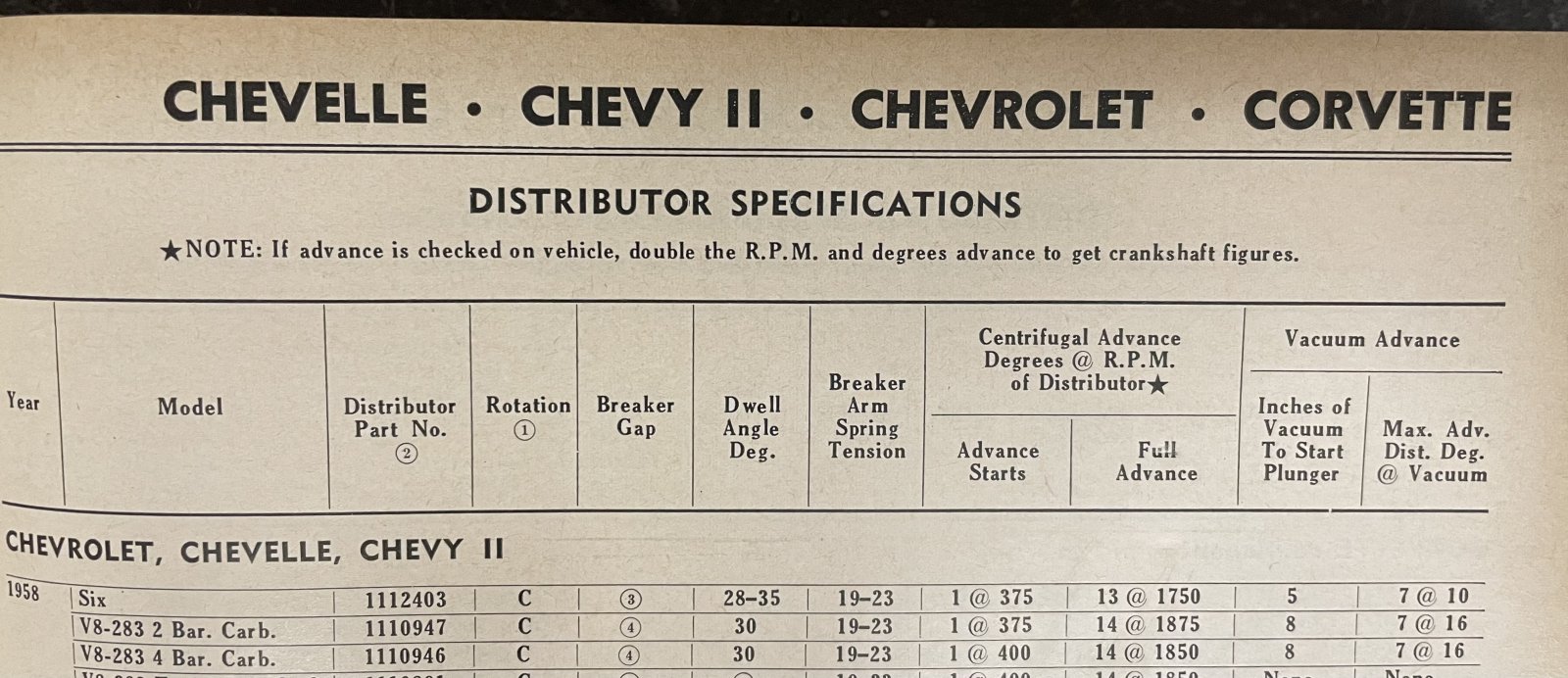

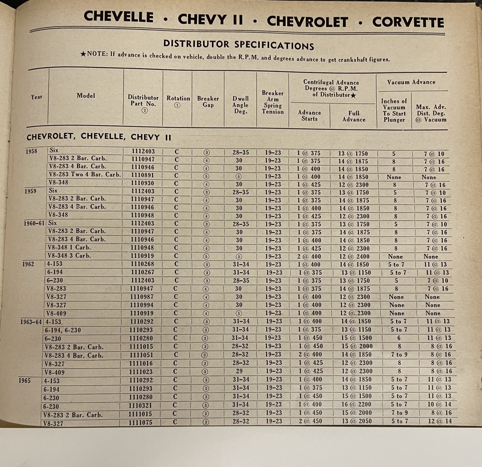

  30. Moriarity
    Joined: Apr 11, 2001
    Posts: 37,450
    Moriarity
    SUPER MODERATOR
    go ahead and try, I have had a Sun Distributor machine for 40 years..... and have done thousands of distributors
    Ok, read the bottom line. Mechanical advance is 13 degrees and vacuum is another 12. These are given in distributor degrees so you double them for engine degrees. That makes 50. I know damned well when I am cruising on the freeway in my car going 70 at 3000 rpms at a light throttle cruise that the vac advance is working because I am running at 16” vacuum. I have my mech advance all in at 3000....
