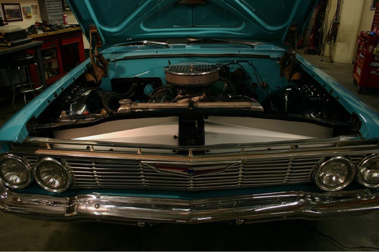

    Also, looking at the pic in post #117, I'm wondering if there is a seal between the top of the radiator bulkhead and the hood?
    GlassThamesDoug and Unkl Ian like this.

    Not on a 61 Impala. There are tons of places for air to byp*** the radiator if the path through the radiator is too difficult to push air through.

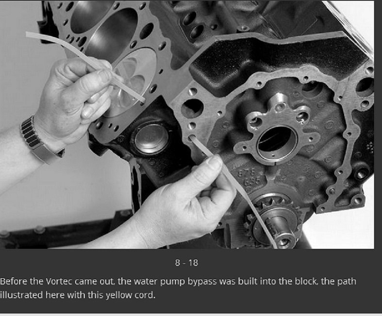

    I didn't say "external", but here is a video that will show you a smallblock Chevy with an external byp***. It affects which intake manifold and water pump you need to use. Listen very carefully at the 4 min 07 sec mark....and again at 4 min 25 sec.
    www.bing.com/videos/riverview/relatedvideo?q=coolant+byp***+smallblock+Chevy&mid=471F23F6CD8E5C0A5174471F23F6CD8E5C0A5174&FORM=VIRE
    On the next video you don't need to watch the whole video, but listen to the problems the guy had during the first 2 minutes caused by trying to get the byp*** right.
    www.bing.com/videos/riverview/relatedvideo?q=coolant%20byp***%20smallblock%20Chevy&mid=ED4CB8A57564B21FE624ED4CB8A57564B21FE624&ajaxhist=0
    Many people switch pulleys and brackets and swap Vortec heads. They may not be aware that they need to address this.

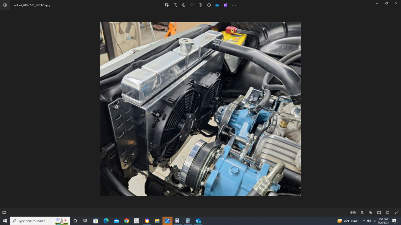

    I've seen these filler panels (also pictured below) for various X-frame chevies but haven't used them. Regardless, I think the fan shroud design is causing a lot of his issue.

  17. Ditch the electric fans and shroud and go with a 6 blade factory style engine driven fan, also increase the radiator size height, width, and thickness the more cores in the radiator the better 2, 3, rows is not enough, you need 4, to 6 core rows.. lastly use a seperate trans cooler that's not part of the radiator and not mounted on the radiator, put ot below or to the side out of radiator air flow.. What you have now will never run cool.

    Just as you need to make sure that your water pump is turning the correct direction, there are electric fans that pull and electric fans that push- make sure yours is blowing the right direction

    1. Aluminum rads usually have 2 cores of 1" or larger tubes. The old "have to have 3 or 4 cores) is copper-br***, not aluminum. Aluminum rads can flow better as a result.
    2. It's about air through the rad, it doesn't matter to the air or rad whether the fan is mechanical or electric. That's chasing money spent with more money spent for no reason.
    3. The cooling system IS keeping the car cool, just not at highway speeds. It's keeping it cool in stop and go, so it is working.
    As was discussed previously in the thread, his shroud appears to be the most likely issue. Taking it and the fans off and going for a drive will tell whether he has an issue with shroud design. With the design of the cheaper rad and fan setup he bought, I'm betting modifications to the shroud would solve his issue without the hundreds of dollars spent you're suggesting.

    I'm not seeing much of any way for air to byp*** the radiator though holes in the core support that shouldn't be there or gaps between the radiator and the support.
    Timing = been there done that with late timing. I don't even know how the 350R in my 51 Merc ran with the timing that late but It ran down the road at 80 pulling a trailer for hours on end.
    Looking at some 61 Chebby under the hood photos there isn't much space for a lot of air to get between the core support and the hood. I've seen 49/51 Merc guys leave that panel over the radiator off all too many cars because "it blocks the view of the engine and I don't like that" and have similar issues. Air going over rather than through the radiator.
    That comes down to lower hose collapsing at speed or that cute fan and shroud setup blocking too much air at speed. Screenshot (637).png

    A decent one does. Those shrouds are so close to the rad and cover so much of it up once you’re doing more than 30mph they become a hindrance to airflow.

    I think , (like others have said )) main problem is Not enough airflow at highway speeds going through the radiator,/core..
    Air is stacking up &'leaking in front of radiator bleeding off in front of core support and other places not flowing through the radiator cores @ Hyw / road speeds , because of fan shroud
    That fan shroud is a poor design , needs to be modified , but best to remove an ad
    70'-80s shroud , cutch fan best but not required,
