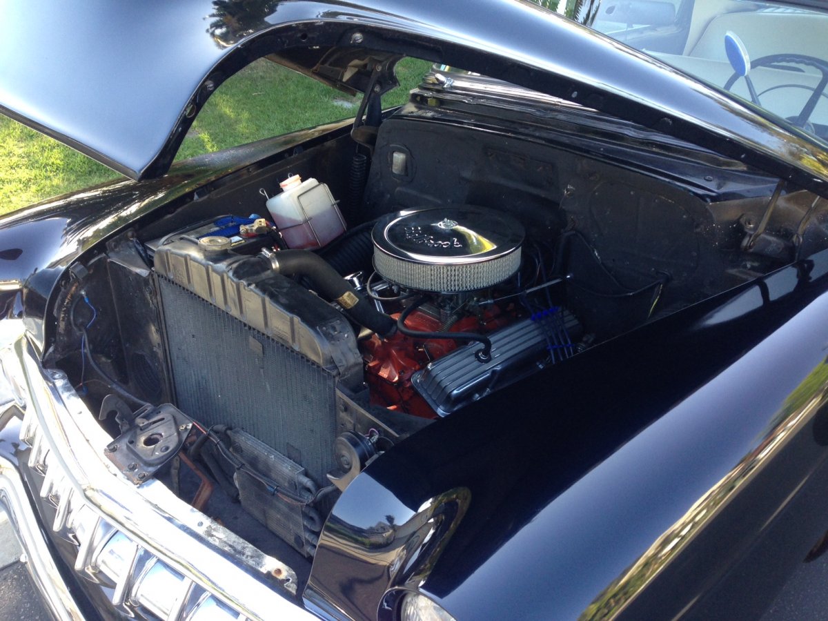

    I have a coolant recovery tank shown in the photo in post #57.

    I was hoping to make a shroud at some point since it didn't have one but prior to changing the coolant it seemed to be ok for the most part. I will inspect and make sure there is no air in the coolant system.

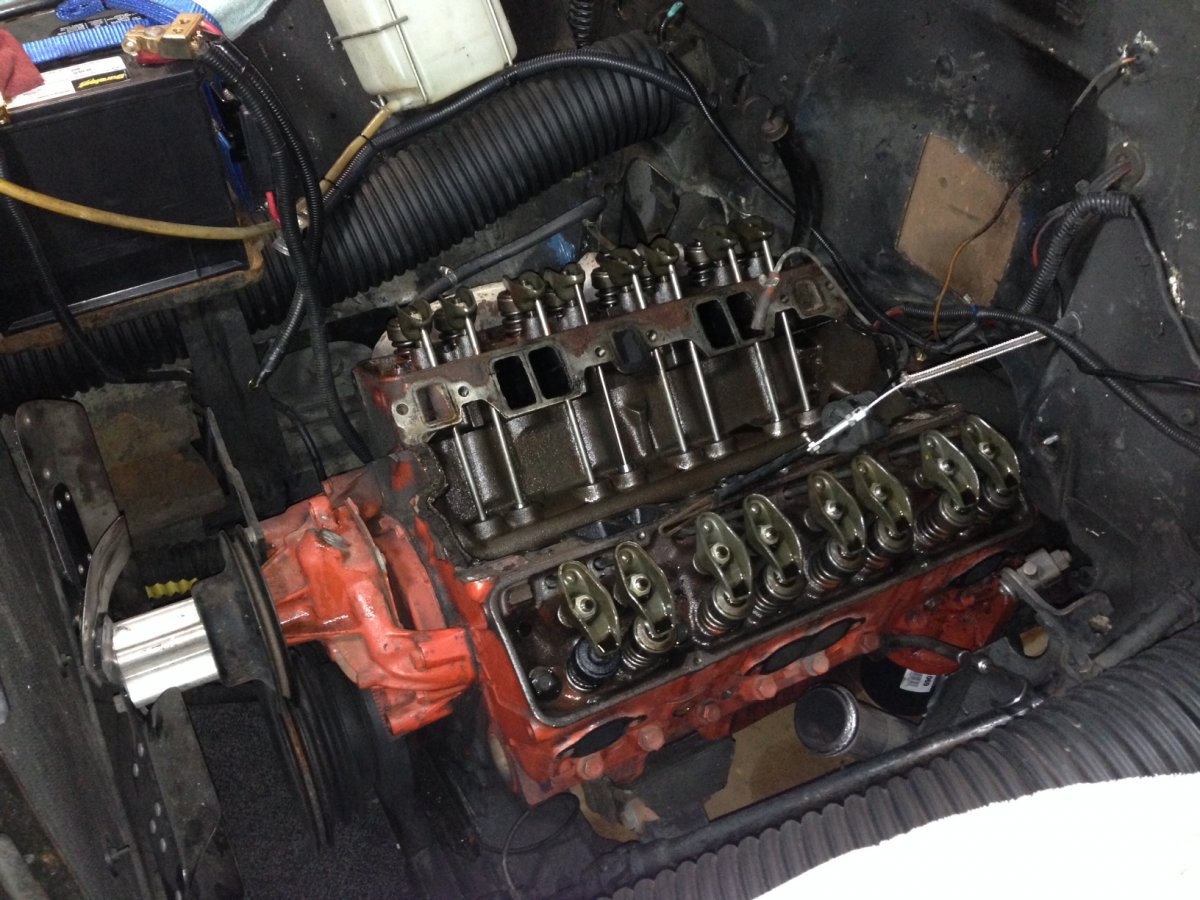

    Thanks. I can take photos tomorrow when I go in the garage. For now heres a photo from when I was working on getting the driver side cylinder head out.
    55gasserkid likes this.
  29. Jay Tyrrell
    Joined: Dec 9, 2007
    Posts: 1,631
    Jay Tyrrell
    This is good to do. Pull the coolant housing off and check and see if there is a thermostat. If there is. test in a pot of water that you bring to a boil. use a Turkey thermometer in the water to see where exactly it opens. don't know if this question has been asked yet.
    What kind of gauges are you running. Sometimes a cheap set will not read properly. I usually test the sensor at the end of the gauge to see if the gauges are correct.
