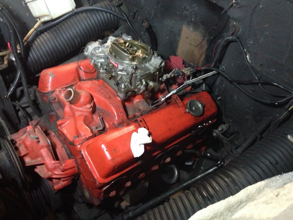

    Thanks it has an SW gauge for temp, oil pressure and fuel level.

    53CHKustom
    Sorry I re-attached it.

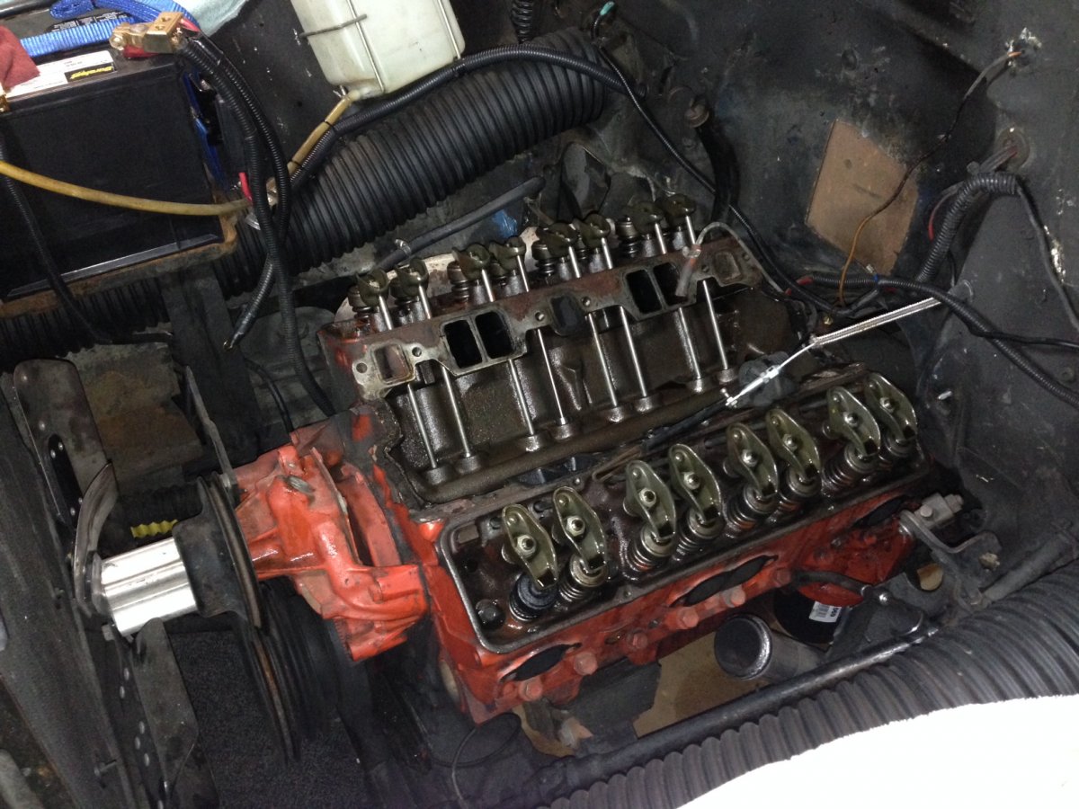

    To the left of the thermostat housing is where the temp sender should be positioned. Flex fans are junk.

    Ok If you are standing in front of the car do you see a bolt that is just left of the thermostat housing? That isn't a bolt but a plug. You will need to remove that plug and then put the temp sensor in that hole once the plug is out. Please take pics of the temp sensor once you get that out because you might need an adaptor for it. You are also going to need a plug for the hole in the head where that temp sensor came out. But we will get to that once I see the pic.

    You will need to drain the coolant right down again. to do this right. You got to make sure there is no coolant in the water jackets of the block or you will have a mess.

    Thanks. I did see that plug in the photo just to the side of the thermostat housing. I do remember draining the coolant and adding thread sealant when I re-installed it on the head.
    I will take some more photos tomorrow but will plan on doing this work when I can get it done in a day or two that way I don't have another big chunk of downtime.

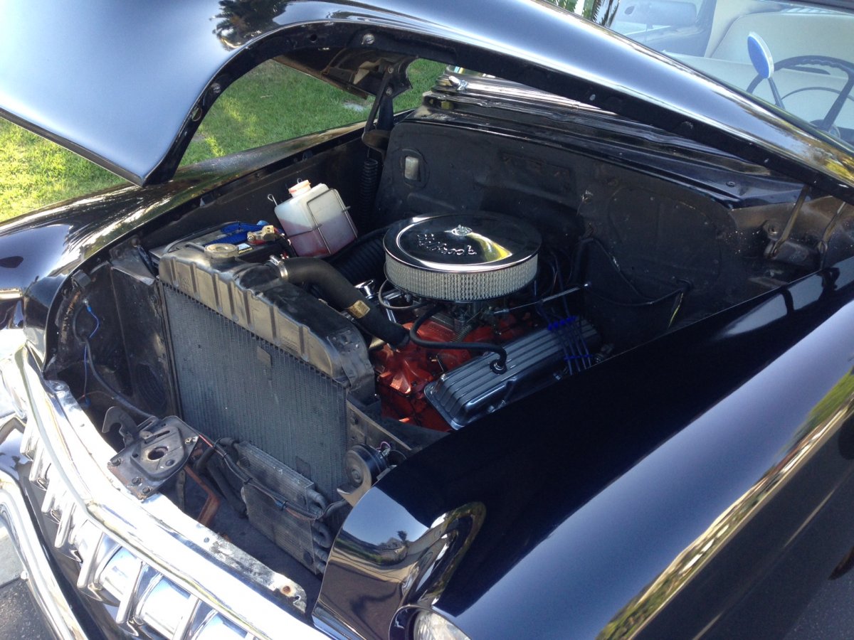

    Thanks for all the advice. I imagine if I put my temp sensor on the intake it would possibly read 10-15 deg cooler which would put it in the 175-185 when on the highway and 200 sitting in a traffic light. Right now it's 185-190 on the highway, 200 in city streets around 25 mph and near 220 sitting in a traffic light if I've been driving for half hour. As I said before I noticed it 5-10 deg cooler before changing from what coolant was in it to 50/50 mix.
    Here are photos of my setup:
    I bought the 180 deg Mr Gasket 4364 thermostat yesterday.
