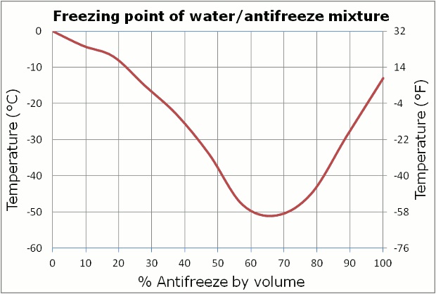

    Looking at freeze point, the back of the Peak hydrometer says use 50 percent water, 50 percent solution for -34 deg F protection and that correlates with the plots 31Vicky posted. The back of the hydrometer says 265 deg F protection for 50 percent antifreeze volume. That also checks out with the plot when 15psi pressure is considered (plots are for ambient pressure).
    Using -20 deg F data point from the hydrometer, I should have a 46% antifreeze volume which is close to 50/50. The boiling point data needs to take pressure into consideration. I should have 45% antifreeze volume using the 262 deg F at 15psi reading (my system is 7psi but the hydrometer reading uses 15psi condition). On a side note according to the data at 7psi, 45% antifreeze volume should give 242 deg F boiling point.
    If I drained the radiator in July and put 50/50 and the resulting mixture is 46% antifreeze, the previous owner likely put 50/50 but didn't measure accurately, or the the 46% is within the accuracy of the hydrometer. What doesn't make sense is the motor running a little hotter after draining the radiator and filling with new 50/50 (I did use Carlsbad city tap water which is hard stuff). I found no traces of air in the system when taking the thermostat out yesterday.

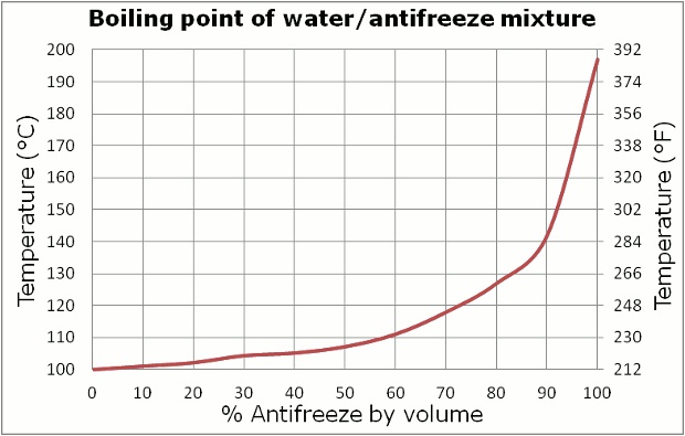

    Boiling point is raised much more by pressure, than coolant percentage.
