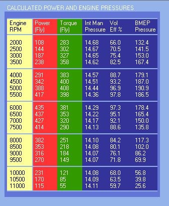

    The pic is a dyno sym of my 307
    The numbers are good- but you'll notice the volumetric efficiency never breaks into the 90 %s with the 305 heads. It's all in what you want and how you look at it, when I compare those #s to the dollars spent to get them - the numbers are phenomenal!!!

    The 307 above actually has better number in street driving mode where Rpms are generally below 3500 any way. You just figure out what fuel a 307 burns at those Rpms and what fuel a 327 burns at identical Rpms, ok got it? Now look at the power levels.

  6. If you were to put these two in an overall competition that encompassed all facets-
    Cost to build, cost to run, longevity, performance, power out put, smoothness, everything...
    With a 3500 rpm limit- the 307 would win hands down and by a bunch !

  7. tjet

    Be careful with Desktop Dyno. My motor was about 75 HP short between desktop dyno & a real dyno.
    307 is a nice motor, but a 327 is better is his application. A 327 will also have a better resale factor.

    I believe the question was from JP not 49ply "how did 307 with 305 heads compare to 307 with vortec heads." That's the two close comparisons I had.
    If you agree to a 3500 rev limit, ill put my 307 against any challenge you can come up with.
    The numbers are there- 350 ft lbs torque average between 2000 and 5000 Rpms isn't too shabby and that's 307 fuel consumption not 20% more 350 fuel consumption.
