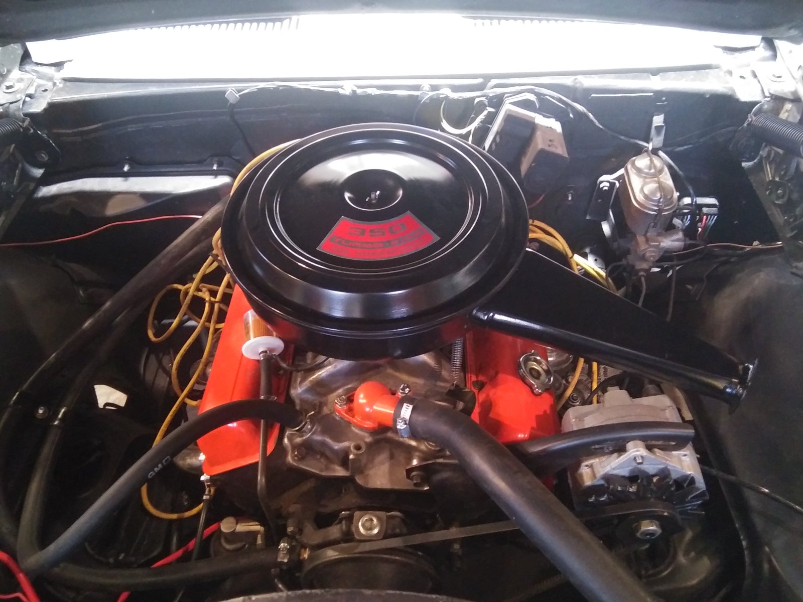

    Dang it's hard to jack a photo of a small block with a plain old stock style alternator bracket on it when you are hunting one
    The number of grooves in the pulley don't matter but it would look better if you just had single groove pulleys rather than naked grooves. The bracket on this engine is chrome but it is pretty much the same one that is on 90% of small blocks with long water pumps. Get the long bolt and spacer that goes behind the alterna SBC on pallet.jpg tor with it. Pulley is just take one off and put the other on. Any mid 70's chevy with a small block and long pump should have what you need if it is still on the engine.

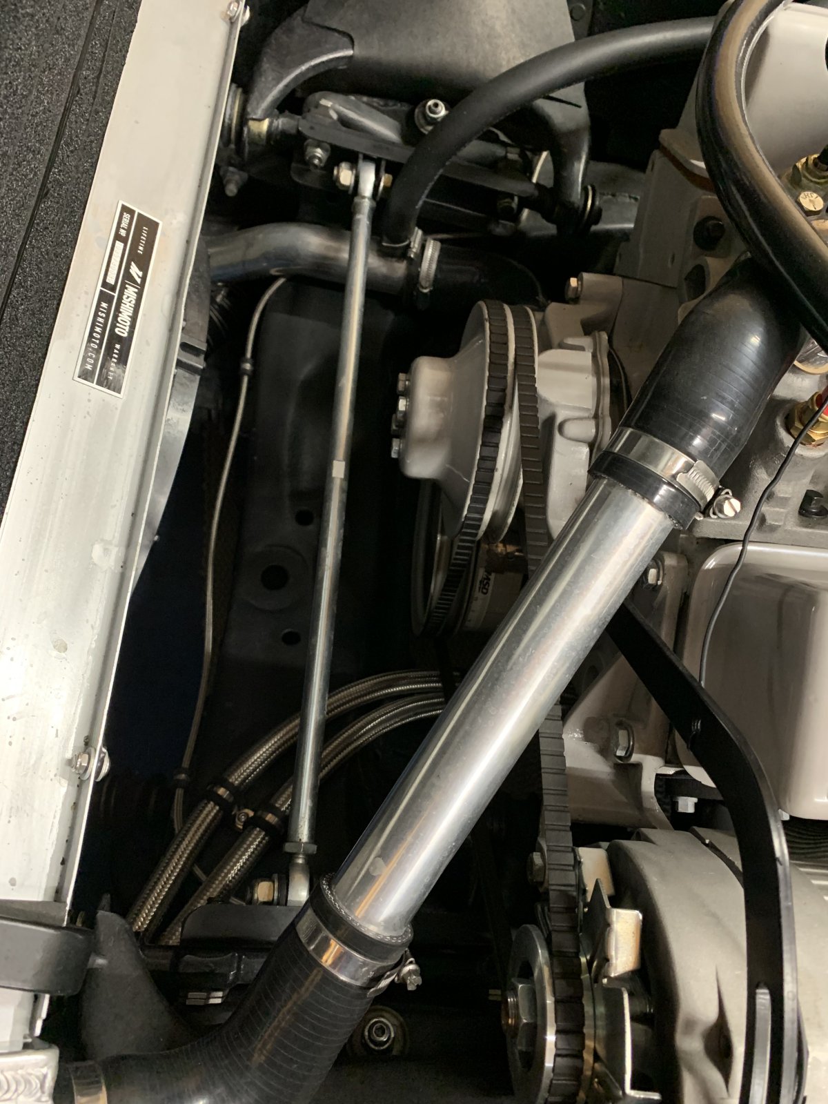

    Country Joe
    Here is my set up with long water pump.

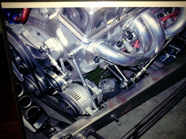

    Like this!
  30. jimmy six
    Joined: Mar 21, 2006
    Posts: 17,145
    jimmy six
    And all dirt track racers.
