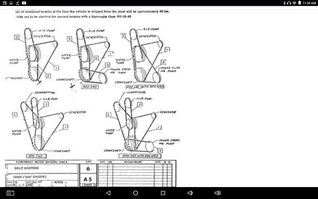

    That adjusts the alternator belt , not the forward belt ( closest to the radiator) doesn't it ?

    I don’t understand your “?????”.. dirt stockers and super stock style engines at all the tracks we run at use the “extra” belt from the water pump to the crank which what I was referring to and so was the poster. It’s a dedicated belt. They have an alternator and PS pump belt also.

    in post#32 above are the standard 68-9 corvette belt routing combinations , I don't see a single crank to water pump belt , if , as you say , racers used it , it was a short term ,non adjustable race thing that would have been impossible to properly adjust belt tension .

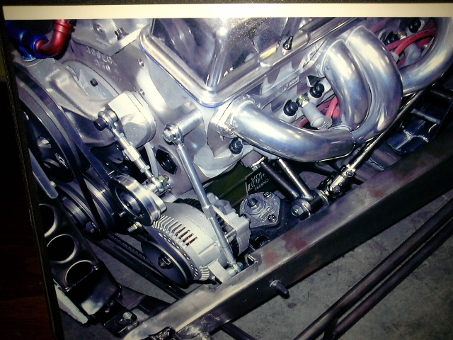

    Here's the way mine looks.

    This is what I gots, About as simple as can be... IMG_0014.JPG using the dreaded electric fan.

    The first two diagrams show a belt (labelled 2) that goes around just the water pump and crank pulley.

    I stand humiliated & corrected , even if its a half -***ed configuration :(o_O !
