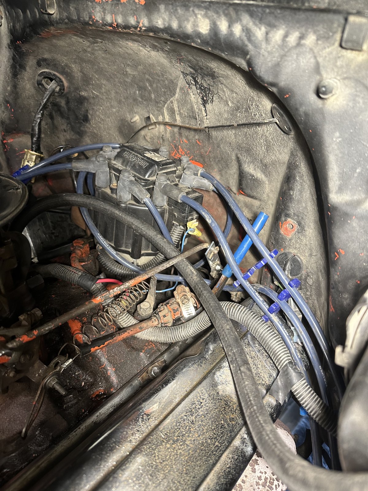

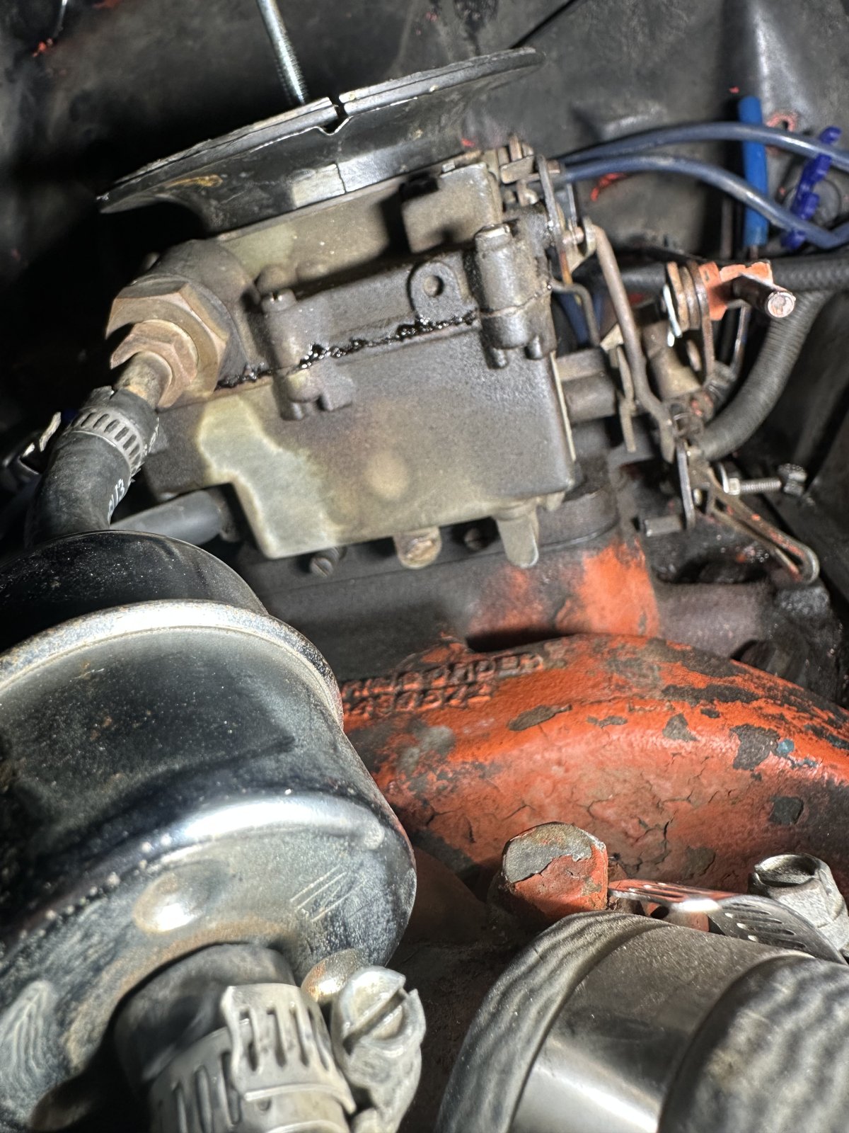

    What does the hose on the front of the carb go to
  3. Johnny Gee
    Joined: Dec 3, 2009
    Posts: 14,278
    Johnny Gee
    from Downey, Ca
    The lower one right? Vacuum advance but in this case, it’s most likely going to the thermostat housing were there is smog related thermal deal that controls spark advance vacuum signal.

    I think PCV valve for that lower one. I'm posting more photos now.

    IMG_4050.jpg Here are some more photos

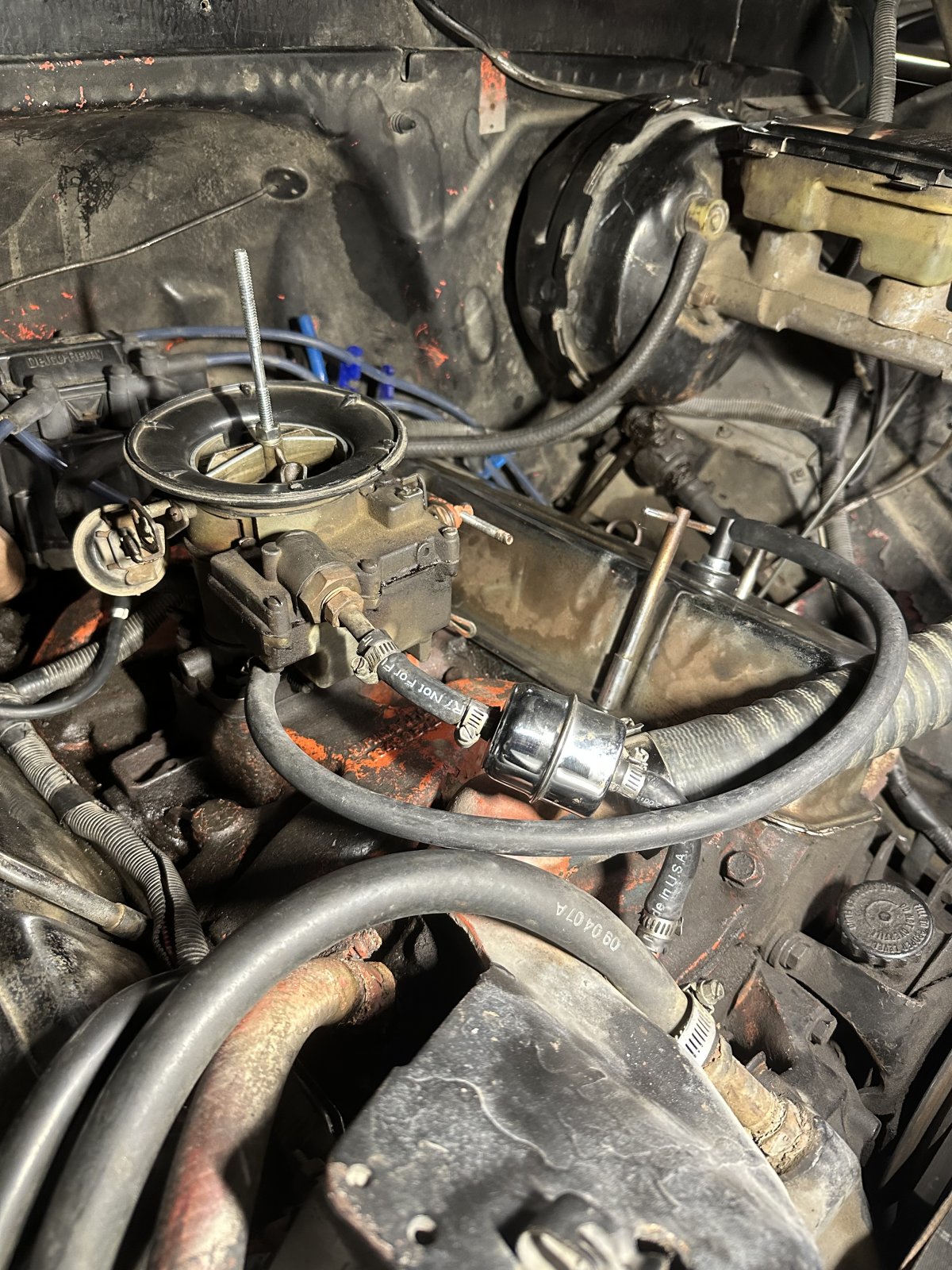

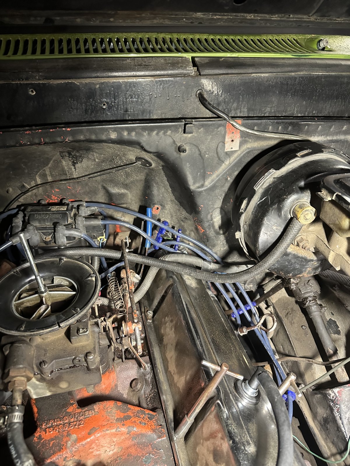

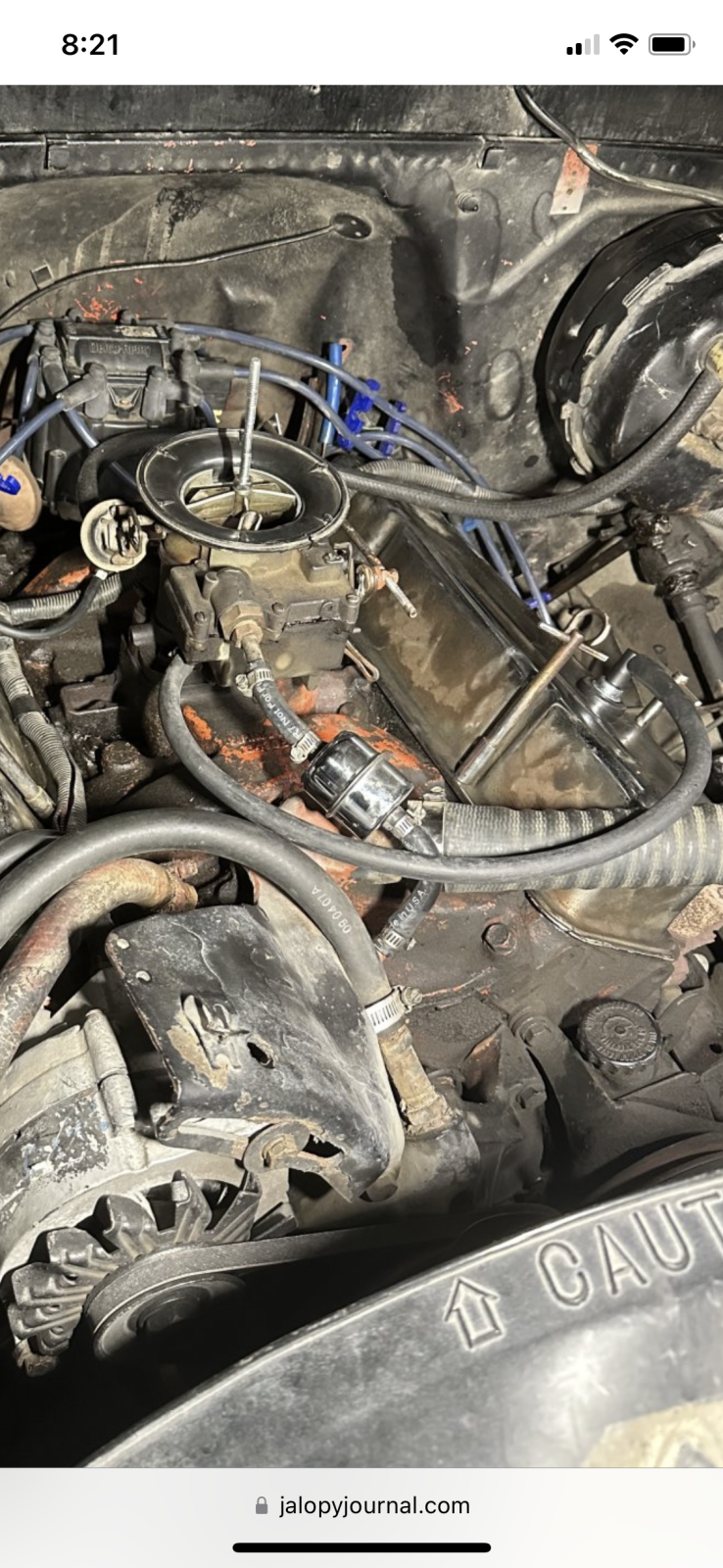

    Thanks here are some photos.

    Ok I see it now. Your PVC hose should be off the back of the carb at the base/throttle plate. FAFF28D8-9F87-4B39-A4B2-6385AFC1F54B.png

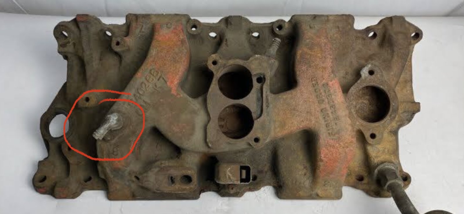

    Thanks just checked and the brake booster line is plugged in there. Do you think it will make a big difference moving the PCV to the back? I guess I could buy a tee fitting of some type..

    Brake booster would go where I circled. 46375D05-8174-4BBA-B6CA-49B8A9243DDE.jpeg

    And @SDrocker Most Rochester 2G carbs should have the vacuum "Ported Advance" [regardless of what the internet and Youtube mechanics claim]
    The port is here [below blue Arrow] and not below the*****erflies [blue circle]capped off
    A lot of carburetor "off the line stumble" is caused by manifold vacuum advance! [and ported will remedy it]
    If you set the timing at 12° advance and then connect up manifold vacuum [maximum vacuum is at idle] the timing could advance up to +/- another 8° [approx 20° total at idle]
    As soon as you touch the gas pedal and manifold vacuum drops,and the dizzy instantly retards to 12° advance [causing a stumble], then the timing has to climb back up to full centrifugal advance at higher RPM
    By having ported vacuum you only have vacuum advance when you back out of the gas while cruising or decelerating.
    If your engine runs smoother/better with "manifold" vacuum, simply add a few more degrees into the timing and re-connect it to "ported" vacuum
    Also listen to @Johnny Gee about the PCV valve ....It must go to a hosetail at the base of the carburetor [ black arrow on photo ^^^] mine is an early PCV but the port is the same position on the Carb
    If the PVC is connected to the port on the rear of the manifold [Johnny Gee posted #23] there will be a constant flow via the PCV and the rear cylinders will lean-out .
    So leave that port on the manifold for the Brake booster where it needs vacuum not flow. [Johnny is correct]
    The PCV port at the Carb divides into both barrels on a 2G
    Here is another view of where the PCV port is on the Carb , on a 350 the PCV is on the rocker cover and the Carb has a hosetail
