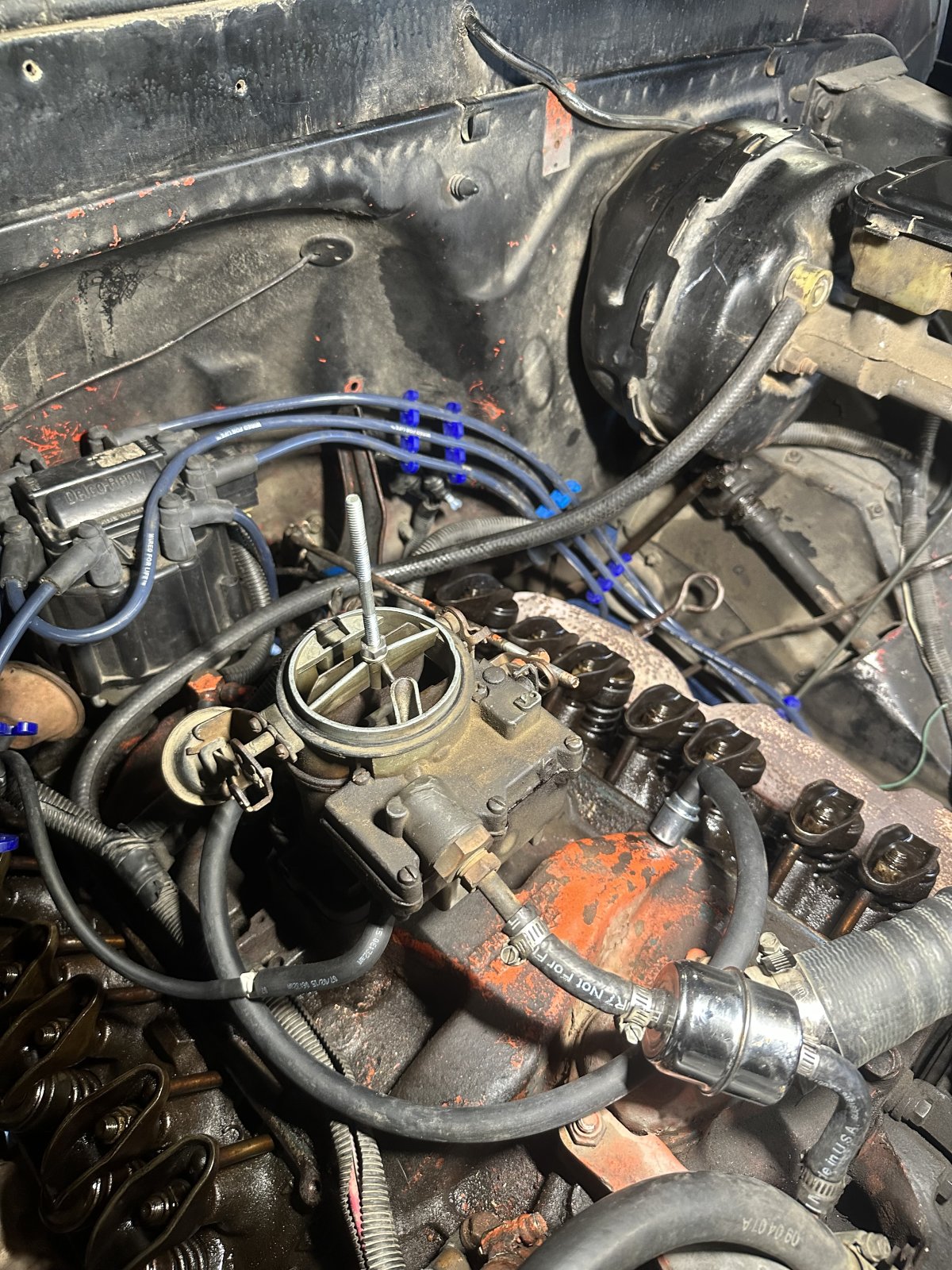

    Thanks, I'll look into that. I noticed the truck had way more stumble on acceleration after doing valve seals and the other work I mentioned and I had the timing in the same place as it was before I noticed the stumbling getting worse. I had checked with the timing light to make sure I didn't move the timing when I was using the valve spring compressor tool which rubbed against the distributor. I feel I must have done something to make the stumble worse... it was there before but slight.

    I made all the changes to the vacuum routing. Reset the valve last using 1/4 turn preload after zero lash. Fired up and it’s a night and day difference first crank and it idled way smoother not even touching the pedal to feather it like before. I listened and don’t hear any valve clatter but shut the motor off so as to not make a big mess with oil. Anyone think 1/4 preload is fine? Or should I maybe go in and add another 1/8th or even 1/4 turn to get to 3/8 or 1/2 total? I read some prefer 1/2 turn and some for a street driven motor will go 1/4.
    I used the firing order fraction method watching the valves to teeter and set companion cylinder valves.
    I guess I could set valve lash while running but want to avoid the mess.
    I’m tempted to throw the valve covers back on and test drive and go back to add more preload later if necessary but I didn’t hear any clatter.

    Update so I took this thing for a drive... before that I put the valve covers back on after resetting the lash and going with 3/8 total turn of preload after zero lash.. I also removed the extension I put on the pedal linkage going to the carb so it was set how I had it before. I pulled it out of the garage and let it warm up and then used a vacuum gauge to set the idle mixture screws again on the carb. All the way in then 1 1/2 turns out and then 1/4 turn in on each until I saw the vacuum reading change. This time I was seeing 10 in hg of vacuum vs the 15 in hg of vacuum but this was also after applying the corrections suggested below and re-routing the vacuum lines to the correct locations on the carb. To adjust the carb idle mixture screws I put a tee in to the line going from the carb to the distributor vacuum advance and put a gauge there. Prior to this it was going to manifold so I can see why I am not getting 15 in hg this time. I assume when setting the carb I'm supposed to monitor the vacuum between the distributor and carb?
    In the driveway if I revved it up it felt pretty good and smooth and no stutter.. then I left my driveway and when I would give step on the throttle a little I would hear popping noise and it startled me enough to just baby the pedal and barely touch it and drive a few streets over to get out and see if I saw anything obviously wrong. In park I could rev it and no popping noise... then I put it back in drive and headed back home and popping noise if I gave it too much throttle more than just a little touch on the pedal. Could this be caused by the new mechanical fuel pump that I suspect may have too much pressure? I was going to connect my vacuum/fuel gauge but I don't have the right fittings. When I borrowed the oreilly fuel gauge I measured 3 psi on my old/failing mechanical fuel pump and 11 psi on this new one... I wonder if the gauge is inaccurate or if the pump is indeed putting out too much (which I've read is common for any of the parts we get from china nowadays). I was going to buy a fuel pressure regulator (basically the mr. gasket type that are basically restrictors) and see if that helps but I also have little to no room for one.
    I also wonder if maybe the fast idle isn't set correctly and causing this issue.. hmmm
    Darn I thought I was close this time! It definitely wasn't doing the popping (if its backfiring) before..

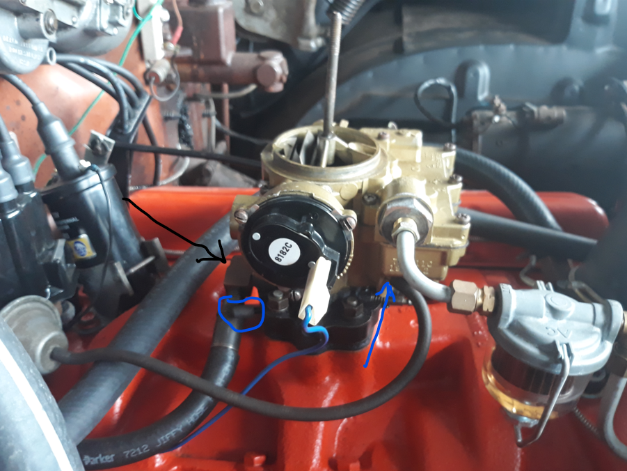

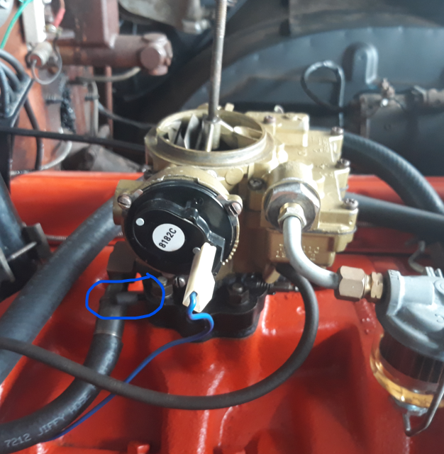

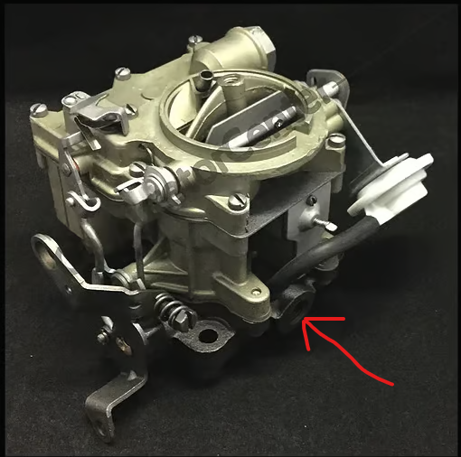

    Idle mixture screws are adjusted off the manifold vacuum port [not the "ported" vacuum port] otherwise you will get a low reading
    [This is the blue circle on post # 29]
    I always disconnect the vacuum off the dizzy end and jam a golf tee in the hose when I adjust idle screws.
    You adjust the screws in / out one at a time to get maximum vacuum [go back and forth a few times]
    It should idle slightly higher.
    Then you turn the idle a bit [and this should shut off the ported vacuum]
    The timing should be checked and corrected Before you tinker with the mixture [I hope you did this after re-routing the plumbing]
    So to summarize
    Ported Vacuum for vacuum advance
    Manifold Vacuum for idle mixtures
