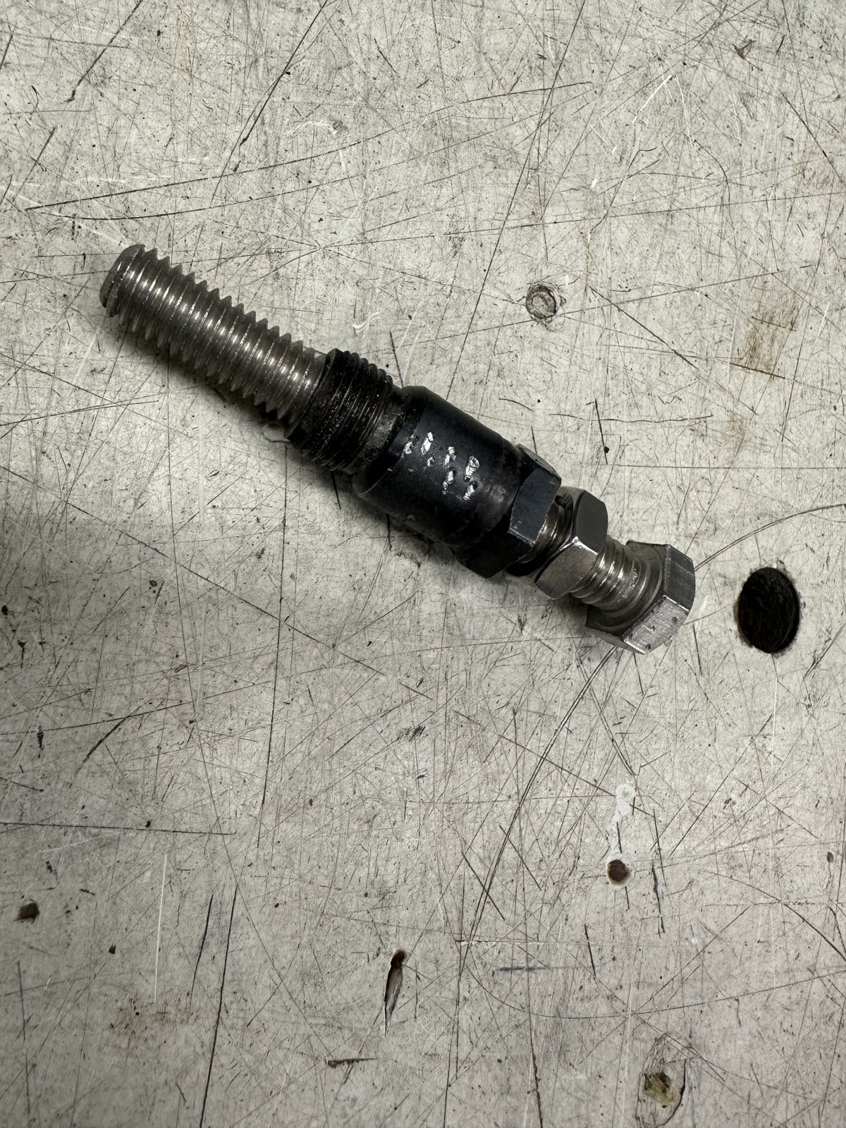

    I went in to work where I have access to lathe, press, vice, mills, taps, etc…. I’m gutting the spark plug and tapping for 3/8-16
    crazy you can’t buy a tool like this without ordering online!

    Below is a photo of what I made. I’m thinking grinding out all the thread and smoothing would be kind of a pain… I read some people complain the bolt threads may knick the piston. I rounded the very tip with a file so it’s not as sharp there…

    Made another version.. I don’t think the length has to adjust. I cut off the end of a shoulder bolt and smoothed out the end… no threads to knick the piston.

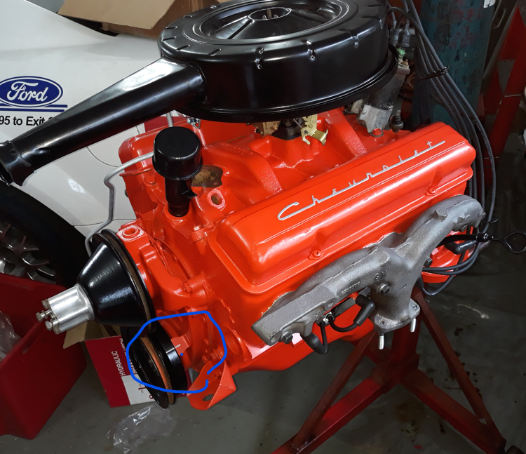

    Mark the TDC on the timing cover so it is easy to see, and then mark the "correct' position on the balancer. [below]
    This mark on the balancer is where the "0" on the timing tape goes.
    On my friend's 350 Chevy we moved the TDC position to the edge of the timing tab [below]
    This made it easier to read [especially with accessories in place]
  19. Good job on the stops. Second one is probably too long. The first might need adjustment too ..Better to get it as short as you can.Then you can split your marks easier.

    thanks I can shorten the second one so I’m working with a smooth surface for the piston. I wonder what a good length is from the base of the drilled out spark plug.

    I got it dialed in and cut it shorter and smoothed it. I will keep this tool handy for the future!

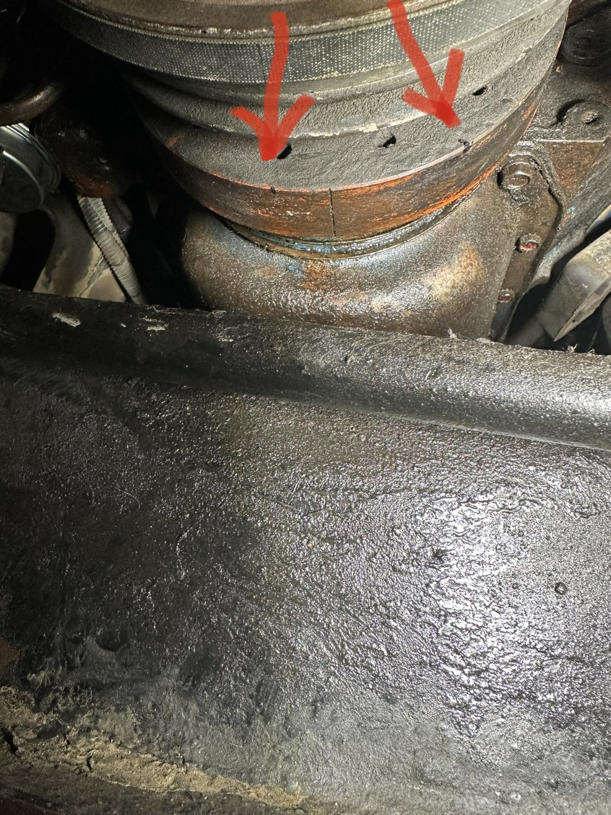

    Here’s a photo showing the two marks I made using piston tool. This is from underneath the car where I has more room to look clearly. I’m going to make a new zero mark and use my dial back light to set 12 deg advanced.

    Was indeed off about 10 degrees. Looking from top of engine red is new mark blue is previous factory mark on balancer.
    If I set 12 deg initial on the incorrect mark before must have been 22 deg initial.
    maybe with the distributor connected to manifold it was driveable before since timing dropped when giving it throttle but it stuttered as the engine adjusted to the changes. Now with it connected properly to port it gets way too much advance timing when giving it gas since it’s off by 10 degrees!
