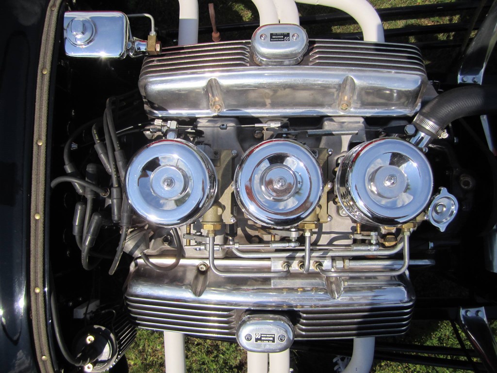

  8. Koz
    Joined: May 5, 2008
    Posts: 2,787
    Koz
    Not sure how stuck on trips you are but you can run 2x2, large base Rochesters and use one. You need to make the manifold like a Sam-O-Ram. I've made a bunch now. They don't run bad at all and the coolness factor is pretty high. I'm making one now with small base Rochesters for a 355. Will be a tad easier on the mild motor. Nicson made one in the '50's but extremely rare now. Samiyam may want to jump in here. This pic is one I use for a muse. Not sure who made it.

  10. Wizard1926
    Joined: Jun 17, 2023
    Posts: 110
    Wizard1926
    Now that would be perfect.
    And you are right about the cool factor. Wonder why no one still offers something like that

  12. davxsmith
    Joined: Jan 7, 2023
    Posts: 11
    davxsmith
    What valve covers are these? They don't look like the Mooneyes that are available these days

  15. RICH B
    Joined: Feb 7, 2007
    Posts: 6,111
    RICH B
    They started out as Edelbrock covers that someone drilled a breather hole right in the center of the script. Welded the holes, "milled" the center flat with a router, and added the breathers. I actually bought two sets of covers with butchered holes in one cover for cheap on eBay and used the unmolested covers on my '35.

  17. RICH B
    Joined: Feb 7, 2007
    Posts: 6,111
    RICH B
    I still wonder at not one; but two guys that thought it was a good idea to put a PCV valve/breather hole right in the middle of the script; same goes for the ones that make holes in Corvette rocker covers.

  20. Cali4niaCruiser
    Joined: Aug 30, 2005
    Posts: 670
    Cali4niaCruiser
    Deuces likes this.
