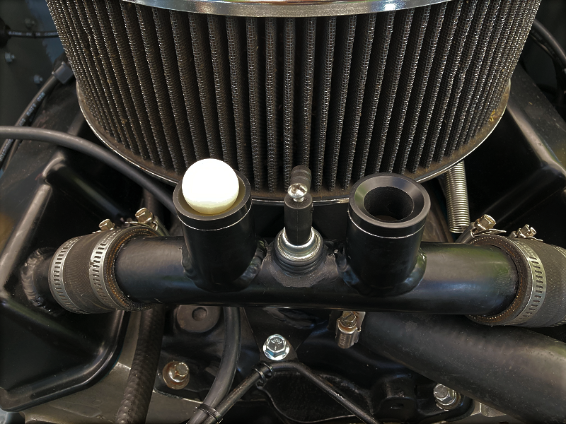

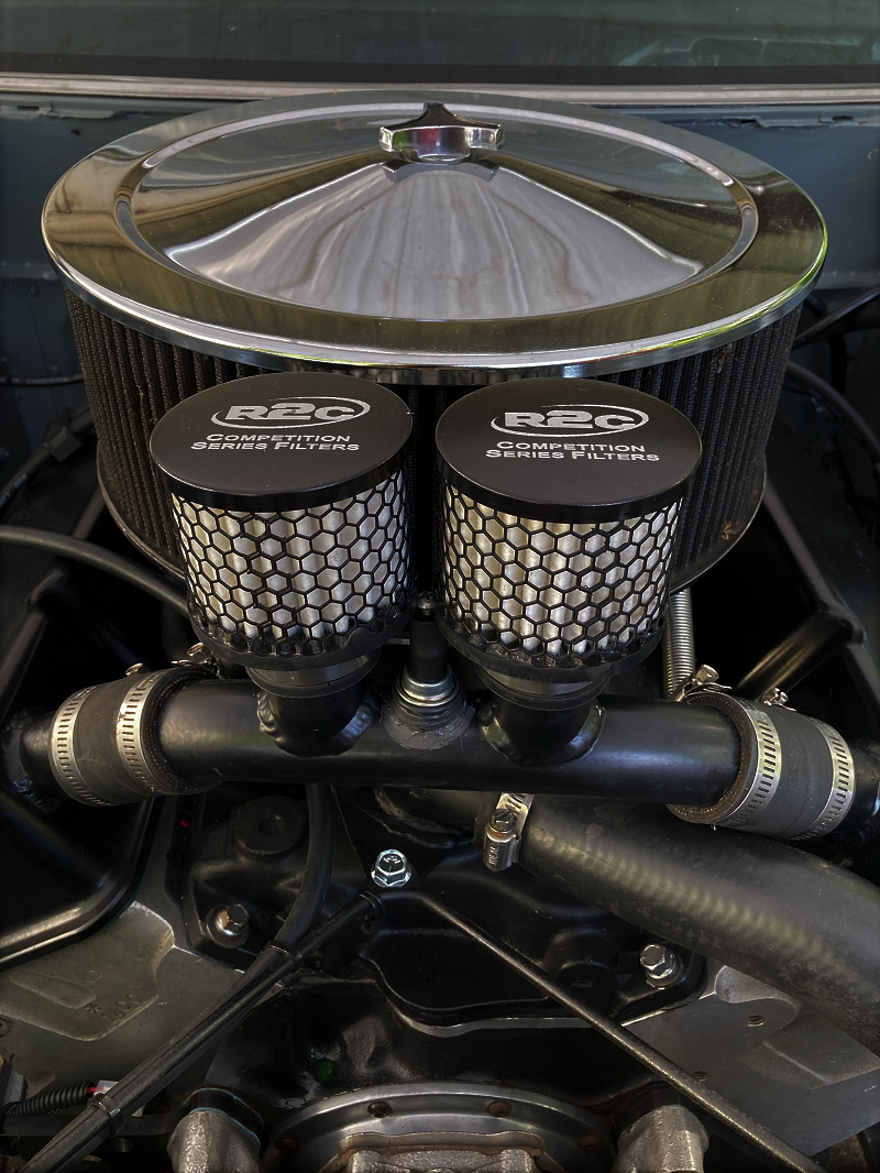

    If you need more airflow thru the pcv at idle, you can add an adjustment screw to the top of the valve's plastic elbow. The screw basically serves as an adjustable stop to hold the pintle slightly off it's seat. This valve was cut apart just to see what was inside, but you get the idea...
    Here you can see my modified valve located in the top of a separator can...
    Here's another version of my breather system, you can see a modified pcv valve located between the breathers...
    My current system uses a set of check valves inside the breathers, which allows the pcv valve to draw a vacuum inside the engine. I run low tension rings, drawing a vacuum inside the crankcase really helps with oil consumption on my street/strip car...
    Grant
    Vic Walter, Just Gary, rod1 and 2 others like this.

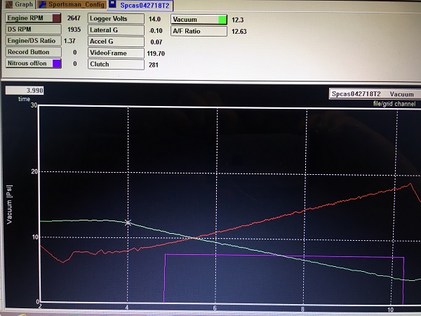

  29. Weedburner
    Joined: Nov 16, 2010
    Posts: 275
    Weedburner
    from Wa State
    I've been running this pcv/sealed crankcase setup since 2012 with a couple different engines, crank seals are reversed. Rear seal is a fluoroelastomer 2912 Felpro, which seems to last pretty good reversed against this much vacuum. Front seal is viton SCE 21102, it had to be replaced last winter. I think next front seal will be one designed for a reverse rotation boat engine, my thinking is that the small directional ribs going in the wrong direction will help lube the seal lip. No signs of wrist pin oiling issues @ 15-16"Hg.
    Here's a RacePak graph from 3 years ago showing crankcase vacuum during a 6.25sec long WOT 3rd gear pull...
    ...Red line- engine rpm
    ...Blue line- WOT switch
    ...Yellow line- crankcase vacuum
    The pull started out with 12.6"Hg @ 2600rpm. When the pull ended at 6250rpm, the crankcase still had 3.9"Hg of vacuum left. I should add that the engine is well sealed, no dipstick (oil level sight tube).
    It's a low compression (pumps around 100psi) flat top pump gas 355 with a couple nitrous kits in a crossbar plate. Total Seal gapless top rings, solid roller 114 LSA nitrous cam, aluminum rods, rolled 11R heads w/ ***anium valves, shaft rockers. Car weighs 2325lbs, 28" drag radials, 3.73 gears, Top Loader 4spd (no overdrive).
    Took it on a long drive across the p*** a few weeks ago, included a 8610rpm blast inside a tunnel and still got 20.98 mpg. Low tension rings are the biggest reason it gets great fuel mileage while spinning that fast without overdrive. A pcv valve, combined with a sealed crankcase, is the key to making those low tension rings work on the highway without excessive oil consumption.
    Grant
