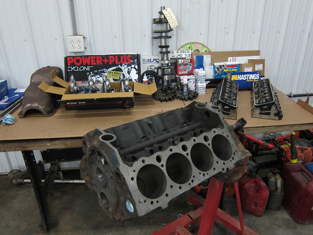

    Long overdue update for everyone! I'm just about ready to begin my build.
    Block was bored 0.040 over and decked 0.025.
    Crank main journals were turned 0.010 and the rod journals turned 0.040.
    loudbang, turboroadster and H380 like this.

    I painted the block and installed the main bearings, main studs, crank, and rear main seal. Plastigauge on the mains was right at 0.002.

    I got the pistons, rods, camshaft, and timing gears installed as well.

    I installed the new oil pump (re-used the old pickup tube/screen), oil filter adapter, two piece dipstick tube & dipstick, timing chain cover, Vortec heads (.500 lift springs, machined valve guides, and .530 seals), hydraulic flat tappet lifters, pushrods, and rocker arms.
