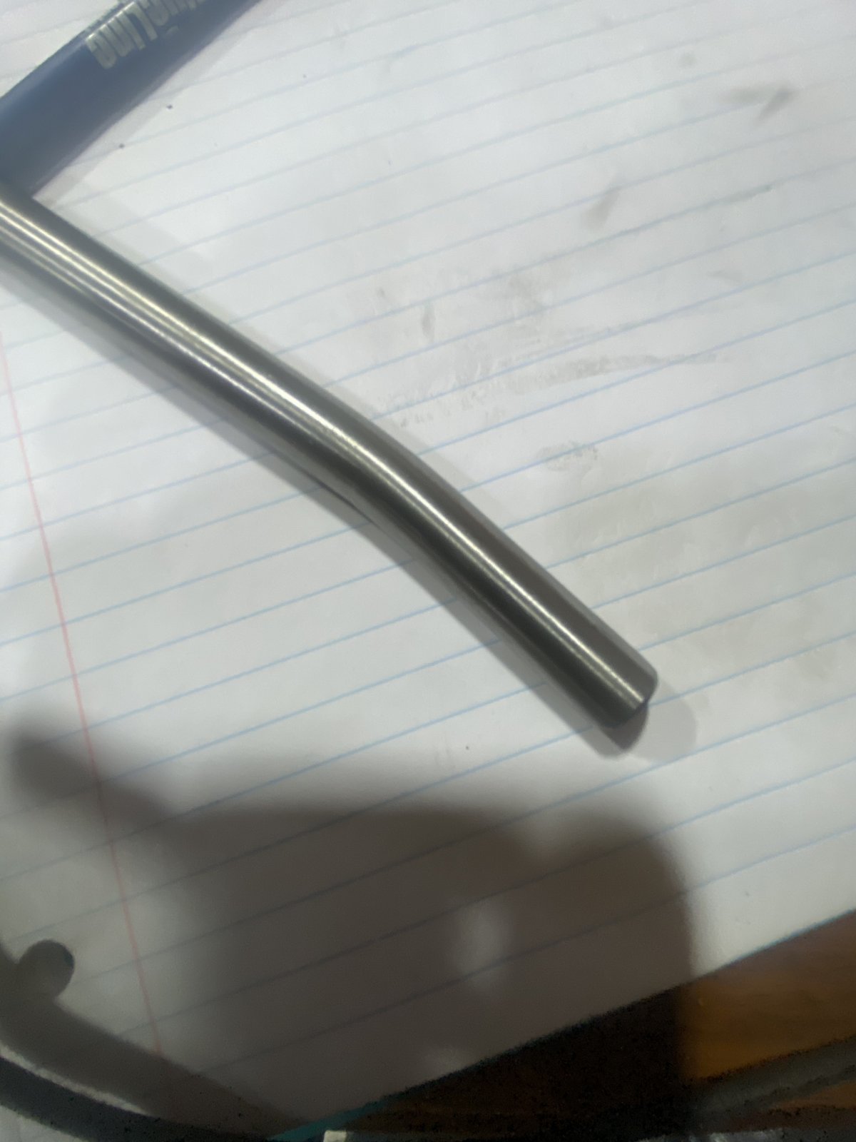

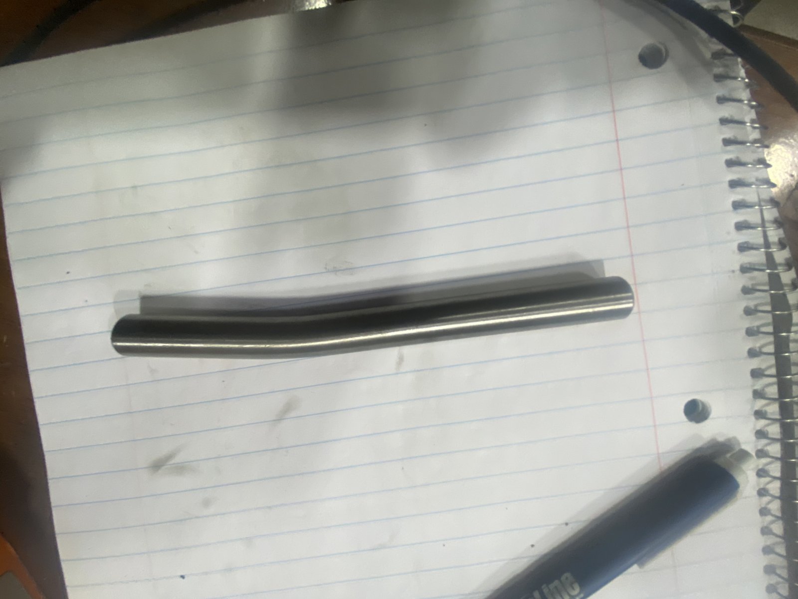

    Of course, there’s quite a few google hits on this problem and no good answers. Not one! Lots of feed back saying “ I’ve been wrench for 50 years and never heard of that”
    I don’t know what the hell happened to this damn thing but it was installed the same way I’ve installed 100 or so over the last lifetime.
    It’s brand new engine (I didn’t build it) engine was started and broke in on stand by builders with Electric FP. It’s brand new rod, (because nobody could find the old one) 1 year old pump. Engine on stand, installed the pump, as well as a few other things, flipped it over and swapped oil pans, off the stand bolted up transmission. Rolled over by hand for TC bolts. Put it in car and hooked it up all the other stuff. Tried starting it.
    Not getting fuel, diagnostic led to fuel pump coming off. Pull this out ,,,
    10599891-17BA-4FEA-996F-1CE2A04DD662.jpeg 53BB4BF8-8D28-4D1B-ABF6-09A949784DE8.jpeg
    Awe hell ,,, how exactly does that get bent and turn over by hand? No noises or groaning from starter. I don’t get it

    I could be wrong, but the “new” statement is what makes me think the rod isn’t made from the material it should be. I’m going to guess it is way too soft of material. Heck, I use a small block fuel pump rod as a drift and have never even came close to damaging it smacking it pretty hard. As far as what caused the actual bend, all I can come up with is that maybe the pump arm missed the rod somehow when installed and put it in a bind? Then, once it bent and cleared, it missed the contact point on the pump arm making it not pump fuel? Or maybe the rod is just so soft it couldn’t overcome the pump without bending?

    I have seen one other fuel pump rod bent that way. The rod fell down when the pump was bolted on and the arm in the fuel pump bent the rod.

    I have done that before, I put too long of a bolt in a Hurst engine mount and I't bent the rod in the same place.

    Never seen that before either. Those are hardened, at least they were. Can't believe that itis bent like that.
  7. It’s a First for me. Obviously something went wrong here but the install process seemed flawless,,,, lube and instal rod, made sure it was on the low side of cam eccentric, install long bolt just snug install plate, install pump, felt slight tension, evenly tightened bolts, removed long bolt, thread sealer and short bolt.
    Text book ...
    GlassThamesDoug likes this.
  8. I’m trying to picture the bending method and exactly when,,,, rolled that motor over by hand at least 2x after pump installed and felt no resistance, nothing wrong and nothing odd when using the starter motor.

    Yep, procedure sounds exactly like we have all likely done it many times. That is why I am questioning the hardness or just material of the rod.

    Put the rod in a vice and see how hard it is too bend, just curious.

    Holy ****, that's a first for me. I would be concerned what that did to the cam. When I install one I usually blob a bunch of white grease in there which will hold the rod in place till you get the pump in place.

    Newer ones are hollow with hardened ends. We use them on our race engines…

    I have three small block powered cars and all have the fuel pump push rod that Jimmy described, hollow with hardened ends. Since '63 I have always held the push rod against the camshaft so the rod is at the base of the lobe. You can feel it while slowly turning the engine over. With the engine in that position there is less tension on the fuel pump and rod when it's installed.

    I’m just trying to get my head around the actual pivots forces and stop of how the damn thing Got bent in there. Long part was up towards cam,,, rod came right out

  30. One end contacts the cam the other end contacts the fuel pump. Between those spots the rod contacts/rides in/is guided by the block itself.
    The bend is happening between the fuel pump and the block. If the rod was binding in the block I would expect the bend to be between the cam and the block. The way I see it, something happened (jammed?) with the fuel pump, the cam pushed down on the rod and the rod slid off the fuel pump and bent.
    I have never seen this happen before but I believe you have an issue with the fuel pump. Turning the engine over by hand is not the same as firing an engine up and running it at 600rpm. The issue wasn't obvious (or even an issue yet) when turned over by hand ... the same can't be said for when it fired.
    I have a Masters degree in Intergalaxational Multidirectioning Plasmodic Disectionism (that was unfortunately not earned on this planet) so I have an inkling how things work ... it's your fuel pump ;)
    If the install of the pump was done correctly, then it's an issue with the pump itself.
    Edit: Are you absolutely positive the rod you used is for a SBC and it isn't too long? Just because the box says SBC doesn't mean the correct part is in the box.
