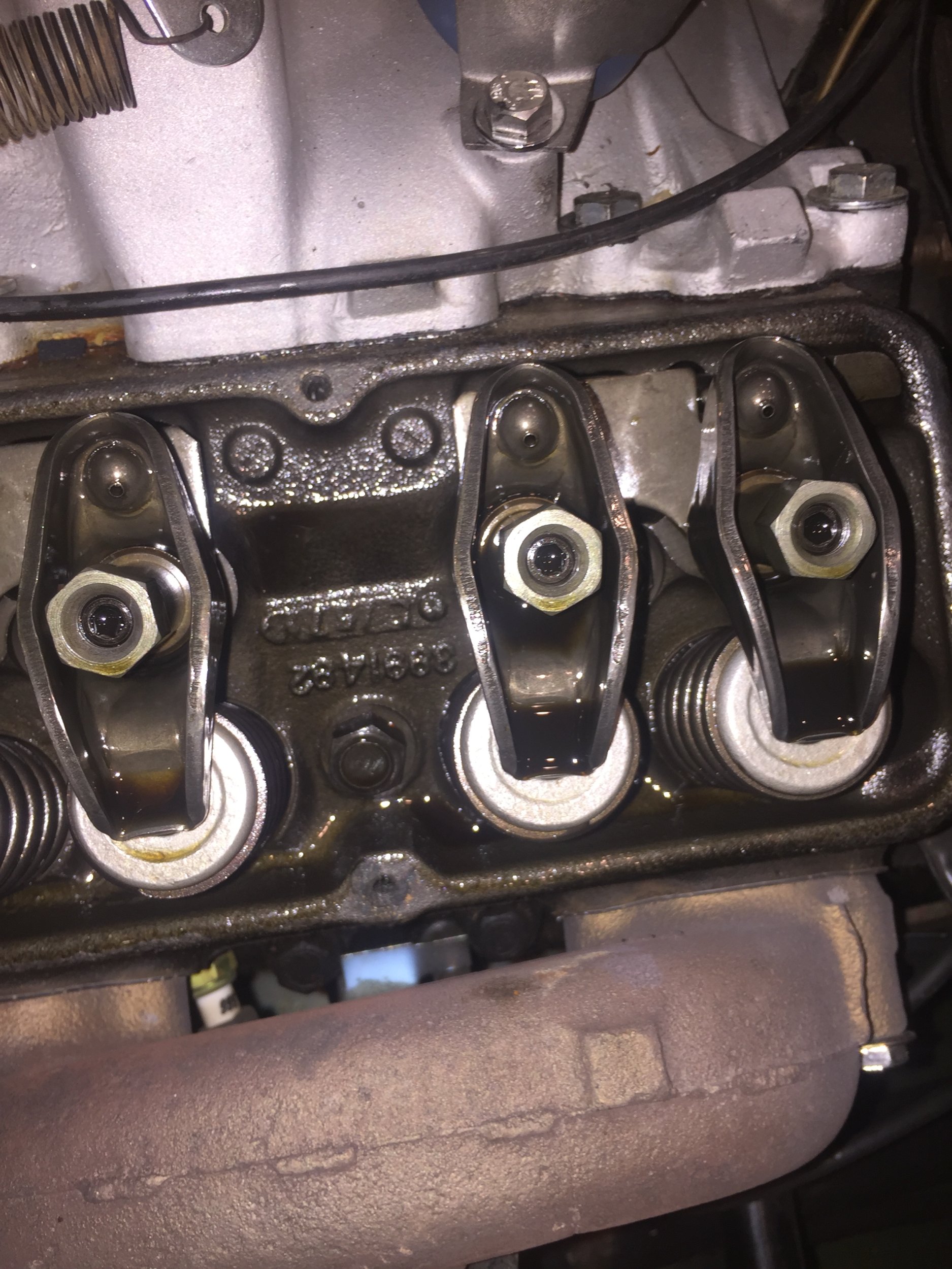

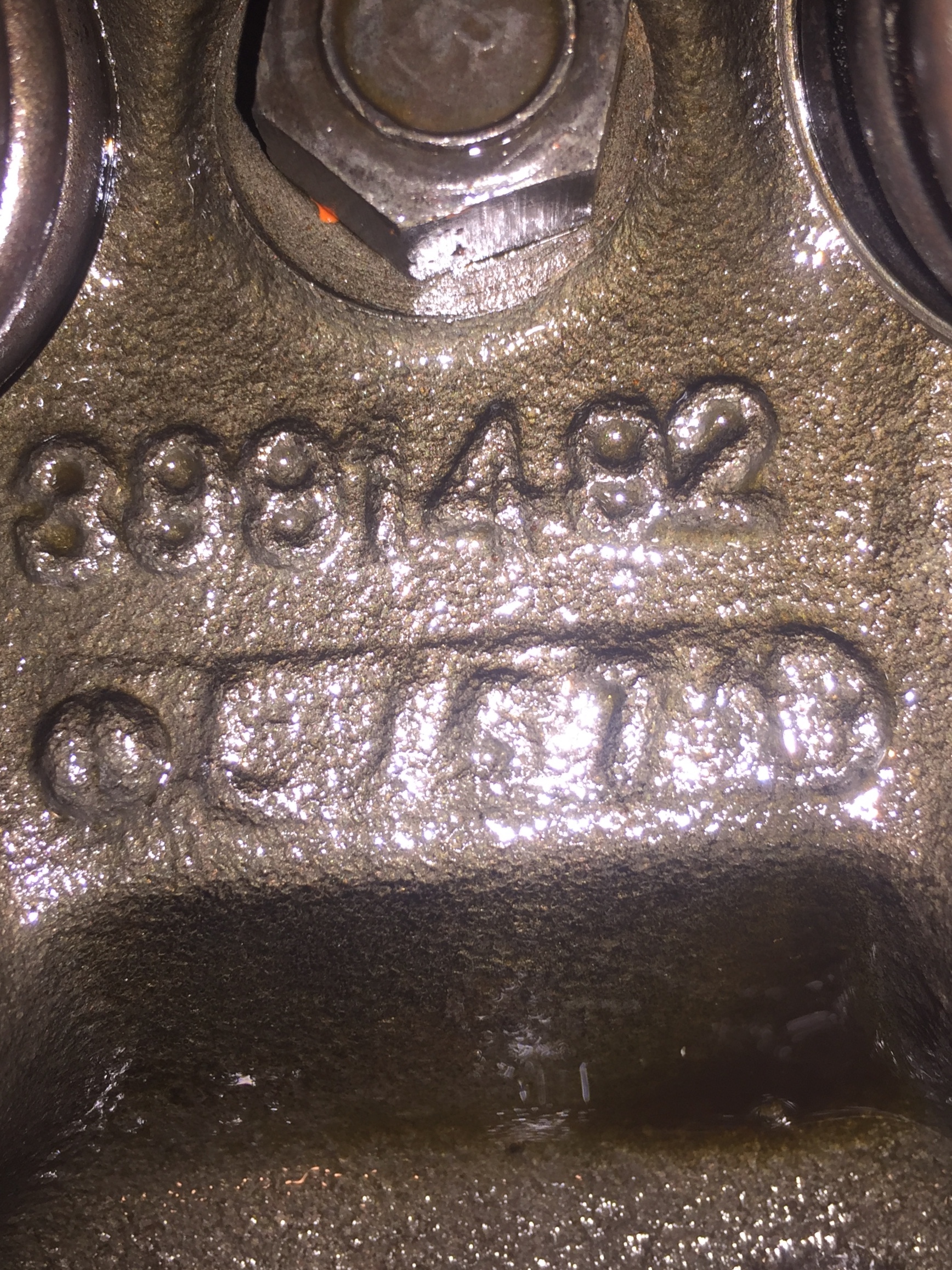

    As long as we’re talking about Chevy angle plug heads. These are on my corvette. What can you tell me about them? How much different are they from the 292’s?

    It was always my understanding that they were basically fuely heads with angle plugs . The 292s are a thicker casting to allow extensive port work without hitting water they also are machined for bigger valve springs.

    Yes to all of the above. The 492 castings were the same as the ones used on the LT1 350 enginne up to machining the sparkplug holes. A point of interest, a couple of the head porters offered a service that plugged the original holes in heads back to the 461 heads and remachining for peanut plugs at the angle. Just in case you had a lot of money in older heads that were otherwise still good.
    Like lumpy said, the 292 castings had more iron in the spring seat areas, the deck surface, and the ports. This allowed for bigger springs, more creative porting, and probably the best feature, angle milling the heads to get smaller chambers and better angles on the ports and valves. The 492s could be milled to reduce the valve angle from the stock 23 begrees to about 21 degrees max (or min, depending on the point of view). This moved the valves away from the cylinder wall, and also stood the intake ports more upright, helping with flow.
    The 292s could be angle milled further, but I don't know how far, as they have thicker deck surfaces, allowing deeper cutting on the plug side of the heads.
    The 034 heads have even more iron in those critical areas, but by then aftermarket heads were starting to have all of these features and more. The 400 engine that ratrodder has, has Gaerte spec Brodix heads from the mid 80s that are big enough to feed a good big block. And they are now considered antique. The last iteration of that engine before the Rodec 350+ block had one too many heat cycles, it was 14:1 compression on methanol, roller cam that the lobes don't look like eggs, they look like squares with the corners rounded off, and all of the stuff that good sprintcar engines had. And somewhere over 700 hp. And it wouldn't be compe***ive with engines today.
