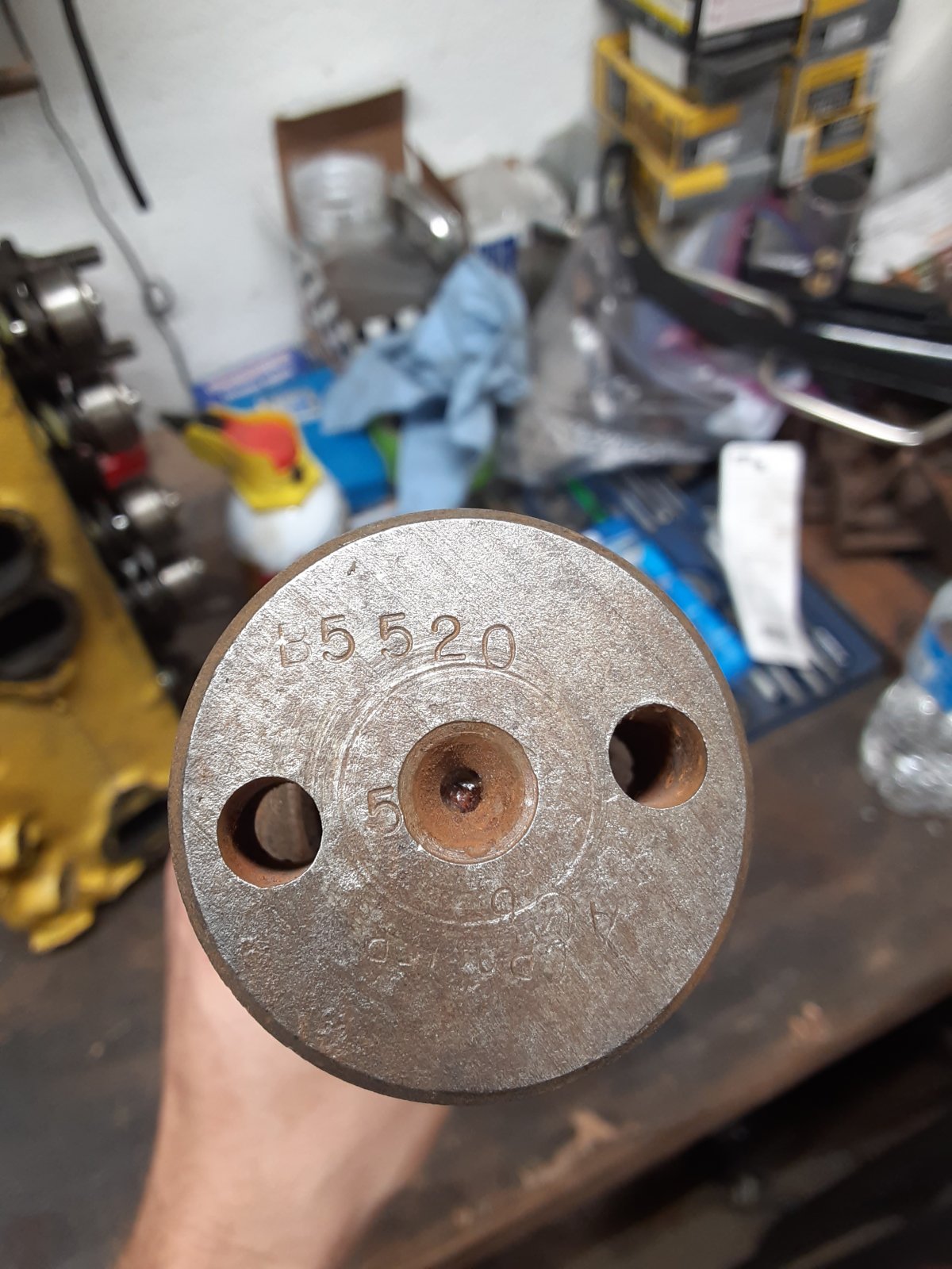

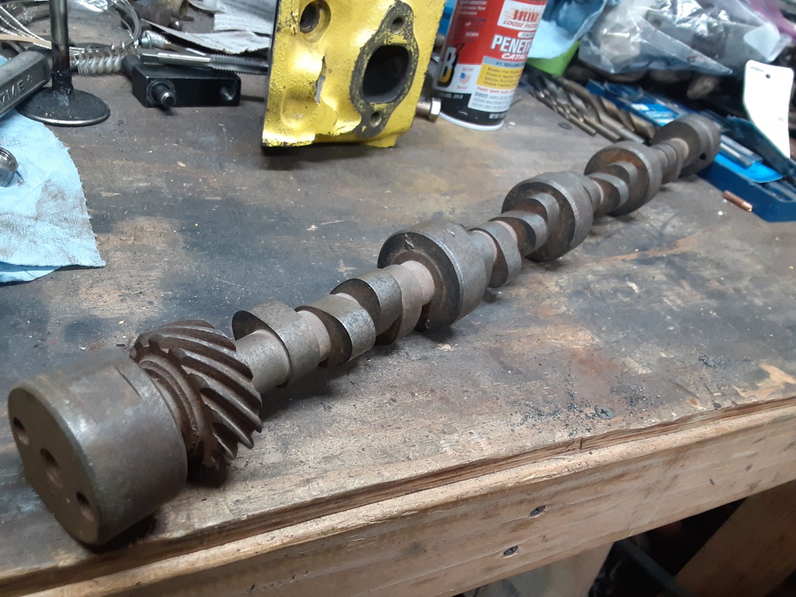

    Hey there guys and gals, I recently picked up an old Crower roller cam at the Redmond Swap meet in eastern Oregon a few weeks ago. The guy gave me the springs, solid lifters, rev kit, everything to put it back into an engine.
    I cannot find any specs on it anywhere, waiting for a response from Crower. All the cam says is B 5 5 2 0 on the end, it is old enough, it has the notch in the rear cam journal for oiling.
    The guys said he didnt remember specs, but it was in a 283 that ran 7800rpm all day with Enderle Inj., and it sounded nasty. Looking at it, the lobes are quite large, so I bet it does sound pretty rowdy.

    Will need to be polished,
    If Crower can not find Records
    You can mock up with Deg wheel & get specs / close,
    All needed is one Cylinder,
    Other ways with thought .

    You could use a pair calipers to measure the lobe lift and the base circle diameter and do the math..

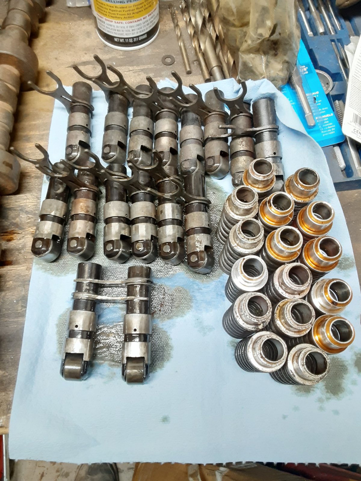

    Can’t help with specs. But how do the lifters look?
  6. From Crower's website....
    If the number on the cam starts with a letter it is a custom ground camshaft not a catalog or shelf camshaft.

    I looked all over their website and didnt see that, good to know!

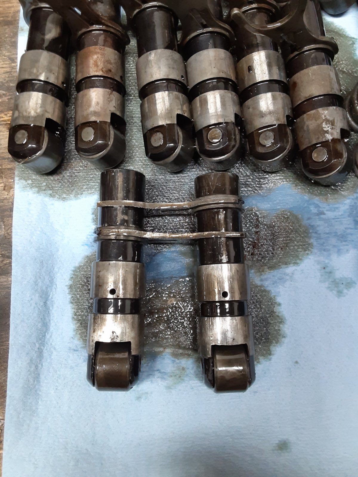

    Looking at them, they look fine, as a roller lifter should, i can get pictures later. They use a dogbone style link.
    They have all been sitting in a coffee can partially full of oil for god knows how long. Noticed a couple of the bodies have a little wear to them. All the rollers spin smooth. But could be a lot worse for a 50+ yeat old set of lifters. I think I did okay for $75 for the whole sha-bang including the valve springs, lifters, rev kit, cam, 14 push rods, 2 missing.
    I jerry rigged a setup in my vise to measure the lobes with my dial gauge, measured .531int/.550exh with a 1.5 rocker ratio (.354int/.367exh before ratio).
    Thinking I will send it off to Delta afterall and have them polish it, straighten/repair if needed, spec it out.

    That’s the best way to see if you want put together an engine with what you have, and it’s what you want.
    Not a cam expert by any means, but it
    doesn’t seem to be a daily driver camshaft;)
