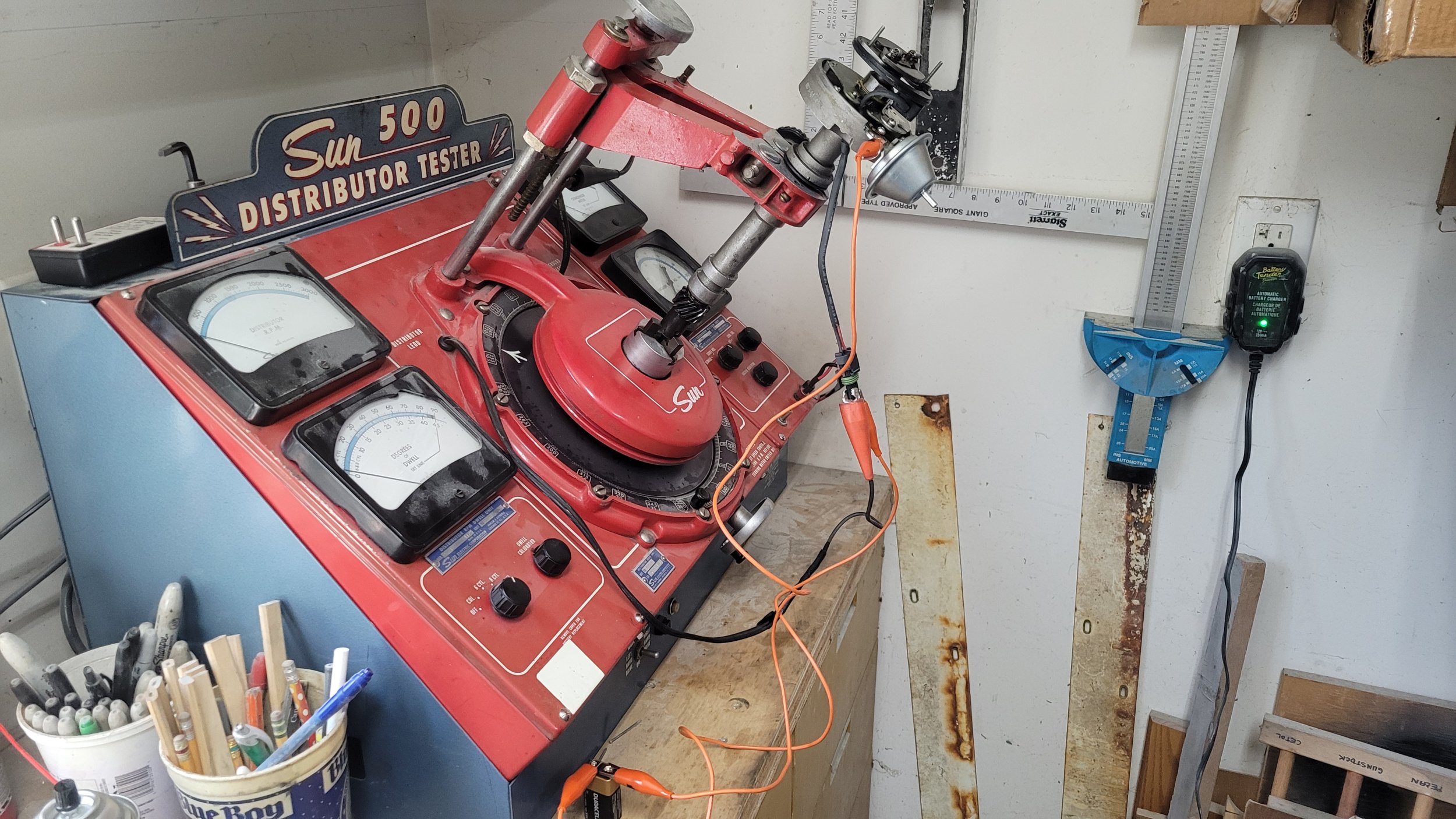

    Anyone else encounter this? Anyone know the cause? Also, I set my distributor up on my Sun 500 machine and it does not do this on the machine (though I did not have the cap or rotor on when setting it up on the machine...so maybe that plays a roll??). Even, when I took the distributor up past 2500 distributor rpm (5000+ engine equivalent) the advance seemed to react properly as expected.

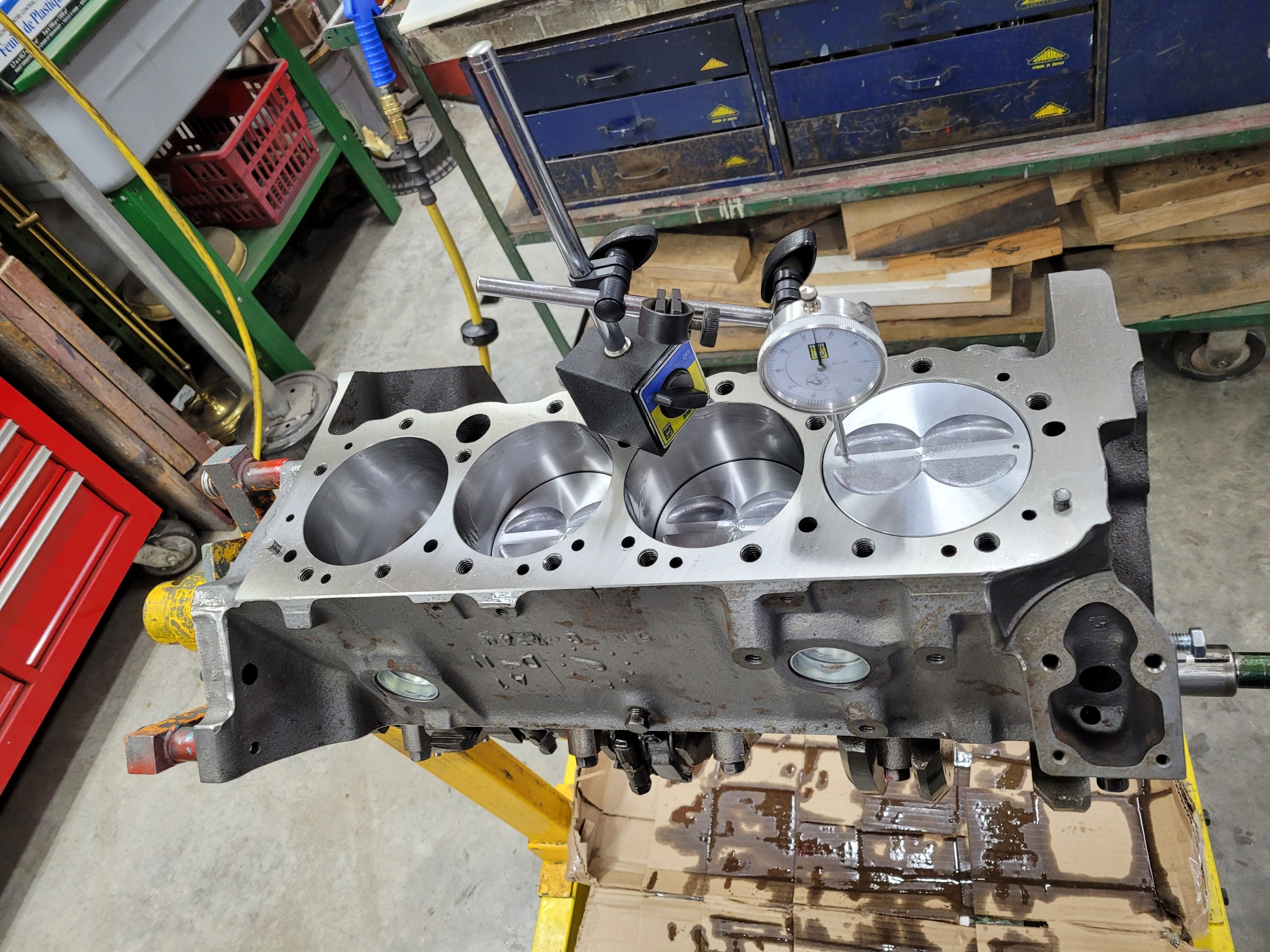

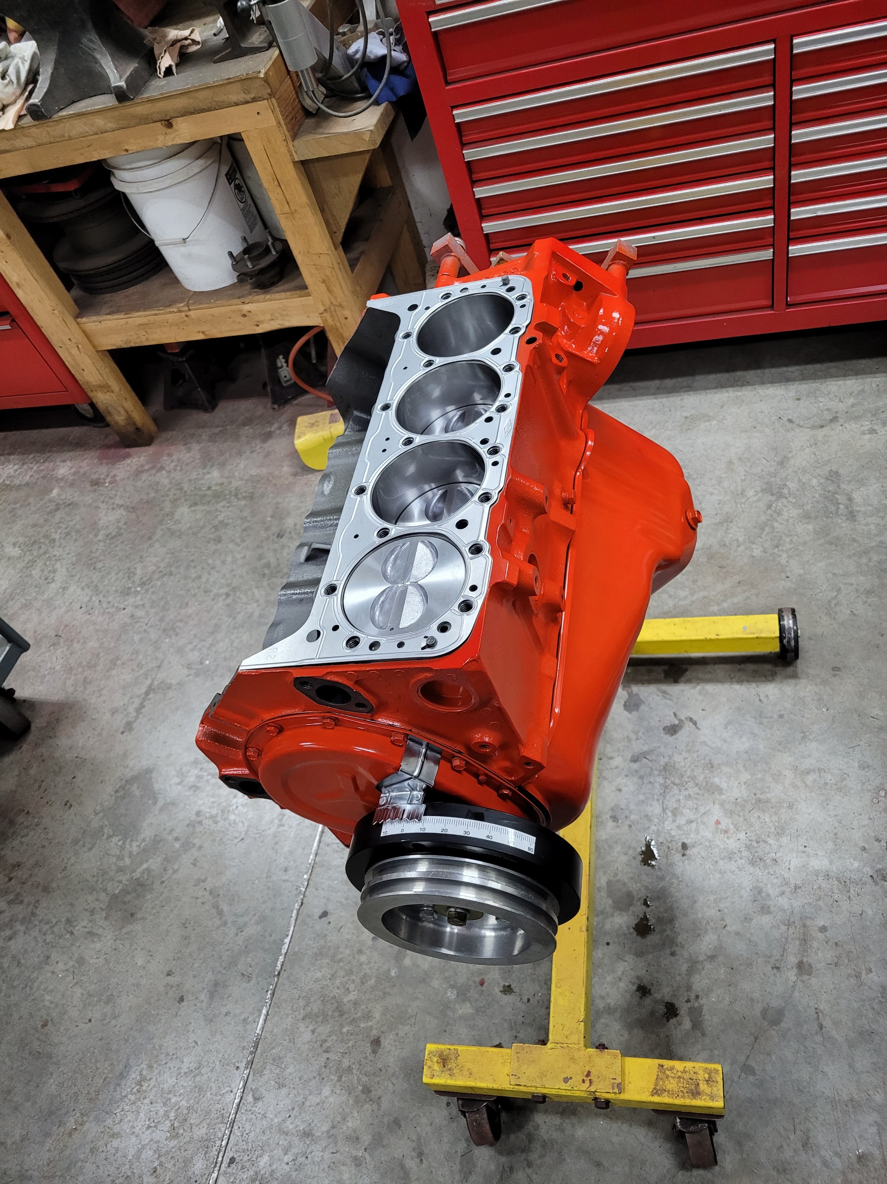

    And, just because this is the HAMB and this thread hasn't had a picture...I don't have any photos of the cam ****on install, but here are a couple engine ***embly shots anyway. 20240302_153916.jpg 20240309_135722.jpg 20240323_105905.jpg 20240530_161908.jpg
