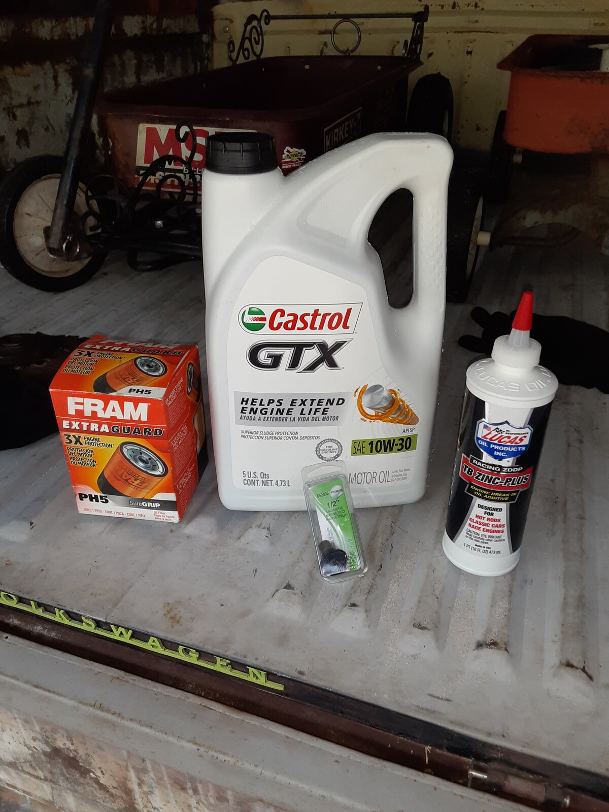

    Well...here we go. I'll use Castrol GTX 10W30 with Lucas Zinc additive for a 30 minute 2000-2500 rpm break in. I also picked up a magnetic drain plug...just because.
    I'm still not sure what to replace it with for the following 500 miles of driving break in... and then what after that. The Lucas additive says add a full bottle ar every oil change. Is it true, or are they just marketing their product ? Maybe we can get the Facebook fact checkers on it.
    I'll admit it. This cam BULL5h1T has me spooked. I still find it impossible to believe they can't figure out a better solution during manufacture instead of leaving it all up to a 30 minute break in.. 20210630_104233.jpg

    Good luck with your startup. You realize that you're gonna start a whole new bruhaha by showing that Fram filter? Right?

    I use valvoline VR1 racing oil that has zinc in it for every oil change in all of my old cars every single time..... Don't you dare run non zinc oil..... just my opinion
    and if someone gave me a free fram filter I would throw it away before I would ever use it on a car, too many horror stories

    Ok...I just watched a few FRAM oil filter videos. ..so the FRAM will get nixed. Live and learn. How did we ever survive without the internet so solve our issues?

    And then again , some of us have used fram filters for years without incident !
    AGEL55. The ast 3 FT cams I've been involved with ,Lucas break-oil was used for start up & first 500 miles , Lucas Hotrod/ muscle car oil since , no issues..

    Every time I see these oil/filter/lifter stories, guys gotta say, "been doing it this way for 30 years! Well consider this: things CHANGE! Fram used to make a quality filter, oh maybe 20 years ago. All the oil companies USED to put a lotta zinc in oil, A LONG TIME AGO. Lifters used to all generally be good enough to survive 100,000 miles back in the day. Well guess what, bean counters driven by profit margin, and the EPA, driven by the anti-christ (or something), made a lot of things we took for granted, different today. That's why we read this stuff today-to keep informed about what is going on TODAY! Thank you for your time, rant over. PS, if anyone has a set of good, unused, prehistoric, NOS anti pump up Chevy lifters, I'm looking for 'em.

    Ok, I cut the Fram open out of curiosity. Fyi, it had no byp*** valve at all. Hmmm.
    I also have a Bosch on the shelf. Any holt **** concerns there? 20210630_122557.jpg
