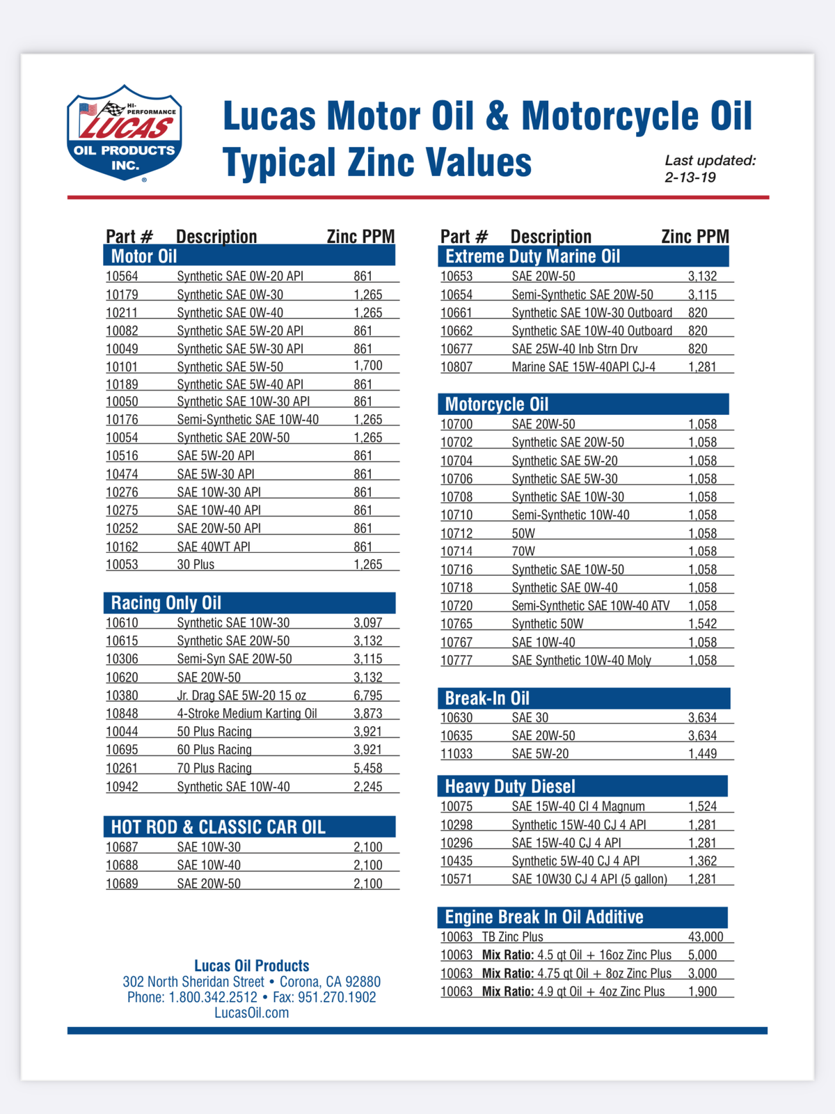

    Call be **** or obsessive, but I like to understand things and not simply accept the general comments plastered on these oils and additives, like "extends engine life", or superior protection". Really? How about some DATA?! To that end, trying to understand how much zddp I'm actually putting into a new engine, I found this awesome chart from Lucas. Check out the lower RH entries for the zddp additive.
    One 16oz bottle has 43,000 ppm? Holy smokes.. and on the bottle, it recommends adding a full bottle with each oil change? A full bottle with 4.9 qts of oil puts you over 5000 ppm, plus whatever zinc was already in the oil you added it to. This doesn’t add up, because Lucas Hot Rod oil has 2100 ppm. Couple this with everything I’m reading that says too much ZDDP will also harm your engine. What to do? You call Lucas oil, and ask questions.
    Per the Lucas technical hotline ( as best as my note taking allows):
    My Castrol GTX oil has around 861 ppm of zinc. If I add a full bottle (16oz) to 5 qts of oil for break in, I’ll be in the mid 3000’s ppm which matches up with their own break in oil.
    They recommend following the GM procedure for the 30 min 2000-2500 rpm romp. Dump the oil and filter, and replace using another full bottle for the 500 mile break in drive. After that, hold around 2100 ppm. At this point, I asked why the additive bottle recommends adding a full bottle with every oil change, which as we already discovered, would hold your ZDDP in the mid 3000’s when their own oil has 2100 ppm. Hmmmm... “Good question”. He will “raise this issue with their marketing and development people”.
    So in conclusion, after full break in, us their HotRod oil at 2100 ppm, or use about a quarter to a third bottle of additive ***uming your base oil carries around 861 ppm.
    I love technical stuff.

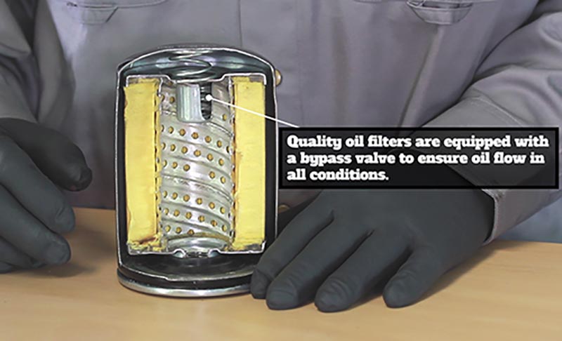

    To the best of my knowledge , filter byp*** valves are located in the filter adaptor on the engine .
    An anti drain back valve is sometimes included in filters , whether or not its needed is another question..
  15. 2fast,
    Finally,,,,,,someone has mentioned this fact .
    If the filter clogs or the media collapsed within it,,,,,the only way to get the oil to the engine is,,,,,,by the byp*** of the filter .

    Actually they can be in the filter, allows for oil flow when the filter media can’t handle it, plugged, cold oil etc.

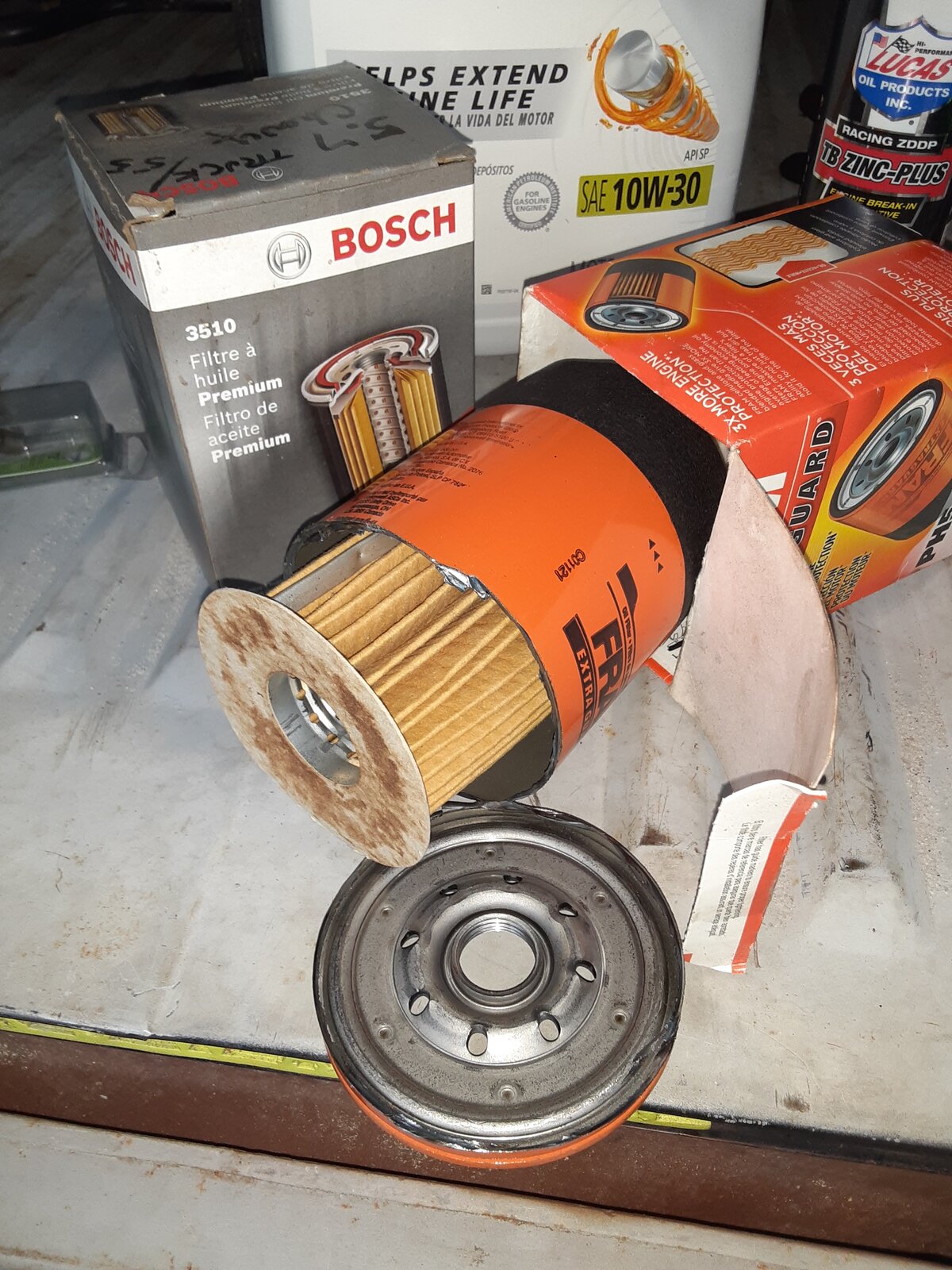

    Bosch Filter & 15w40 Diesel oil. After break in.
