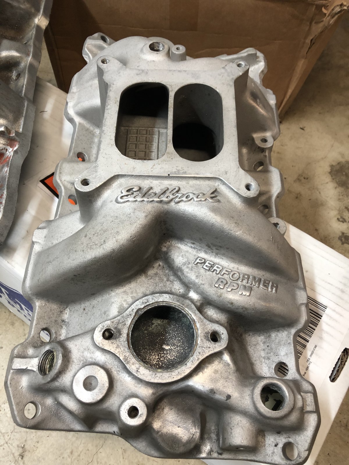

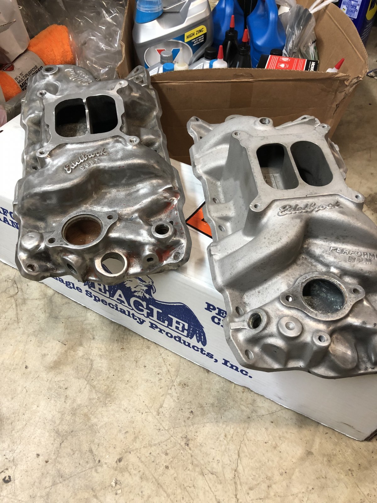

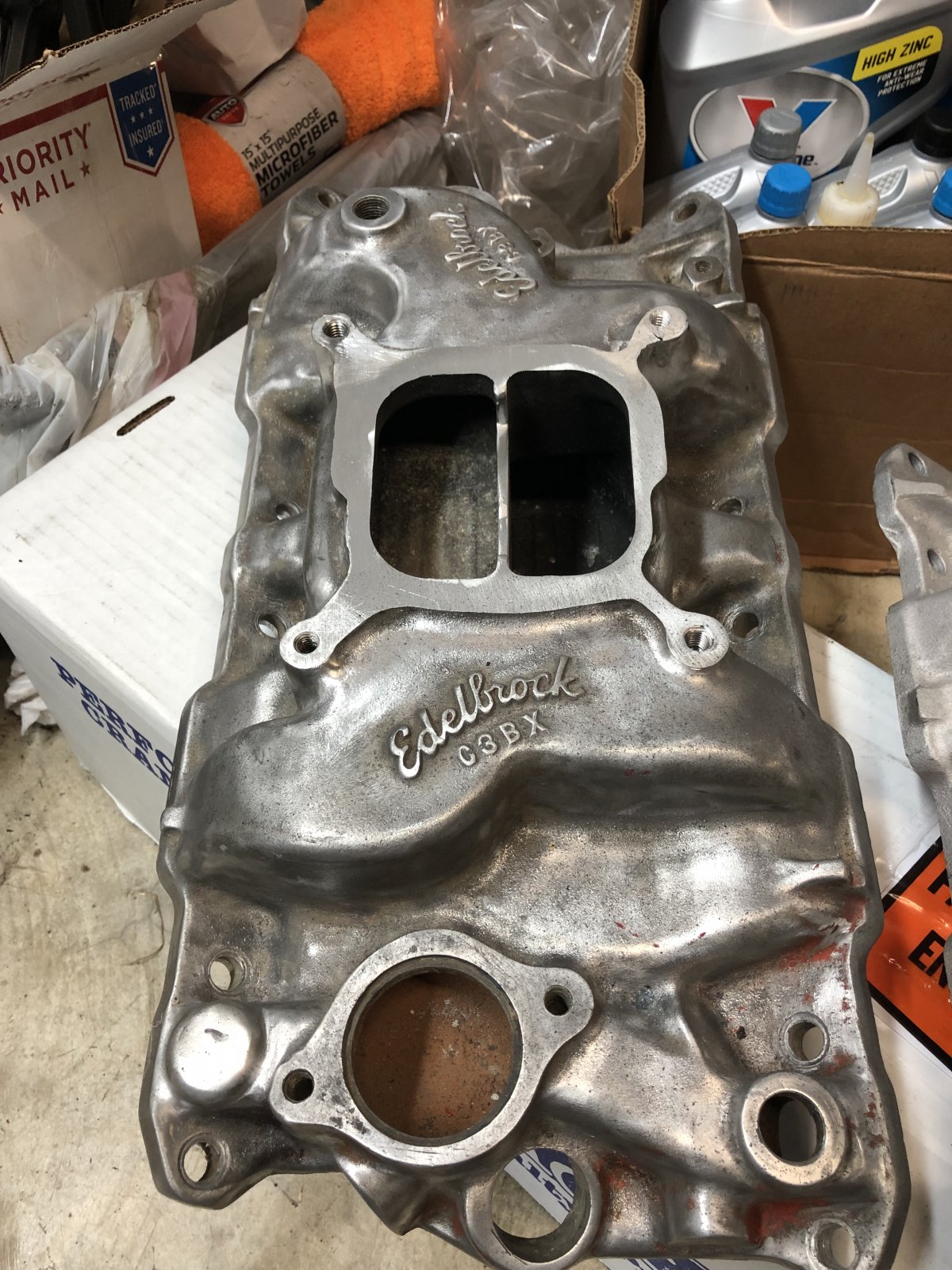

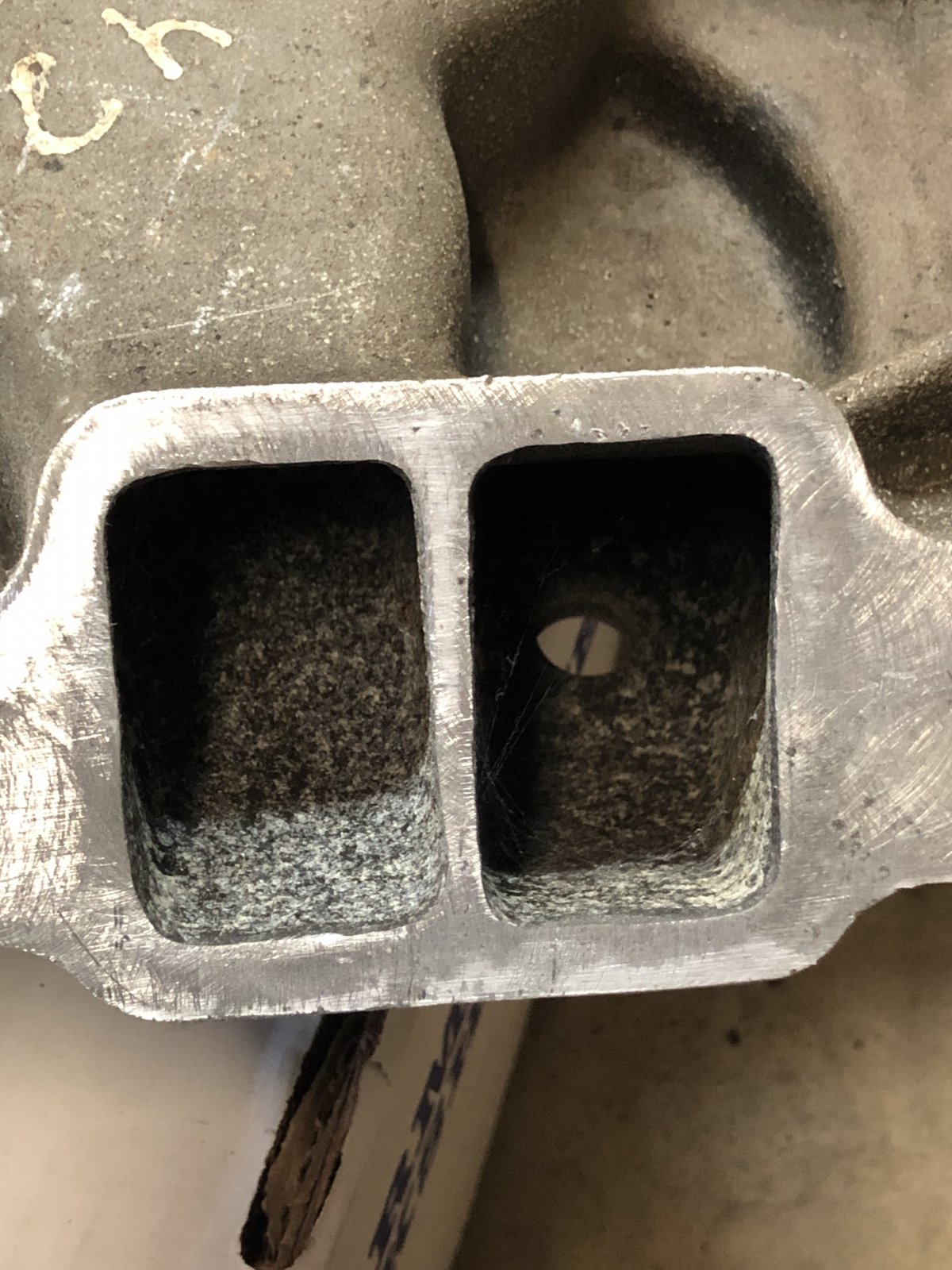

  11. The C3BX is an older intake and reminds me of the old Z28 or LT 1 Winters factory intakes .
    Comparing the ports,,,,the C3 does have larger ports,,,,,I’m assuming they have been opened up at some earlier time ?
    The C3 runners appear to be cast larger as well .
    The Perfomer is a taller intake,,,,,and ,,,,the runners,,,although taller,,,, seem to be somewhat smaller externally .
    The Performer feels to be heavier as well,,,,,,it’s enough I can feel it by just picking it up .
    Here are pics of the ports as they are now .
    9A6D5FAD-2B1E-4138-81C1-3C2949F19F56.jpeg F09D6A6D-A1BA-4E53-90FA-90823D539AAA.jpeg

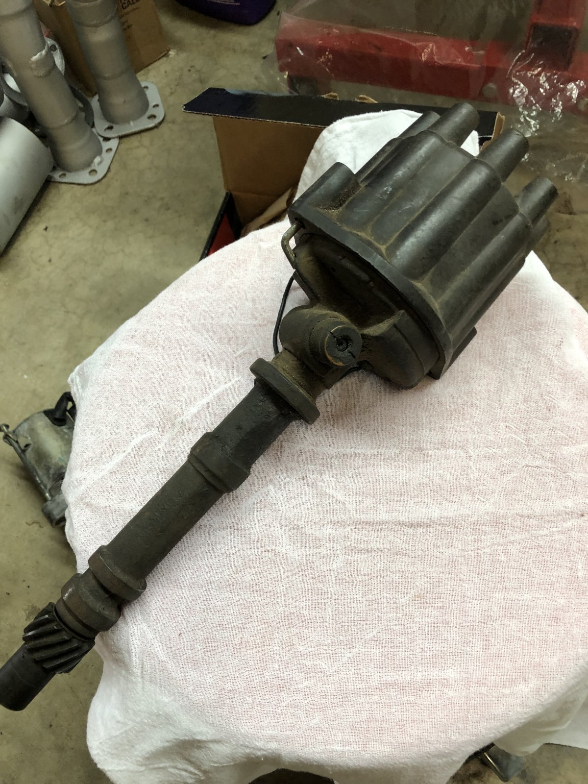

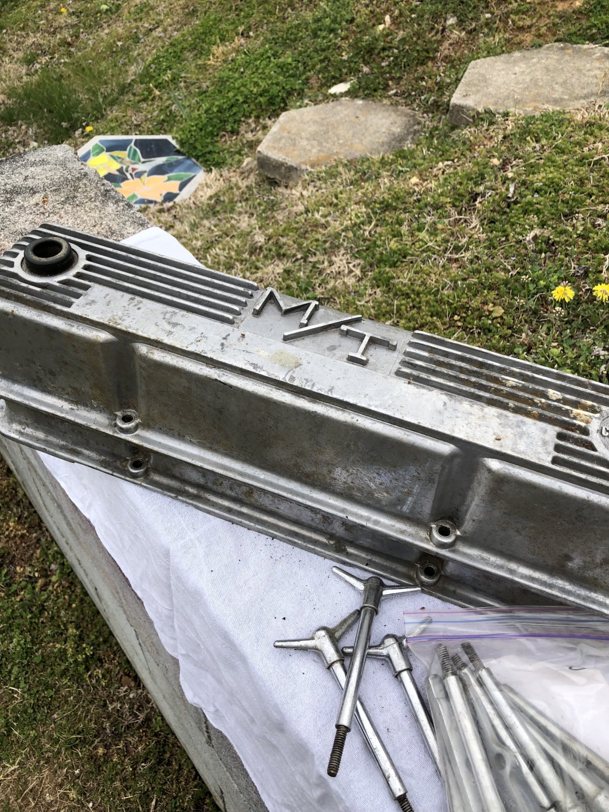

  12. Here are what I plan to use for valve covers and ignition .
    I’ve had the Mickeys for many years,,,,,,just waiting for a need .
    They are really filthy,,,,but I can clean and polish them back up .
    Also,,,gonna use the Wing tie downs,,,,,,I’m reminiscing some I guess,,,,lol .
    The ignition is gonna be an HEI,,,,,.
    Wait a minute,,,,,wait a minute ,,,,,,,,just kidding !,,,,,,psych,,,,,!
    This is an old cast iron ,,,tach drive,,,,,Dual Point !
    Had it for a while,,,,,just me I guess,,,,,LoL .
    883D0B93-AAF5-4147-BD69-503EC465DFDF.jpeg BCE1E35A-3240-4E3D-96FF-AA5CF47F999F.jpeg
    1Nimrod, Stock Racer, Deuces and 5 others like this.

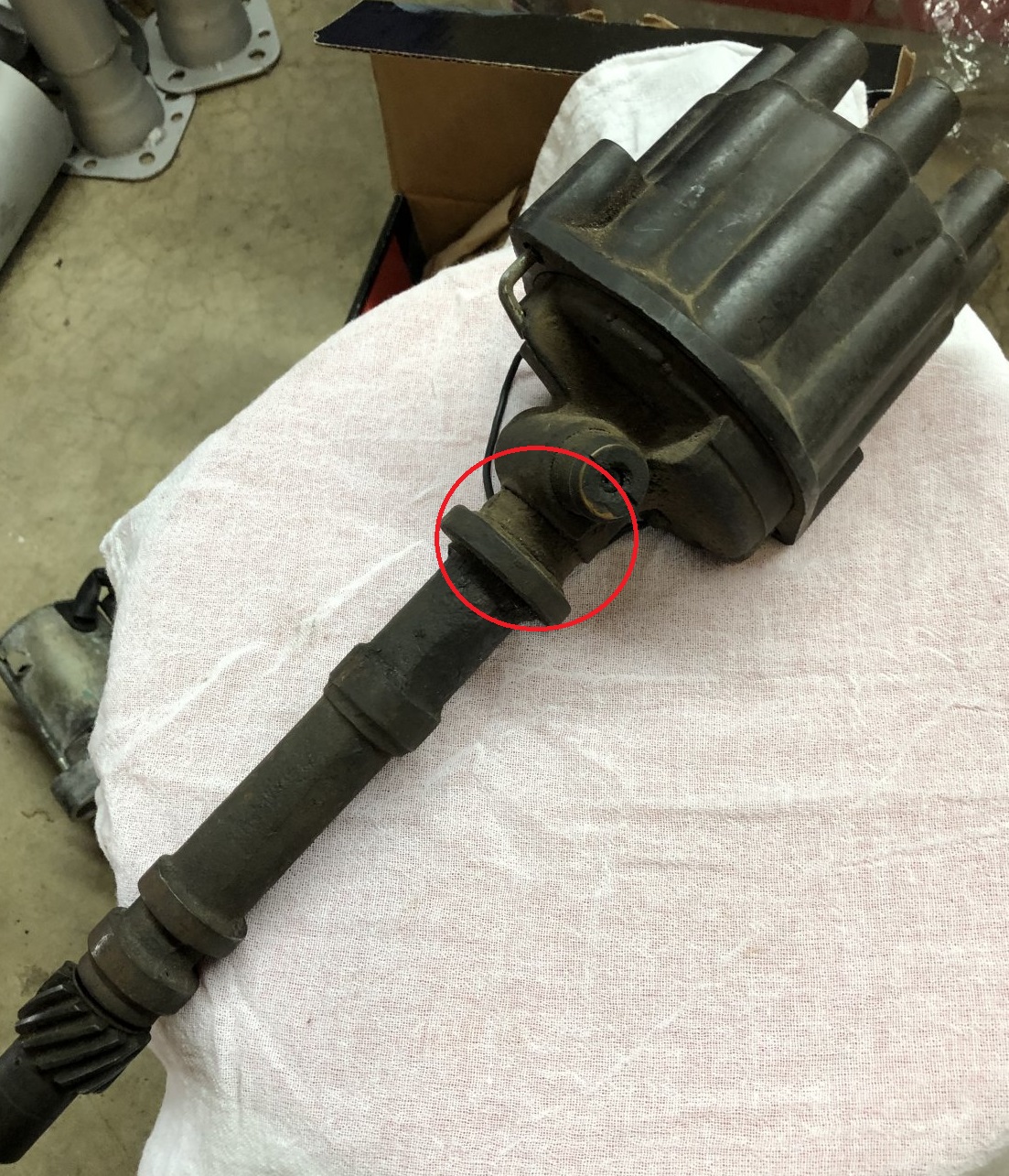

    The older intake, valve covers, and iron distributor will go together pretty well. Although...if it has a tag on it, it might be worth a bunch to a Vette restorer, and you could get a Mallory dual point, which was very common on engines that got the other go-fast parts installed on them. Most guys tended to ditch the stock ignition, even though it worked great with a recurve.
  22. Hi Jim ,
    I have a really nice Mallory dual point,,,,,but I’m saving it to be converted for my Flathead .
    I might be wrong,,,,but I don’t think the iron distributor I have ,,,,,has a tag on it .
    And besides,,…I rarely run upon anything that anyone wants .
    Most of my stuff is castoffs and hand me downs,,,,no one needs my junk .,,,, .
    Of course,,,,I do own a couple of Hemis,,,,,,,many 440s,,,,,a cherry Flathead that is gonna be a great engine,,,,,,and multiples of superchargers,,,,fuel injection systems,,,,,a few nice SBC engines .
    Where am I going with this,,,,,,?,,,,,hummmmm,,,,,maybe I need to check on that tag after all .
    Lol,,,LoL .
    Tommy
    1Nimrod and loudbang like this.
  23. squirrel
    Joined: Sep 23, 2004
    Posts: 59,241
    squirrel
    The tag is an aluminum strip, with numbers stamped, wrapped around the distributor neck where the red circle is. Many are gone. Some, if they're dirty enough that no one noticed it and took it off, are still there. Even without a tag, the distributor is worth something to the Vette guys. Many years ago I picked up two of the electronic version tach drive units, ten bucks a pop at the swap meet...no tags...sold one that week for $350, used the other for several years then sold it for bucks also. You never know. If it's a dual point, they're rare, and might be worth looking into.
