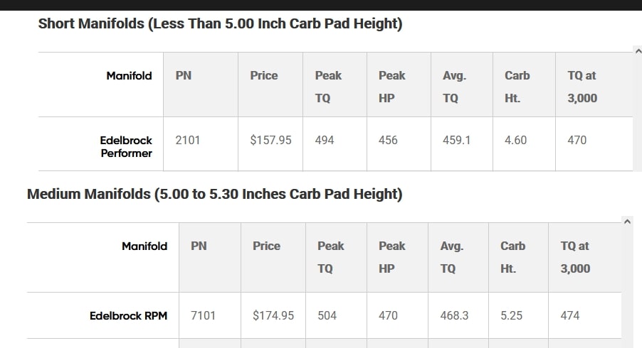

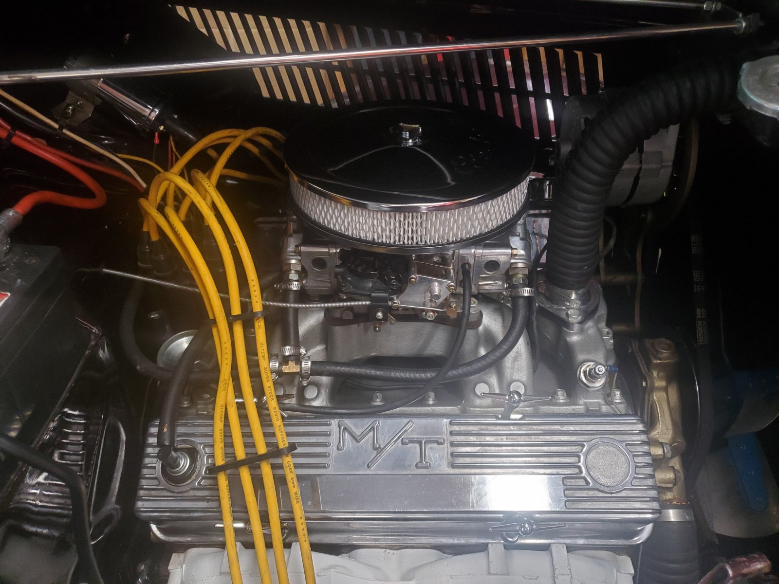

    RPM air gap.. and I do have a C3B.
    No need for an oil fill with a 350.
    Breathers in the covers, same covers you have.
    Holley Street Avenger 670....I ain't losing sleep over it either. 20210629_195737.jpg

    The C3BX has the vintage look. The Performer is a bit more refined and will make a little more power. The performance difference between the two will probably be unrecognizable so choose along those guidelines.

  10. Moedog07
    Joined: Apr 11, 2011
    Posts: 517
    Moedog07
    If he uses the M/T valve covers he'll be fine. They have at least one hole in them.
